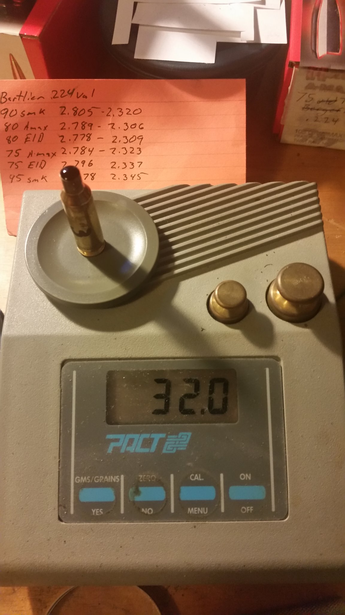

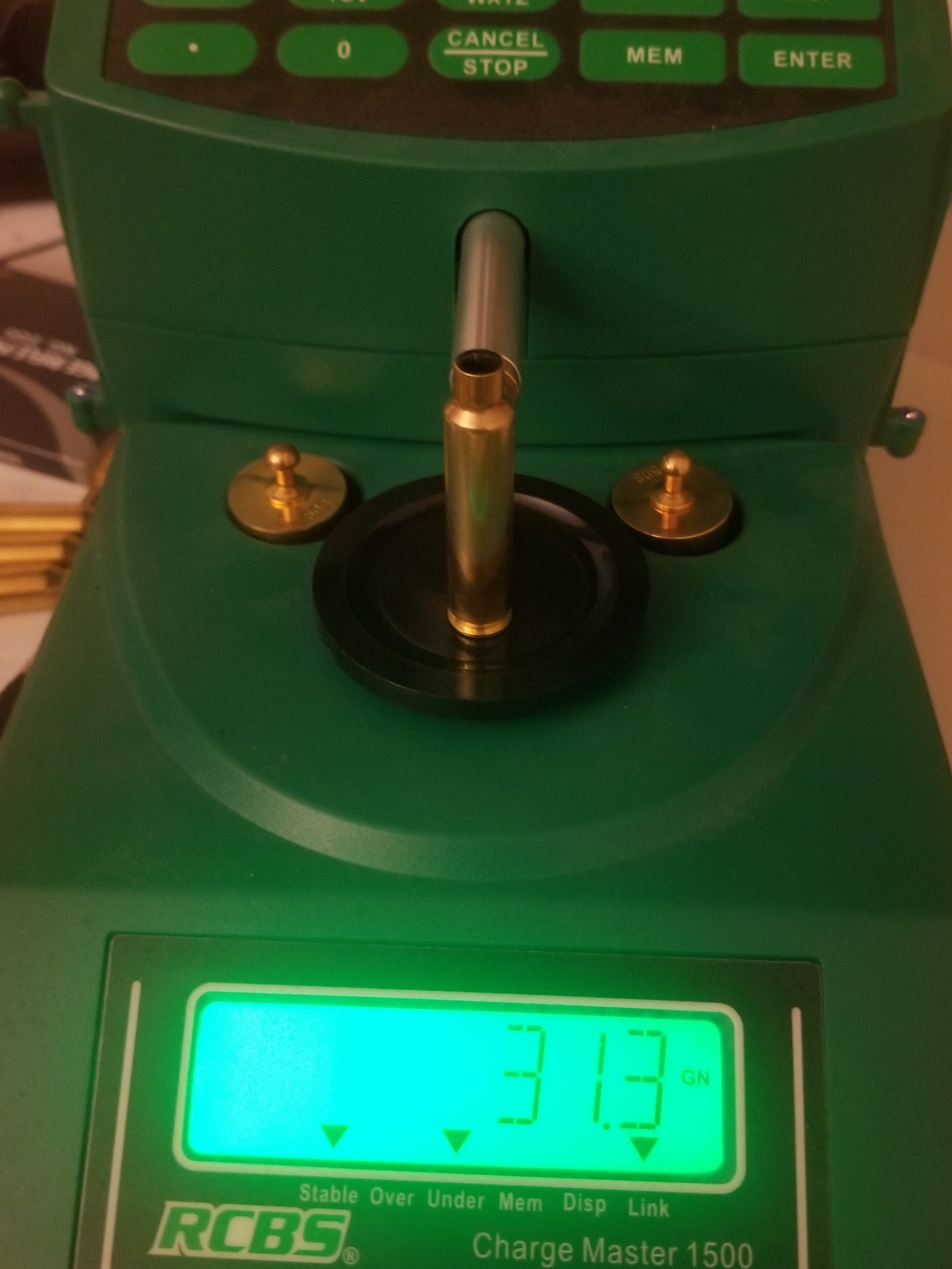

Measure some cases for yourself, I bet the numbers will be very close to the ones I found
224 Grendel 35.3gr
224 Valkyrie 32.8gr
22 Nosler 35.5gr
223 Rem 29 ish as there are so many cases and it can very quite a bit for the old 223. All measured in H20 to over flow.
These were the numbers I found when I recently did some searching. Pretty sure the same guy measured the cases he had so it was a good comparison. I know numbers get to be all over the place when looking at some sites.
I know he said bolt gun. I mentioned in the first sentence of what you quoted of me, "I know this is in bolt guns". "The duality of the cartridge" is supposed to mean both bolt and AR. In this case -15 platform so you don't have to go with the heavier -10 platform. Read further and you will see that I state, "otherwise, the BR will beat it hands down." No such duality with BR's. They don't last in AR's. So owning one each isn't such a hot idea.
You lost me again, particularly with the last sentence.
Sorry, the dimensions I was given a while back were close to that of the 6.8 SPC necked down. Minus 1mm on the neck. The only thing I have close to that is a 6.8 SPC necked down to 6mm as opposed to 5.56/.223. I went back and looked at the dimensions of the .224V and they have sized down more than just the case length, my bad.

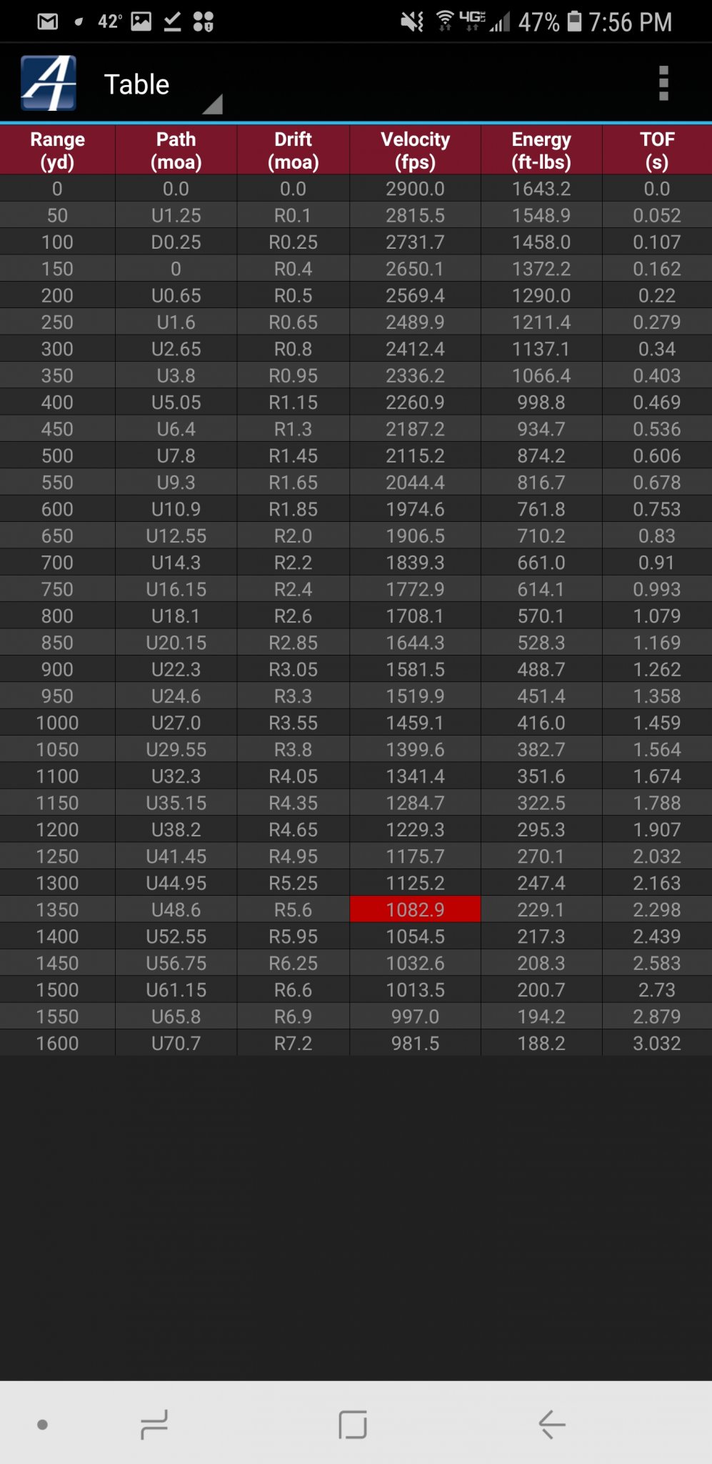

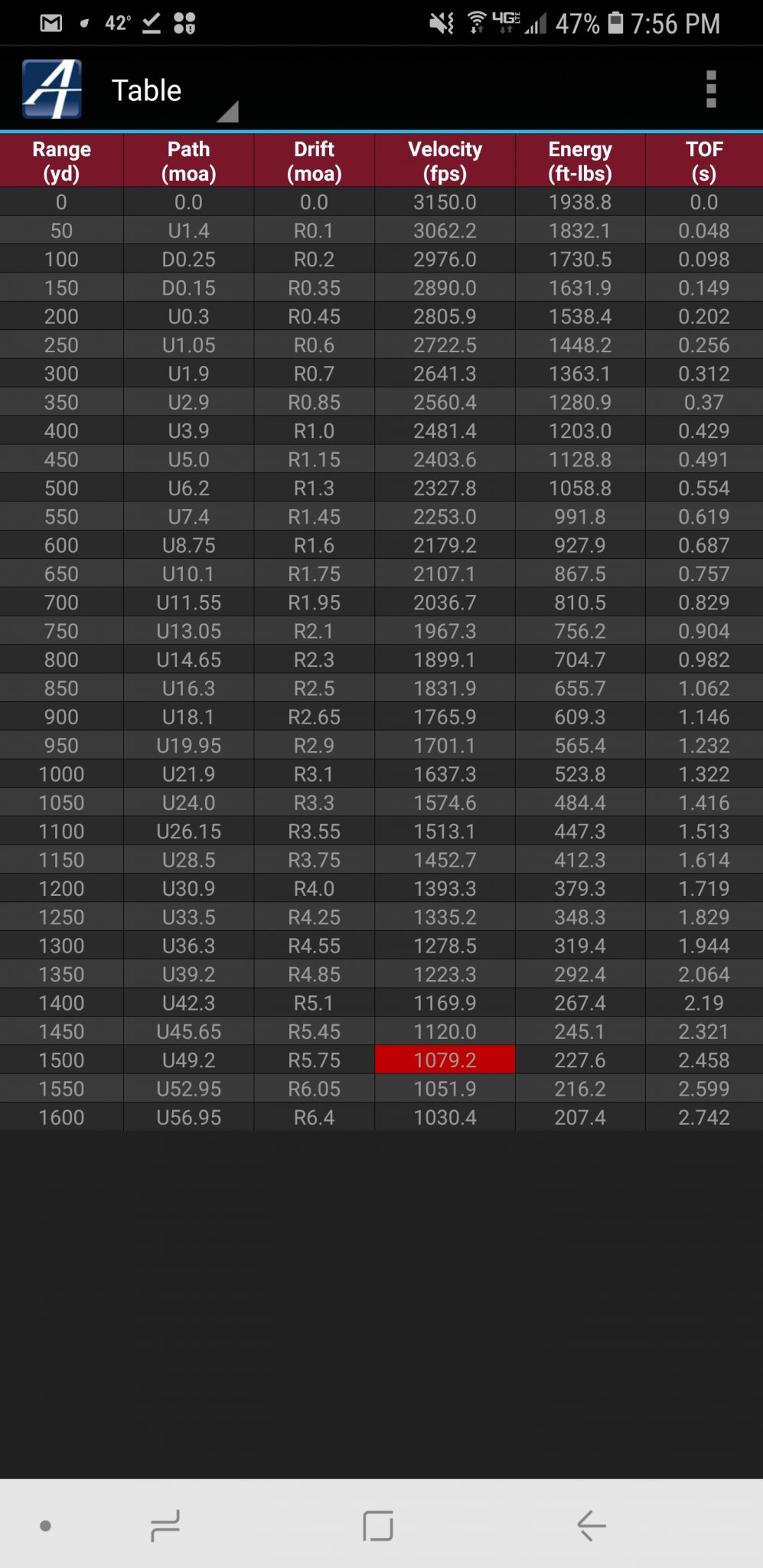

Here are the theoretical ballistics for an 88ELDM from 22 Creed at 3150fps (first picture) vs 224V at 2900fps (2nd pic), 55deg, 1000feet:
224V Bolt @ 2900fps
The 224V is still flatter than a 140 VLD 6.5CM running around 2750 to 1000 yards. And it costs 50% less to shoot than the 6.5 and probably about 20% less than 22 Creed. Toss in 2 extra barrels for the 22Creed to make it to 5000 rounds and it's substantially more than the Valkyrie.
224V Bolt @ 2900fps

If he doesn't come up with a case capacity weight just let me know and I will weigh one tomorrow. Not sure if I have to pull a bullet to do so but it's no big deal if I have to.
I am away from home for a few days. If you can, please do. I know I had a few AI' cases but finding them may be difficult.
Reactions: Bender
On a side note, awhile back I loaded a 77 grain bthp into both a standard 223 and a valkyrie with the same powder charge and primer. The valkyrie was about 30 fps slower, but there was quite a bit more room for powder in the valkyrie whereas the 223 was at compression. I was using Varget. I suspect that a long throated Valkyrie made for use in an aics modified mag would match, if not surpass a 223ai loaded long with the same 88 or 95 grain bullet.
