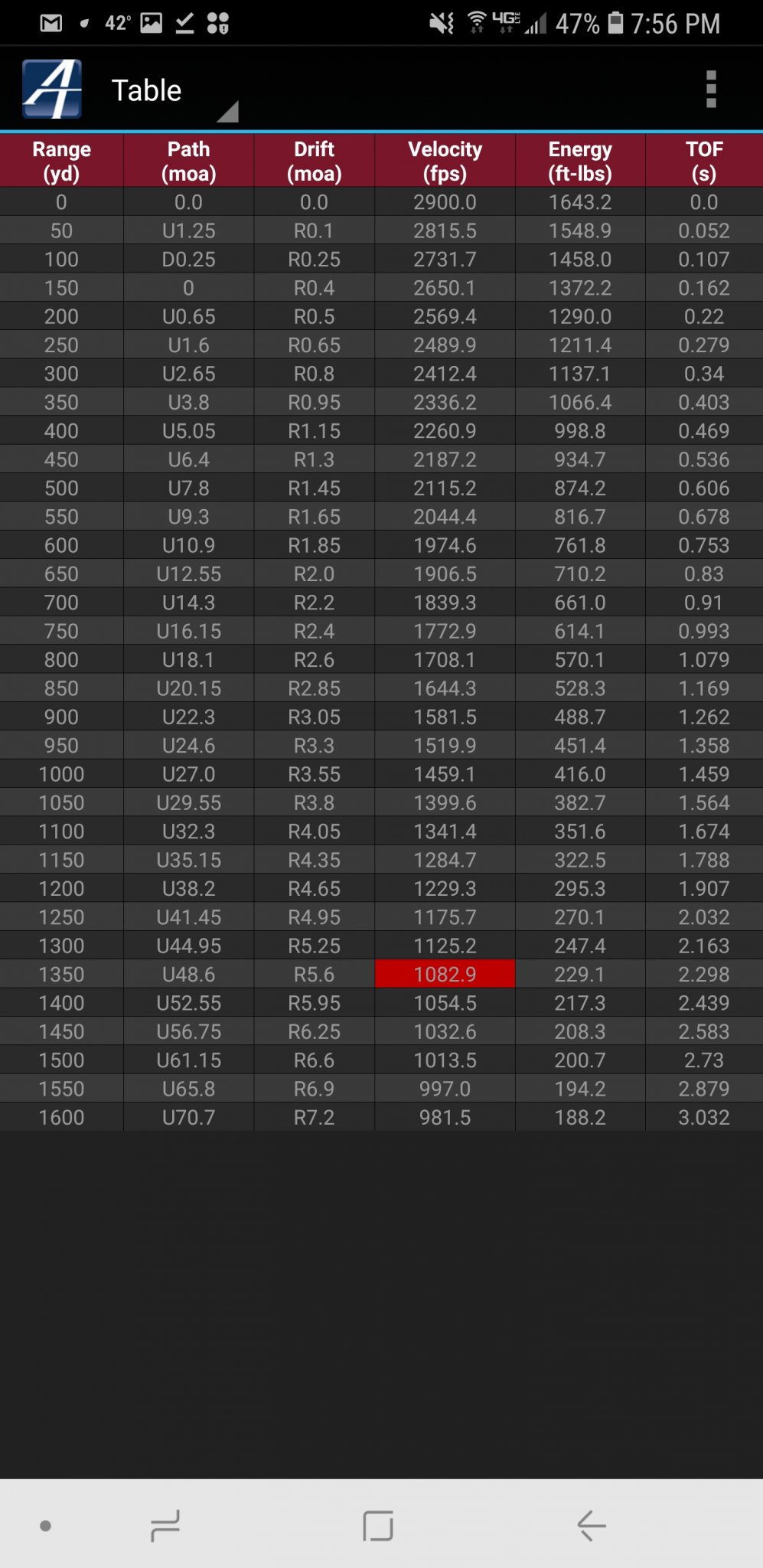

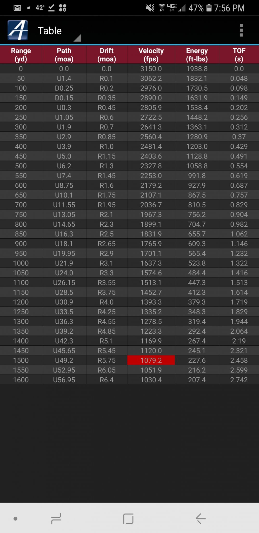

Here are the theoretical ballistics for an 88ELDM from 22 Creed at 3150fps (first picture) vs 224V at 2900fps (2nd pic), 55deg, 1000feet:
224V Bolt @ 2900fps
The 224V is still flatter than a 140 VLD 6.5CM running around 2750 to 1000 yards. And it costs 50% less to shoot than the 6.5 and probably about 20% less than 22 Creed. Toss in 2 extra barrels for the 22Creed to make it to 5000 rounds and it's substantially more than the Valkyrie.

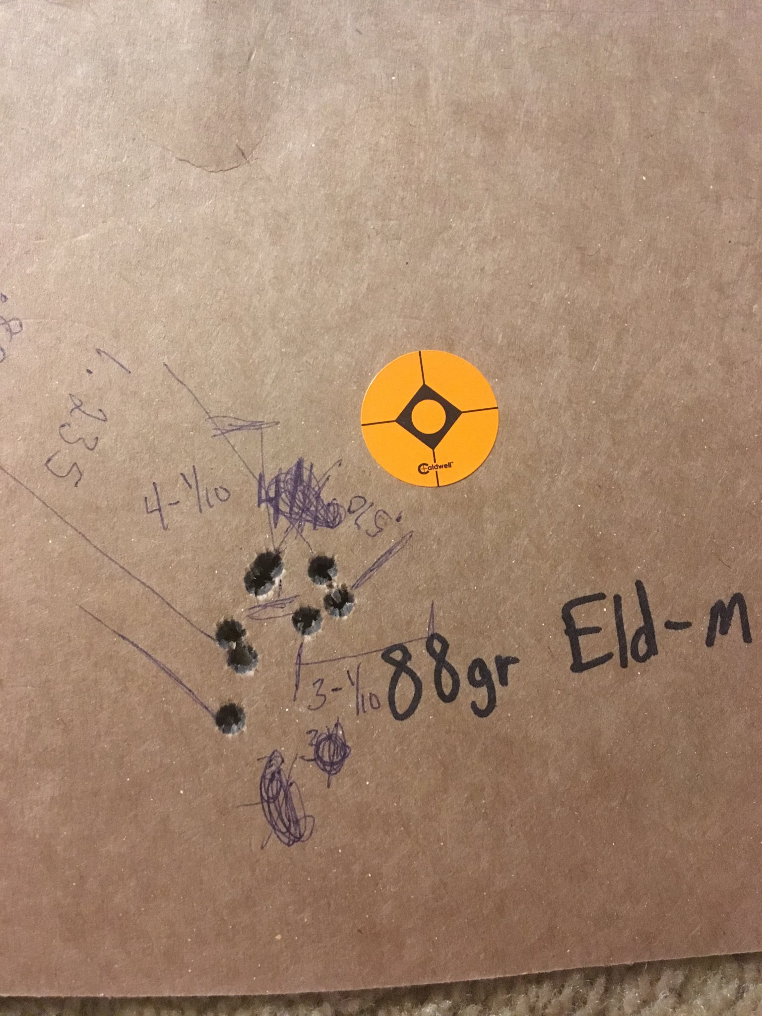

I'm getting anywhere from .570 ctc 5 shot group to 1.235 ctc 8 shot group all at 100 yards with factory 88 eld-m's at an average of 2676fps in a 24" barrel, 43 es, 17sd with the weather at 72F, Station pressure at 29.01, DA at 2112 and humity at 35%.....I'm pretty excited for reloading for the first time and with this round. He also said some of his loads used varget and FGMM primers...not sure what recipe but he said I can call him and ask if/when I have issues.
I don't get how some people are have soooo much bad luck on this round like johnnys reloading and iraqverteran8888 on youtube and I think they are about the only ones on youtube that don't think much of the Valkyrie. I'm happy to say I've seen more good than bad, even on the forums, I've seen good especially this one.

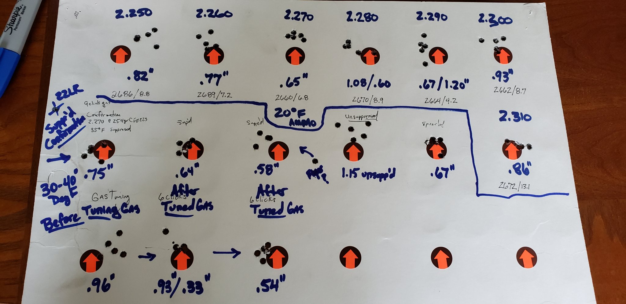

The only powder I've had consistent success with sub-moa loads is CFE223 and even then it takes a LOT of tuning to produce best results. So much so that I found I needed to start a basic OCW with .2gr powder increments because the velocity changes so quickly (about 10-15fps/.1gr of powder). After finding a good SD Node with decent precision, I then went through seating depths at .010 increments. .010 made a big difference between groups. Here is a picture of of recent 88 ELD CFE223 development done specifically for suppressor:
Top row is seating depth test of same charge 25.4gr CFE223, middle row is confirmation of the 2.270" OAL shot the next day. Bottom row is gas tuning (first is adjustment up, and then shot on another target while getting bolt to cycle perfectly, then next two are with correct gas).
The middle row group at 1.05" is an unsuppressed group with the same load.
Also, gas block and spring tuning helped significantly. With +2 gas systems and long barrels, the dwell time is incredibly long on 22+ barrels so timing the extraction point is critical to ensure consistent extraction AFTER bullet has left the barrel rather than during bullet travel.
If shooting suppressed, my best loads for unsuppressed shooting are NOT the same as for suppressed. They are about .2-.4gr different from one another (generally lower) which speaks to the issue of tuning gas and pressure timing even more.
Essentially, I think this catridge can be picky: you need a solid barrel mfg, good reamer, gas/buffer tuning, and very good reloading testing techniques to achieve good results, all in addition to being a very good gas gun shooter (which is a perishable skill).
Additionally, there aren't a lot of good single base powders that have known performance that meet the pressure needs for this round (i.e. temp stable and slow burn rate). CFE223 and BLC2 are slow but they are ball Double base powders. XBR8208 & Varget are too fast to achieve good velocity and H4350 is too bulky/slow. It's almost like we need an H4350 Short cut powder to create a slow but less bulky powder that's temp stable.

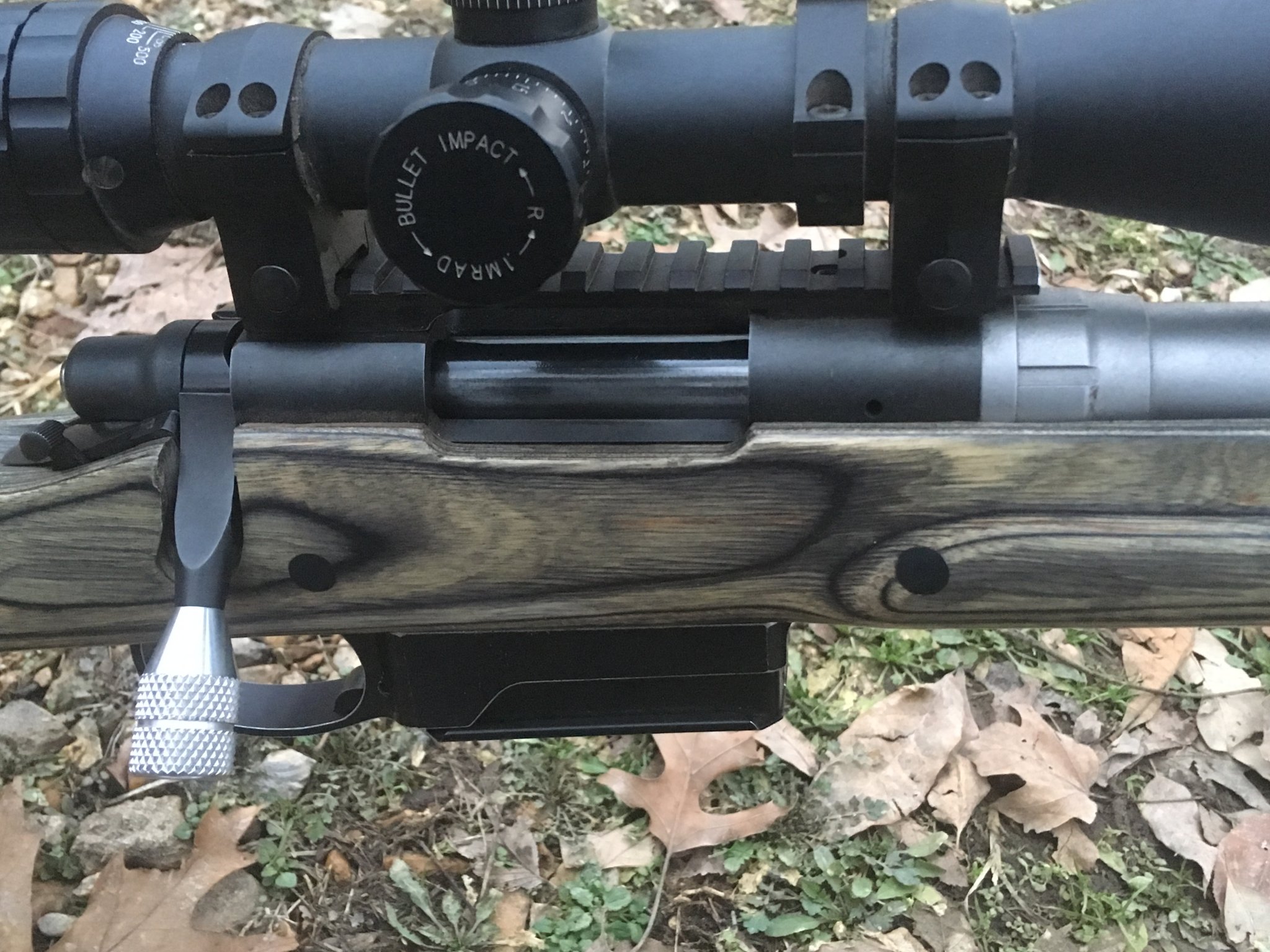

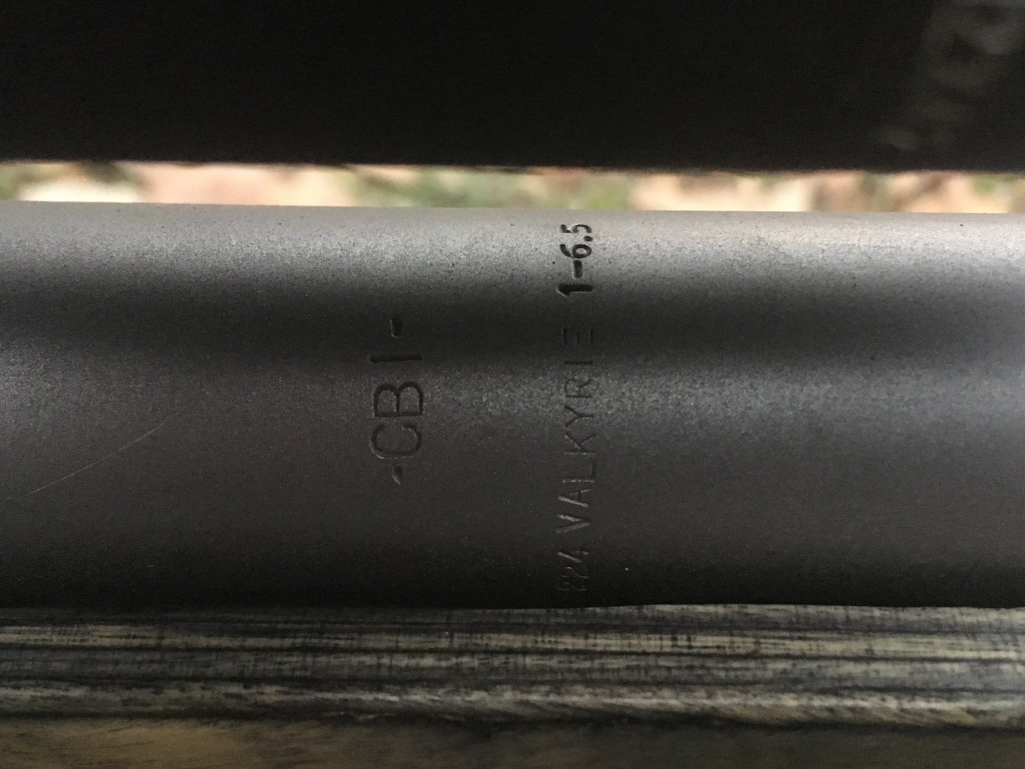

Here ya go.....
Not the best group but it’ll improve with time and ammo down the barrel, think I have only 120 rounds down the tube ....not sure if I have what they call the “bad” reamer chamber or not, will find out when I start reloading for it, but this was probably close to the first criterion 6.5 twist barrels done so I don’t know at this time.
I called to ask what reamer they used and all I got was saami spec, don’t know who’s either maybe jgs or ptg. It shoots a damn sight better than the factory rem it was!
My thought process was low recoil, laser, short barrel (18.5"), critter killing truck gun for night thumping -- .22 Creed fit that glove the best.
Barrel swapping to .224V (24") for when it's range time -- pound some rounds with factory ammo availability and good barrel life.
