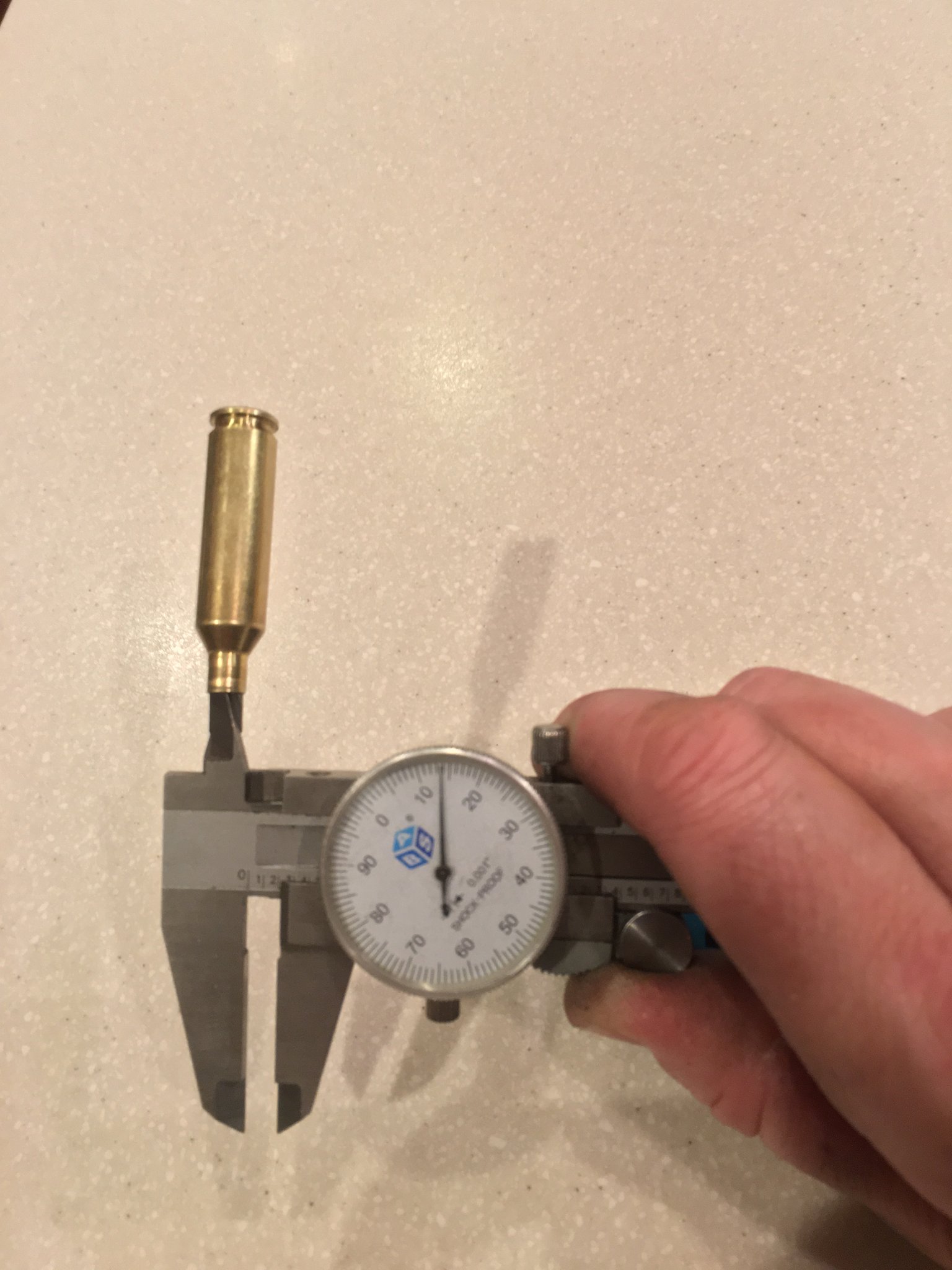

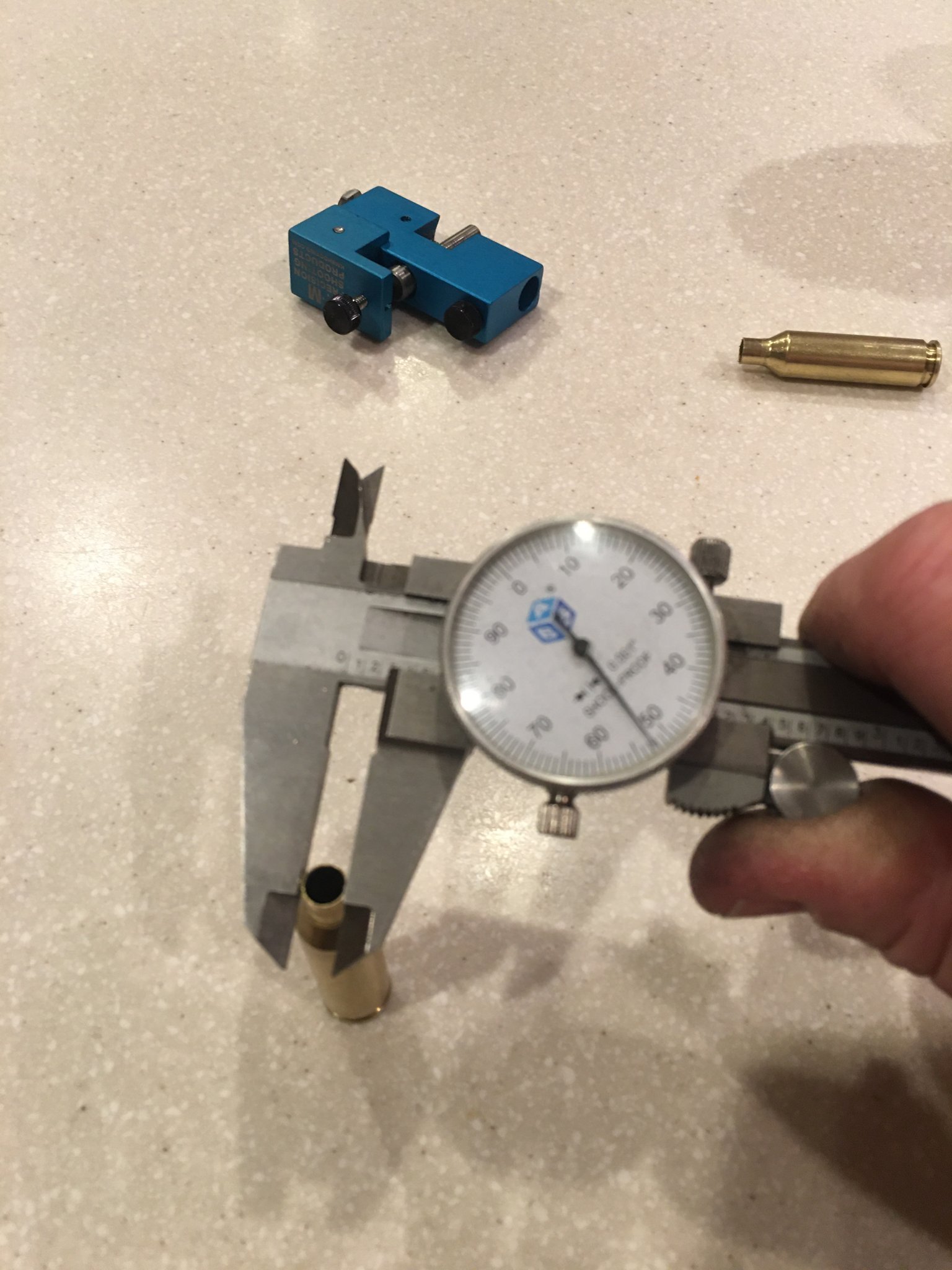

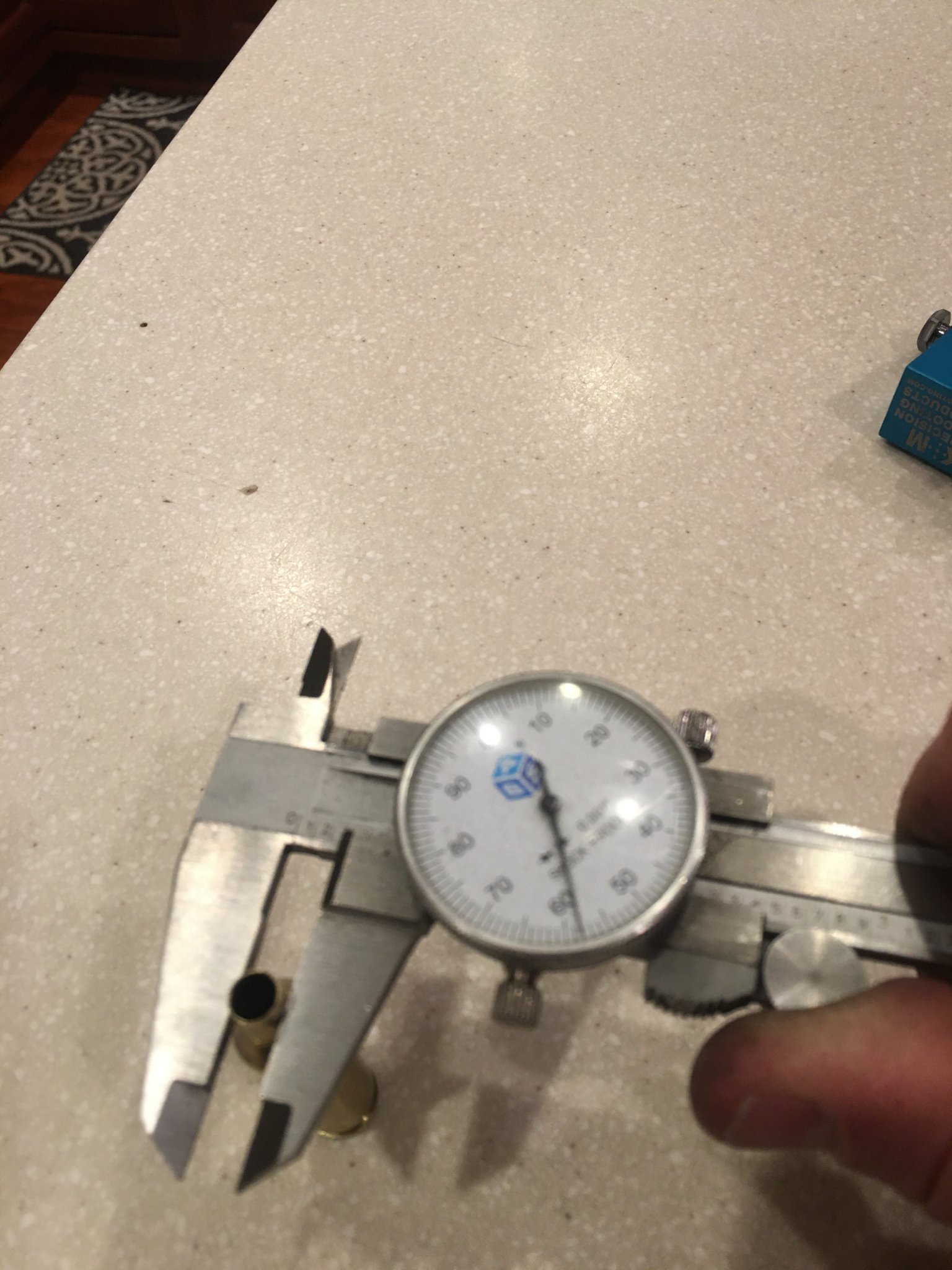

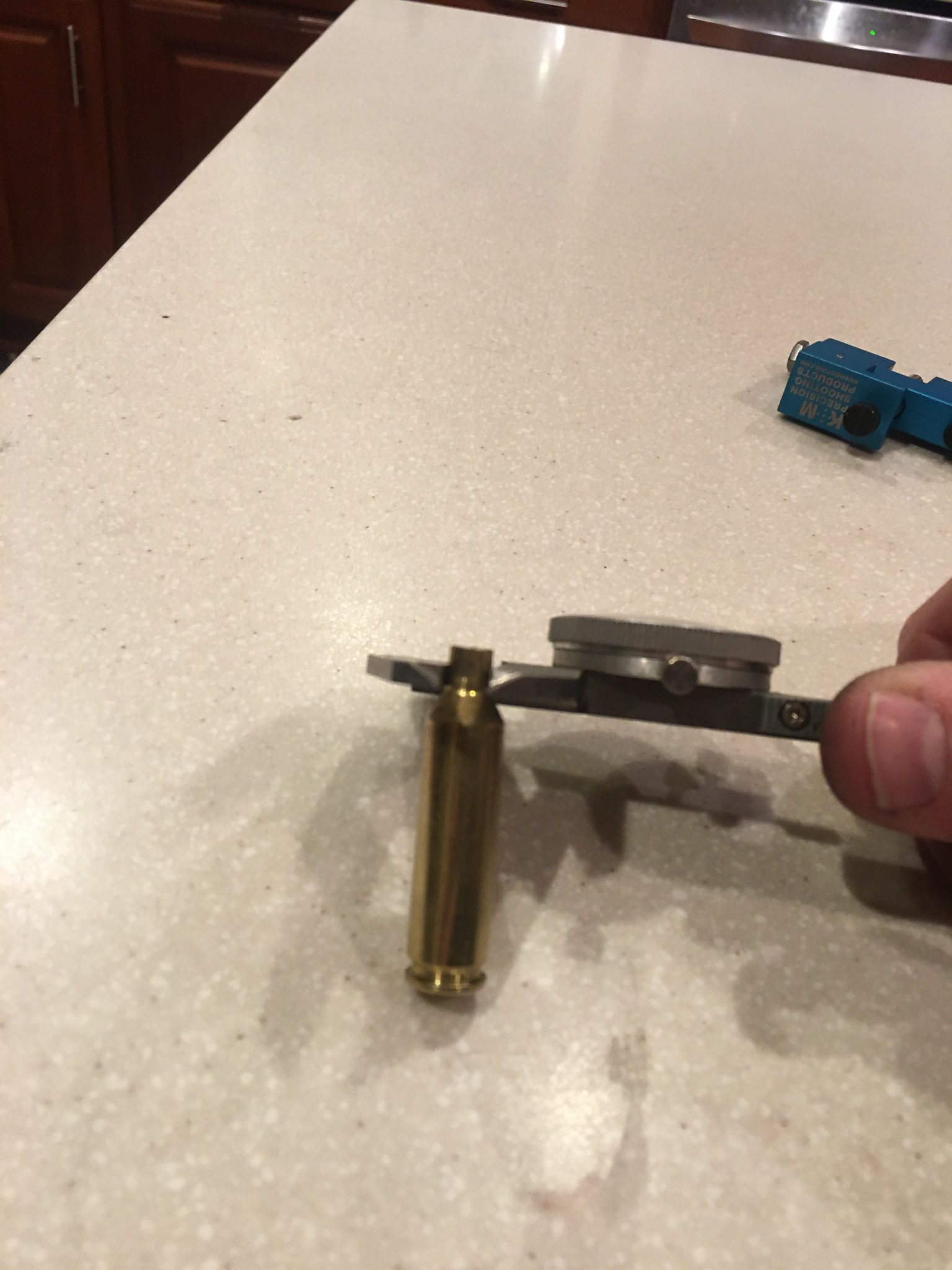

Took the dive into uncharted territory today: 6mm creedmoor brass - necked to 22 creedmoor.
this is went things have gone off the rails.. I heard of the dreaded Donut, but though if I went in steps. (6mm c fls to 260 NS, to 252 ish NS ) all would be good.. Nope!
lip is 251
Shoulder is 257!
1.82 in from lip is 255. This is on the edge of the donut .

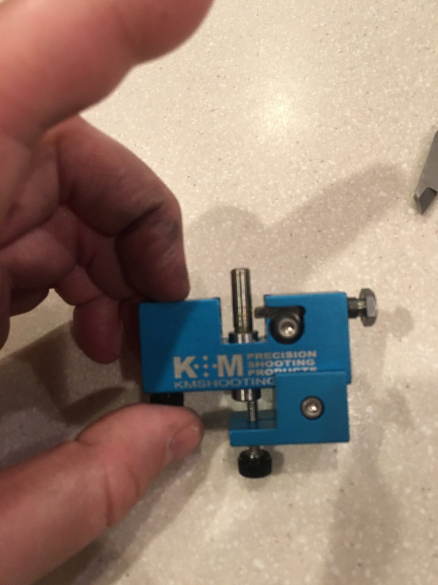

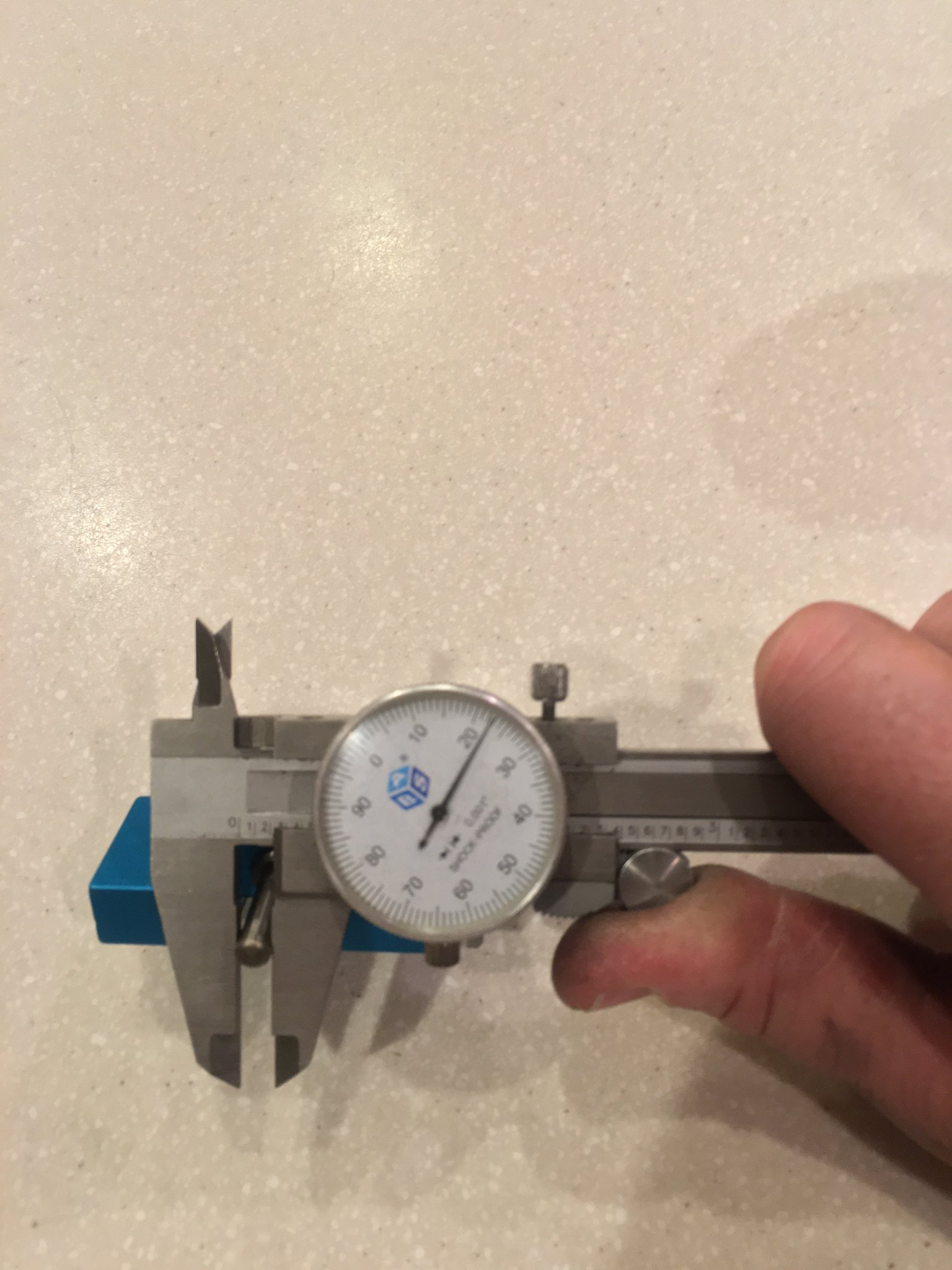

Second part of the adventure is picking up a K&m neck turner...
The 22 caliber arbor will not work in other words if your neck down your brass ready to load a bullet like with a 252 it will be too small so you have to neck it down less... try a 260 hmm too big! Try a 251. Too small! Crap... back to the loading Shop. should have purchased the The K&M Press Adapter so I can use the K&M Expand mandrels ... but that would be only if I knew what I was doing... yeah right.
I should’ve picked something like that up along time ago and I would’ve helped when case trimming. Wow, what do you know I actually learned something today.

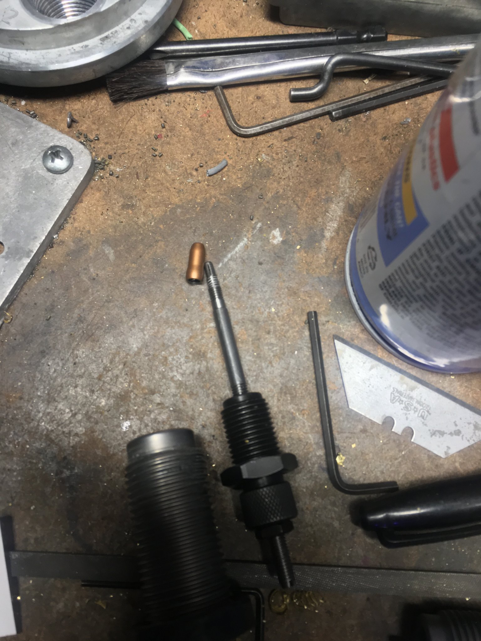

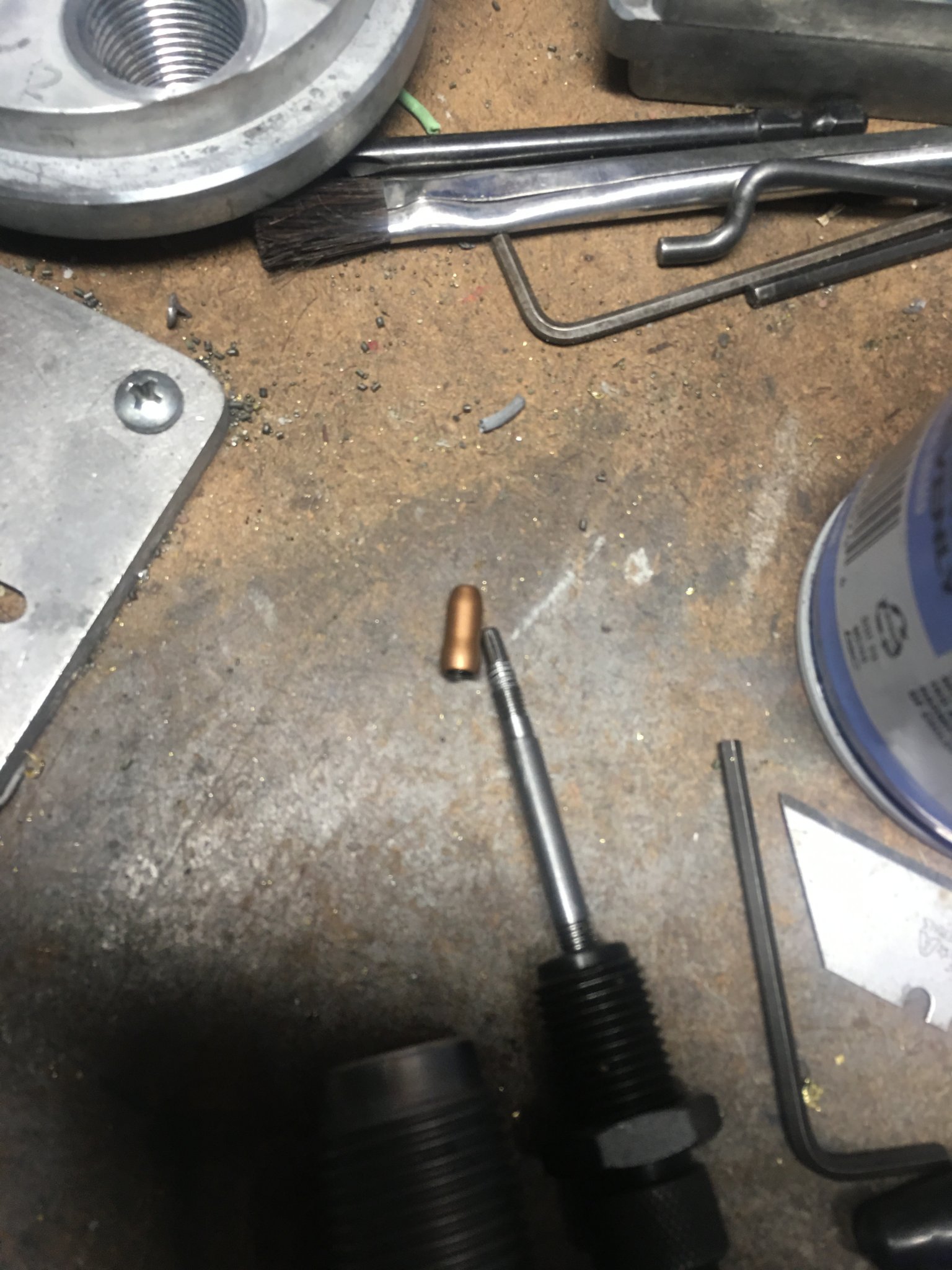

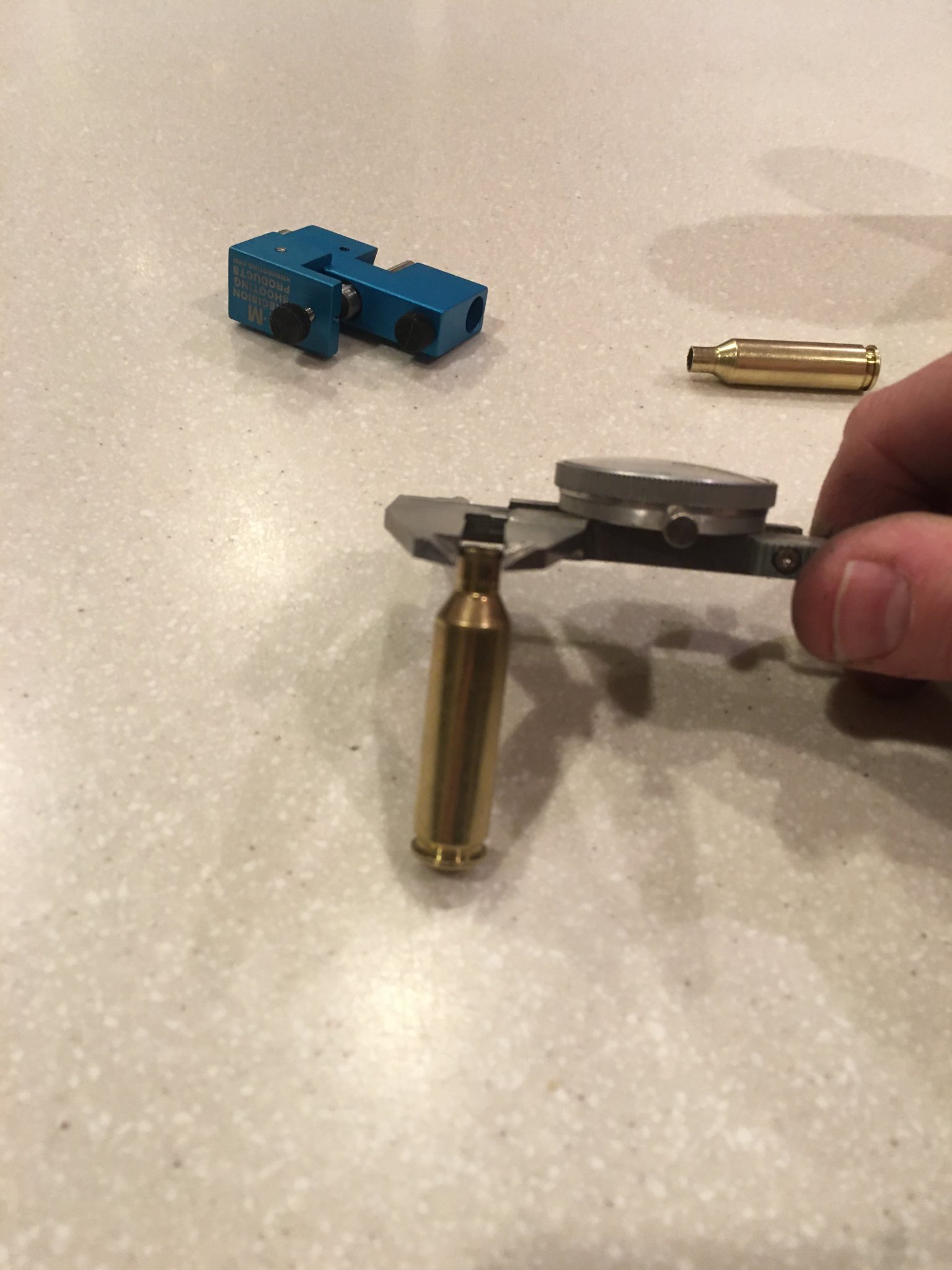

Well the 22 expansion arbor worked like a charm...

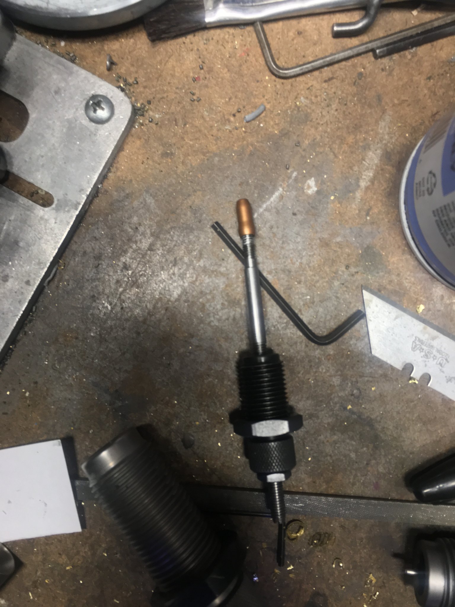

Something to note never assume that you’re reloading dies were assembled, that they were actually done correctly.
I found out why my cases didn’t turn straight when I was turning them on the case turner.... the picture it pretty much explains.. not sure if this is done in an automatic machine or if it’s done there by somebody manually either way they screwed up and either I’ll send it to the factory or send back
The threads are toast

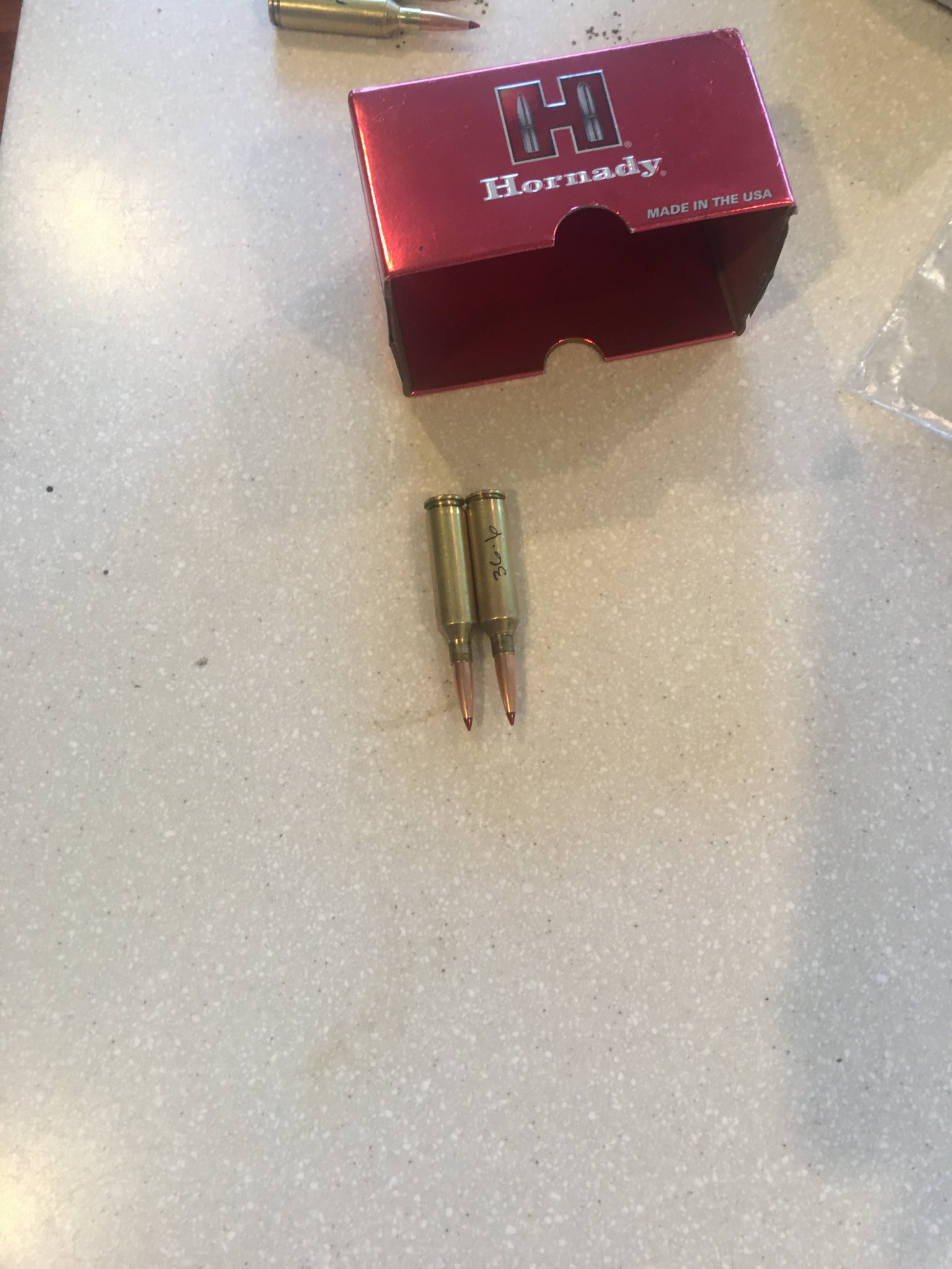

Tried 64 grain game changers and 88eld’s.
Loaded with big game a SW long rifle.
Both showed heavy brass swiping aroun 38-40 grains for both bullets.
I am testing today with big game only with reduced loads.
I may have a very tight chamber?
I used magnum primers. My Krono battery was dead .
All of the bullets made it down range and very accurate. don’t want to kill the brass w/o knowing the velocities.

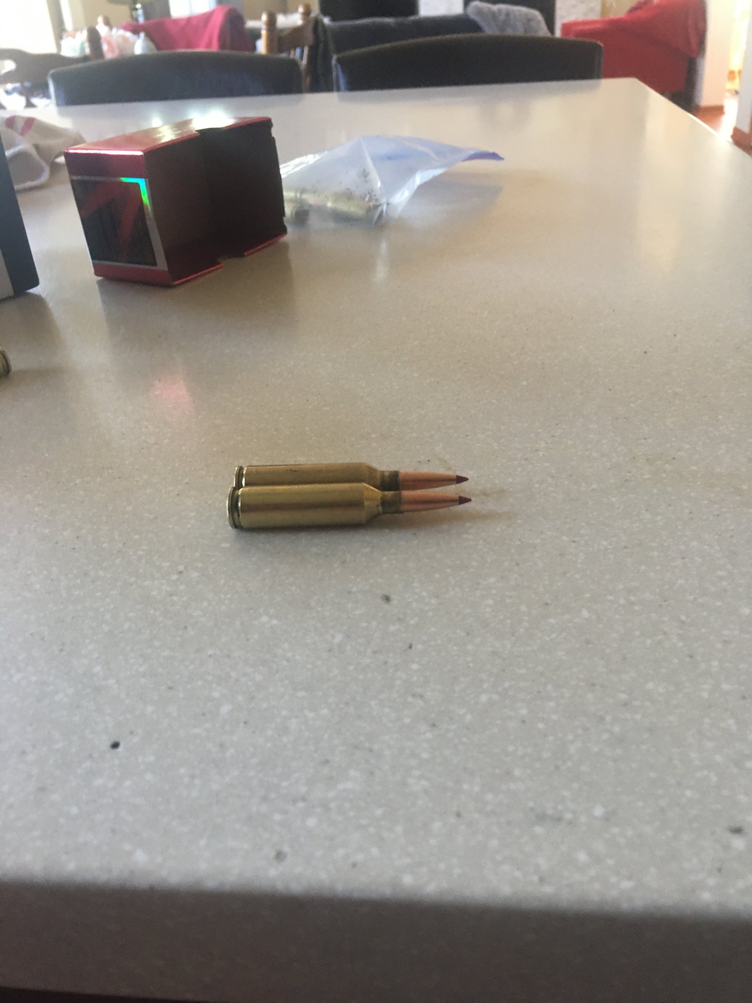

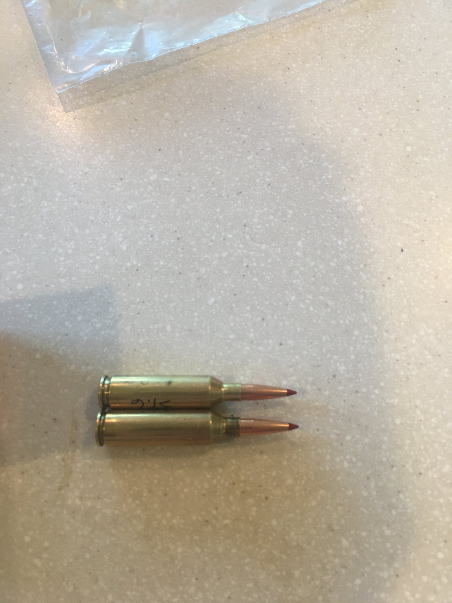

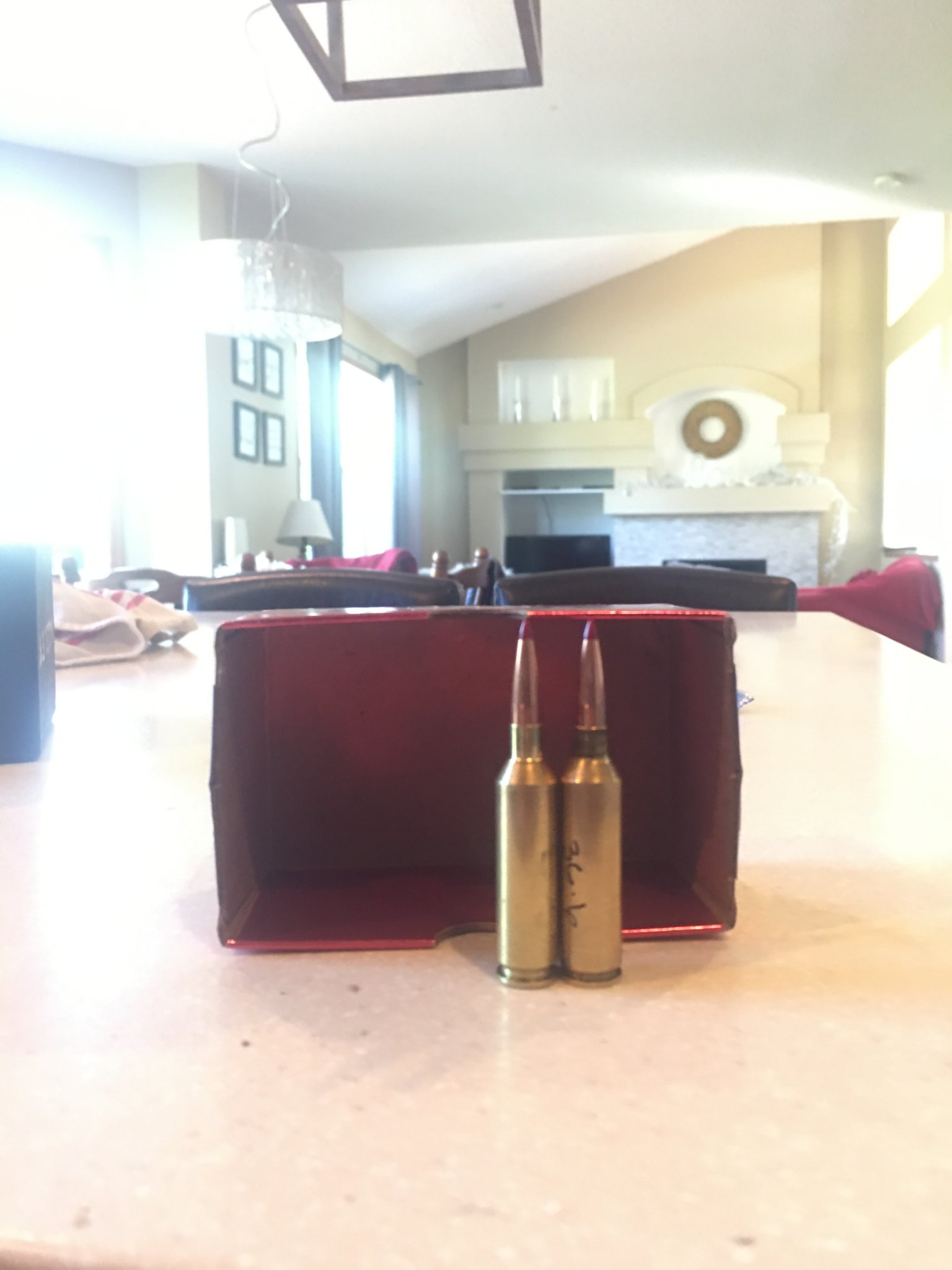

For those that have questions about fire forming 22-250 for 22 creedmoor: Or loading it up for your normal 22-250 and throw it in with your 22 CM ammo and let it rip (that by accident) either way you decide to do it ..survived and turned out just fine. And I think accuracy was of no issue.
I included pictures: the first 2 Picts are unfired 6 mm neck down to 22 next to the fired formed 22-250 federal. (Note the dirty neck on the fired case)
The other pictures: 22-250 FF and reloaded , next to a 22 CM necked down and turned, 1-fired, and reloaded case..
22-250 FF case is slightly shorter
Tried to be as detailed as possible hopefully not boring you.
in hindsight it’s possible that I did not need to turn the donut out of the case as it seems that loading these bullets are not seated to the point where it touches the donut.. I did not take any chances, as I figured the gas gun would be sensitive to pressures anyway.
btw. This 2 gen old iPhone can not do close up shots to save its life and my SLR took a crash landing when walking around some Mayan temples.. my mama should’ve told me not to wear flip-flops.
you’ll just have to click on it and zoom in and you should be able to see the detail
