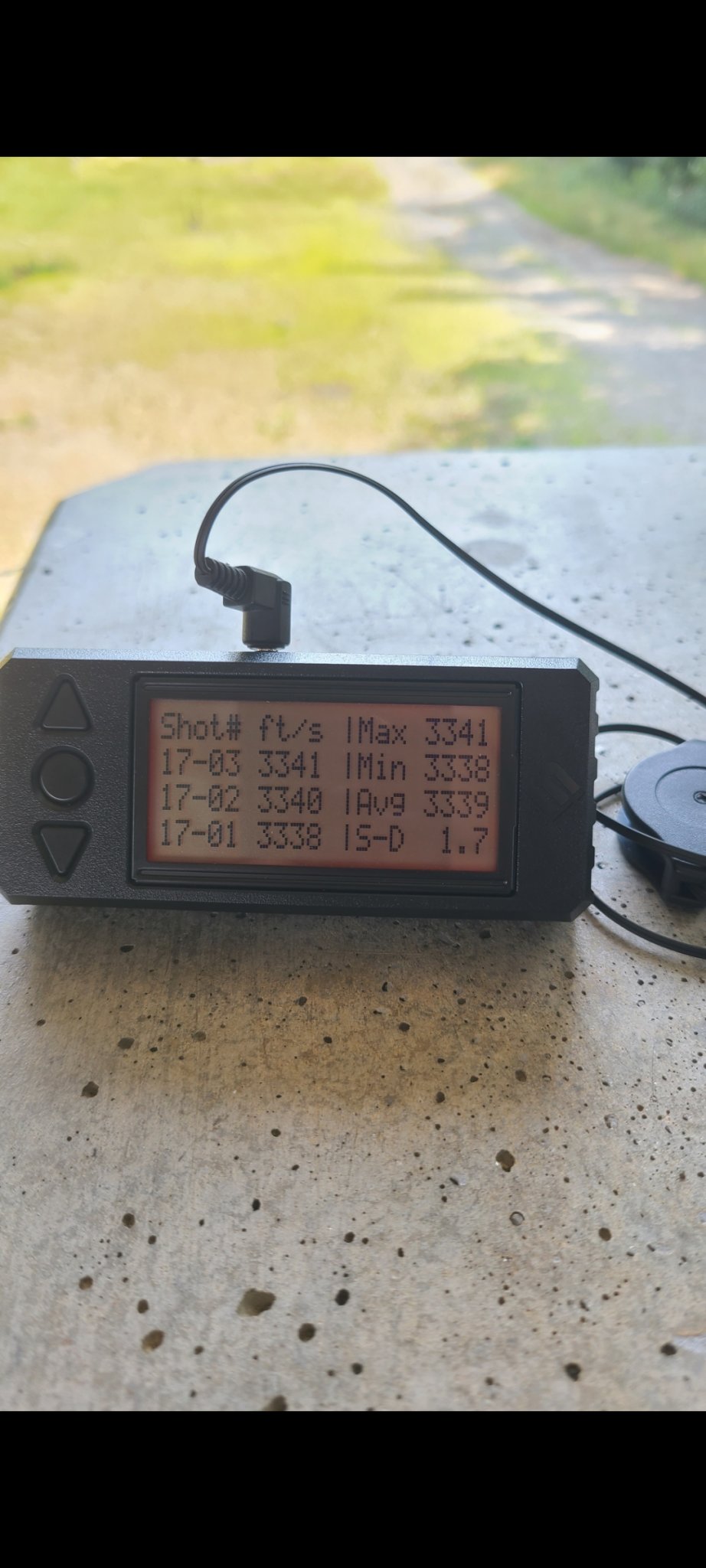

80.5 Berger fullbore
40.2 gr h4350
3339 fps
6mm peterson necked down.
24" 1/7 twist Rock Creek
