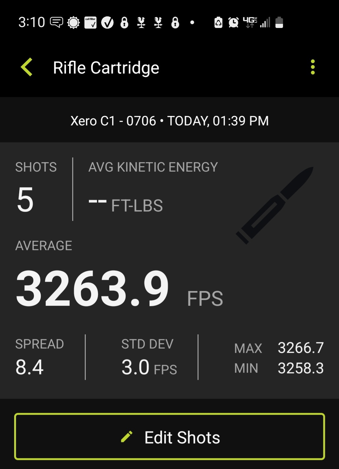

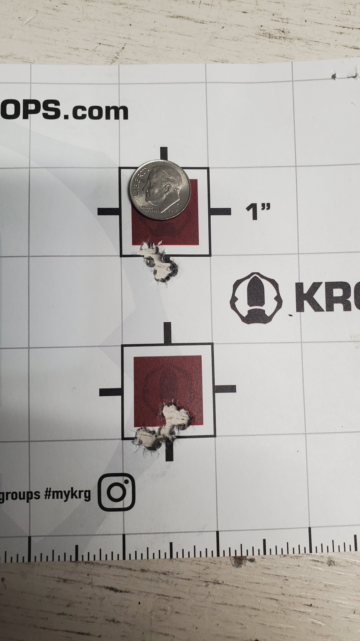

Found a couple powder charges with the 85.5gr that seem to work, 3205(bottom 5) and 3235(top 5). Felt a few in bottom group break high and right, scope is farther back than optimal for prone shooting and felt a bit scrunched up.
On a side note, has anyone saw or dealt with a first shot faster than rest in string? For some reason, irregardless of powder charge, the first rd in every 85.5gr load is 35-45fps faster. Confirmed with magnetospeed and Garmin. Switch to different bullet and it's normal. Rd Robin between 85.5 and 95smk strings and first rd of 85.5 was fast, normal speed on 95smk. Any ideas? I don't think it can be barrel or loading technique as it's consistently first rd and always/only with 85.5s.

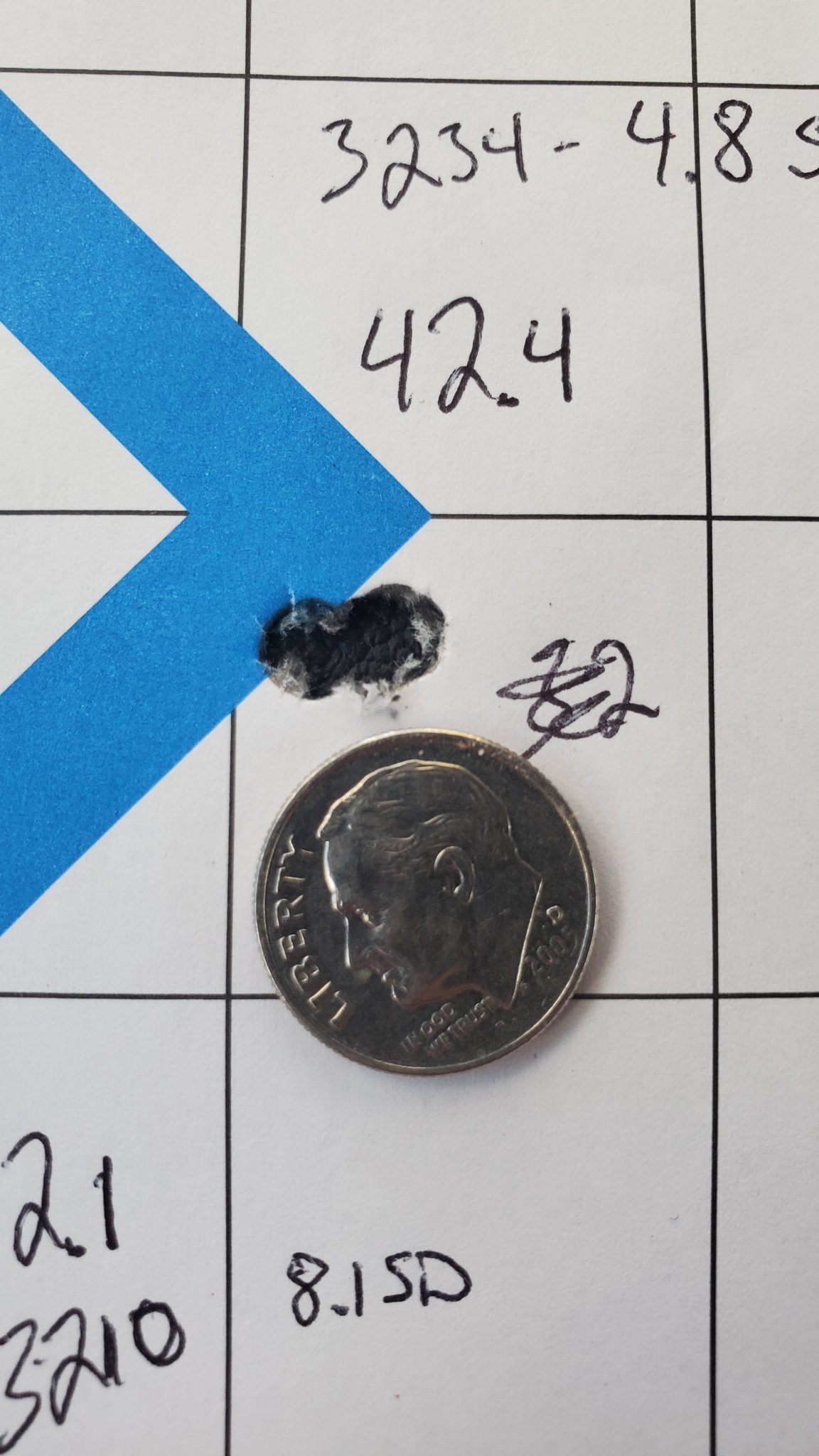

My barrel sped up about 80fps and the solid load was now making faint ejector marks on a few pieces of brass. Slowed back to 3234fps Ave with a 4.8sd over 10rds. Here's the 5rds on paper, the other 5 were on steel, downrange.
Peterson srp, cci450, 42.4fr h4831sc, 90gr vld .010off in a 24" 7tw criterion.

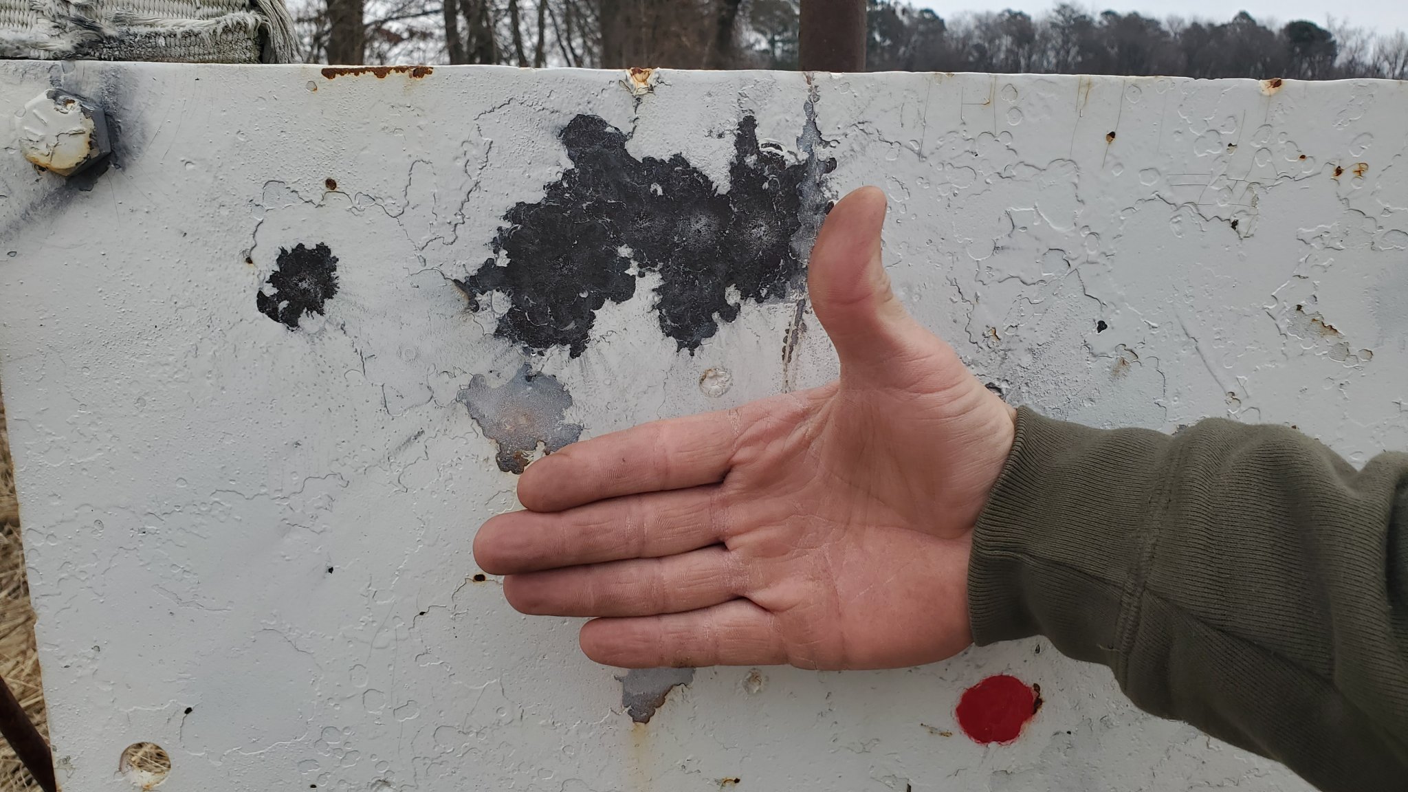

I thought I'd try a 22creed, seems like a neat rd. Nuke 2.0 action, 26" varm criterion 7tw barrel nut, Peterson srp 22creed brass, cci450, h4831sc and 95smk. Started load testing today with 42.4gr set as max, with plans to go up if primers looked alright. Bullets are set .020 off rifling as a generic starting point. Anywho, 5 powder weights/3rds per weight just to see what it will do. Ground was saturated and bright sun/60° with 4-5mph wind= some mirage and soup to deal with.
Everything was going fine until first rd of the 4th powder charge. Bullet didn't impact as predicted. As I scanned target in that area, I then saw a large rip 4" low and 3-4"left of aiming point. I shot the next 2 rds and they landed as predicted. Shot the 5th charge weight and those rds performed as expected.
Has anyone saw or heard issues with 95smk? I generally assume keyholes are too slow fps/too slow twist. I had no issue at slower/lower powder charges. Barrel was allowed to cool to ambient before string. Got any ideas?
I’ve ran into a similar issue. I have a 7 twist criterion pre fit and I wanted to run the 95 smk and I did but with the occasional issue that got more common as the barrel wore. So I switched to the 90 smk and and I ran great for awhile at 3280fps until I had some start hitting sideways or huge poi shift. I talked to Sierra and they said the 95 smk was designed for long 223 barrels with max velocity of 2900 fps and the 90 smk was designed for the 224 valkery again 2900 or less. He said with the thin jackets you are more likely to see issues as the throat begins to fire crack. This is on point from what I saw.
95gr SMK’s at 3080fps got me my first ever top 5 finish in a PRS match last Saturday. I could hear the RO’s while I was shooting saying “that thing is a laser beam”.

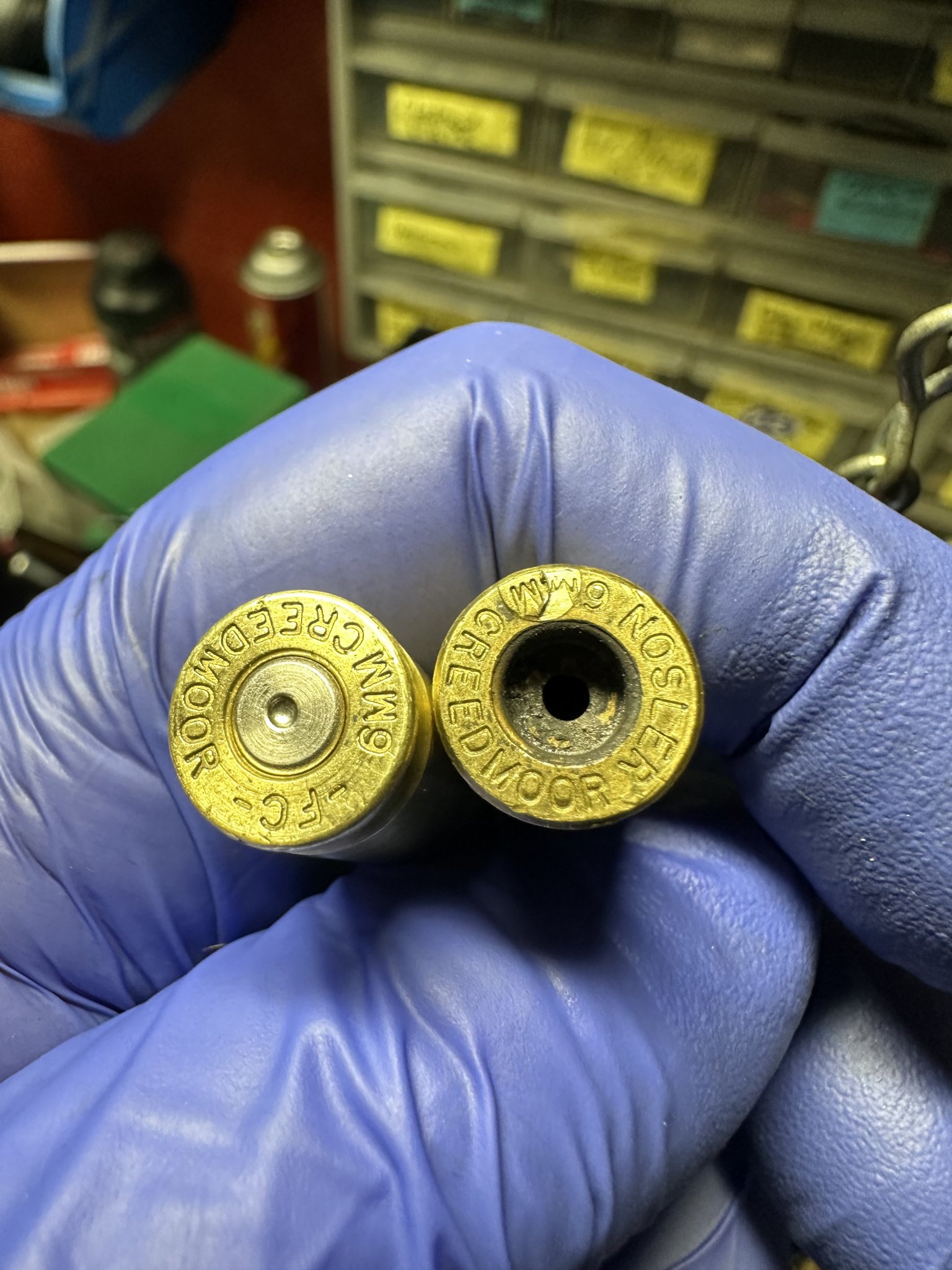

Pederson data shows 43grains of H 4350 running a 80 grain bullets to be way over pressure.am I missing something? I just had a 22 CM built so just wondering just have to work up I suppose. where did you guys start say 41 grains .
Hmmm One of these cases, is not like the other
hey, I got one pop quiz. How do you increase your velocity by 150ft./s without adding any powder super cheap way to increase speed.!!!
NOT…
I wouldn’t max charge any round before you work up to it but hey, do what you want
federal cases are not top quality like Peterson and I’m willing to bet that Peterson would easily take the pressure
I found the main culprit=.
Neck tension= not sure how these were so work hardened but damn couldn’t get them out with a press mounted, collet bullet puller w/o destroying or severely marking the bullet.
A tight reamer /the neck area probably needs a few .00’s than what it has.
all Schilling barrels that I have, that are chambered by Schilling, have a very low thousand space between the neck and the chamber wall . (too bad about the spelling, but I can’t spell it. I’m not going to.)
should have anesled it and maybe even cut a few thousands off the neck
What an interesting learning day I had
Happy I didn’t flame-cut defiance bolt head
I’m sure there’s difference in case volume as well why one was OK and one it wasn’t..
