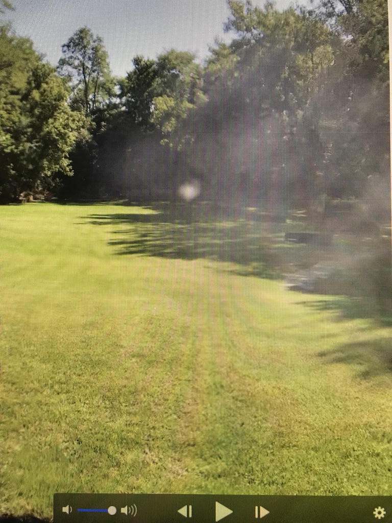

Here is a video of a 90g Berger coming apart.
Video won't load, but here is the stopped frame.
You see the powder and the little white dot, bullet blowing up.

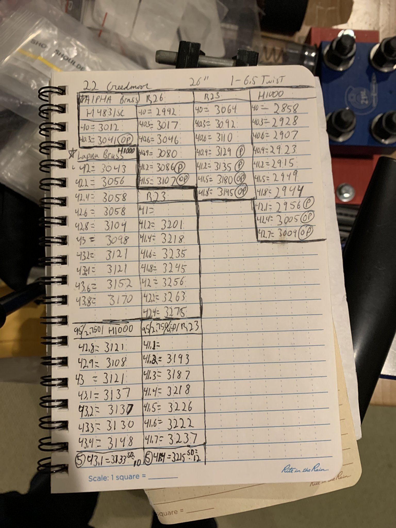

Finnally got to test, mixed emotions an the 7828ssc and H4831ssc . 95SMK shot good but isnt it slow even for a 20" barrel? RL-26 was a little faster. I'm not a speedfreak, love accuracy.

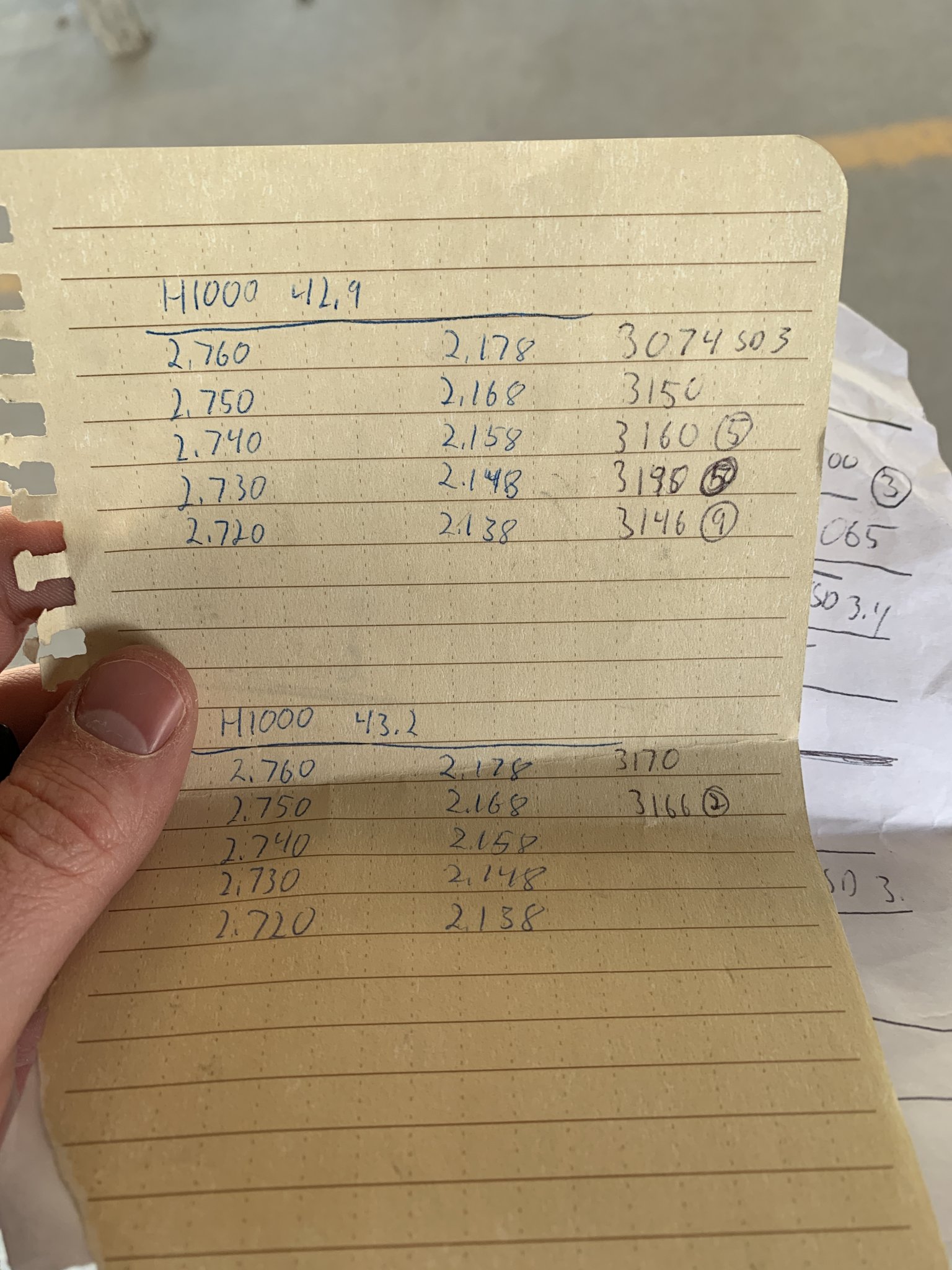

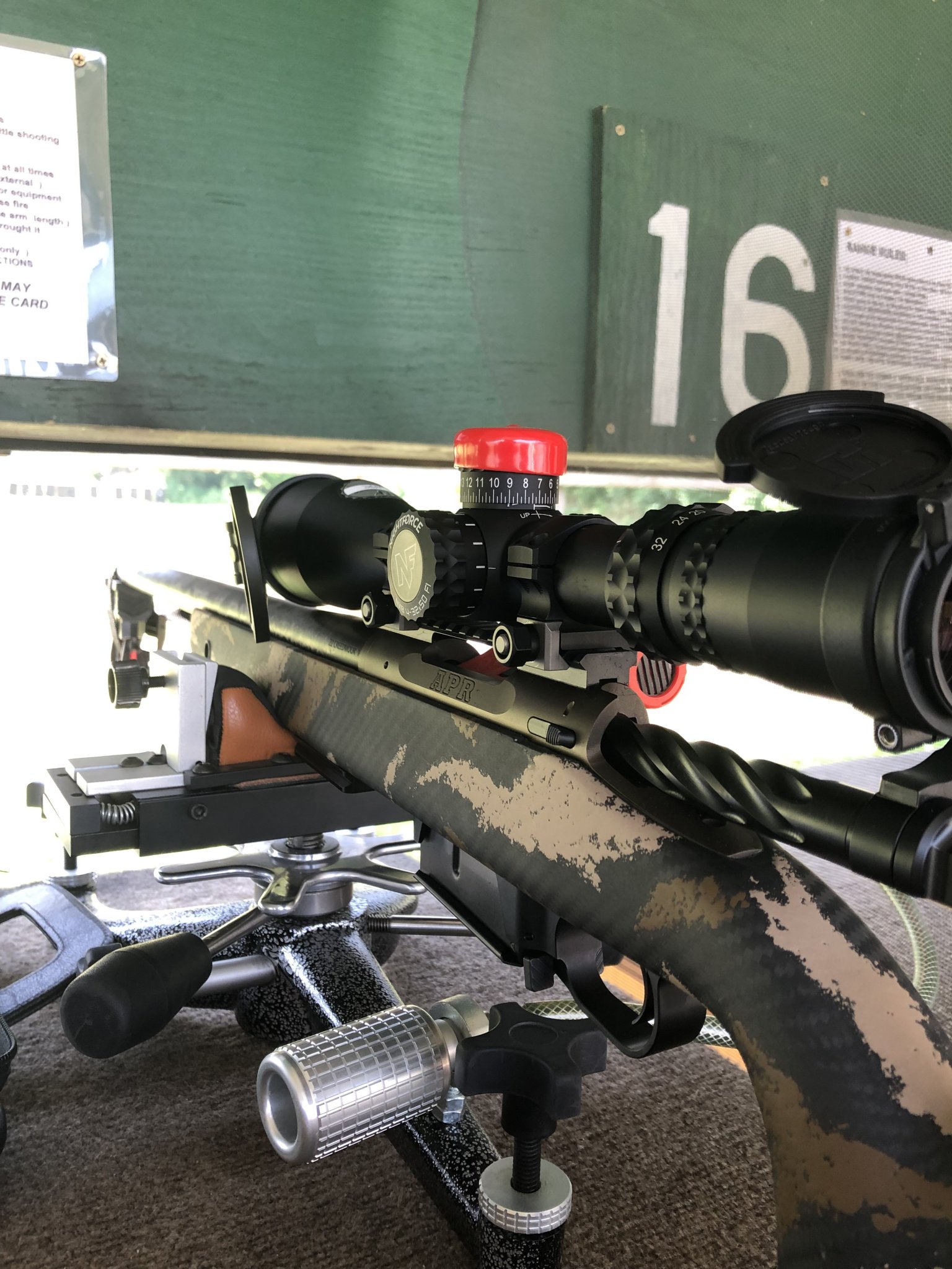

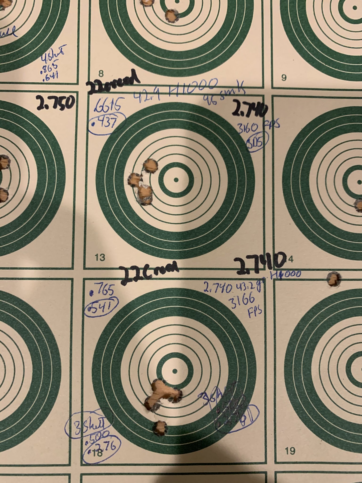

Finished my seating depth test and was happy with the result. I was shooting for 3120 since it’s a 6.5 twist barrel but seems to be working ok

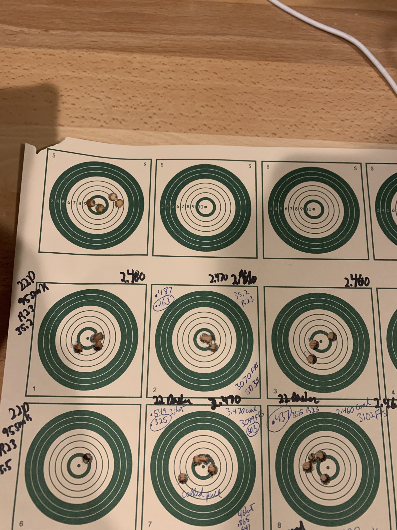

I shot it against my 22 dasher for anyone that’s curious. 6.5 twist as well and both are finished at 26 inches

The case fill on the H4831sc when i hit pressure with the 95smk was maybe 80% case fill so didn't try anything faster
