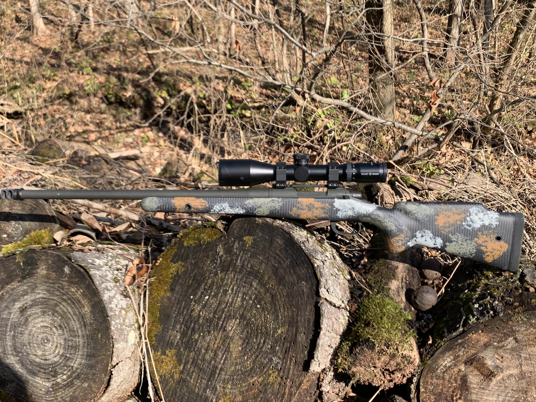

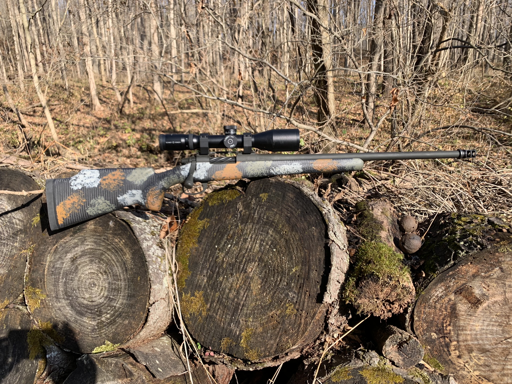

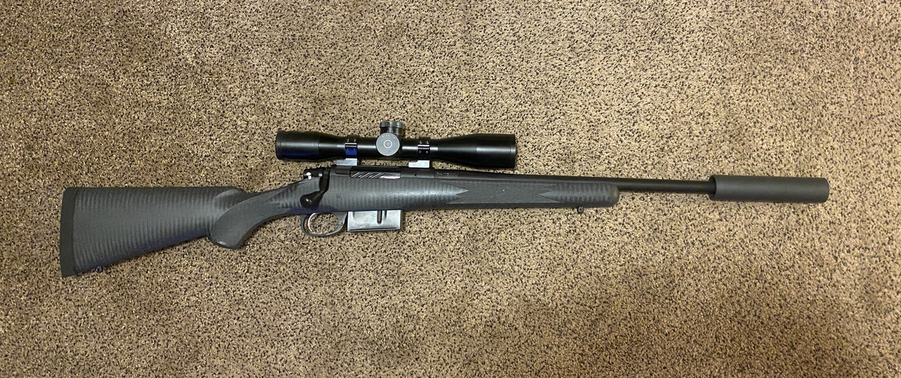

Got a chance to shoot my new rifle. 22 inch CBI barrel with a 1-7 twist.
No load development yet, but fired some Copper Creek 75gr ELDMs and 95gr SMKs.
Less than 20 rounds fired, but zero bullet failures.
The 95s from Copper Creek averaged 2885 fps with an SD of 1.8 (small three shot sample). Sub half MOA group.
Now I'm really looking forward to loading the 95s and 77 gr LRX to their full potential.

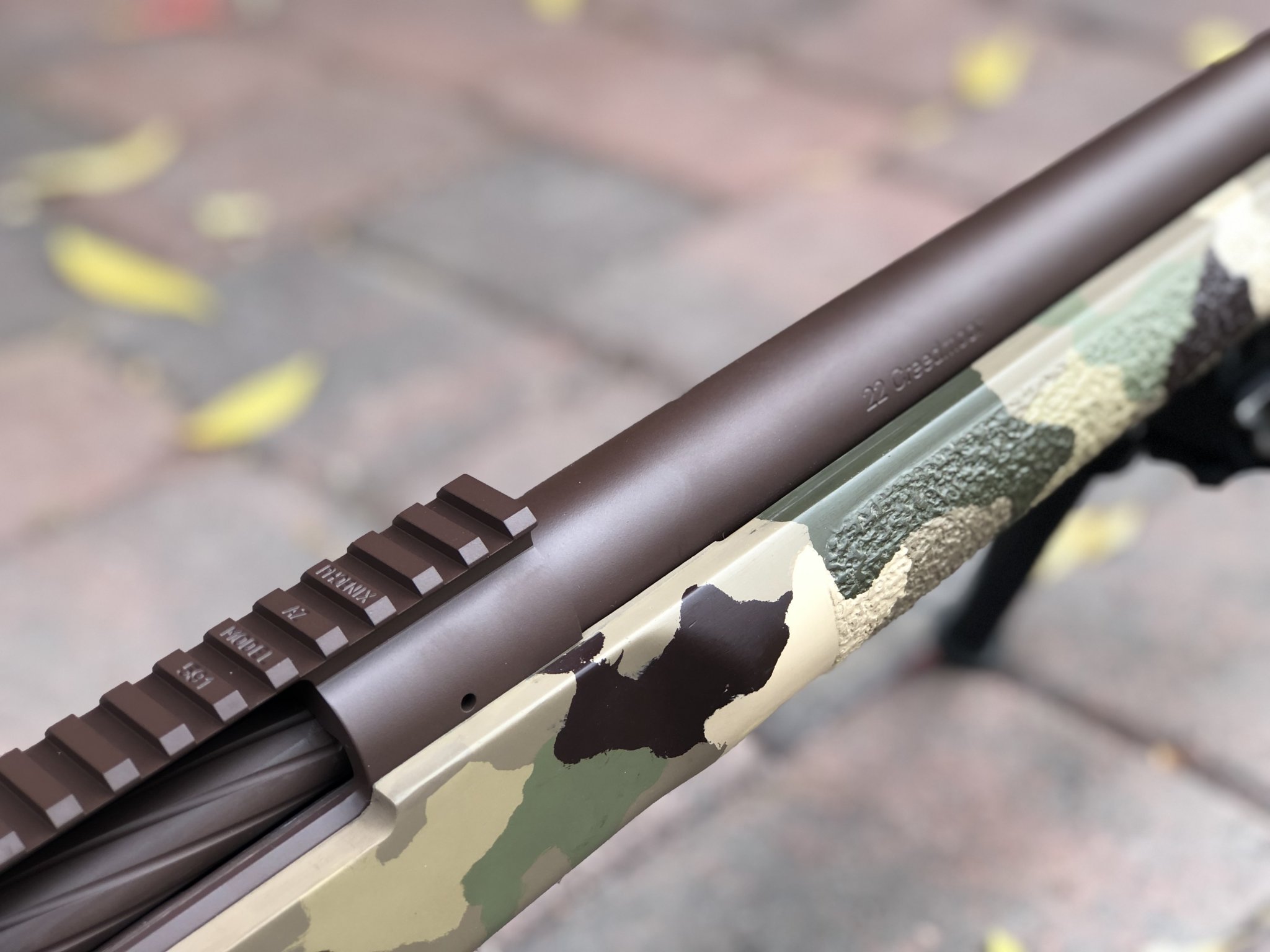

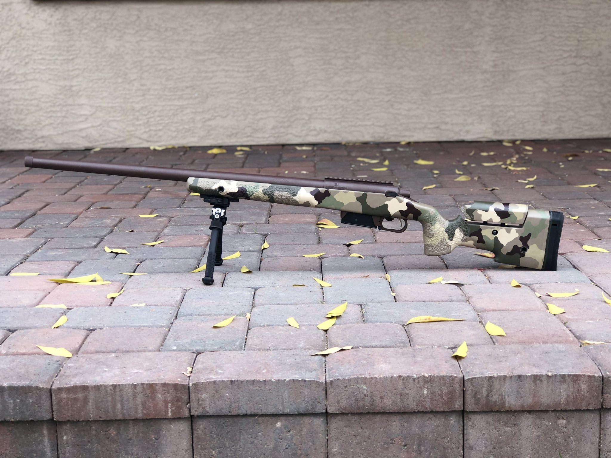

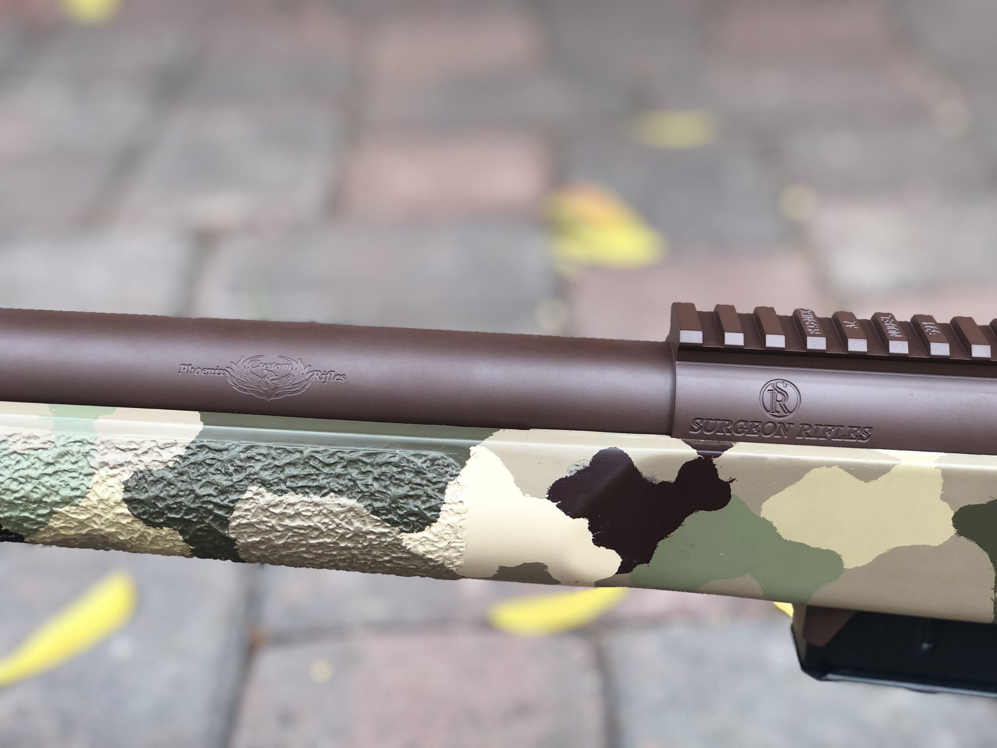

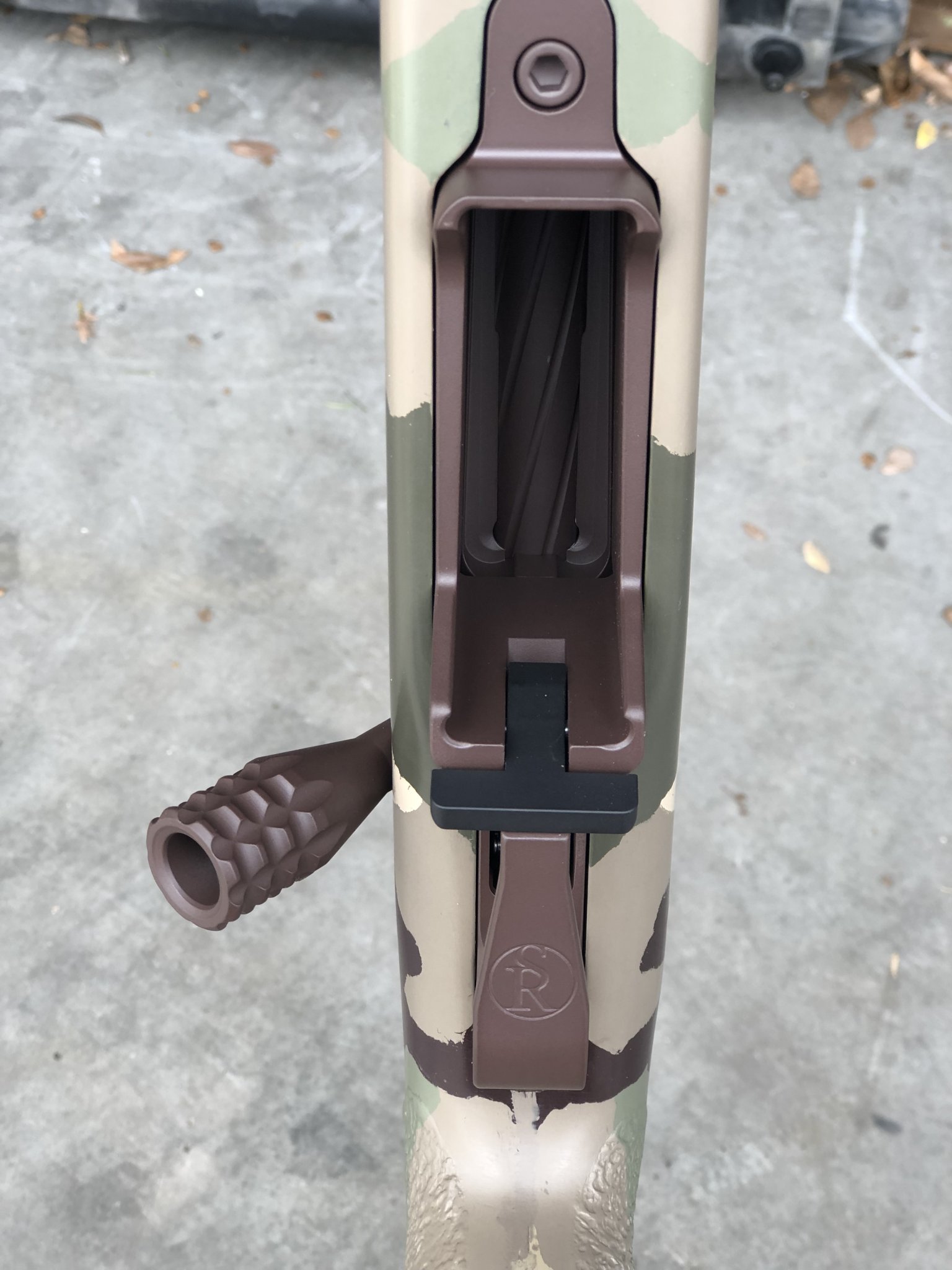

Got my GAP broken in today.
started with 41.0 H4350, Alpha LRP brass and the 75 ELDM at 2.650 COAL.
worked pretty good, just getting started...
GAP Templar V1 sheep hunter port action
manners EH-2
22” Bartlein 3b 8 twist
TBAC CB for my Ultra 7 6.5
APA RTG DBM
S&B PMII 3-12x50
View attachment 7189860View attachment 7189861View attachment 7189862

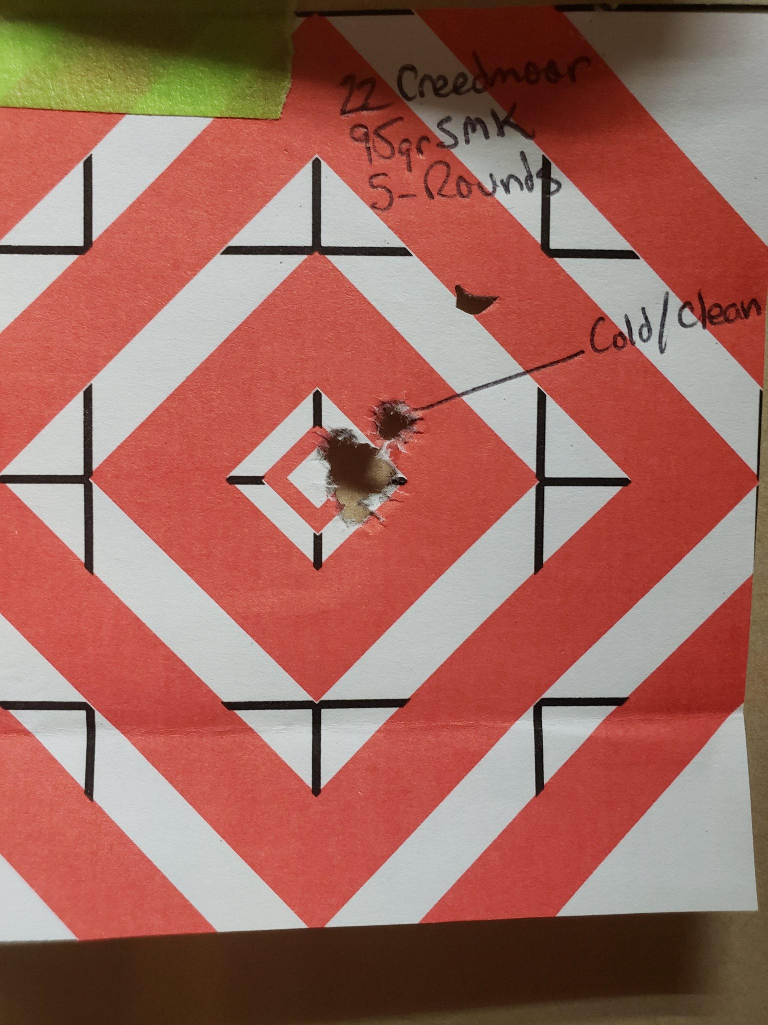

Just got my new barrel and did some ladder tests. Using 6 creedmoor lapua brass and a 95 smk with a coal of 2.750 on a 26 inch barrel. Reloader 23 seems to be the go to powder.

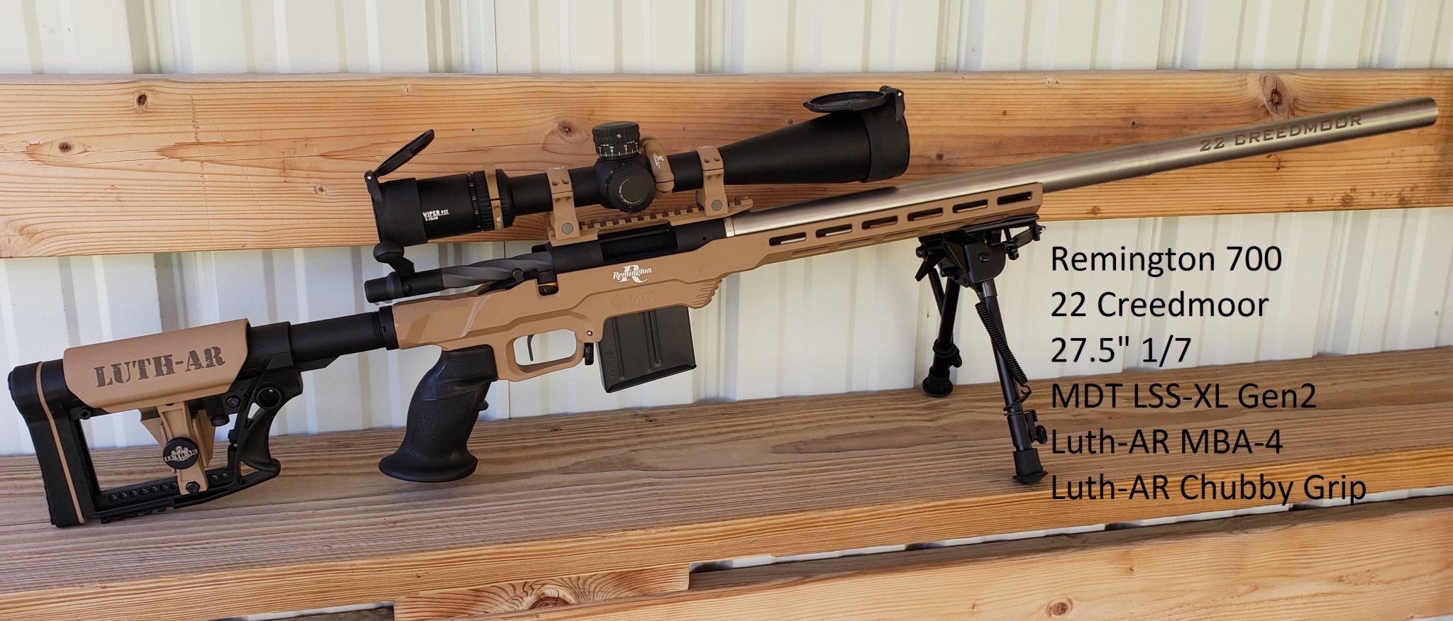

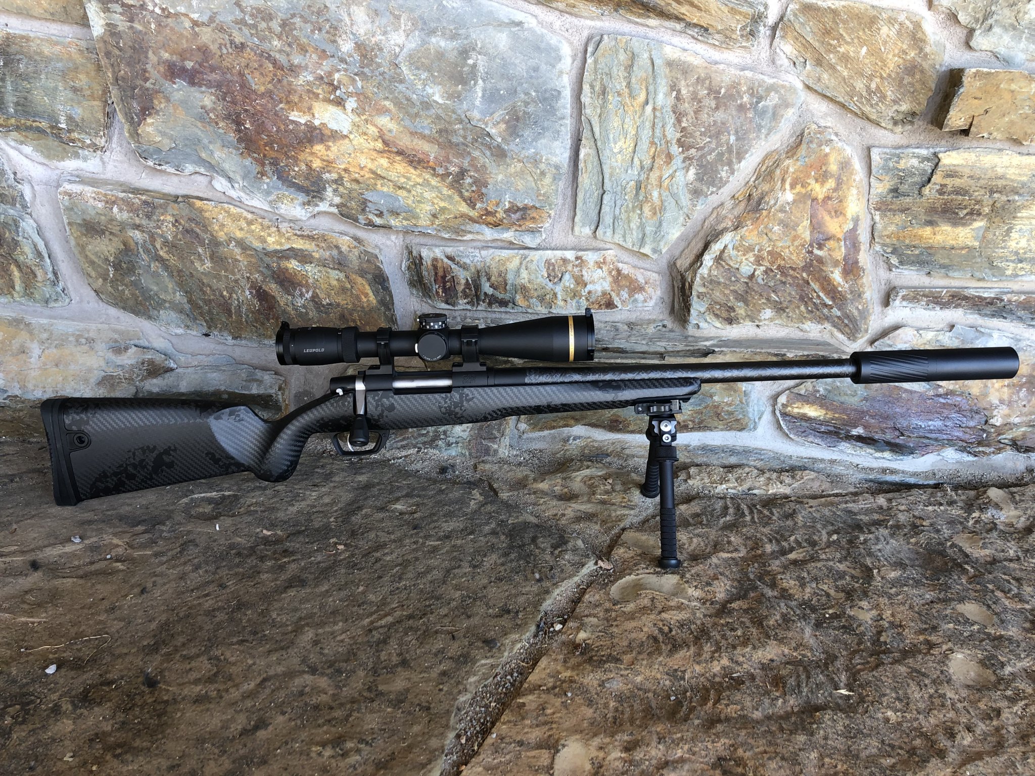

I have been having great luck with my 22CM build. It is a Rem700 SA in an MDT chassis. 27.5" 1/7 twist heavy bull barrel. I've been running the 95gr SMKs at 3125 with no problems at all. The hornady 88gr ELD-Ms shoot almost as well as the SMKs. I'm using H4831SC and Alpha brass for the 95s and resized Hornady 6mm CM brass for the 88s. Both bullets shoot well under .75" with the SMKs regularly shooting .25" at 100 yards. I've shot them both on steel out to just under 1100 yards so far and will try pushing them out to 1500 once the weather warms again in the spring. Fantastic, fun round when fired out of an 18.5 lb rifle!!

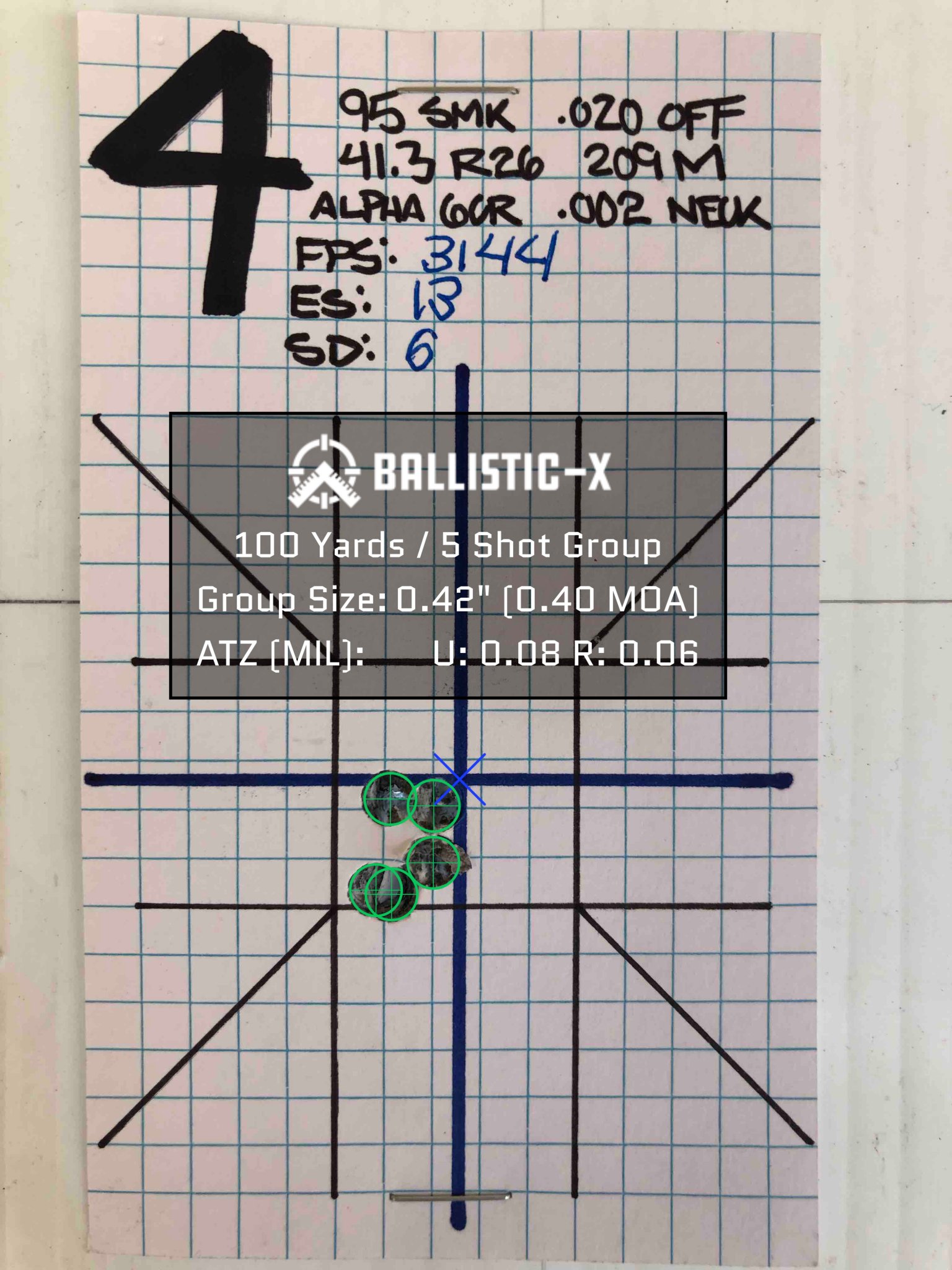

I struggled with consistency for a bit. Barrel has around 600 now, and really settled in. These 3 were the first three rounds loaded to this spec. Barrel had around 500 at the time and only cleaned at 250ish. Only a 3 shot group, but was enough to leave it as is. Vetted to 1070 yds and was spot on. No issues blowing bullets to date.

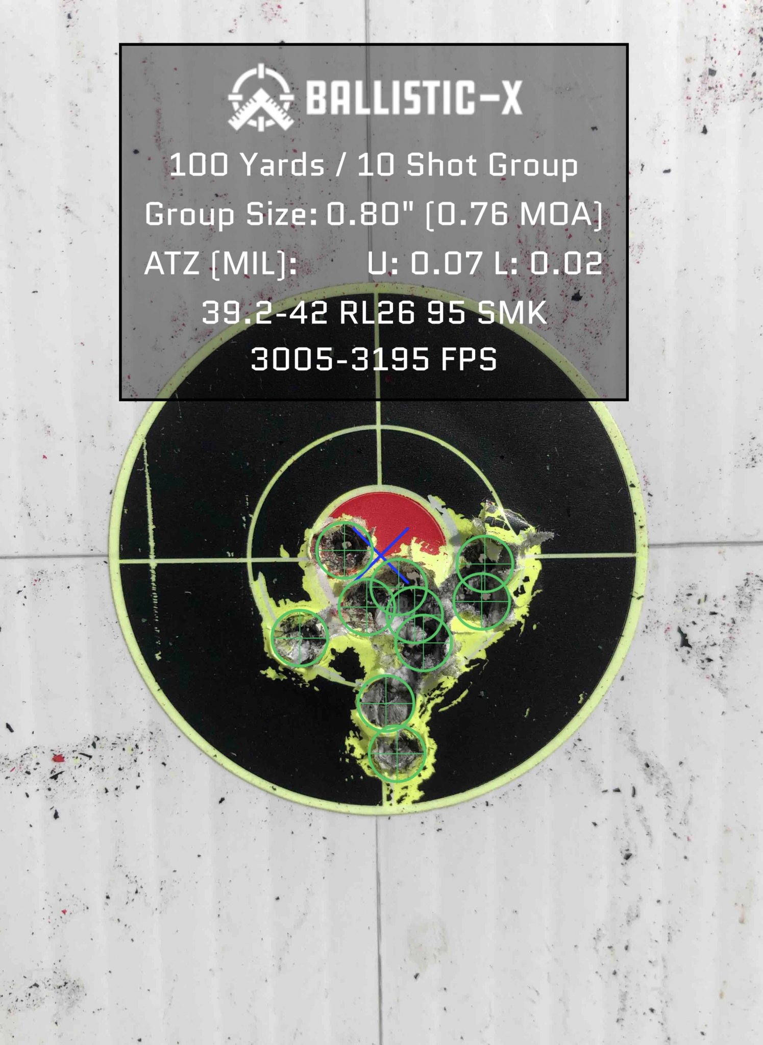

I have been breaking in a barrel and looking for a velocity node. It is a 26” Benchmark and 85.5 Berger Hybrids.
I started with 40.2 of H4350 based on some 90 VLDs I ran in another 22 Creed. I also tried RL26 and H1000; RL26 just didn’t group as well as the H1000 and H4350. Using H4350, I was getting some vertical at the 40.2 which was roughly 3205 FPS. I dropped it down to 39.5 and groups became worse.... so I added more powder and it tightened up. The H1000 was a great little group, but didn’t have the FPS.
I have not found where I would consider “pressure”, but will update when I shoot the next rounds I have loaded up. Will try to go up to 41.1 on H4350 and 45.5 on H1000.... I am at 60 rounds so I suspect the barrel will spread up just in time to start dropping powder back down.
H4350:
40.2... 0.6 MOA 3205 with ES of 19
RL26
42.0... 0.7 MOA 3203 with ES of 14
43.0... 1.2 MOA 3281 with ES 24
H1000
44.0... 0.4 MOA 3146 with ES of 8
Hope this helps!
