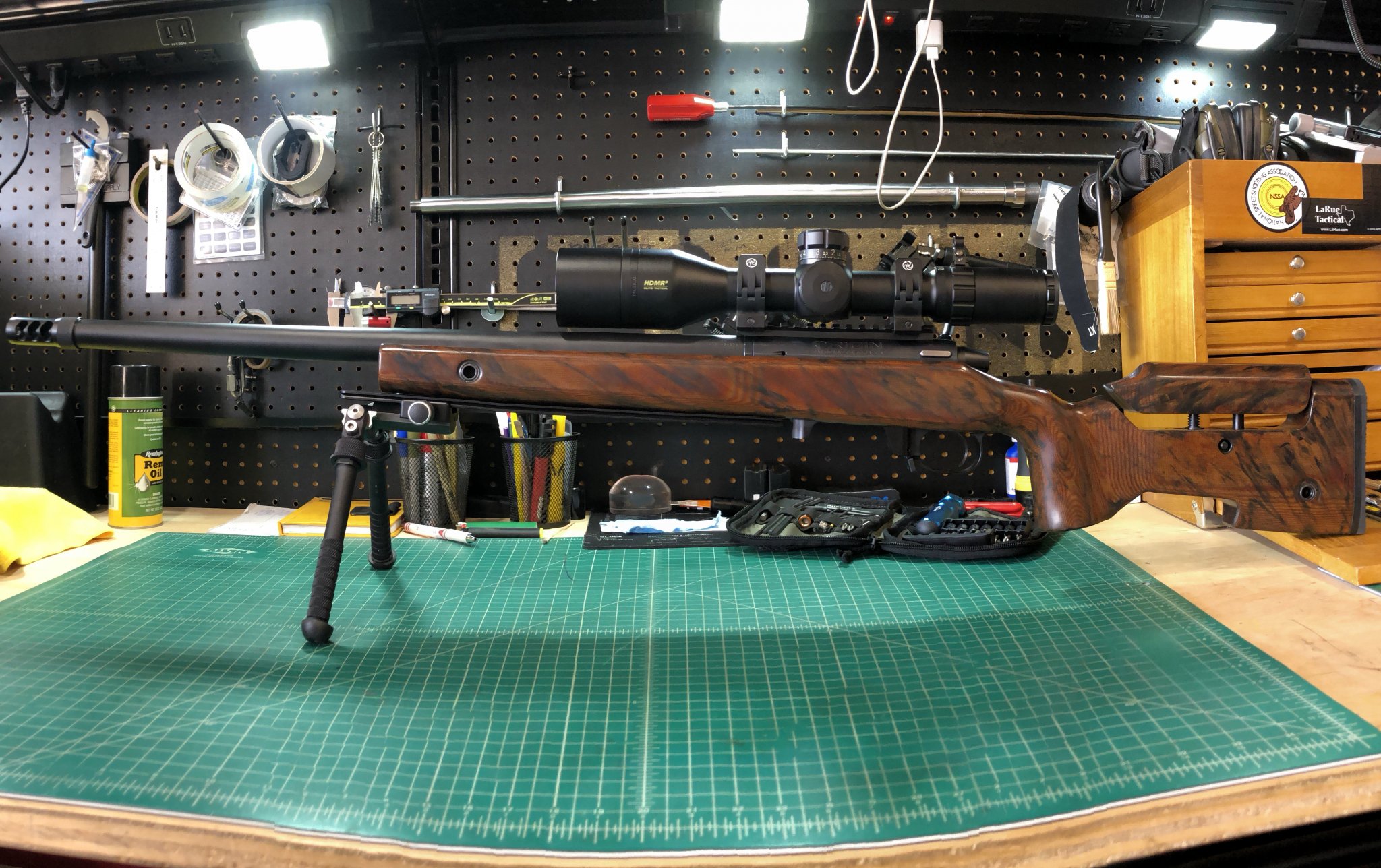

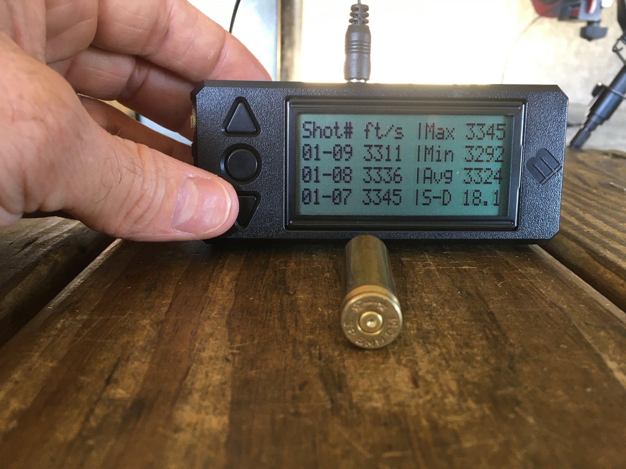

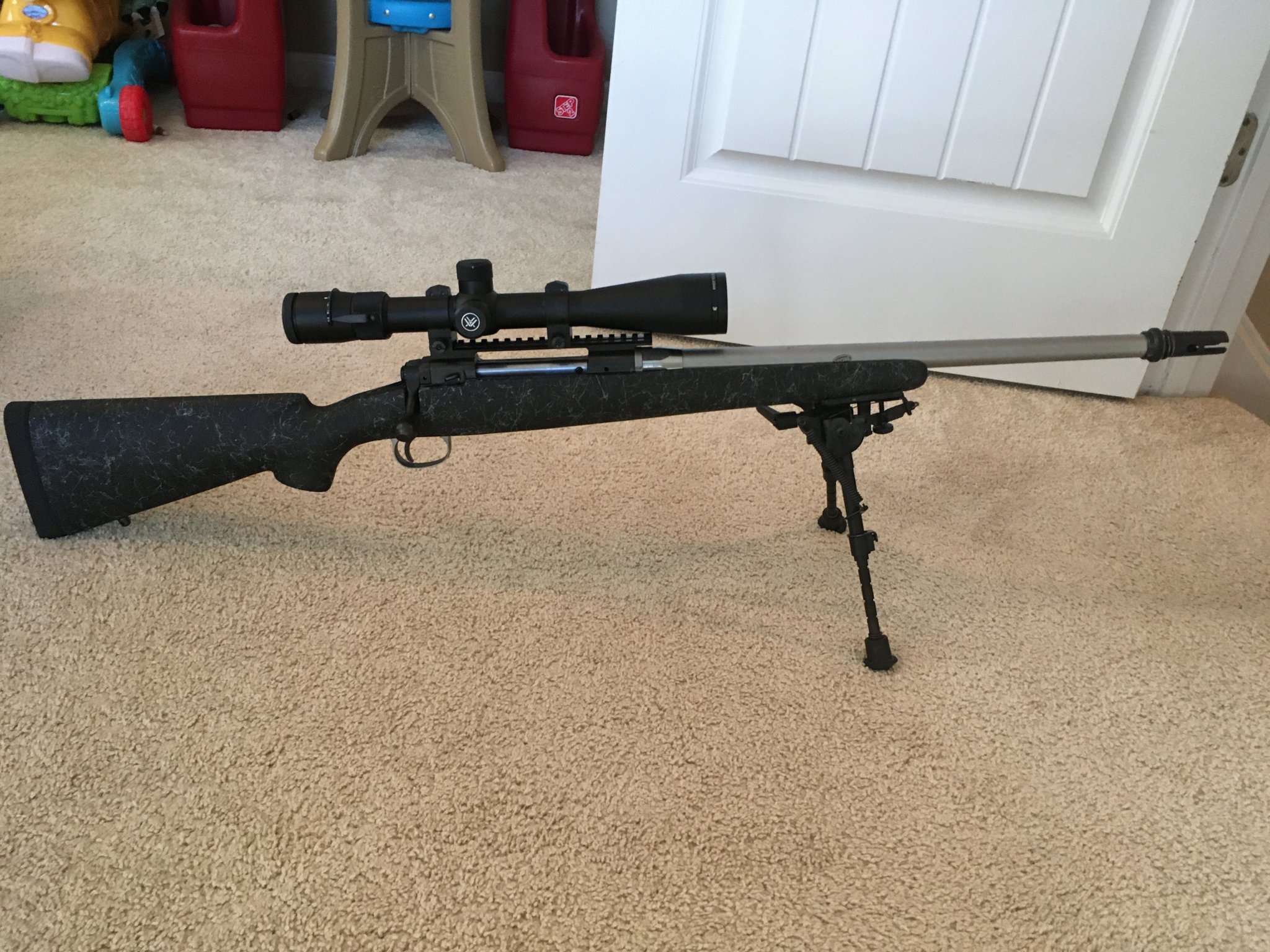

Settling on this. Barnes 78gr TSX over Norma MRP @45.5grs and a CCI #41 primer. The 9 shots on the chrono are the group you see in the picture.
Rifle is a Savage long action in a B&C Medalist that has be trued with PTG hand tools. The barrel is an X-Caliber 8T, 3 groove blank that is an MGM pre-fit at 18”. A buddy gunsmith of mine cut it down to length and threaded the muzzle.

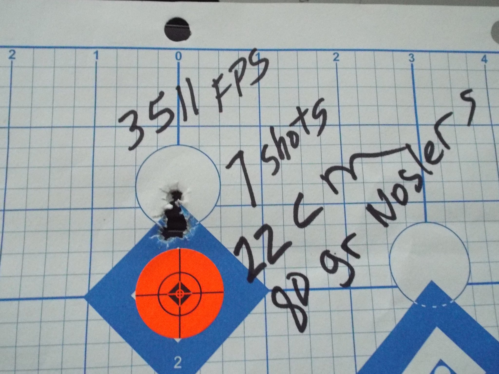

I've got my 22Creedmoor running 80 gr. Nosler CC at a chronographed 3511 fps. Kreiger barrel (1:8) finished at 28".
Thank you sir! That's exactly what i was wanting to verify before I purchased a barrel to have cut for my rifle. That's pretty much exactly the set up I want to run. Which brass, powder and primers are you running? I assume the Accuracy is good since that's the load you settled on. Is that a 4 groove Krieger?
Lapua brass-CCI BR primers-H-4350 41.0 grs.

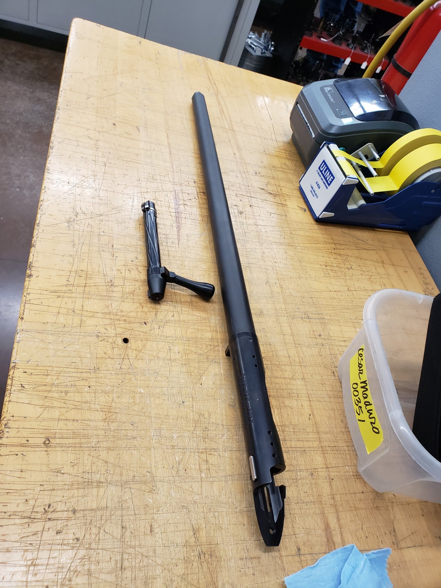

I just spun on a 6.5 twist so I’ll let you know how it goes but with the 7 twist I just took of I took the 95smk up to 3350 with R26 and didn’t see jacket separation. The 88 eld blew up on me at around 3100. Where did you start to see jacket issues with the 95 smk? And was it just on occasion or every shoot. I went up to 43 grains of R26 and had great luck with them in the 3100-3150 using 42.8 H1000.
Didn’t clean the barrel for 400 rounds and had a carbon ring that ended up spiking speeds by 100 FPS and caused jacket separation every shot
