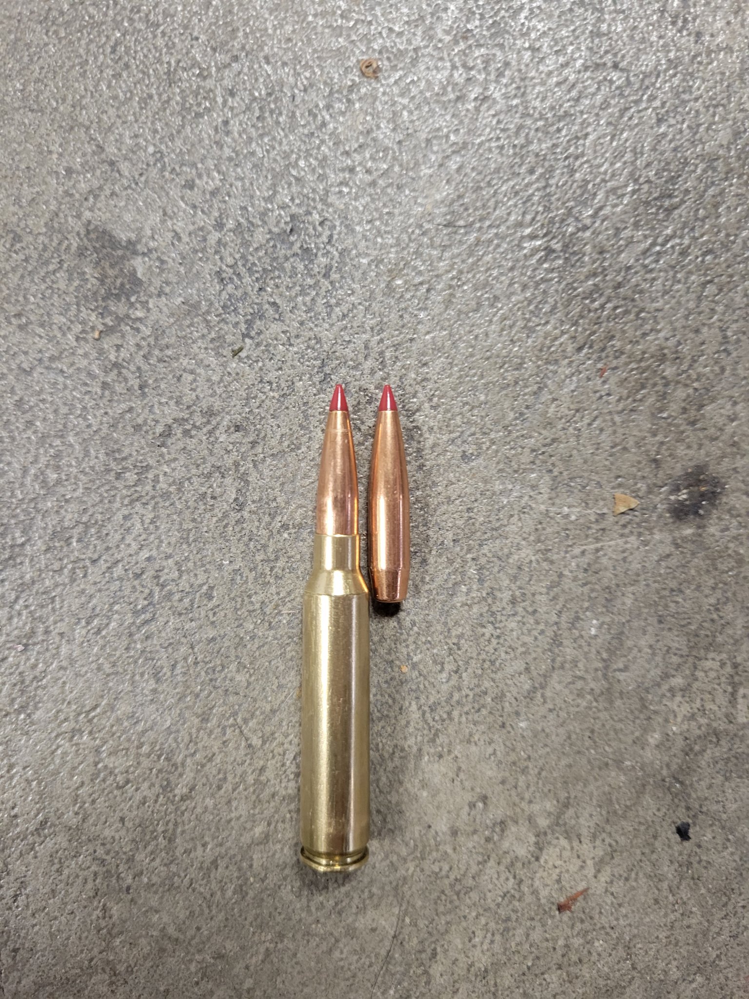

Anyone have an opinion on my coal for the 80 eld?
If it's still tight chambering at the 2.530" then I would back it off a little more. The ELDs don't mind a jump so I don't think it would hurt accuracy but might be safer. How much of the bullet is in the case at the 2.530" OAL?
This is 2.530. Maybe I'll go 2.500 and see how it shoots.
That looks good for bullet in case but I have never been one to jam into the lands. You getting any marks on the bullets at 2.530" after chambering and extracting?
Not that I can see but I'll have to mess with it more. I think most of the feeling I'm getting is just cock on close.
Could be. Try some at the 2.500" and see how they work. Just so you know.

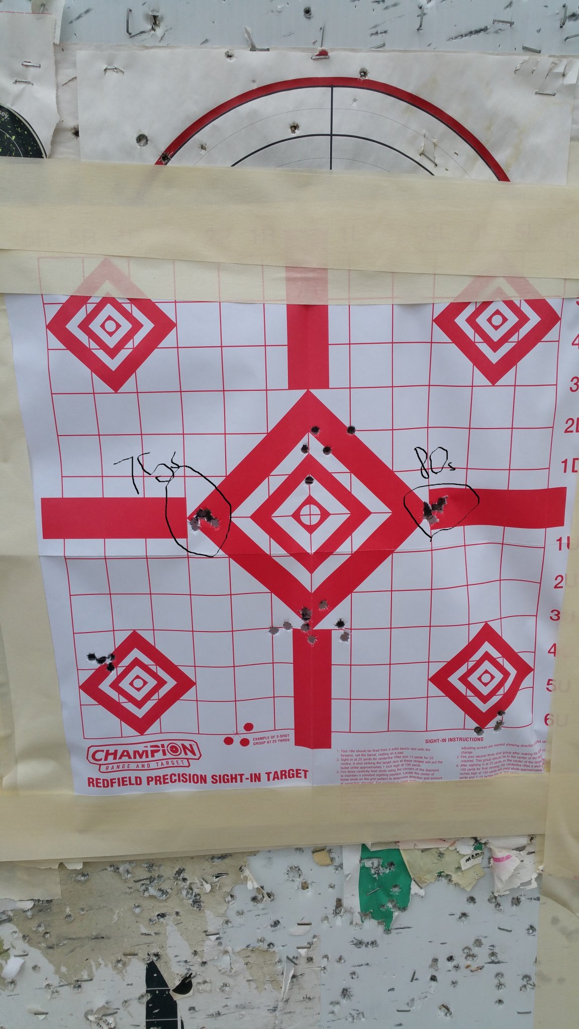

Are you sure your bumping the shoulder enough? Ive been messing with the 80s, have some 75s to try next. You really need to get the 80s and especially the 88s going fairly fast to be worth shooting in a 223. Hard to beat that 75. Ive been shooting the 80s at some 600y high power. Right around 3050ish maybe more with a 26" barrel. Still experimenting but what I am reading online is they like a good amount of jump. Even around .050" some say. I think I'm jumping mine about .030 I have to check though. I loaded 10 rounds each 75 and 80 ELD with an increasing charge weight of N140, I shot the same point of aim while chronoing and looking for pressure. They made 2 cloverleaf 10 round groups despite being different charges.
The other horrible groups were high charges of CFE223 with hornady 75gr bthps loaded for an AR.
