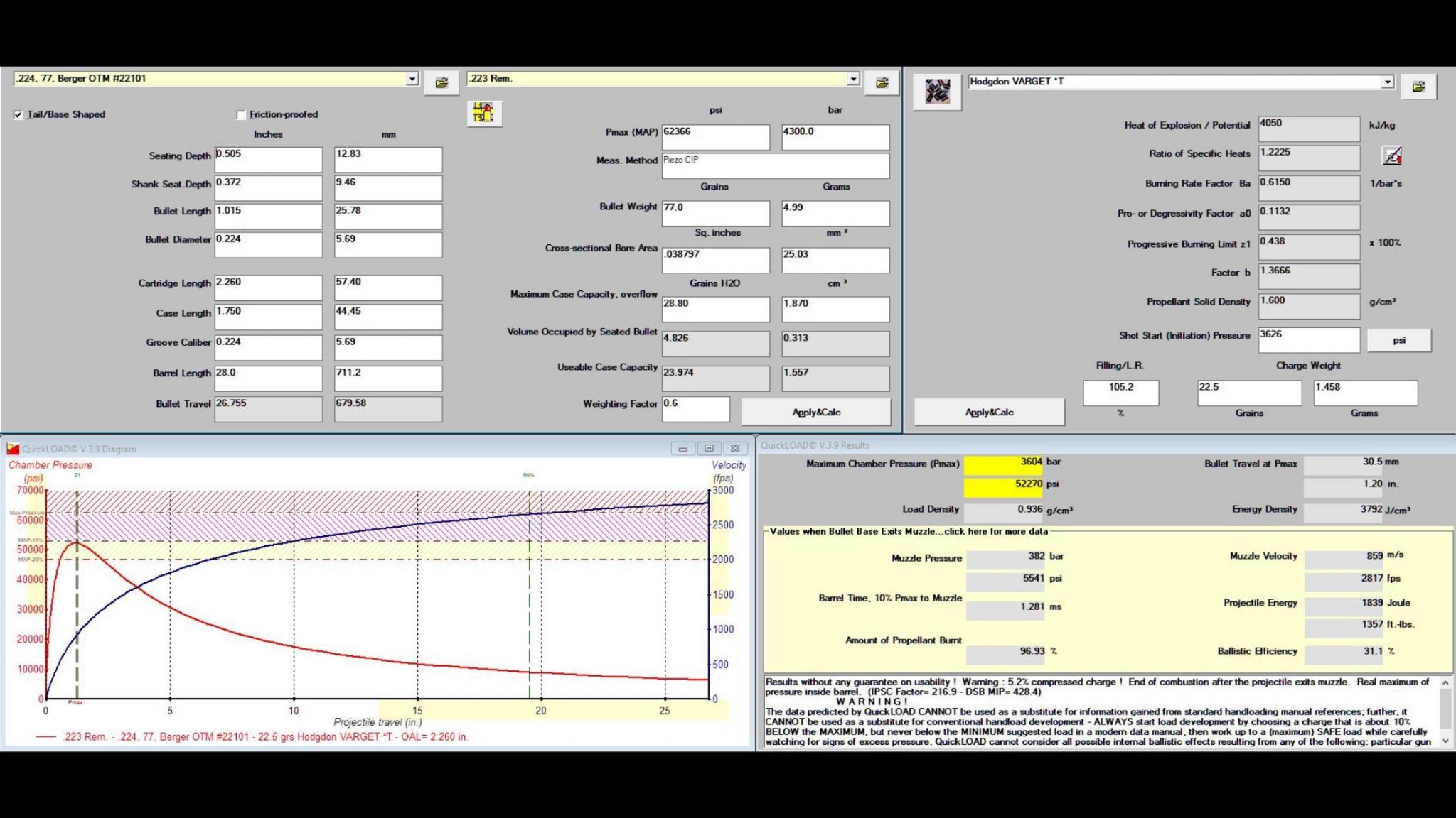

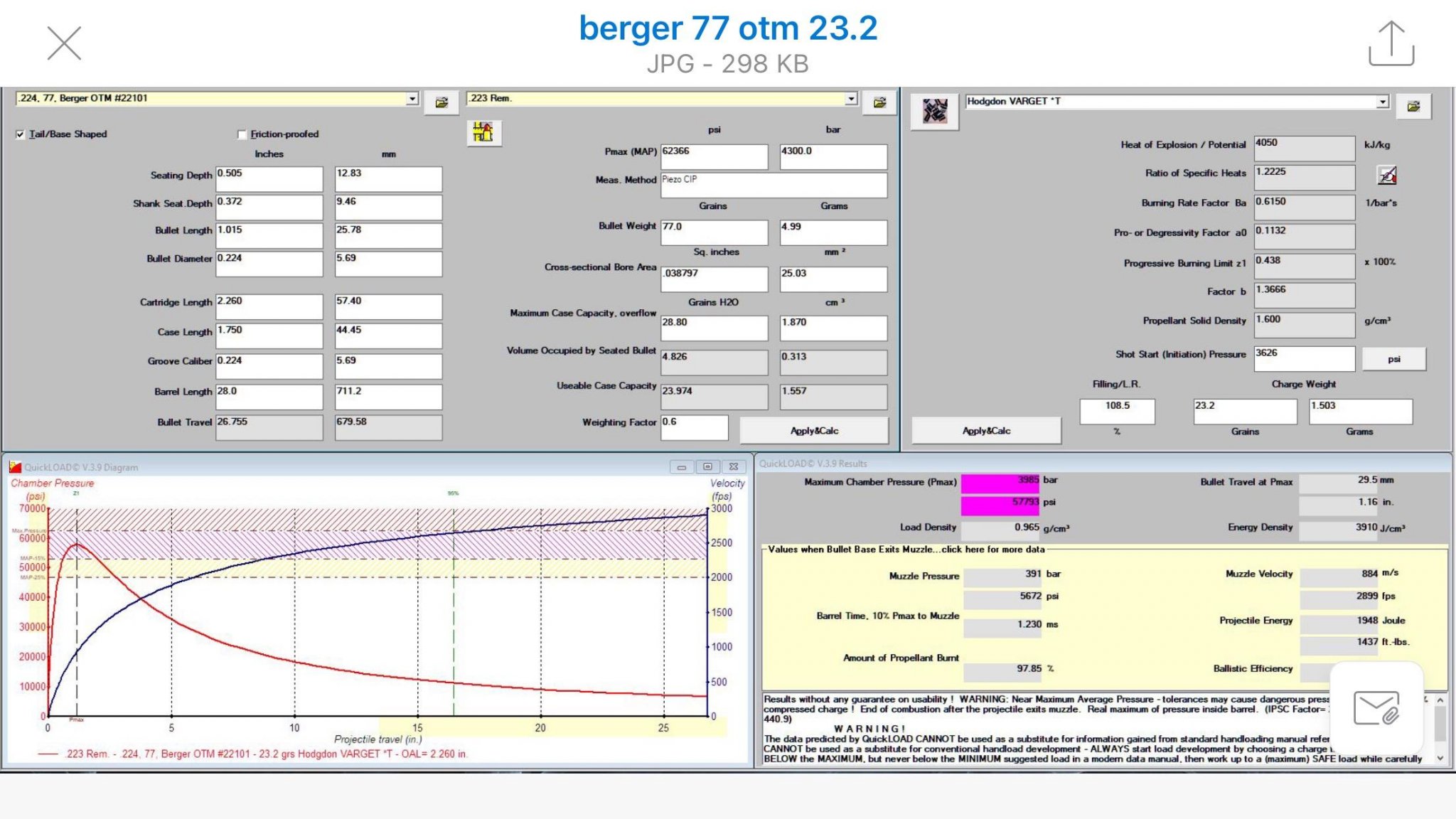

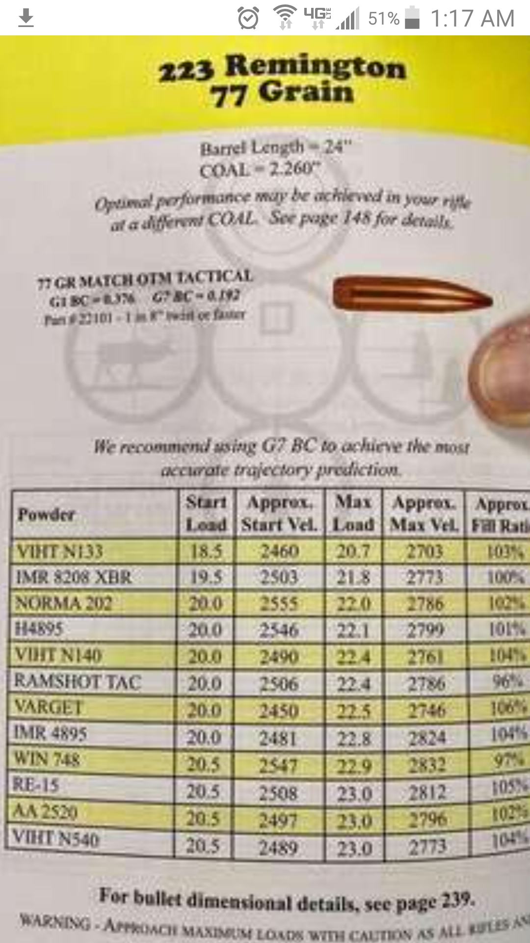

Hey guys, just picked up some Berger 77OTMs to shoot through a 28" 1-7 barrel.
Berger has a max Varget charge listed at 22.5g. Without running it through quickload it seems mighty conservative. May I ask if anyone has any real world input.
Thanks!
Thanks!
22.5 seems awful low. Hodgdon lists 23.7 as the max. Especially if you are loading them longer than SAAMI and adjusted off the ogive jump to lands then you should be able to go higher. Somewhere in here I think I listed my 75 ELD load as around 25.1grns. I worked up to that though with them at .020" off lands.
First run will be plain old "mag length" 2.260. Though I will measure them in the barrel to see jam length.
Thanks!
Seems light. Ran Varget At 23.7 with a 90 vld with no pressure in mixed LC brass.
