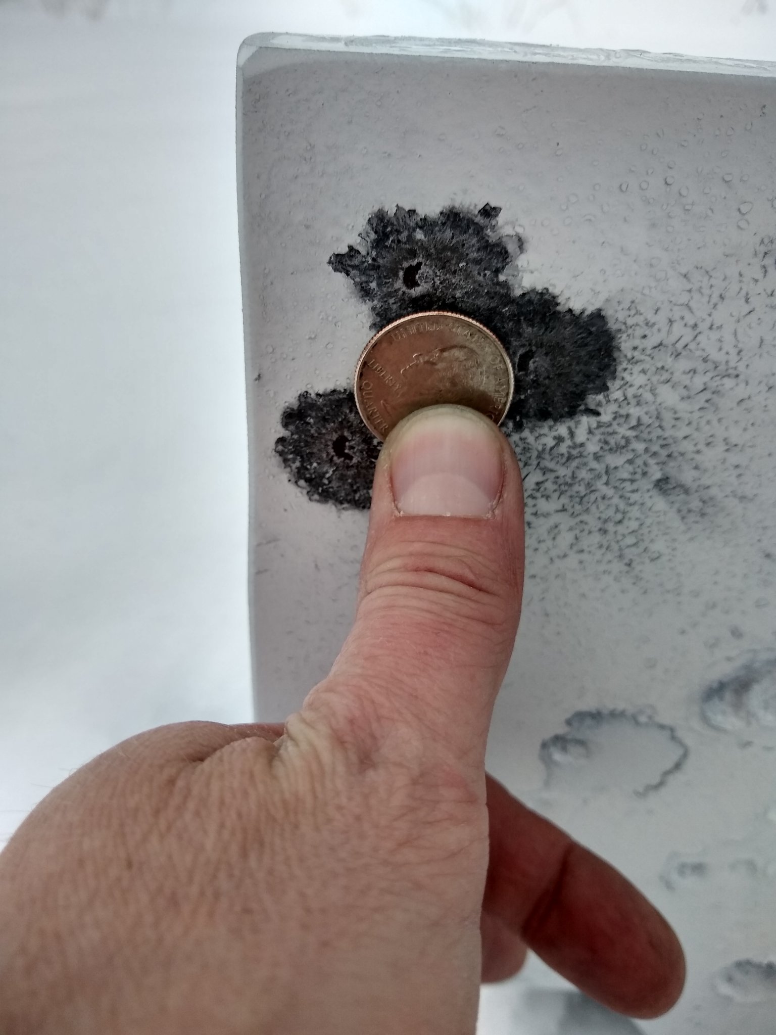

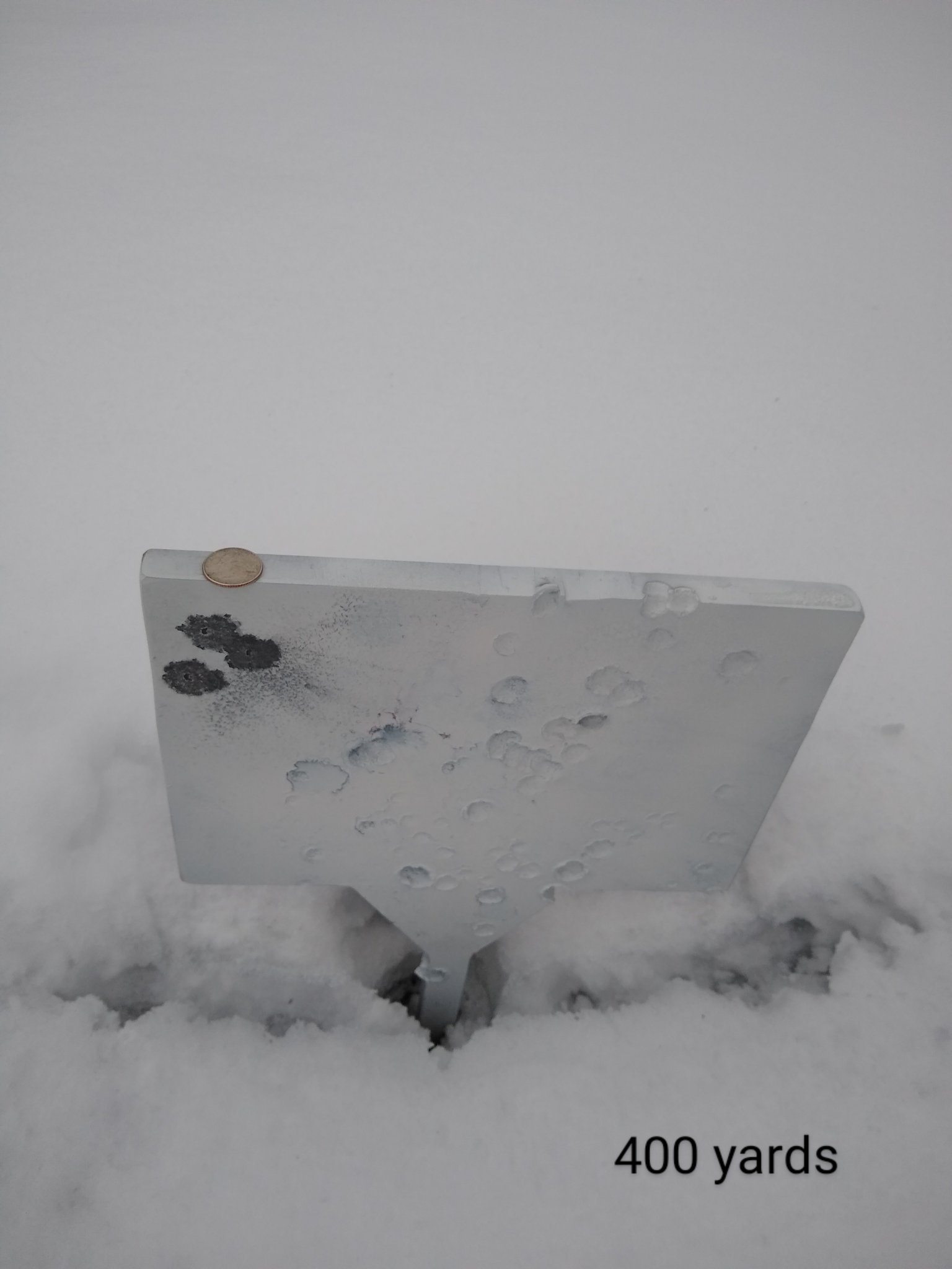

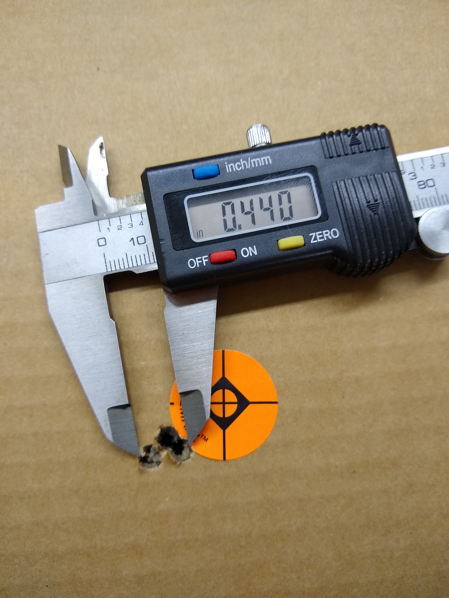

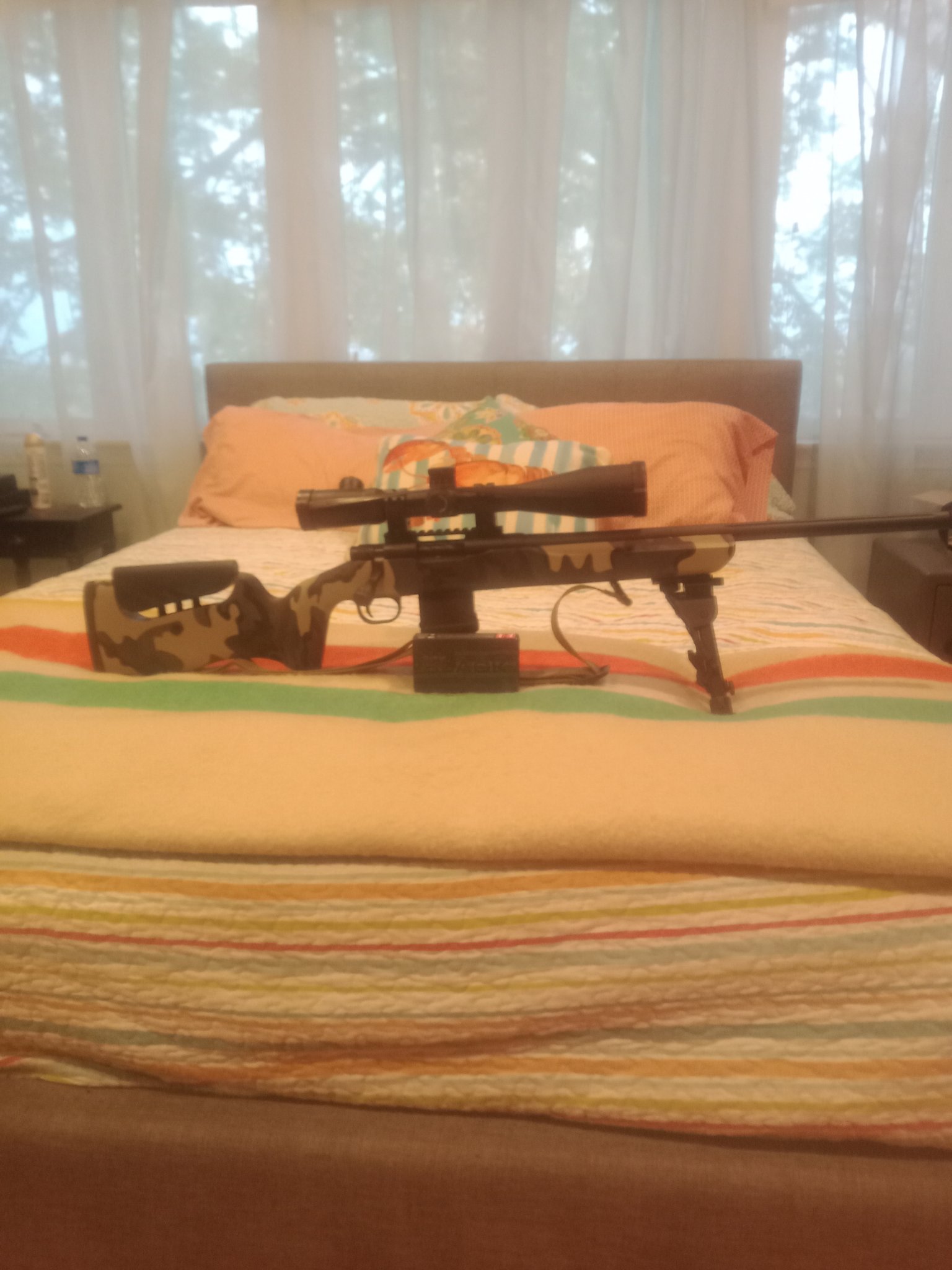

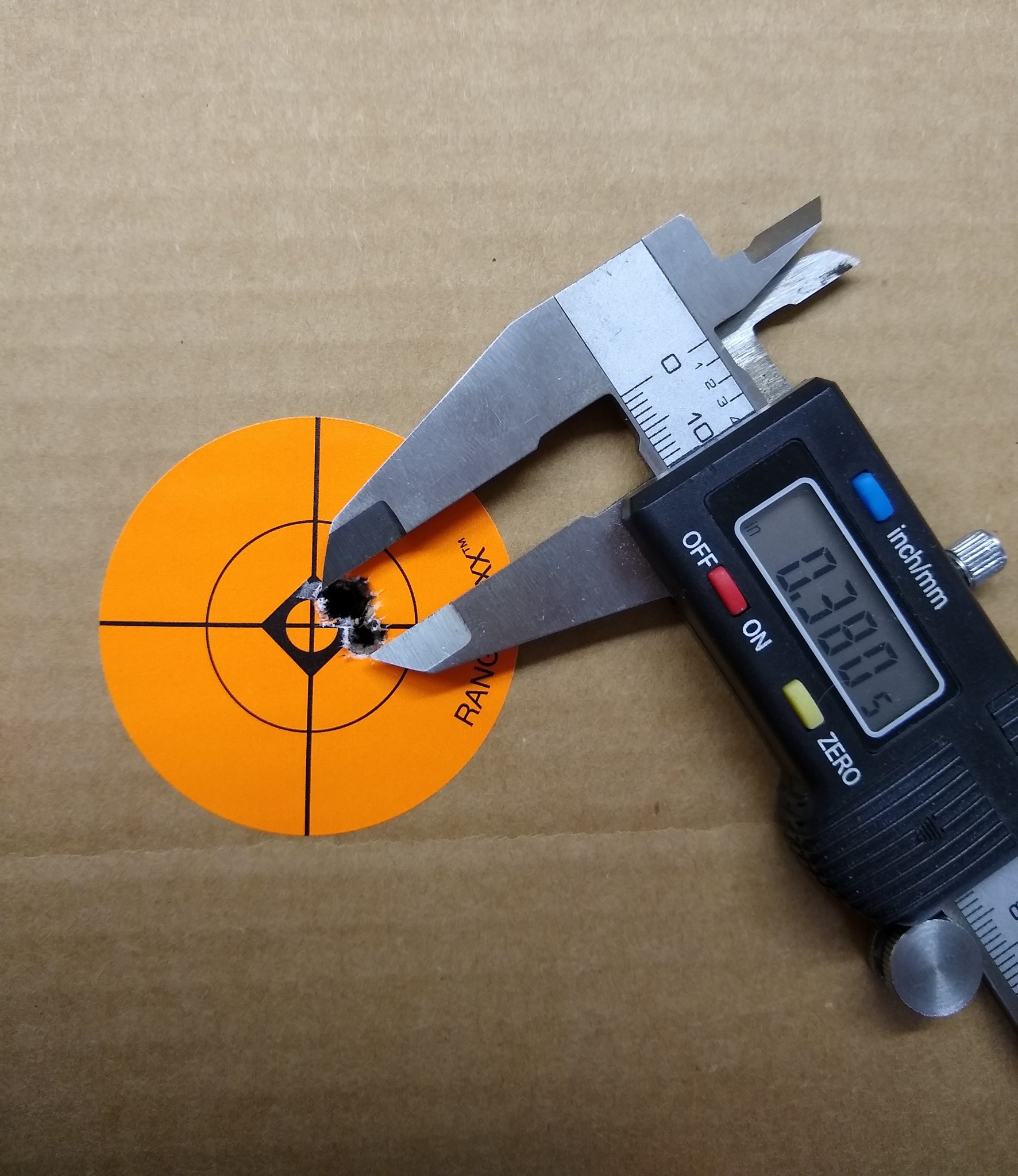

Love my new 16" .223. Its data lines up with my .308 inside of 600 and is a pleasure to shoot. Just dropping my mag length 77 SMK load into it produced the groups shown. Couldn't be happier.

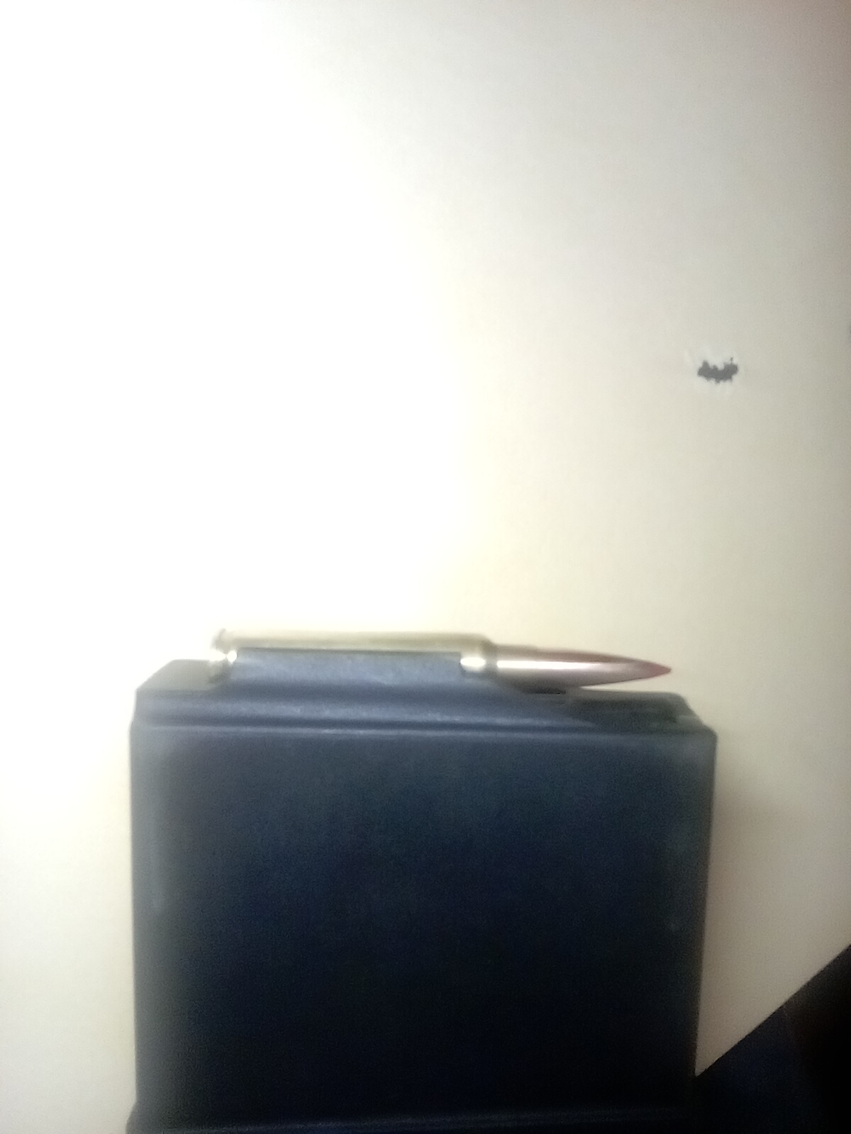

Hey guys so I'm curious on some stuff right now my 223 bolt gun is a wylde chamber with .061 freebore. I ordered a brux barrel and plan to chamber it in 223ai. At first I was looking at the Manson. 124fb ai chamber but I'm thinking that's too much freebore because I wanna run the Berger 75 80 80.5 and 85.5 and when my chamber was new my oal jammed in lands with the 85.5 was 2.547. I'm curious if anyone has .124 freebore and what their oal was please

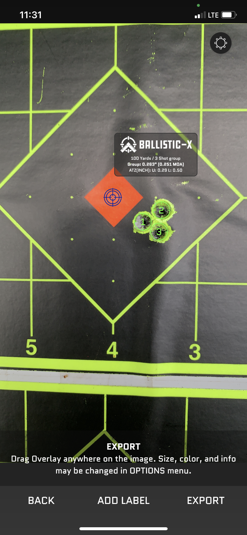

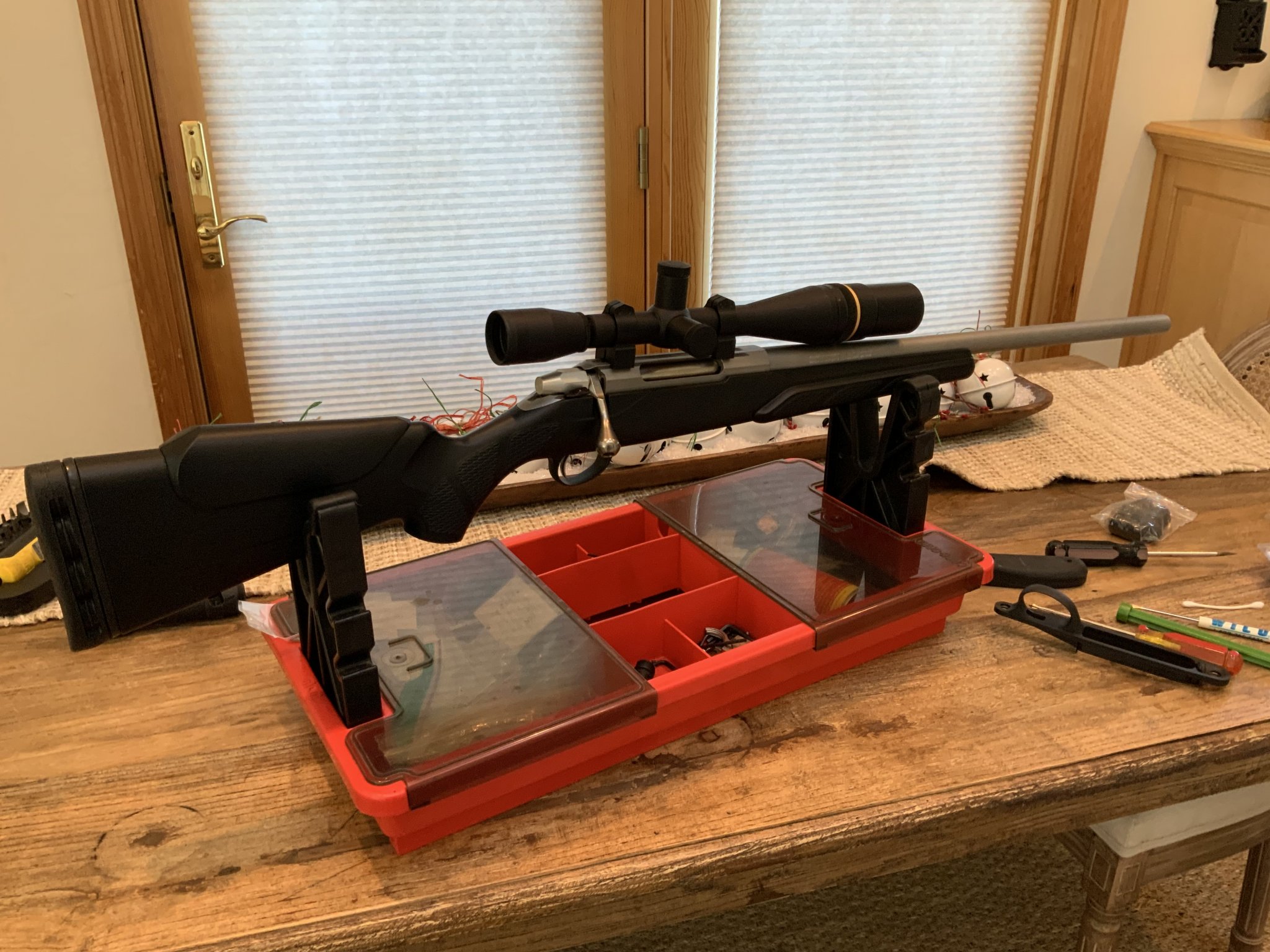

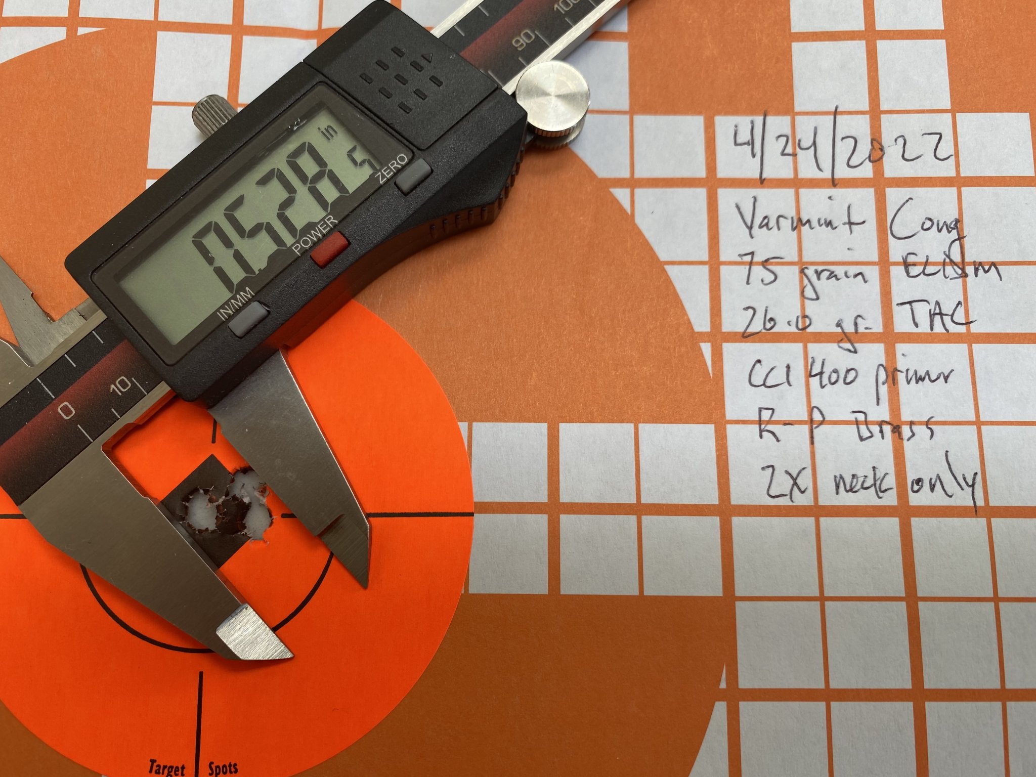

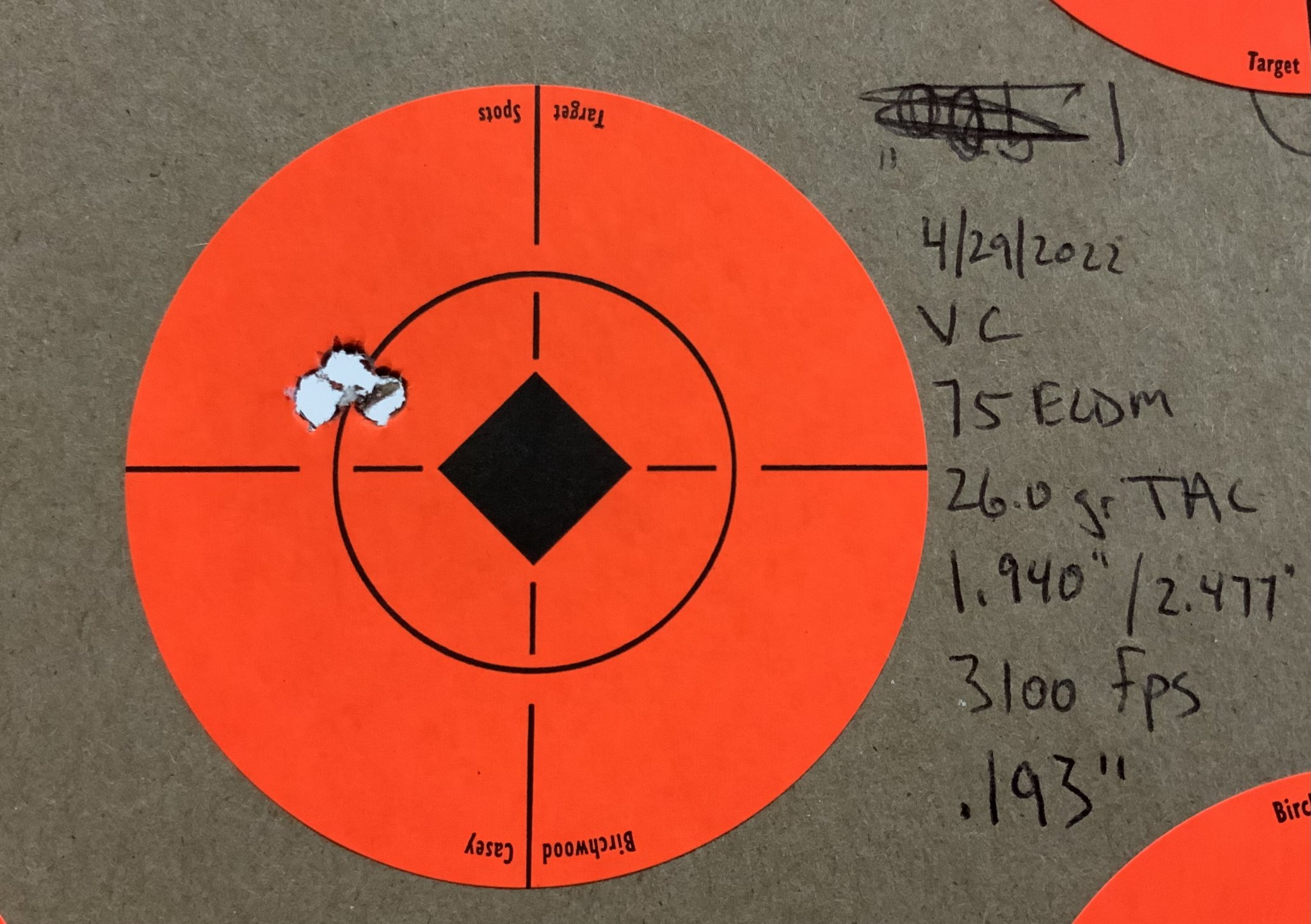

Used Tikka Varmints are out there. I bought one from a member of this site last November. Put a fixed 12x with target turrets on her and worked up a loading using 75 gr ELDM.
I do not recommend this load. Do not exceed book maximums.
Initial development:
Confirmation and chrono:
They’re worth the search.

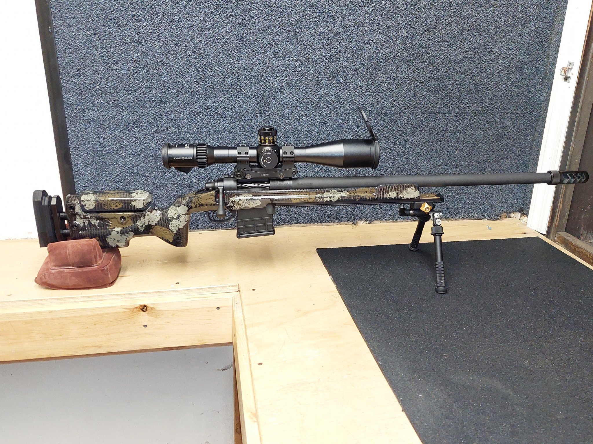

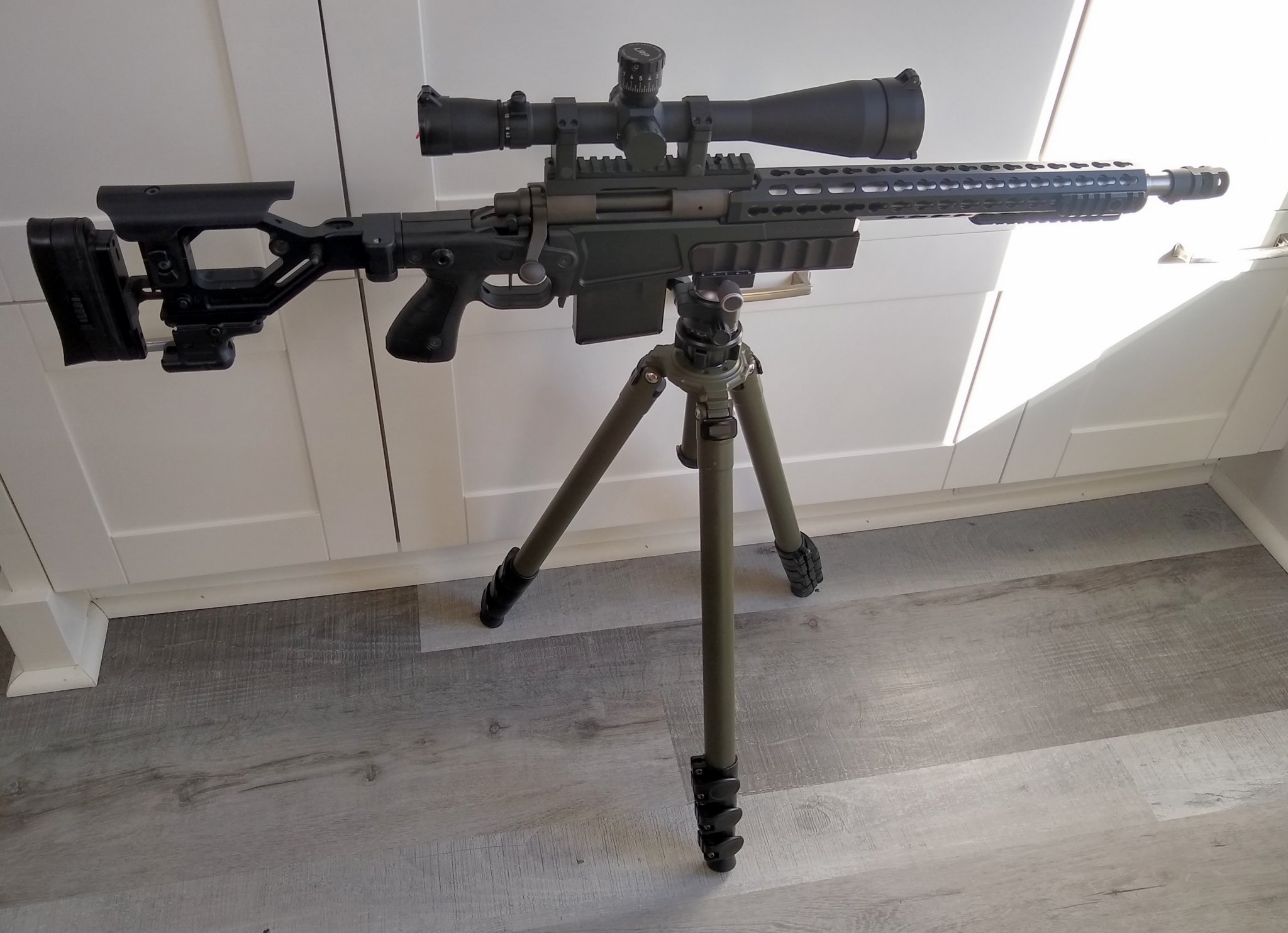

Big Horn Origin .223
26” 1:7 Proof Research Comp prefit
Trigger tech 2-stage flat
DeadAir Sandman S
Manners T4A team elite
Razor Gen II 4.5-27
MPA BA mount 1.125” height
MDT .223 metal AICS mags

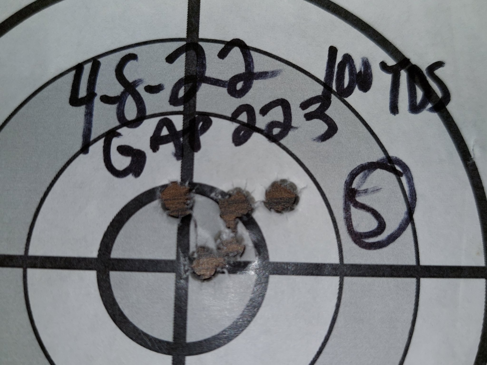

I’ve been shooting factory Remington 77 gr matchking bthp, shoots 1/4”-3/8” all day.
