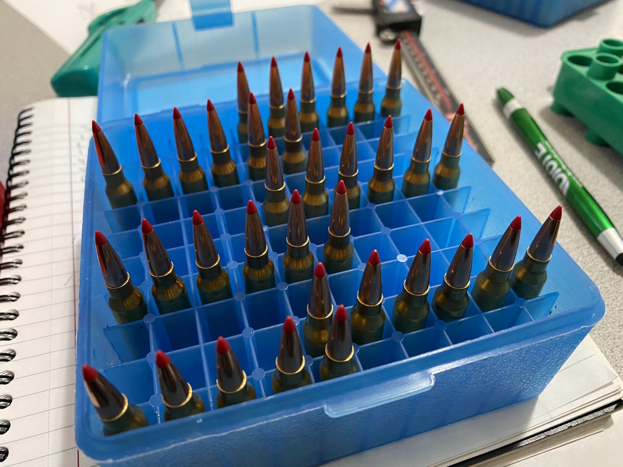

I put together a seating depth test starting at just kissing the lands (2.477”) and ending at 2.373,” which isn’t far from the ogive. Weather permitting I’ll be able to get an afternoon in maybe Wednesday.
I’m looking for Tikka accuracy. 3043 with a .235 G7 ain’t bad.

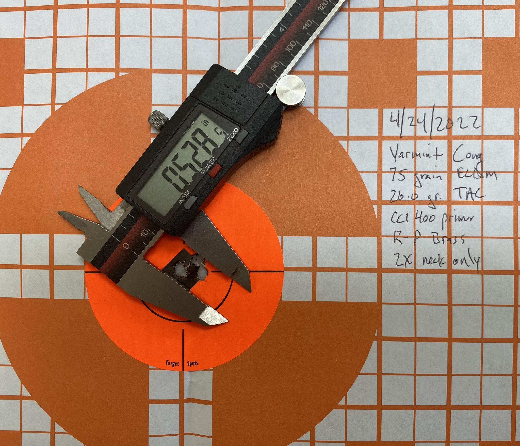

Range day today and the conditions were great.
I started the seating depth test with the shortest rounds. Awful. The first 3 iterations were more like a shotgun pattern than a group. The next two lengths showed promise but then I got to the longest set, just barely touching the lands.
I need to roll a few more but this is a pretty good first effort.
Safe in my rifle only, do not exceed published loads.

I rolled a few more today from the accuracy load to run over the chrono. Average of 10 shots was 3101, SD of 16,
which I thought was a little high. The original test load (3043) was a little shorter but the sd was only 6.
For you statistics wonks out there the mean was equal to the median which was equal to the mode. But still, 10 shots is just the start.

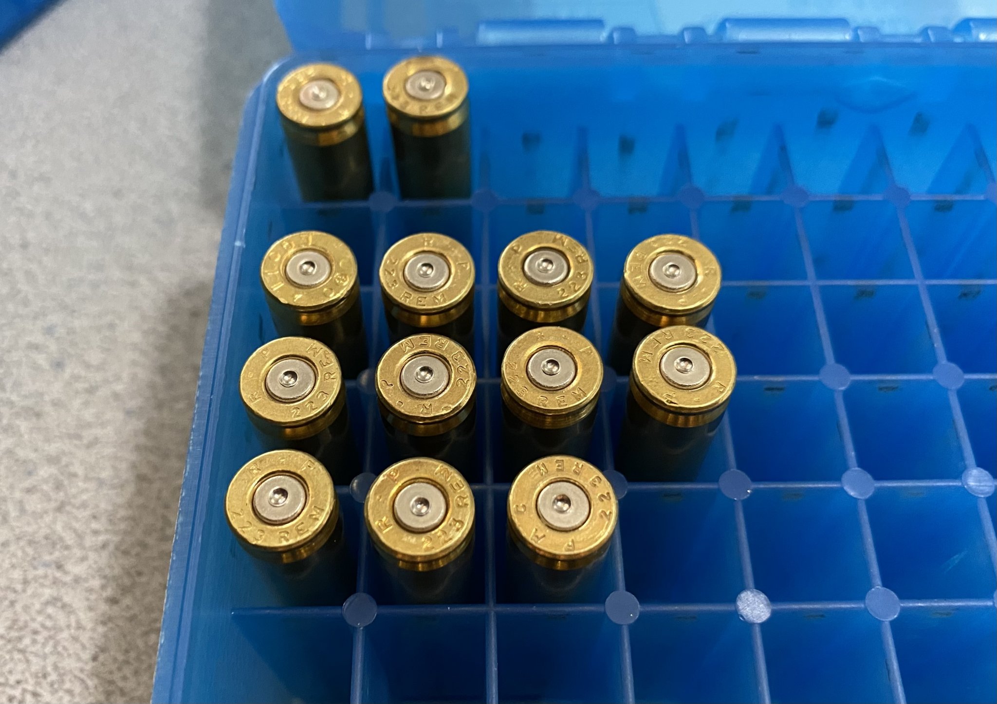

I rolled enough for a range day to confirm precision.
Brass looks good. Primers are maybe a touch cratered but bolt lift was easy. Primers look proud but it’s just the angle.

So pretty crazy accuracy and numbers from mixed head stamp brass. I wouldn't expect it to do that consistently.
Back from the range day. Can confirm.
Wow, thanks for the sharp eyes. I’ve been using R-P for so long I stopped looking at headstamps.
I just went through 300 cases and found 5 that didn’t belong. I’ll have to be more vigilant in the future.

Probably just go through your entire stash and make sure. Better safe than sorry!
