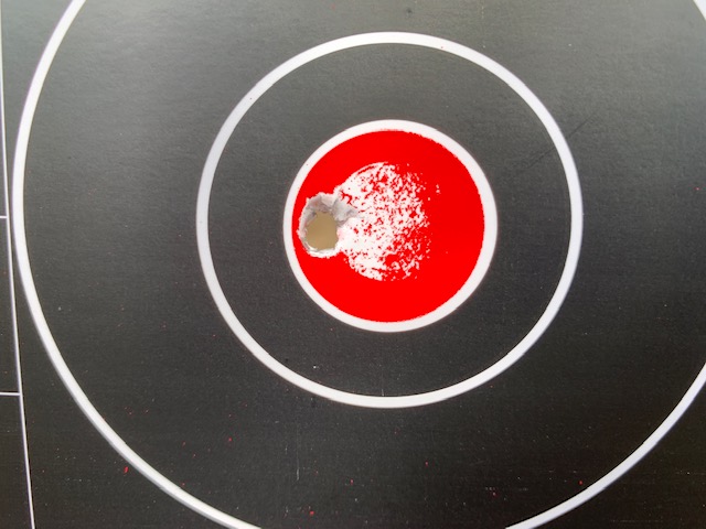

I built a 224 Valkyrie bolt gun do my 10 year old daughter could shoot 500 plus yards. The build turned out better than imagined. Stiller Scout action and reamer from PT&G (yes they were delayed and customer service is not on par), Bartlein 7 twist light Palma, Bergara Pro Stock, bedded, and micro bastard brake, Athlon 2.5-15x50 Optic (caught on sale).
The gun shoots Hornady 88 gr ELD-M unbelievably well with near zero recoil. I shot probably the samllest group Ive ever shot with her rifle zeroing the scope. I didnt know how good the group was because we are running the 15x optic and it was a small hole. I knew they were all touching, but was rather surprised when I pulled the target. 4 rounds at 100 yards.
My daughter is routinely hitting 8” and 12” steel at 500 yards. Its pretty awesome to see.
So yeah, a 224 Valkyrie was designed for the AR-15 platform, but for my purposes to have a low recoil, lomg range capable bolt gun for my daughter its perfect.
It may not be the first choice for a more advanced shooter, but its a gem for younger shooters and makes a great long range trainer with the higher bc bullets.
