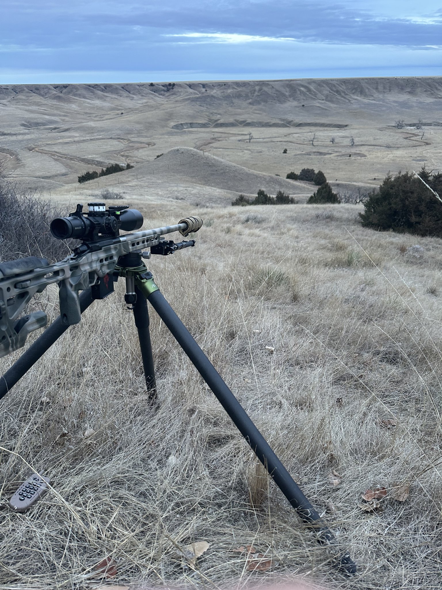

I corrected my axial form factor and verified it the next day on a 12” circle at 950. I have 4/5 hits on that target with the initial miss just being wind, elevation was good. This was my first time using these bullets for anything and I was happy with the results. They do seem to like being close to the lands. Mine were loaded .010” off.

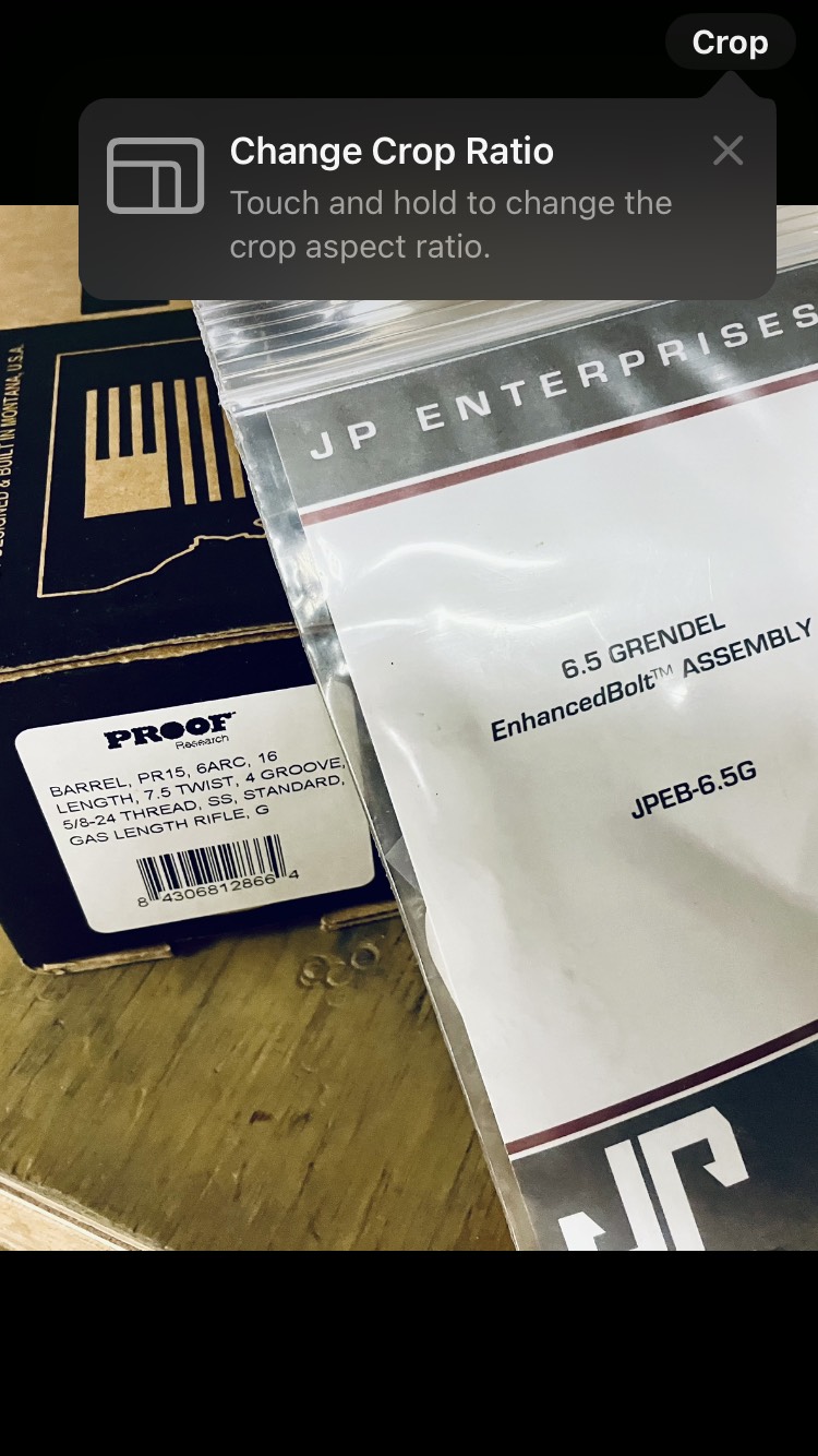

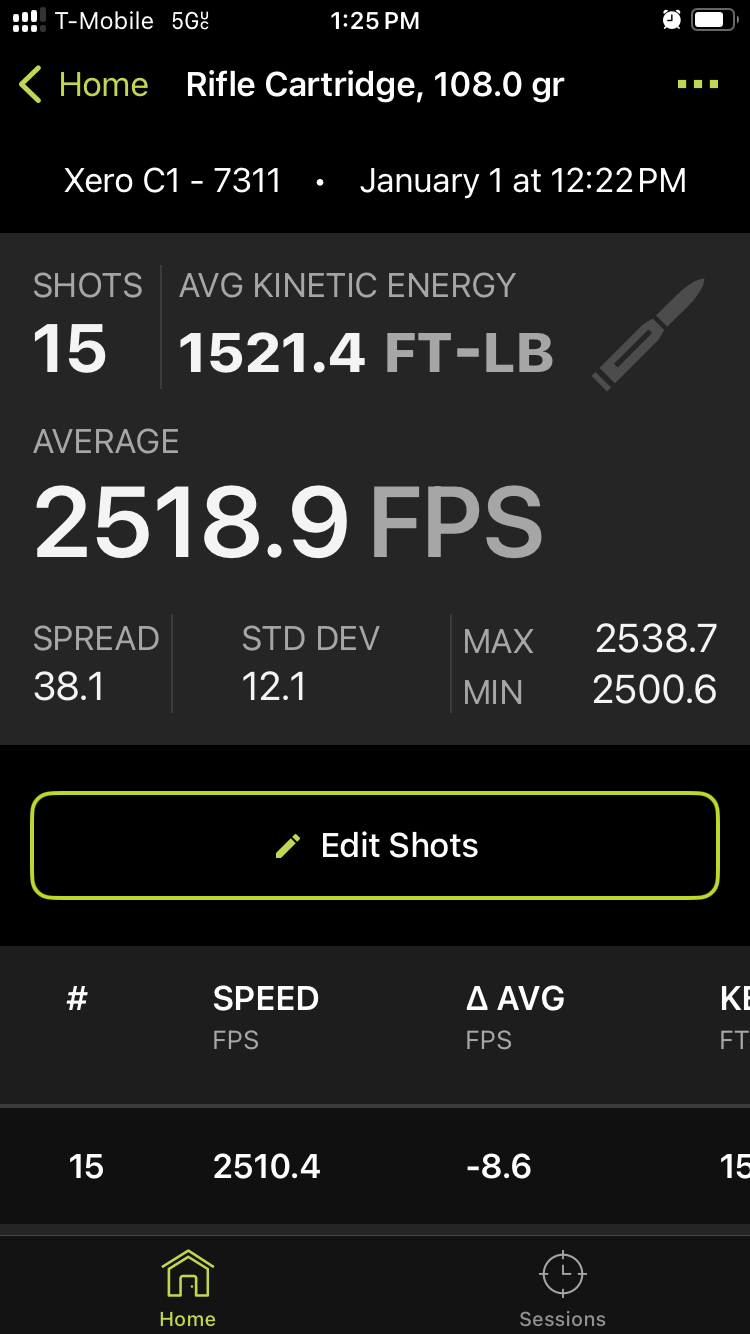

Here is what I’m getting with a 16” proof 6 arc with factory loaded 108 eld m ammo.
What are people getting as far as velocity from a 16” 22 arc with 85-90 grain bullets?
Here is what I’m getting with a 16” proof 6 arc with factory loaded 108 eld m ammo.View attachment 8581195
Which make barrel and how many rounds down it? I ask because I see 30-40fps better than that with factory 108's in my Proof 14.5".

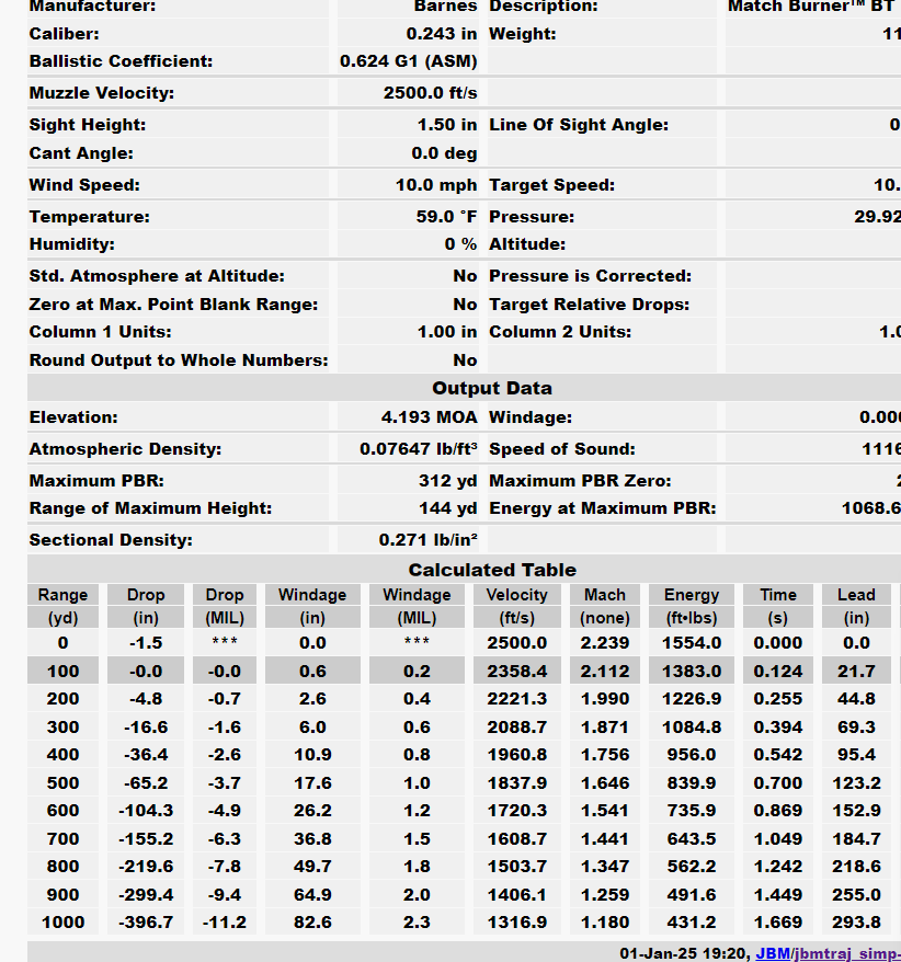

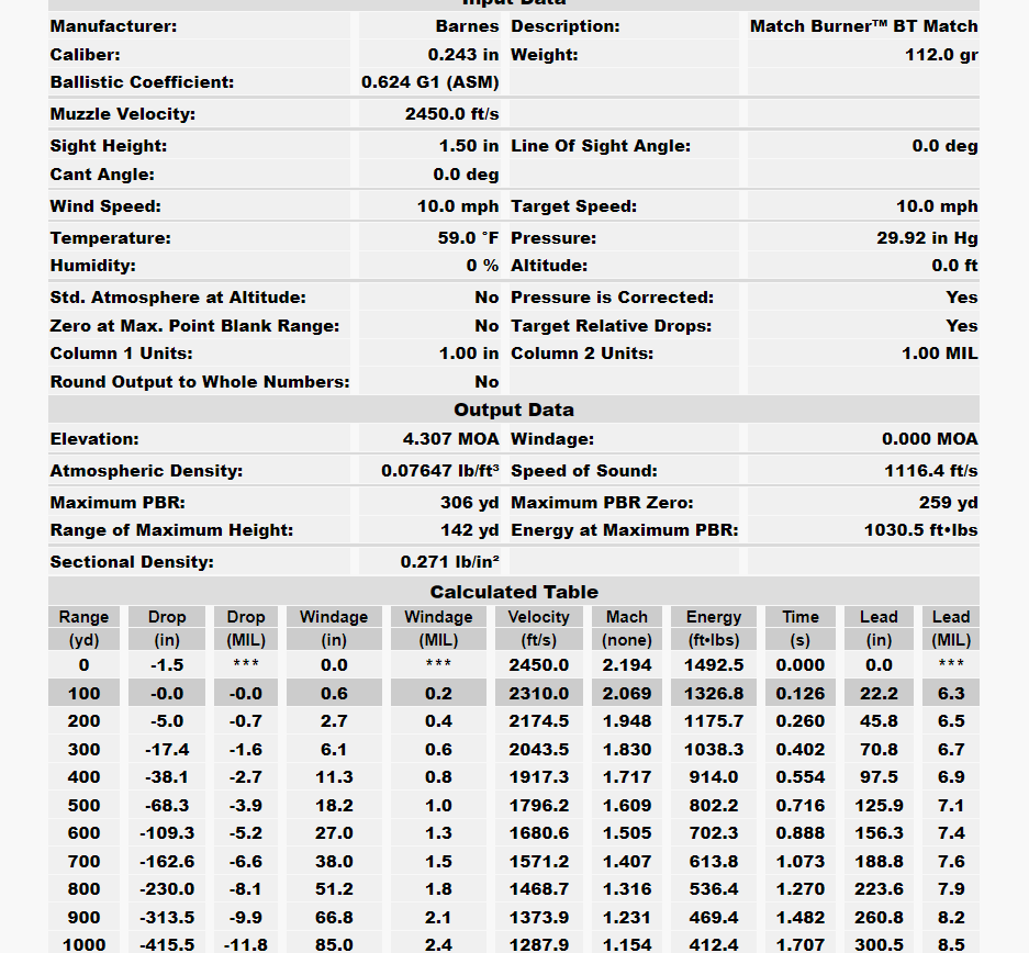

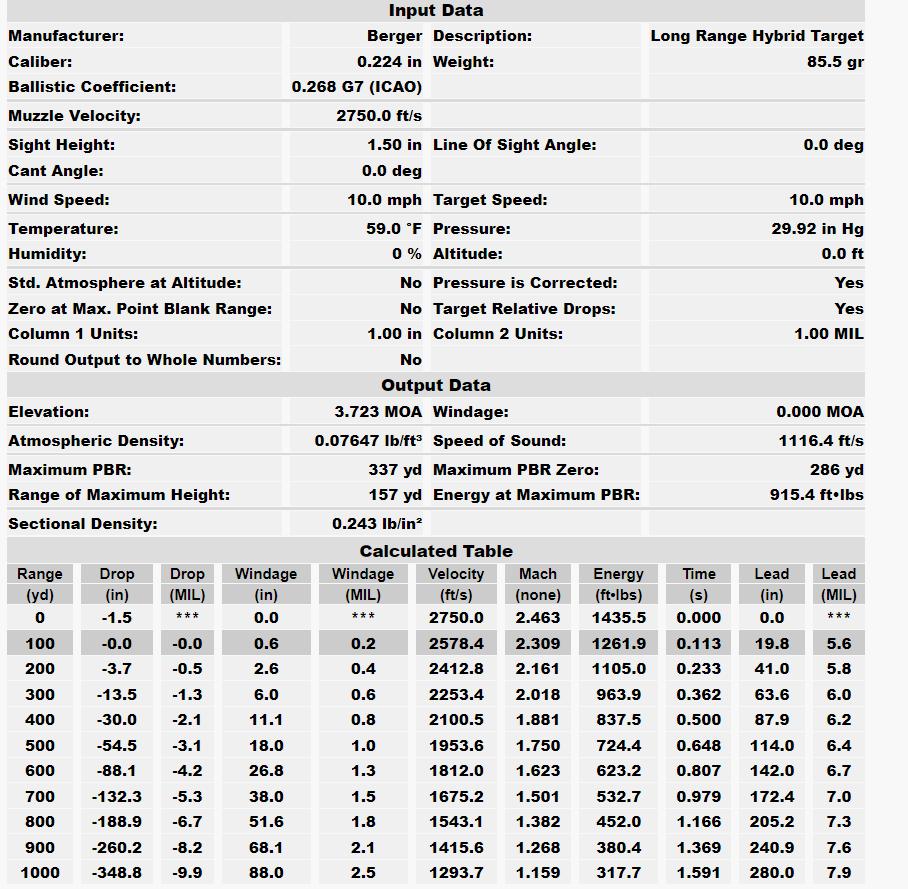

this is as close as I can get them using assumed mv's from 16" barrels and it requires using a 6mm projectile of unknown consistency as far as shape, weight, bc variation from bullet to bullet
112 match burner at 2500 fps at muzzle
85.5 berger lrht at 2750 fps at muzzle

but to me for the same barrel length, it looks like 22 arc always has an advantage over 6 arc in drop due to higher mv's
the only way you get less wind drift with 6 arc than 22 arc is if you go up to a 115 dtac or 112 match burner
if you look at factory hornady ammo, the 88 eld m and the 108 eld m are fairly close in bc
i don't even know if 112 match burners or 115 dtacs are a good fit for the 6 arc case and geissele arc mags
