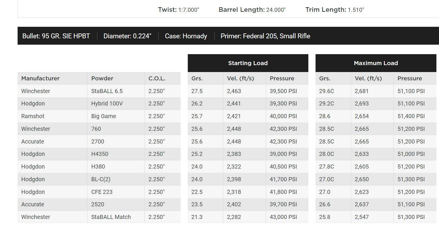

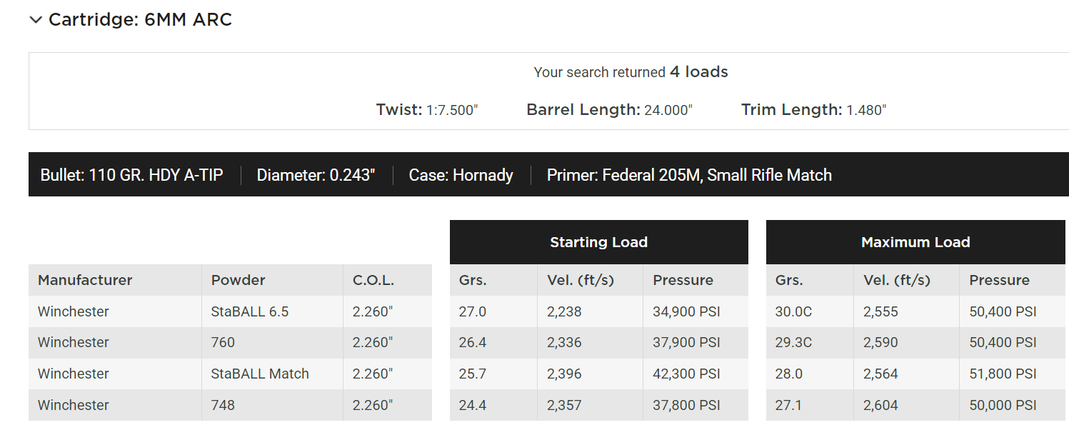

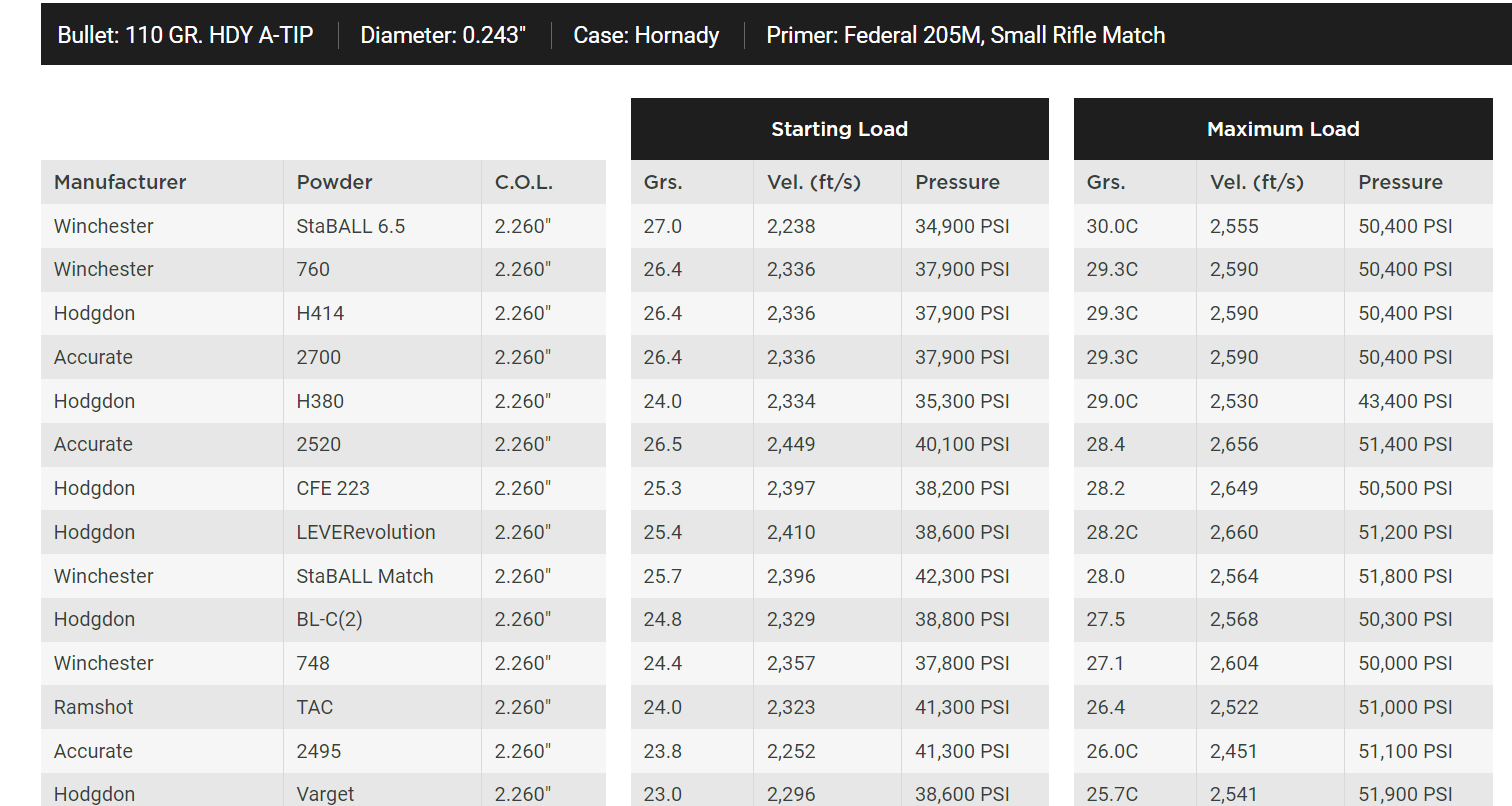

These are all the loads listed for the highest bullet weights on Hodgdon's Reloading Manual for both 22 ARC and 6 ARC

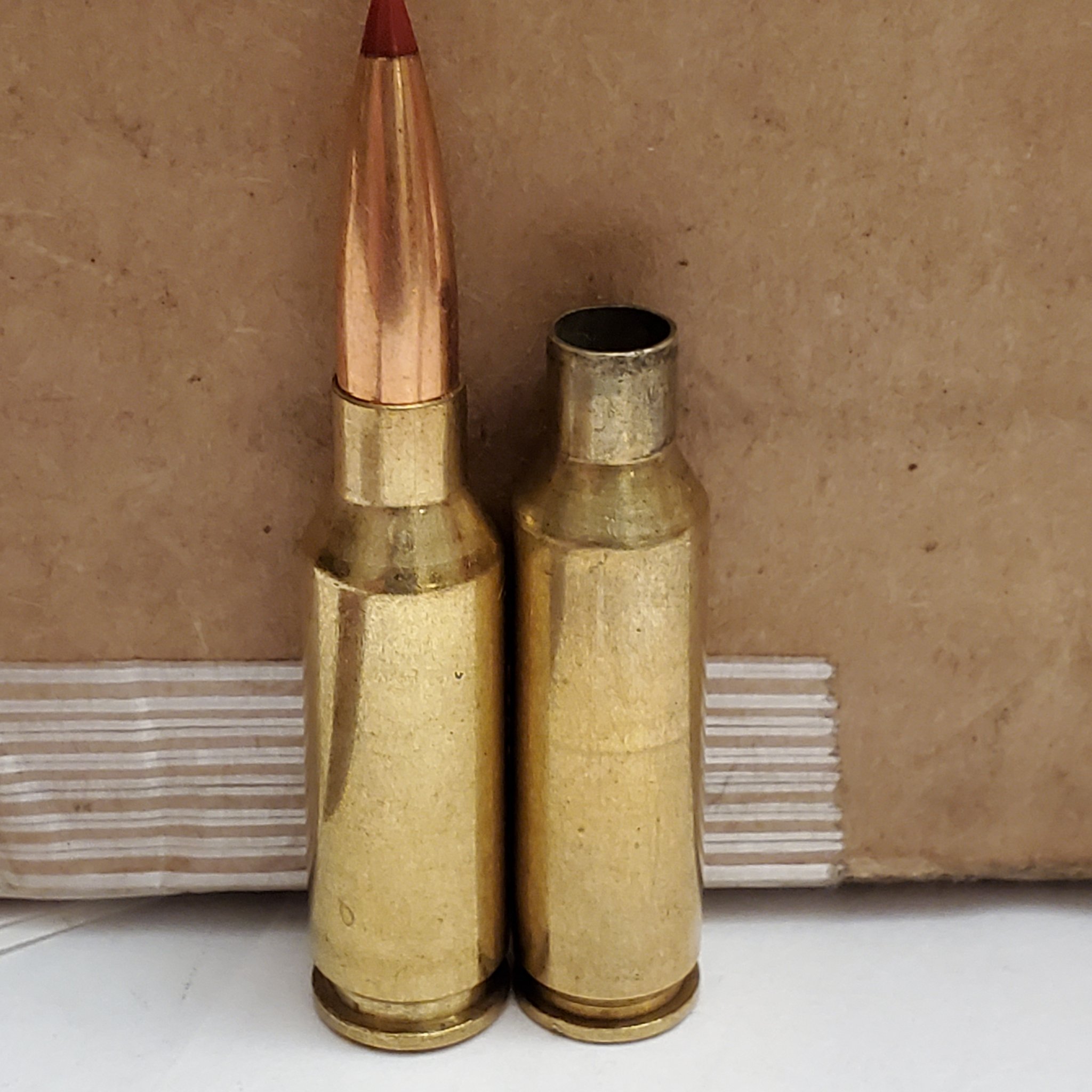

Here's the 6 ARC next to 224 Valkyrie.
The 224 has slightly more, 1/2 gr H2O case capacity than the 22 ARC.
So with the 22ARC is basically a 224 Valkyrie in a different package, requiring slightly less bolt pressure to be safe in an AR.
Which would make the 224 Valkyrie slightly superior to the 22 ARC, with slightly more case capacity and able to run st higher pressures....interesting
Plus the 224 Valkyrie comes in 6.5 twist for 95 gr SMK....and may be able to run varmint bullets 30 or 40 fps faster.
Pretty much the same thing, different package...Hornady...and don't forget each is the best cartridge design ever.

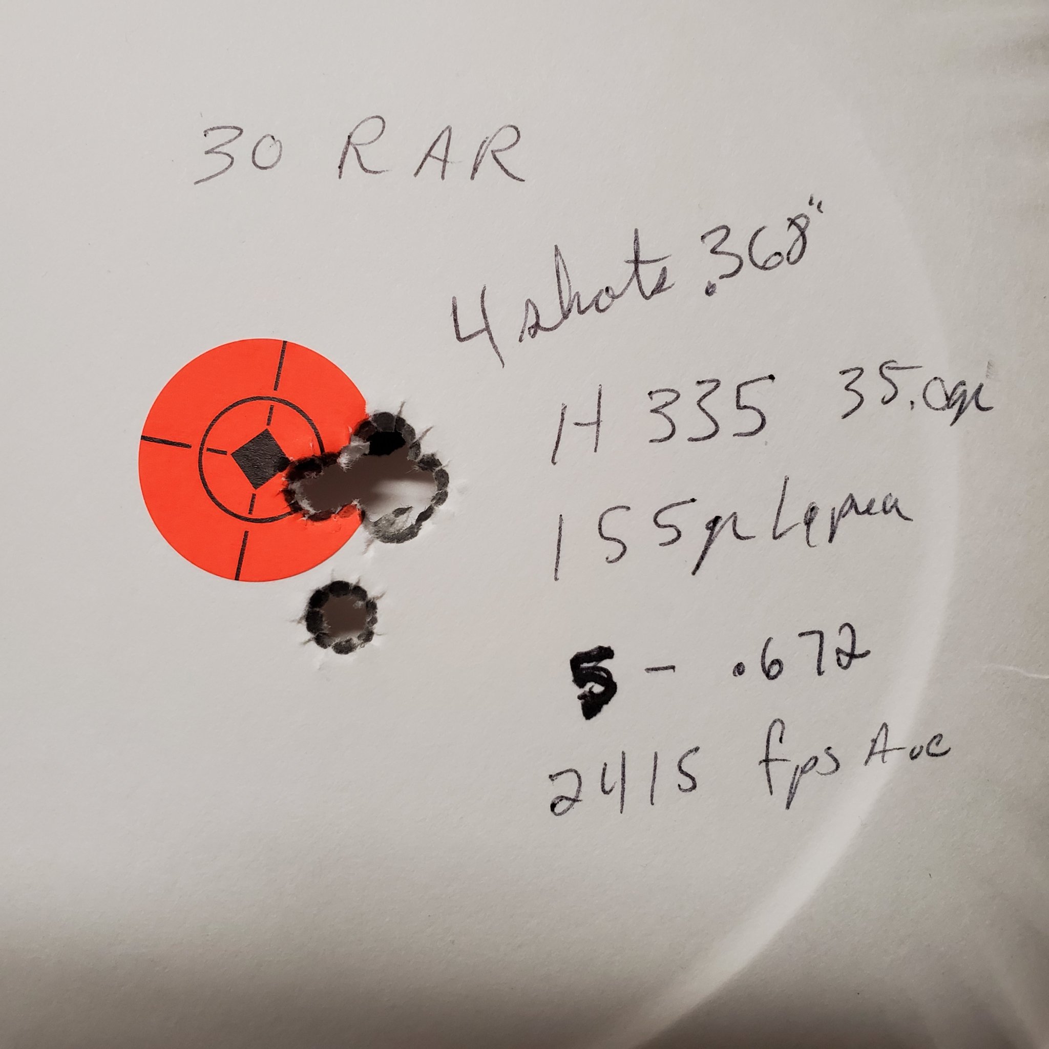

I shoot the 30 RAR in an AR 15.
It's kinda like a 300 savage. About a 300 yd deer cartridge with 150 gr soft points.
Keep the pressure below 50,000 ps. It's very accurate with 155 gr Lapua Scenars, for moderate range target.

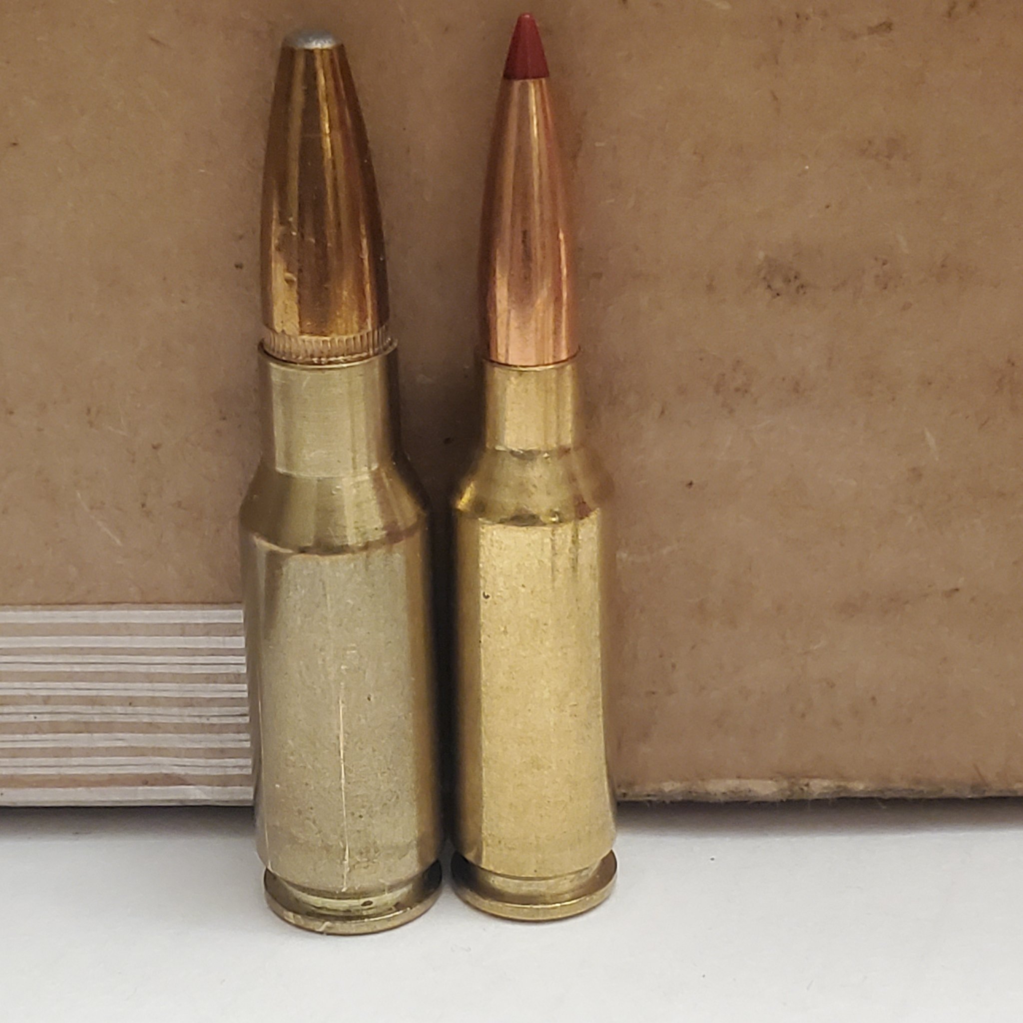

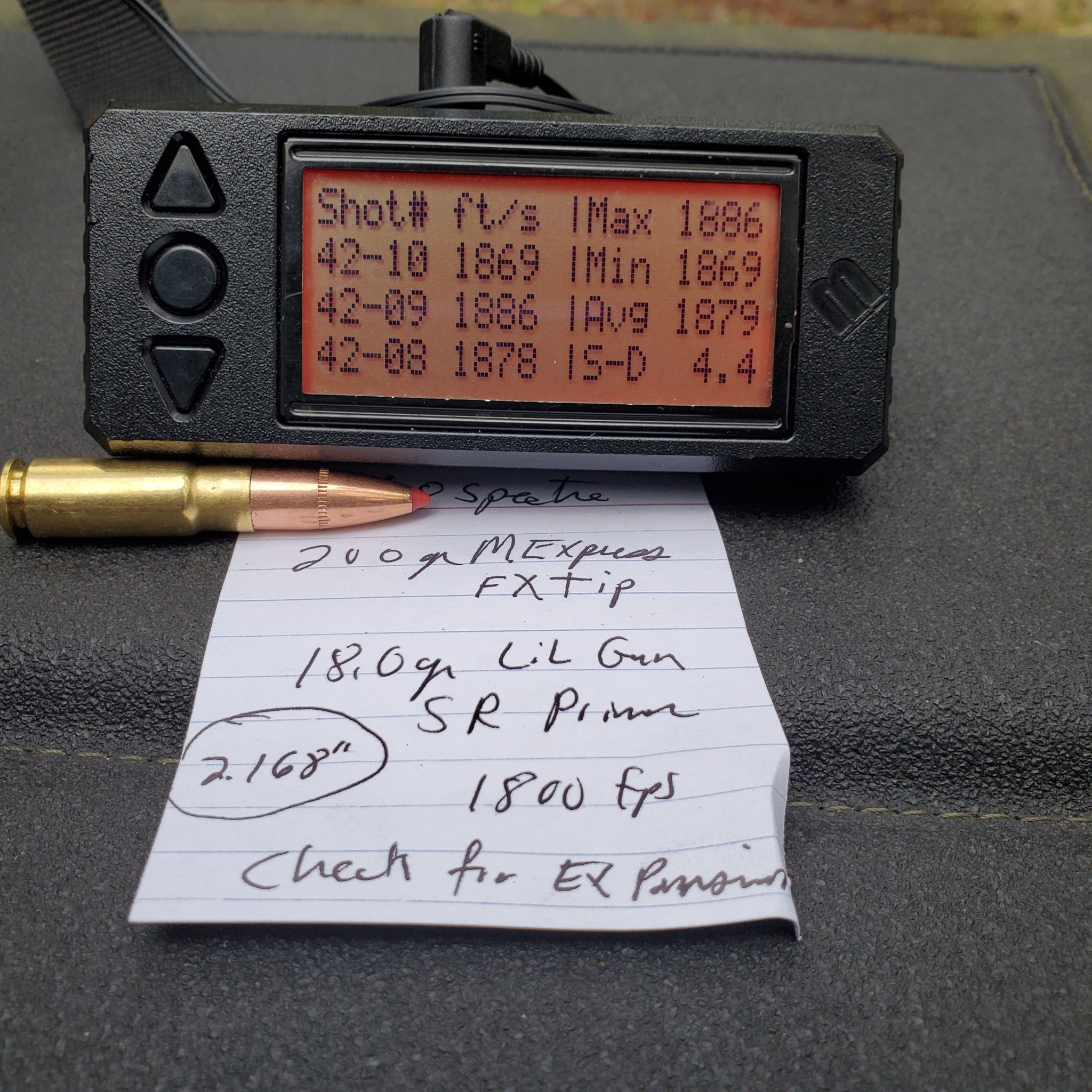

Here it is 30 RAR next to the 6mm ARC.
But the 338 RCM & 300 WSM in a real AR 10 run at the full max of 62,500 psi to just under 65,000 psi with .535", & .550" case bodies, with KAK magnum bolts, & modified ejection ports.

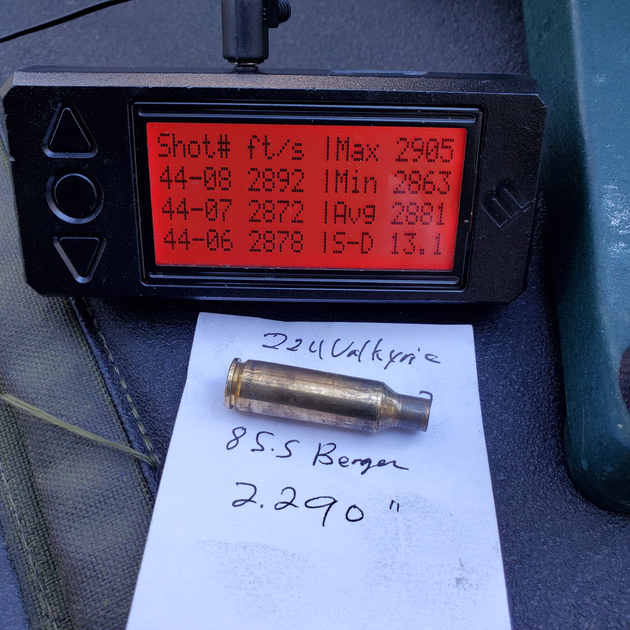

Shot the 85.5 Berger in the 224 Valkyrie today, it hangs around 2900 fps.
I usually shoot the 95 gr SMK in tbe 6.5 twist barrel.
But I like my 2 6mm ARCs...my preference kinda goes to the 6mm, but I enjoy both.

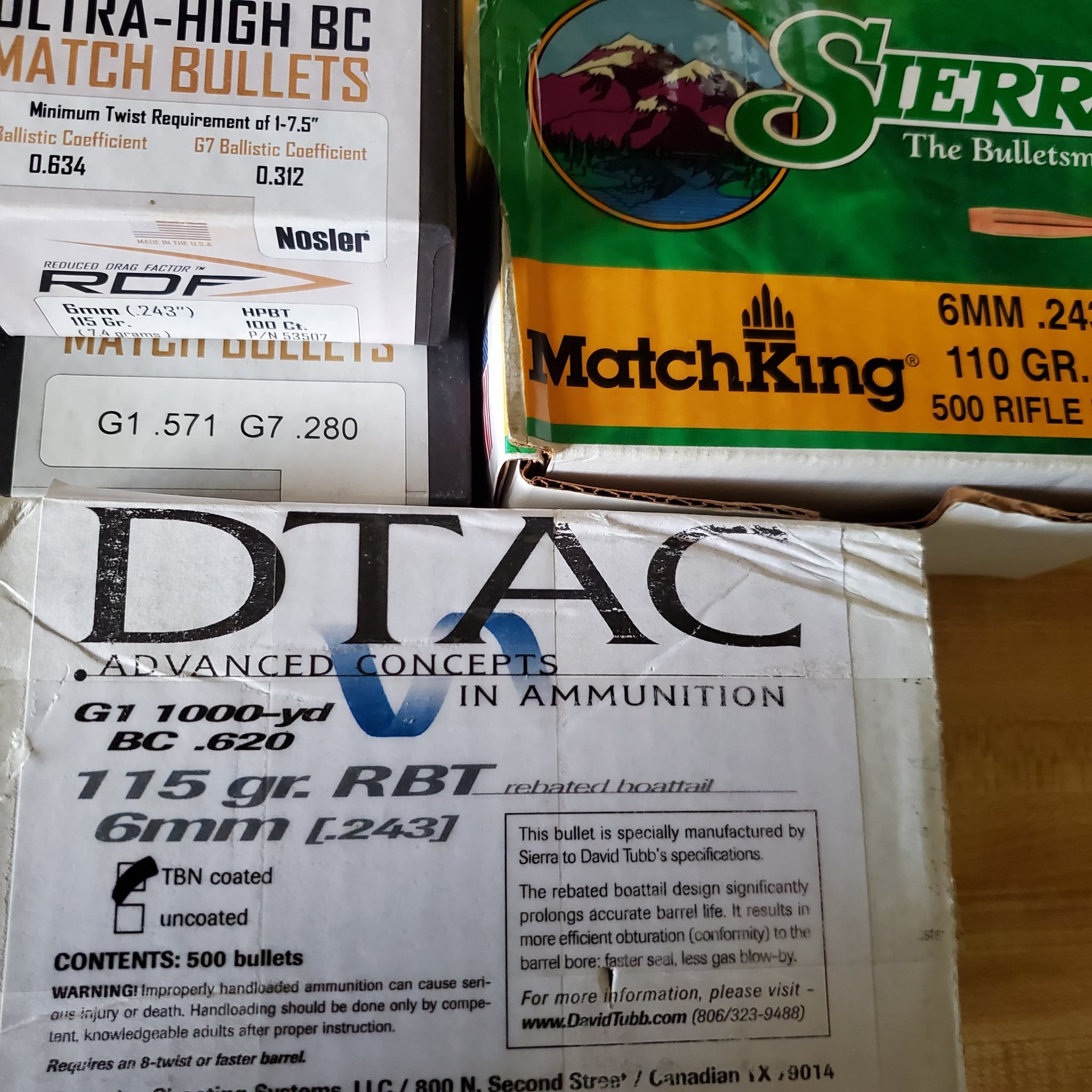

If your going to 16" barrels the 6 ARC makes more sense.
I run 18" Proof 6 ARC 7.5 twist and a 24" 224 Valkyrie 6.5 twist in AR platforms.
Things get different when going to 16" and 18", sometimes the velocities are close to the same, like my 308s...barrel chambers, bore smoothness, twist rate, all factor in.
All of the 115s, 112 gr, 110 gr go over 2500 fps in my 18" 6 ARC barrels.
The BCs are up to .634 G1 or .312 G7, at over 2500 fps with Leverevolution powder.
Try some of these in 6 mm ARC.

I'm going to see if I can get the sierra 110's to shoot a decent velocity at the max length for the geissele mags with either 6.5 staball or staball match
I want to set up on the dillon 650 for this one and want a powder that meters well but has good velocity and good sd's and es
if neither of those do well then i will try 2520
I think staball match will be better than 6.5 staball so I would start there

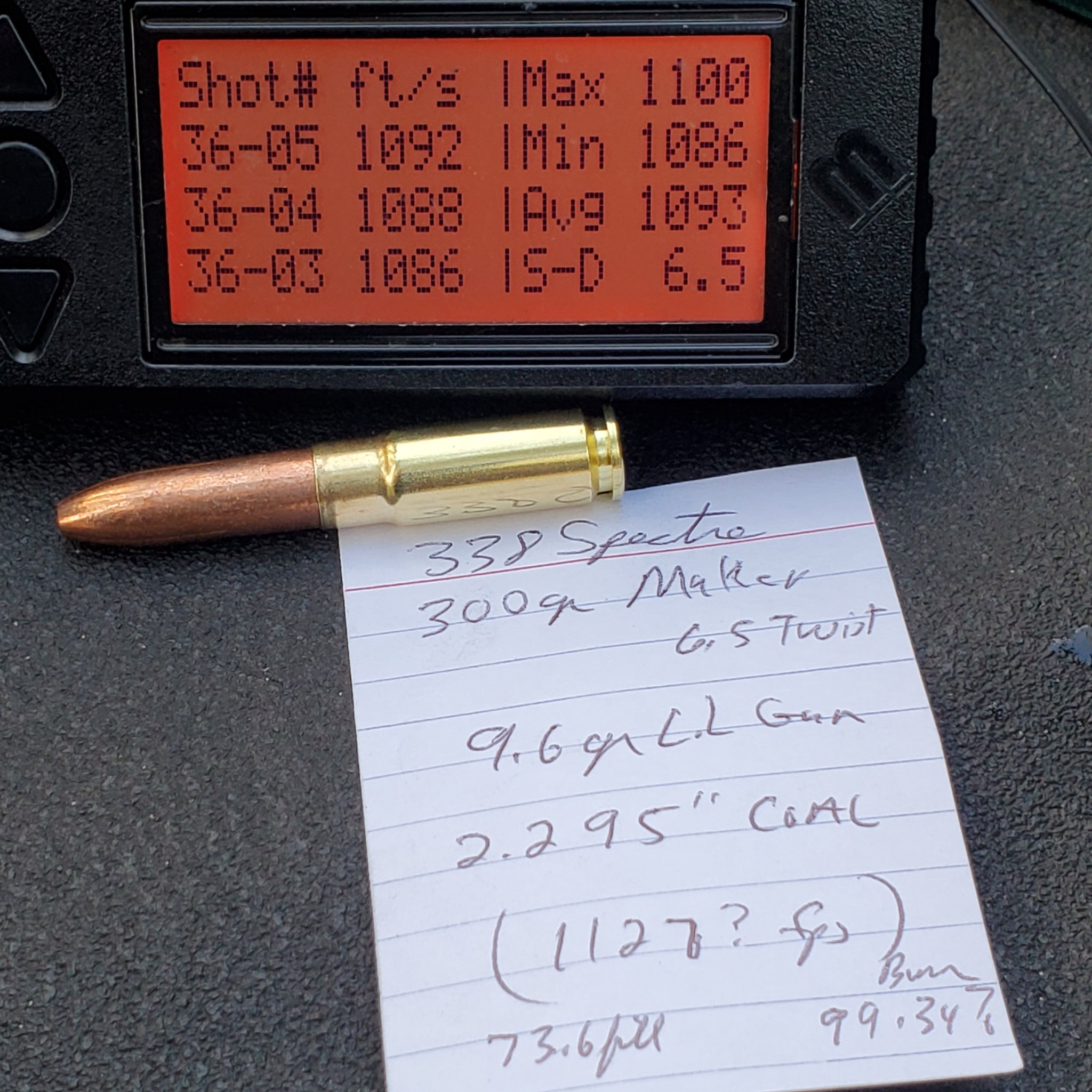

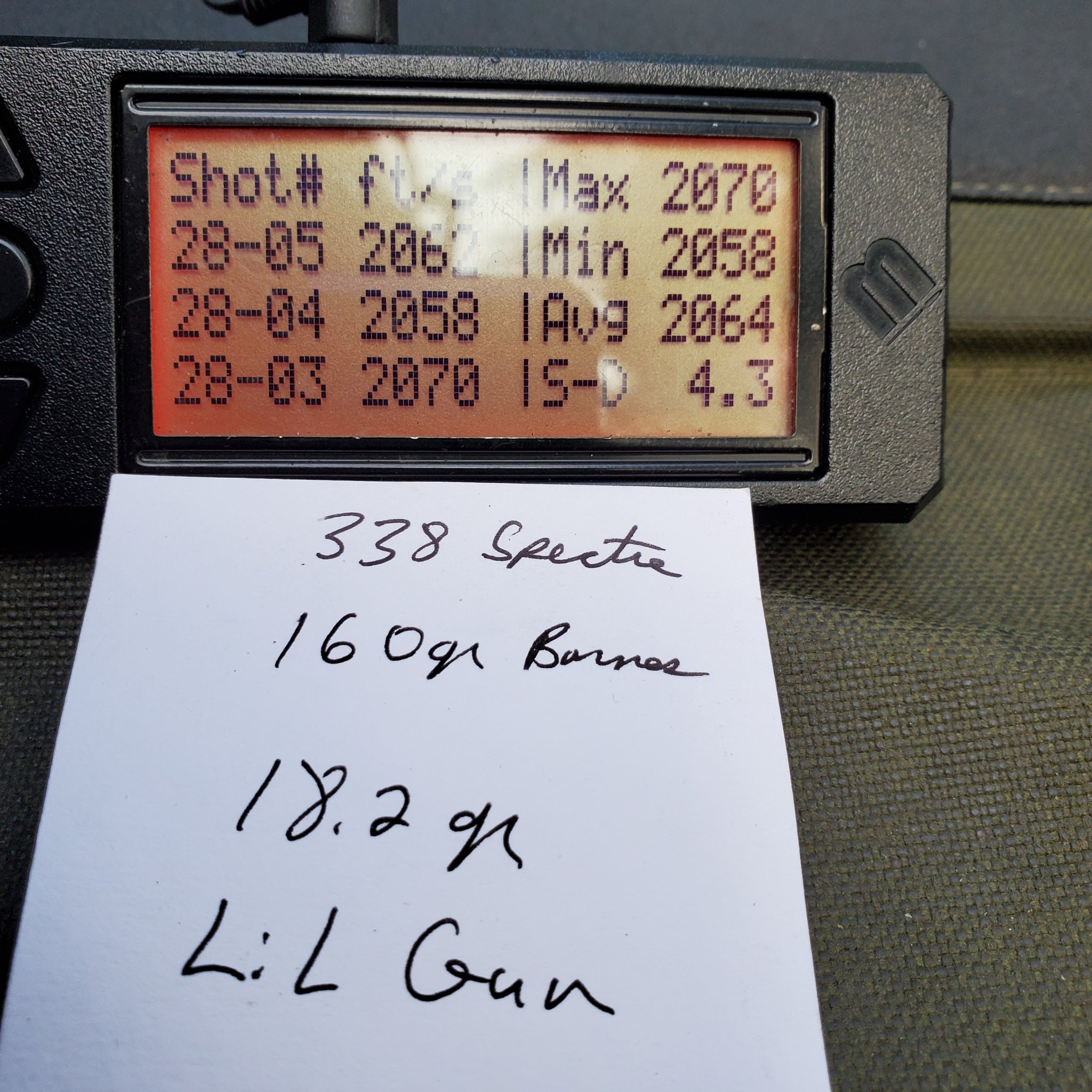

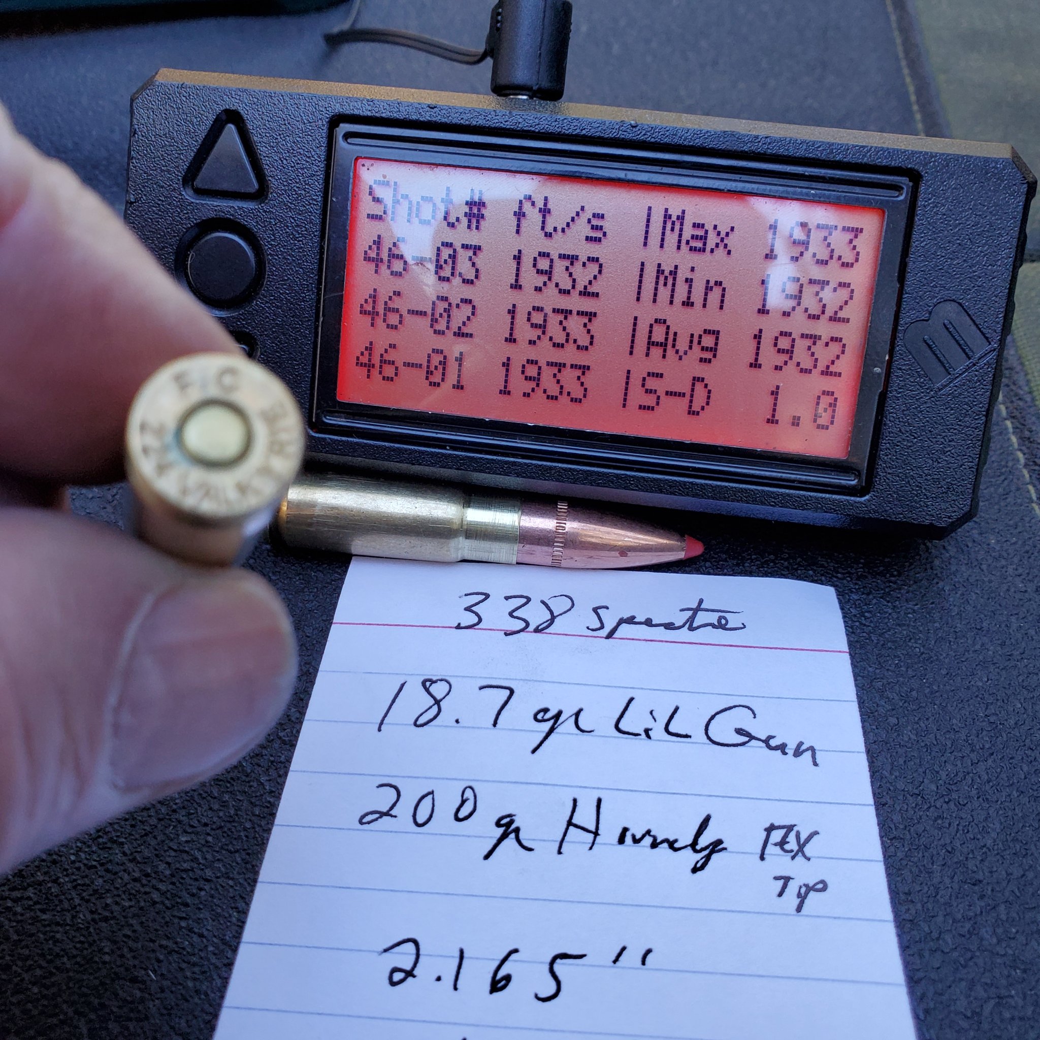

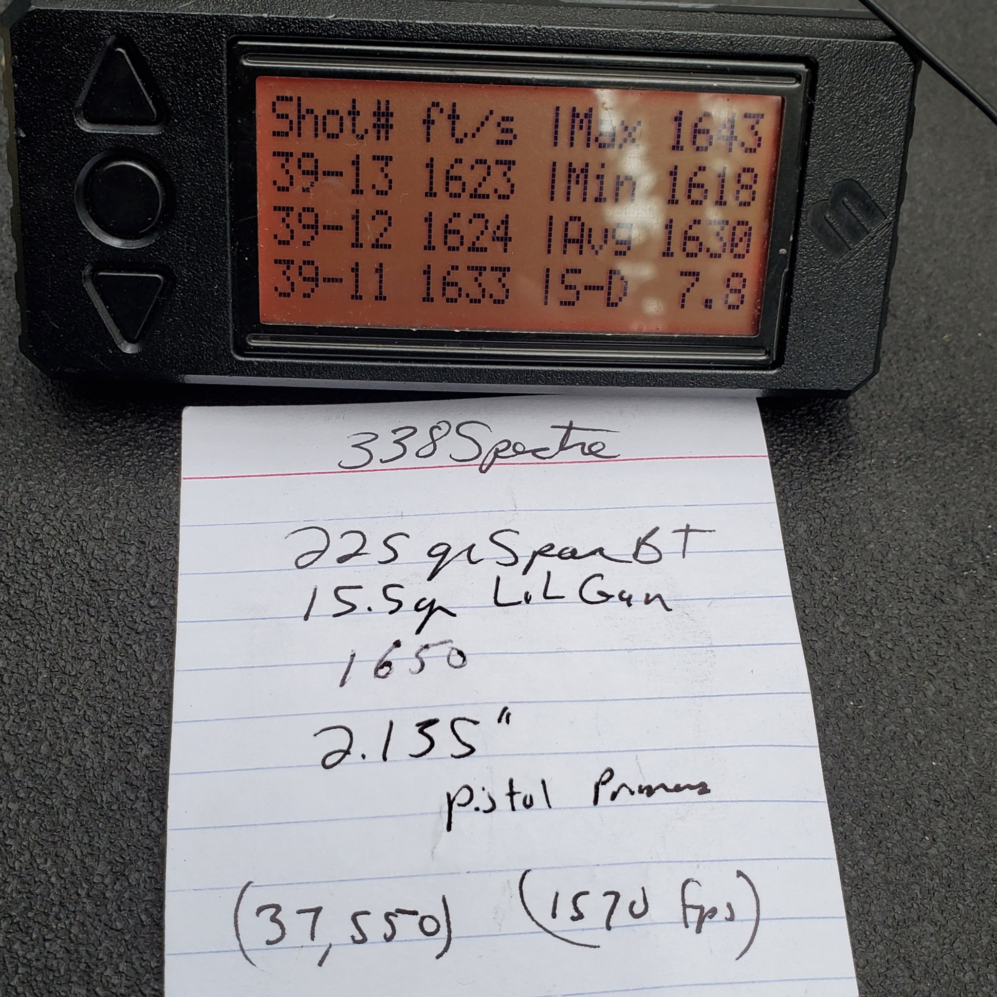

The easiest AR 15 round I ever got to shoot most everything good with single digit standard deviations ....is the 338 Spectre.
Loaded on a Dillion progressive, SR or LP primer, newly formed cases or factory cases... 224 Valkyrie cases or 338 ARC cases turned heads ...it doesn't matter.
Subs or supers, it doesn't matter, still single digit S/Ds ...plus most everything is accurate.
I just use it for plinking, but it's supposed to a subsonic hunting round...almost identical to Hornadys new 338 ARC, except it has a 6.5 twist.
I even modified a few pieces of 338 ARC brass to shoot in it.
A very consistent caliber in this one example.
So loading on a progressive can produce excellent ammo.
it does add in an extra safety factor that you can't fit enough 6.5 staball into the case when you have a 110 smk seated at geissele 6 arc max mag length that you can't get enough powder in the case to be over - pressure before you start compressing the powder
Reactions: stello1001
This is true, I just think it's a lot closer to h4350 so the speeds achieved with it might be very unsatisfactory.
It would probably do better in the really long barrels with extremely heavy for caliber bullet weights
but ... i do think you're right that staball match can be pushed harder and might be a better match for a 16" barrel
You'll be able to fit far more StaBall in an ARC case than you will 4350. That's the difference. You have to be careful at the top end tho. 6.5 StaBall produces super high pressure when compressed. But it does surprising things in smaller cases. I got 105's up to 3050 out of a 28" 6BR with sub 1" accuracy at 300yds. StaBall Match has always just pressured out before I got decent velocity in everything Ive tried it in. Never been impressed with it.
i really like 6.5 staball to use it with a powder measure instead of having to use the auto trickler like i would with reloader 16
i have only used it with 6.5 creed and 6 dasher in bolt guns
i am trying to get down to just two cases to reload for haha but i love trying new things so it's hard but I think i'm going to try it for a year just sticking with 6 arc and 9mm only. I may even do an 11.5" 6 arc sbr and completely do away with 223
I've got a tool head set up in 6GT for the 650 using a case operated powder drop and a bullet feeder so I can run the handle and just pump out loaded blammo.
I still prefer the le Wilson inline seating dies and a 21st century arbor press for match ammo but I’m going to really focus on using the Dillon 650 this year to see how close I can get with it versus using the autotrickler for powder and using the arbor press with mandrel to set neck tension and an inline or Wilson for seating
Will probably still do same annealing setup
