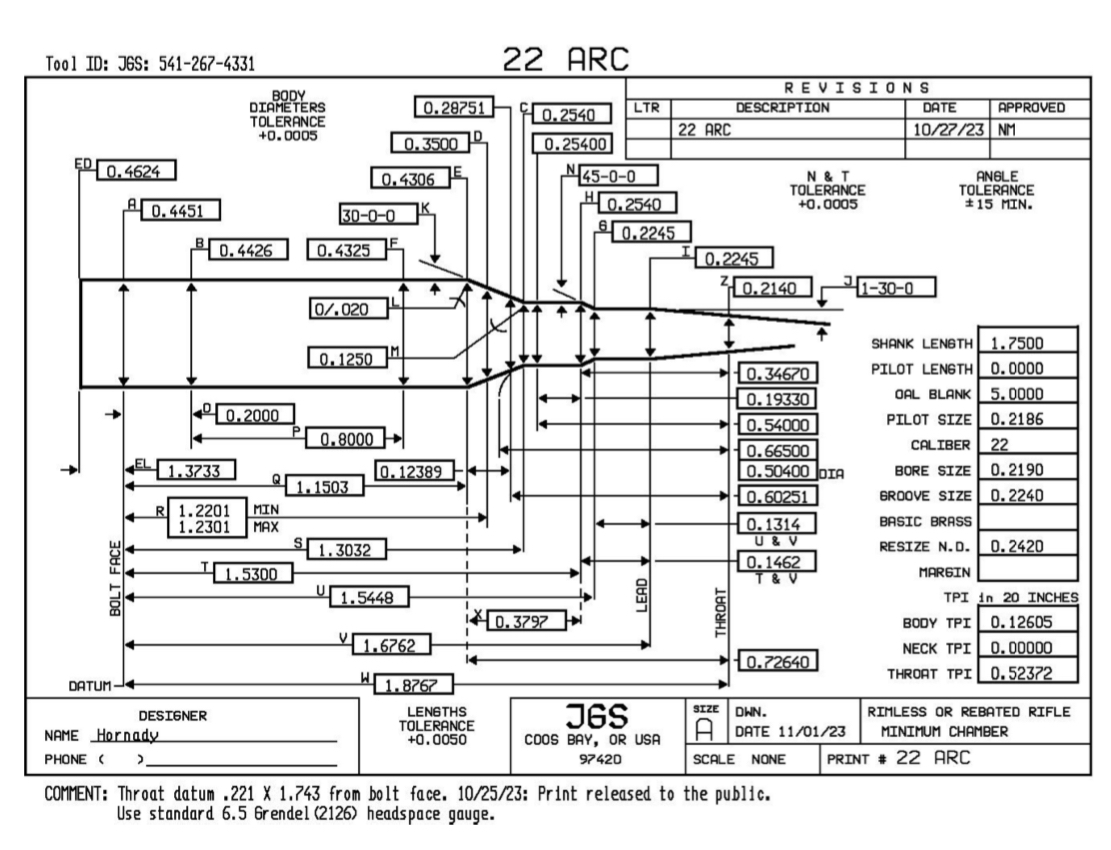

that’s right, the arc has NO optimizations or efficiency increases over a 6mm grendel. in fact it is at a slight disadvantage with a decreased powder capacity. hornady could have redesigned the shoulder of the case to make an actual improvement but didn’t. they just bumped the shoulder down 30 thou and make it to were most people have to hornady components. it’s just a marketing ploy to make people buy their sub par shit.

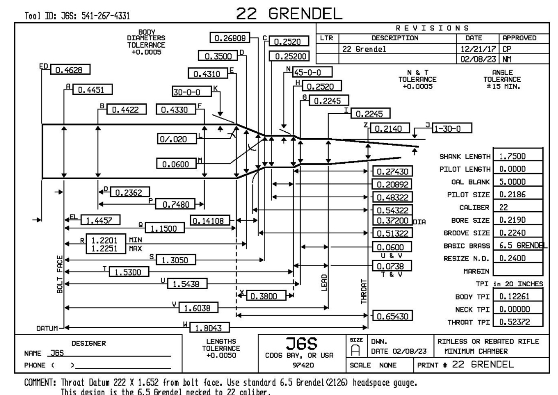

I'm guessing there are two reasons the 6A case is 0.30 shorter than the 65G:
1. They want to seat their long 6mm 108gr bullets to 2.260 mag length while keeping the bearing surface above the case shoulder; supposedly that's a built-in accuracy feature.
2. They wanted/needed to make the 6A case different enough from 65G so guys didn't jam 65G cartridges into 6A chambers. Greedy lawyers have created hassles for normal people in more ways than I can count....
Having said that, yes, I wish the 6A case was the same length as the 65G case, but it's not a deal-breaker.
I'll add another.
3. Robert Whitley and his quest to sue anyone who dared market a straight up 6mm Grendel, sorry "6mmAR."
I think that your #1 is the main reason for the development of the 6 ARC, but Whitley certainly gave a company like Hornady plenty of incentive to think outside the box a bit.

ARC is optimized for accuracy in a wider spectrum of chambers and function in all known magazines. Hornady introduced a cartridge that performs on par with SPC/Valkyrie without the massive accuracy issues. ARC does not outperform 22/6 Grendel ballistically. Further, since this is a Hornady product you can actually buy loaded ARC over the counter.
If you guys would like more information on why Hornady need to step up look to White Oak Armory, where they show the destroyed BCGs because the chamber and cartridge Designs wasn't quite perfect. IMO, I believe that the chamber cut is probably the critical issue being faced... I just hope that the Industry don't go down the same road like the .224Valkyrie not understanding that it doesn't use 5.56/.223 burn rate powders.....Like the Valkyrie( & 6.5Cm) it uses powders in the 4350 burn rate and will require a rifle+2 gas system or you will continue to destroy the brass cases. I have two guns just waiting on barrels. I hope that Faxon is on board because I've had great success with their barrels ..( own six).. I hope this bring some insight.
