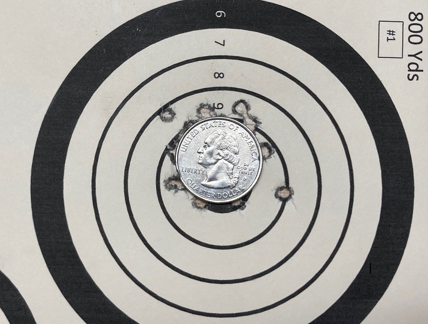

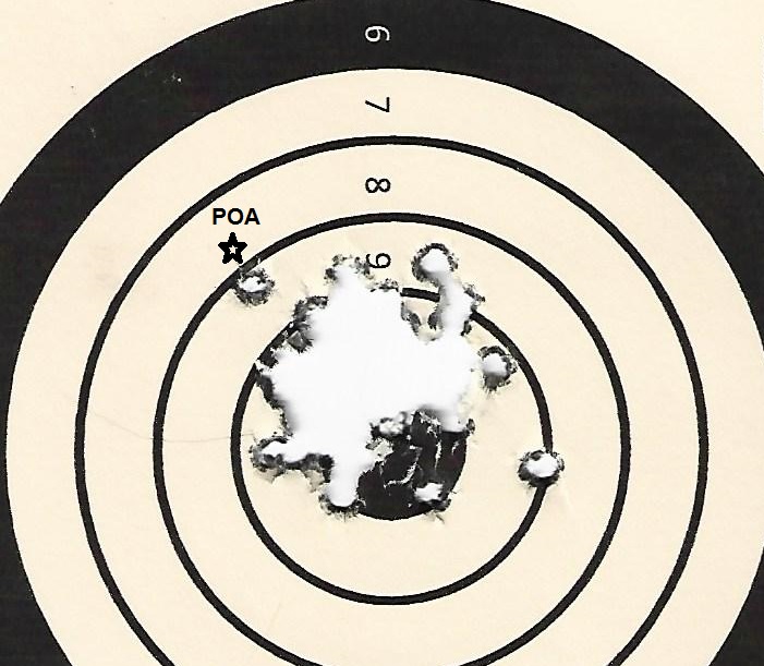

You mean like this ;) 50 shots with a random lot at 100yds. even, there is a way to minimize all this SD & ES it is called tuning.
to the OP the best thing is to select higher grade ammo right now Lapua is King you will have better chances of finding ammo that will shoot consistent.
