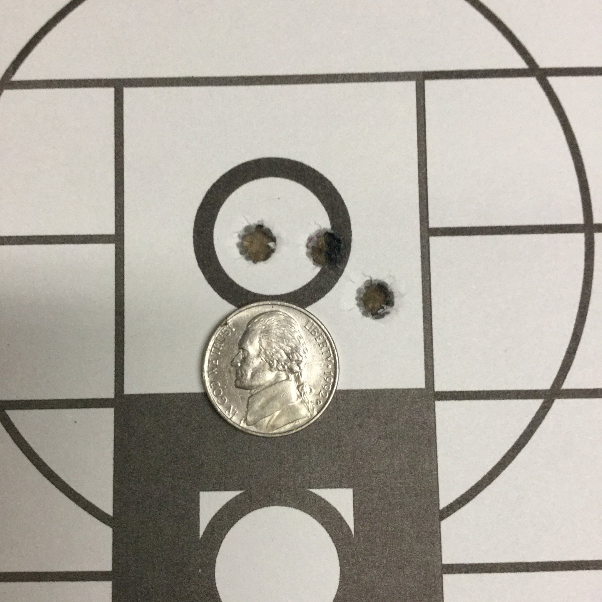

I bought my Rem 700 used. The guy had it done with a 12 twist for whatever reason. 100 gr is as big as I can go. Shoots in the .5” range, but go to a bigger bullet or a vld and I instantly get shotgun pattern groups. this rifle with a fast twist barrel would be very interesting with those new Black Jack 131s. The pic is a 200 yard group that my wife shot the first time she ever shot a precision type rifle. 4F3C389C-720F-4B7B-B107-650C26E3A8A8.jpeg
