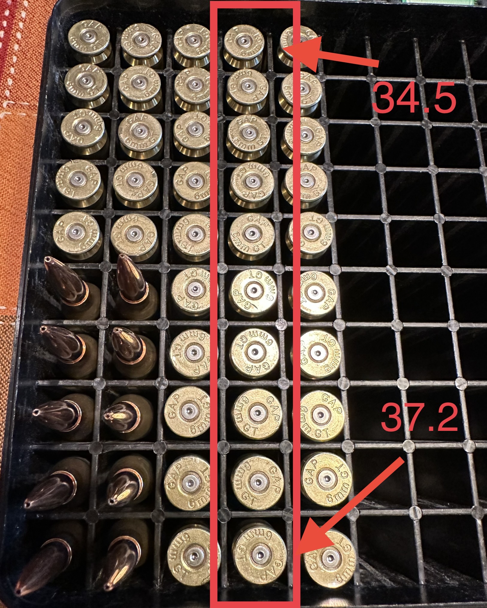

Tried the 134s today. I shot a ladder looking at velocities and pressure limits. 36.9 and 37.2 were just over 100% capacity. (Very light crunch on bullet seating) round was super consistent had no problem keeping them all on an 8x12 plate at 500. Could spot trace easily up until 36 grains. Minimal recoil in 21# rifle with ACE Brake. All and all very similar velocities to the black jack bullets. Never saw any bad pressure signs maybe slightly flat primers. At 36.6 the blackjacks did 2780, the bergers (with pressure do 2722, and the Hornady do 2740.
GAP brass
Cci 450
H4350
CBTO 1.914
OAL 2.647
34.5 2596
34.8 2624
35.1 2628
35.4 2659
35.7 2672
36.0 2691
36.3 2717
36.6 2740
36.9 2754
37.2 2798
GAP brass
Cci 450
H4350
CBTO 1.914
OAL 2.647
34.5 2596
34.8 2624
35.1 2628
35.4 2659
35.7 2672
36.0 2691
36.3 2717
36.6 2740
36.9 2754
37.2 2798
