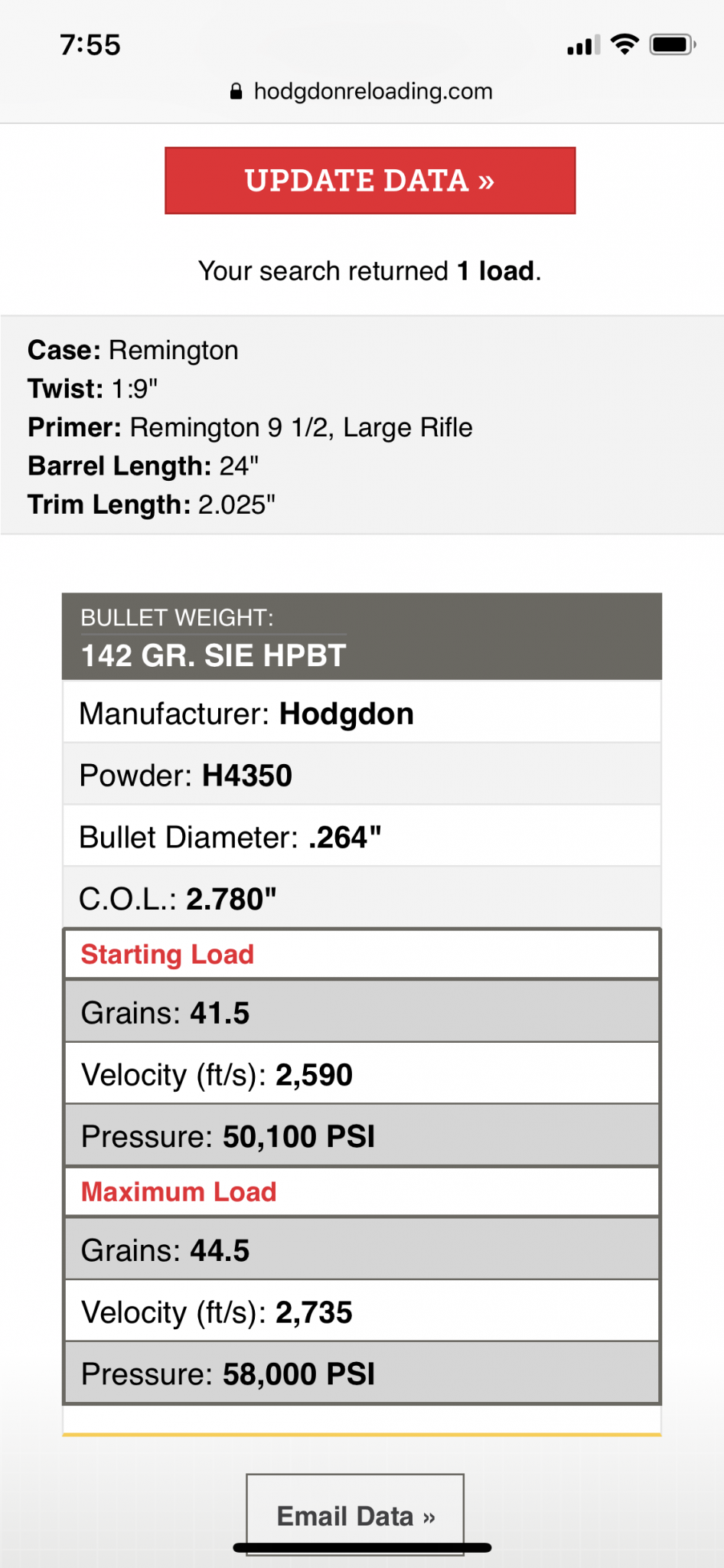

Hodgon Reloading lists a 142 SMK and 44.5 gr H4350 at 2.780” OAL as max just under 60K psi.

I'll have to look that Hodgon SMK load up and QL is saying a 260R, 142 SMK and 44.5grs of H4350 in a 24" barrel at 70 degrees is 2931fps at 72,738 psi, that doesn't seem right....
I'll have to look that Hodgon SMK load up and QL is saying a 260R, 142 SMK and 44.5grs of H4350 in a 24" barrel at 70 degrees is 2931fps at 72,738 psi.

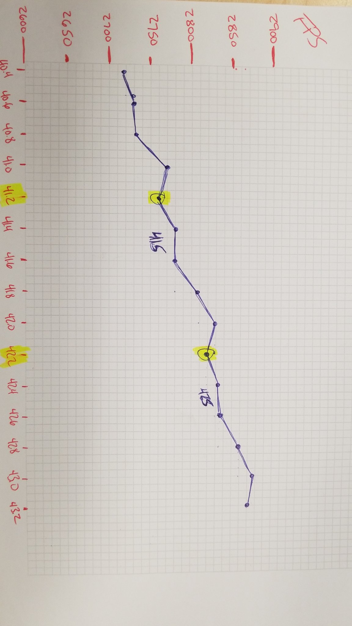

42.2 grains is my go to load. Very simiiar to your findings Defender3. Shot 2 rounds for each charge weight. Weighed on a FX 120i and Magneato speed. 2830FPS avg SD6.
There's just something about 42grs of H4350! Nice old school graph too. :)
