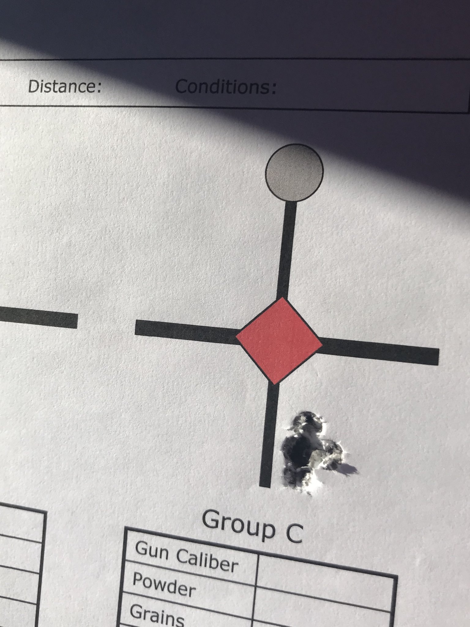

This is a group my wife shot on Monday. It is the 42.8 4451 load with 140 Berger Hybrids. It was her 4th time ever behind any rifle and her first attempt at shooting a group (5 shots) at 100 yds. I think I'll keep her (LOL).

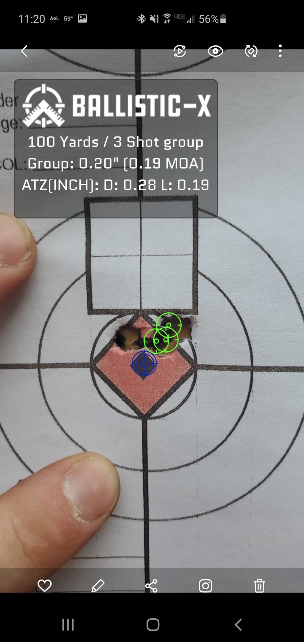

Did a zero check on my desert tech 260 22 inch Saturday. I know its only 3 shots but im extremely happy with this. 4th shot on the left was adjusting the zero
147s eld
47.7 h4831sc
Peterson brass

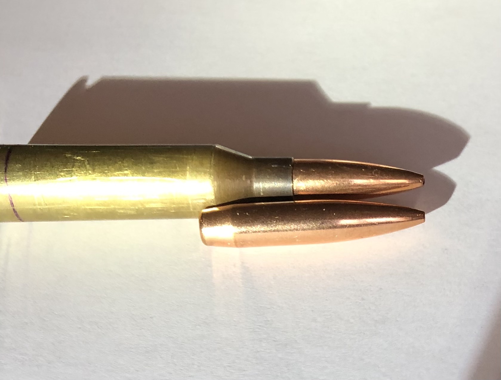

here’s a question for the experienced reloaders…. I have to seat the bullets past the neck/shoulder junction to stay within magazine length. It took me quite a while to figure out that after four firings on each piece of brass a brass donut was building up. So I ream the brass every four firings with an LE Wilson neck reamer that is tailored to my brass so that it only removes the donut portion, and none of the interior neck wall. My question is… Is this pretty normal for cartridges that must be seated deep? I anneal every firing with an AMP. The brass grows about .004 every firing, and I trim it after every firing as well. Anybody else have the same type of experience with bullets seated past the neck/shoulder junction?

No that’s not normal to have to seat super deep like that or have that much brass growth. How are you measuring where jam is? How far back are you setting the shoulders and how are you measuring?
I measure jam with a Hornady OAL Gauge using a fire formed piece of brass from my rifle. I use 3 fresh Lapua 139gr bullets to take multiple (6-10) measurements, so I am pretty confident of the final number. The COAL is just a touch under 2.850, and the limit for my AICS AW mags is 2.880, so I don't have much more to play with... looking at the pictures below, trying to move the bearing surface in front of the neck/shoulder junction would exceed my mag length by a LOT. I will have to ask my gunsmith how much freebore he used, but even if it is .100 it could only be increased to about .160-.170.... not enough to make a difference? I'm guessing he used the longer freebore already.
I set the shoulders back .002 as measured with a Sinclair Bump Gauge. Fired brass is 1.571 and is bumped back to 1.569.

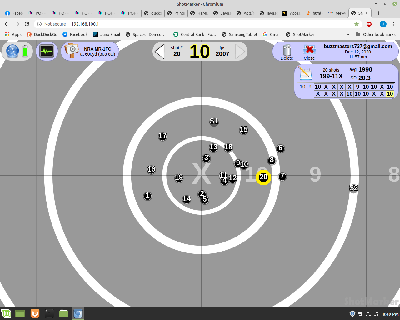

I shoot mostly PRS, and a little F-Class. Results have been fine... shot a 199-11x in December with a group of 20 that was only .266" tall at 600 yards (in the picture, the X ring is 3" diameter, and the 10 Ring is 6" diameter)... so it shoots fine... just builds donuts and grows .004 per firing. I got 15 reloads out of the last batch of brass before primer pockets got a little loose. I guess this is one of those setups that is "not optimum, but it works"???

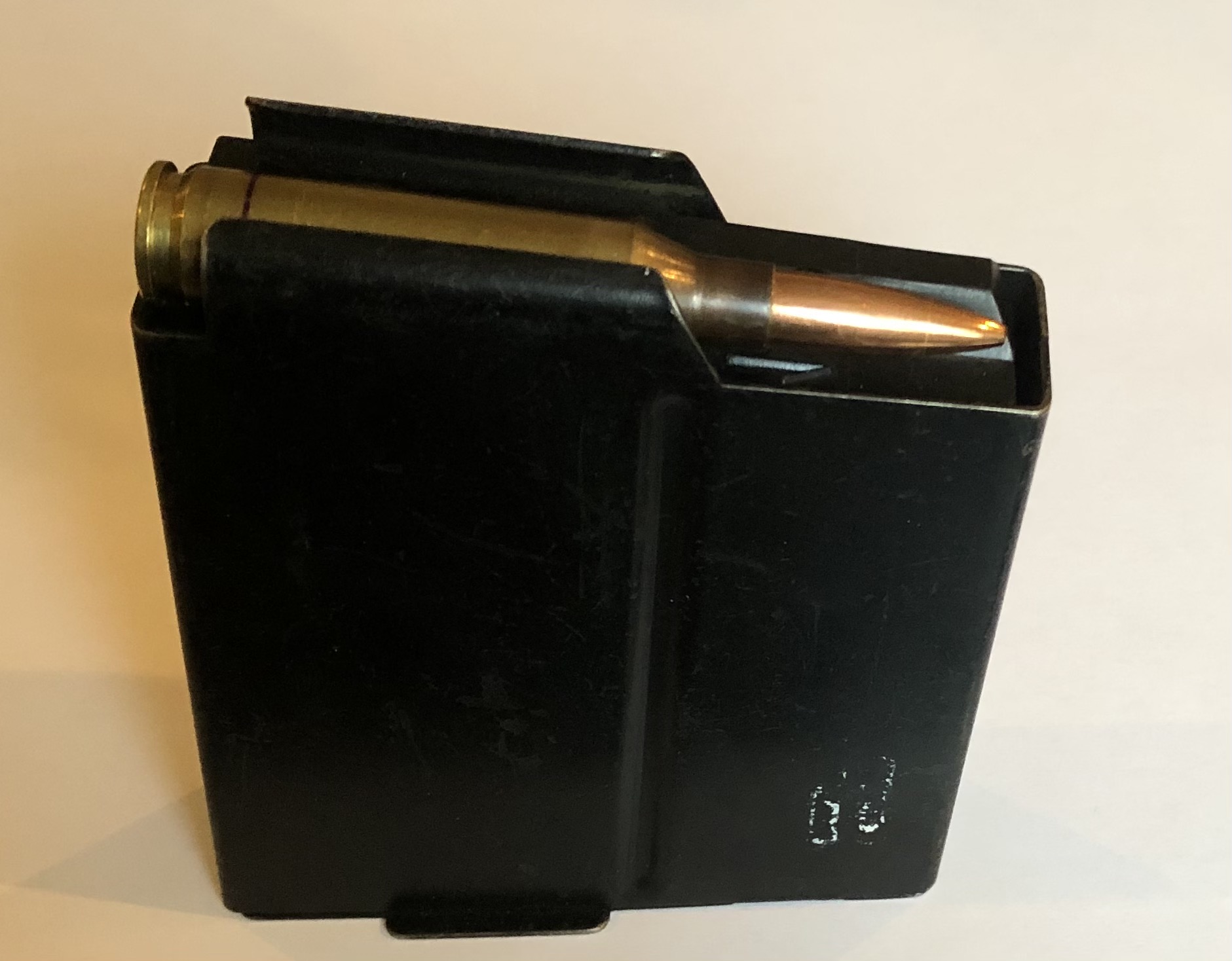

I have an AI AT and I'm pretty sure they use the same mags as the AW. I'm able to load my 140 hybrids to just shy of 2.960. 2.955 clears easily.

@riffraff, I use AW mags for my 260 and load 136g Lapua Scenar Ls to 2.880” OAL and still have plenty of room if I wanted to load longer. Below is a picture of a round in the mag showing that I have 2.980+/- available in the mag if I wanted to go longer. I’ve never heard of anyone having an oal issue shooting 139s from a 260. Either your throat is way too short or you’ve gotten something wrong along the way.
ETA: I know that the picture angle makes it look like the case is hanging over the back of the magazine, but trust me that that round is in the mag and it’s just the one-handed cell phone angle that makes it look that way. I have loaded and shot somewhere around 10,000+ rounds with this exact spec and bullet, all at dynamic ranges and targets during matches or practice. 👍🏻😎
