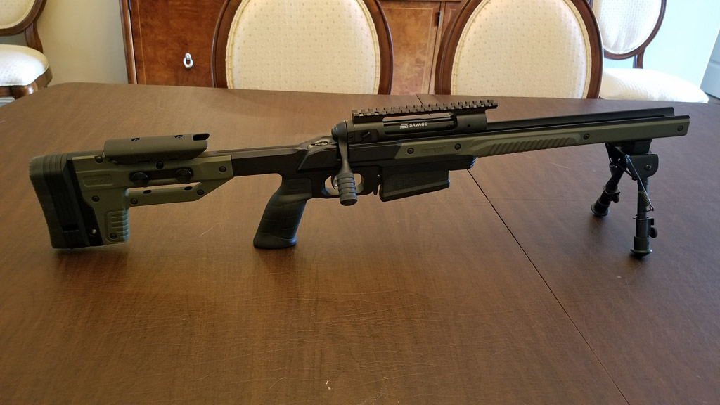

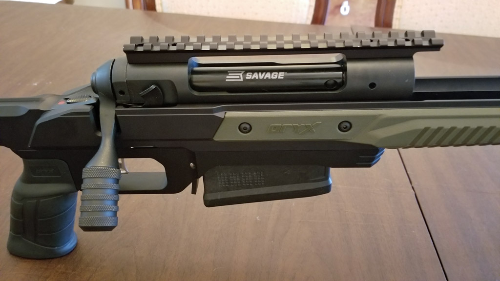

I am currently building a 284 Win with a Savage 110BA LA action in an MDT Oryx chassis. I am currently waiting for the McGowen barrel which is being throated for ELDM 180s set at 3.24" COL. I am using Magpul PMAG MAG671 (30-06) magazines. My rounds feed perfectly with these magazines in the Oryx chassis.
Previously I tried building a 284 on a Savage SA however there's just no way to magazine feed long/heavy rounds. It shot great, however I was limited to 162gr bullets.

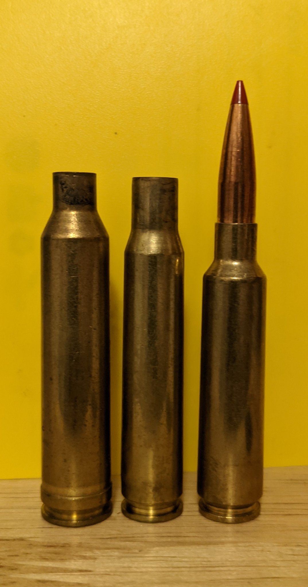

I'm planning on building a hunting 284 Tikka, but haven't yet. That said, I don't know why you would need to go with the 300 WM magazine, the 284 is shorter and only slightly wider than the 30-06. Here are cases for the 7mm RM, 30-06, and 284 Win with a 162 ELD-M (no barrel yet so seating depth is just what looked good). The 284 feeds just fine from the Tikka 6.5x55/30-06 magazines.

I built my first 284 Win on a Savage SA which is limited to 2.86"-2.95" mag feed. I want to load to 3.20+ COL so I went with a Savage LA and I'm using the PMAG MAG671 (30-06) magazines which give me plenty of length (3.34").
I think a 30-06 action/magazine would be plenty long for 180/190 gr bullets in a 284 win.

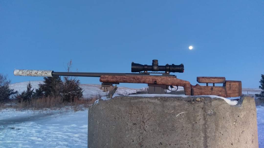

Mine is a 6x284
First picture is how it started.
19" Win M70 LA I used for matches.
Rebarrel in 22" 6x284 in a T4F
I use 300 WM mags pinched ever so slightly but I have a pair of MDT 30-06 mags ordered.
