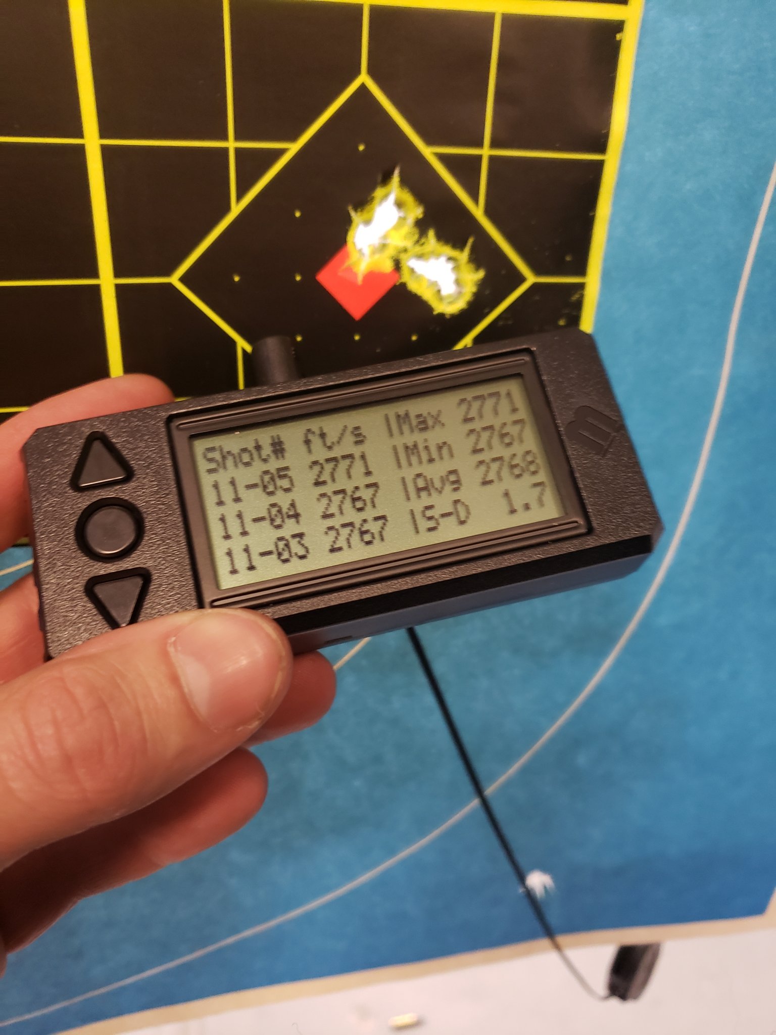

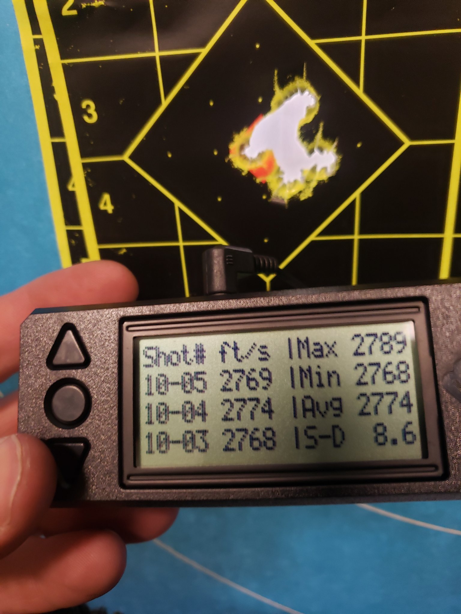

I had an ever so light shiny spot from the ejector in my 285gr load above. Couldn't feel a difference in the bolt lift and couldn't feel a ridge on those shiny spots with a finger nail once I got home.
Shooting in mid-50s yesterday, but I plan to take a few rounds out when it gets warmer before I take it to a match.
