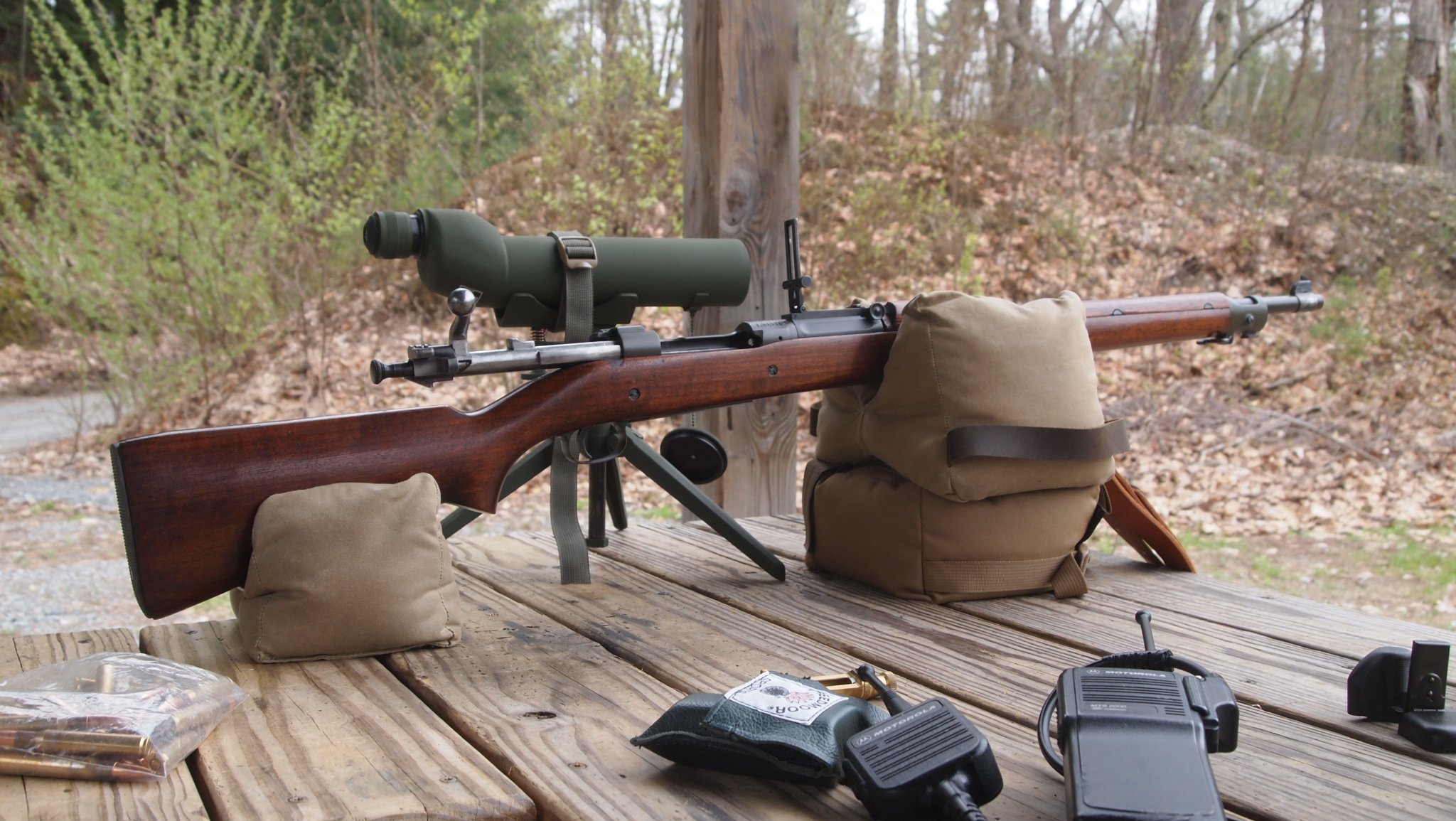

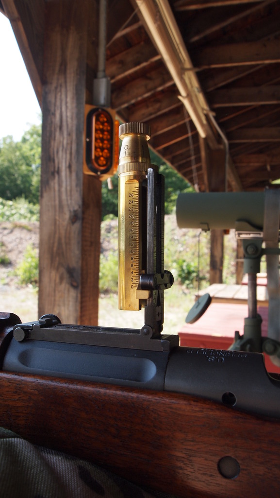

I'll just leave this here;

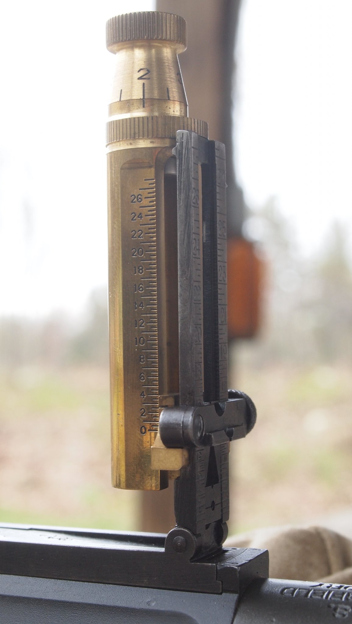

Note the O'Hare sight micrometer attached to the rear sight leaf.
Accurate elevation changes are next to impossible without an O'hare micrometer.
7044407

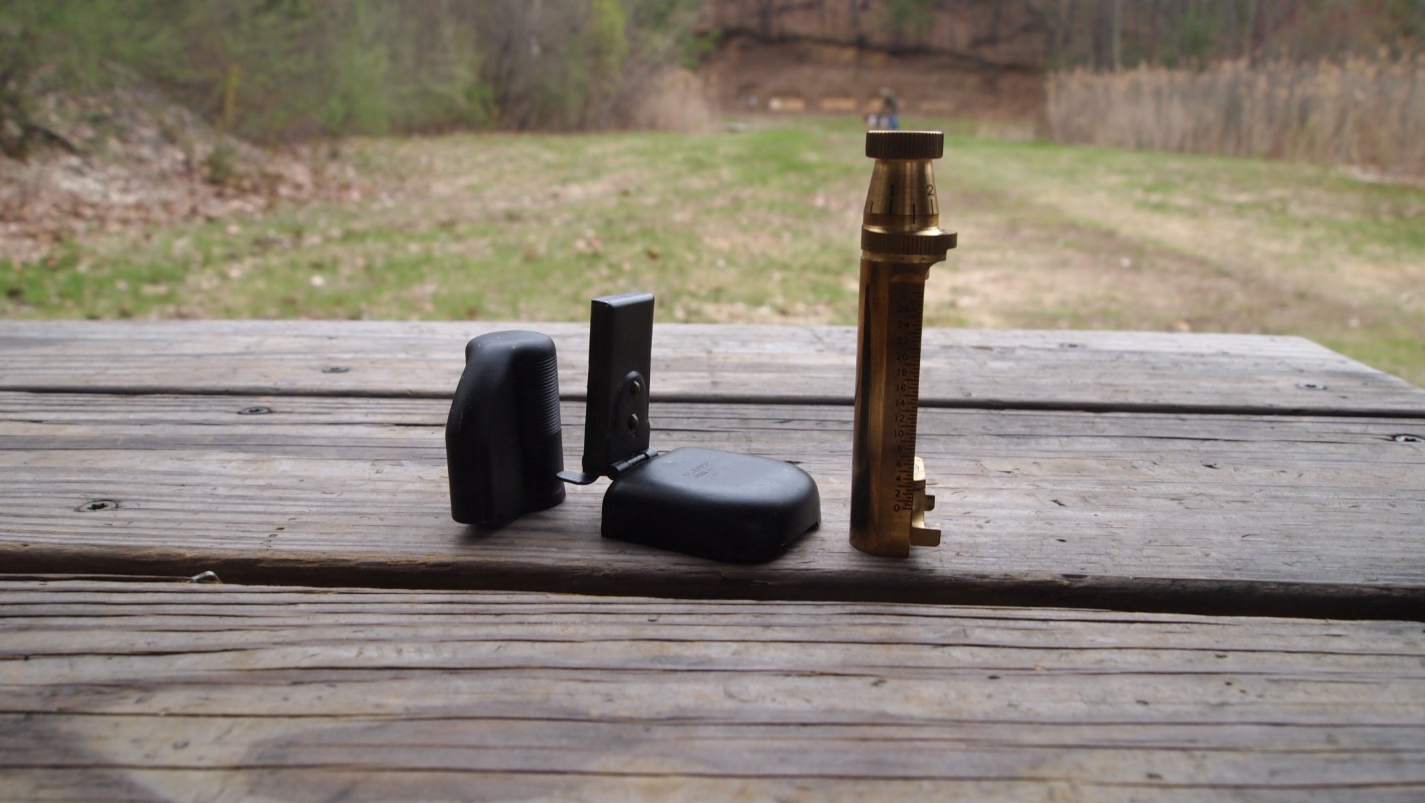

This is a repro I bought a while ago that I dont think is made anymore.
Its Ebay now for older vintage ones most of which usually carry a US mil inventory mark.
Just out of curiosity, does the sight move under recoil? Seems to me with that much weight on the hinge it might fold down under recoil.
No not at all.
If you are assuming the brass Ohare stays on there during firing thats an easy enough mistake to make but thats not what happens.
You attach the Ohare, make your adjustment (1/4 MOA per click) than remove the Ohare and fire.
There is a pretty good spring under the sight leaf that keeps it standing tall.
The mechanism can get sloppy from hard use and usually peening or replacing a spring will keep it serviceable..

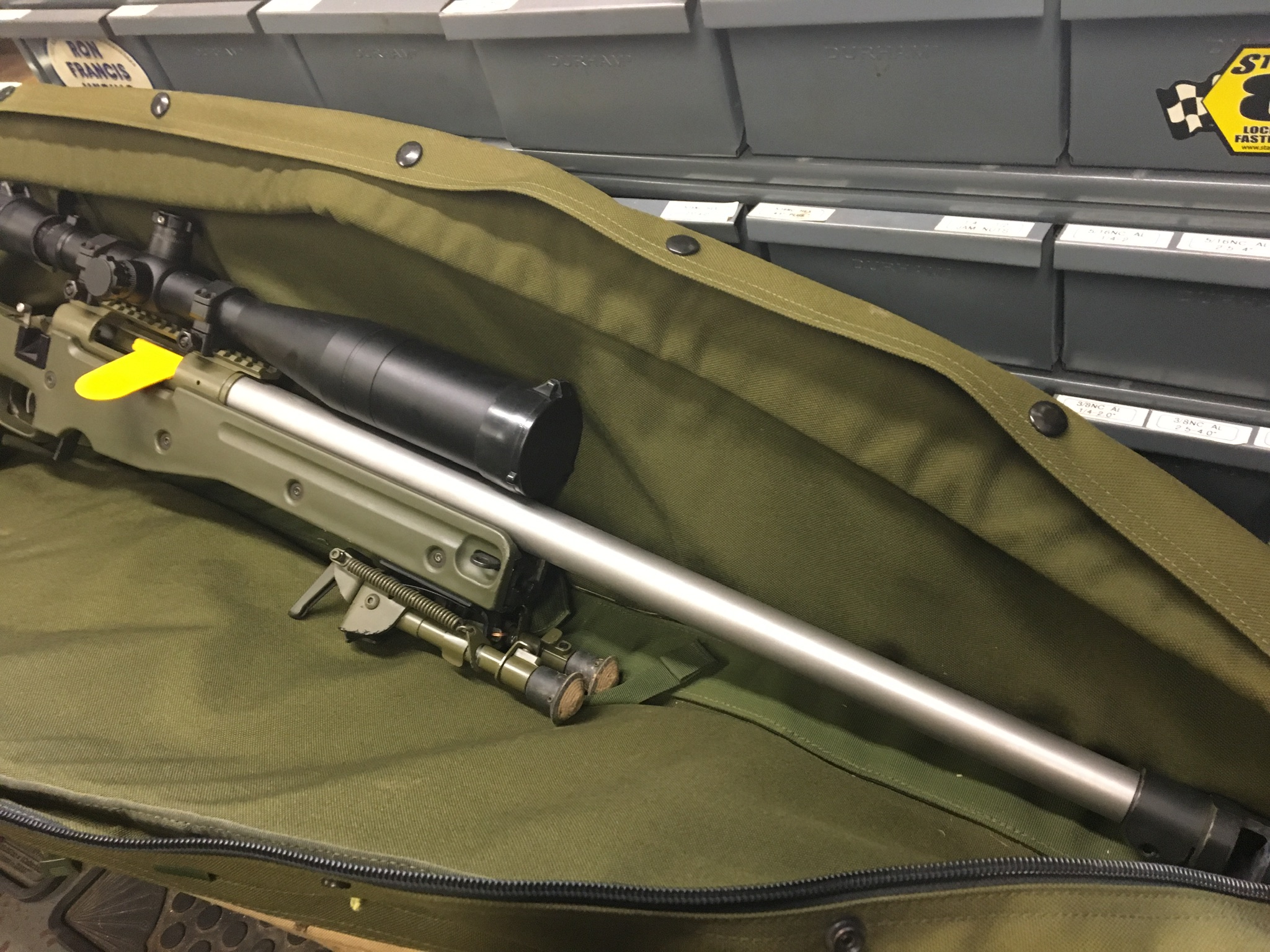

I guess I’m kinda’ late to the party...

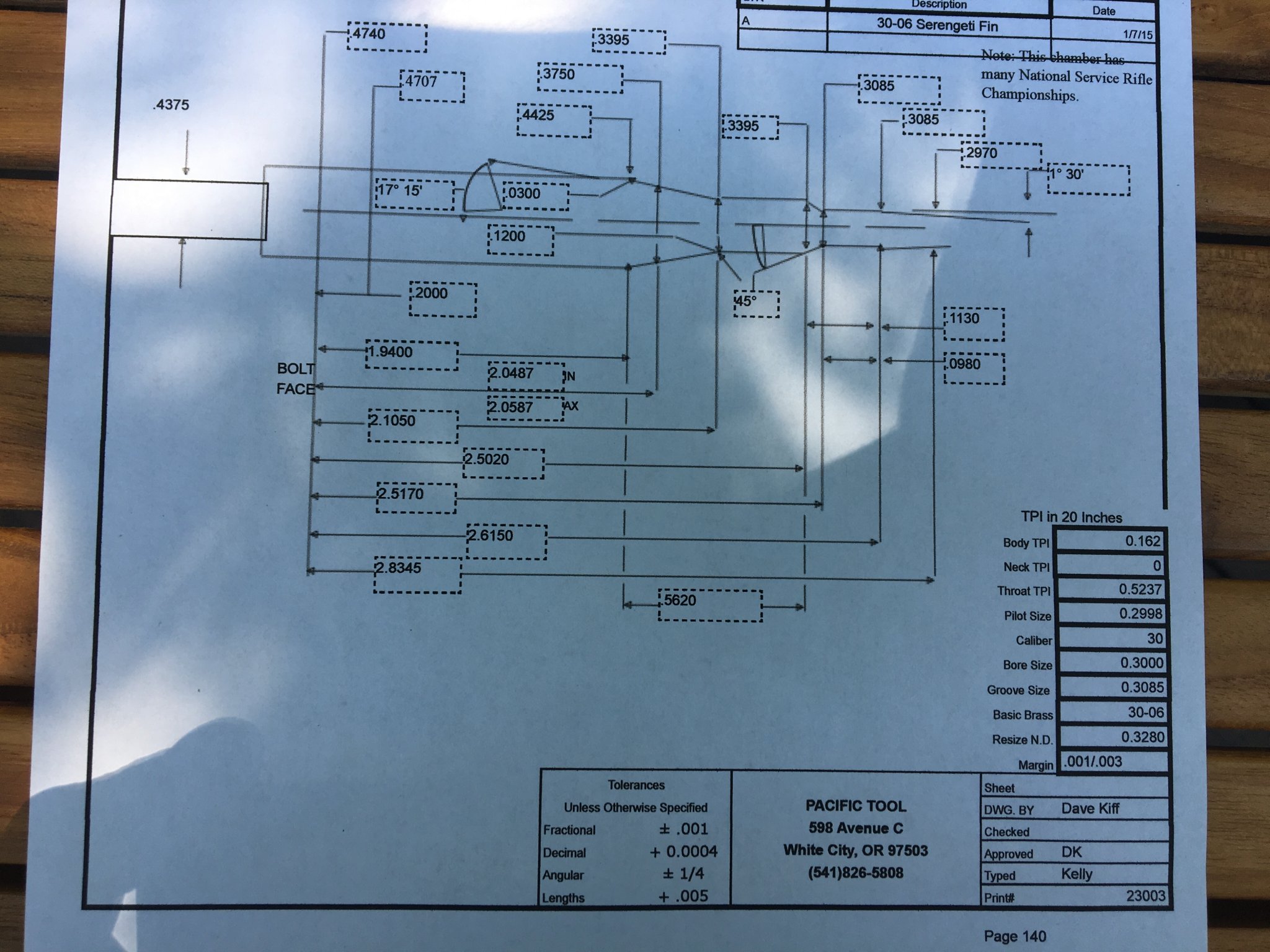

About a dozen years ago, two pretty well respected members here began to post their 30-06 ballistic performance at long ranges with modern powders and projectiles.
One was MontanaMarine and the other was USSR. I don’t see either of them here anymore. Maybe they both skipped the Scout thing; I know I did.
I was intrigued at the prospect of getting 300WM performance without the barrel wear. But more on that in a minute....
So I found a R700 donor action and a Shillen select 10 twist and had my smith build me a 30-06 barreled action that went into an AICS 1.5. This rifle was chambered with a match reamer that was optimized for 190SMKs. I had 400 Lake City M72 match cases and began load development.
This thing shot everything well but two loads stood out: 208 Amaxs over 60gr of RL22 and 155gr Lapua Scenars over H4895. The 208s ran about 2760fps or 29.5 MOA to a thousand yards. This was a very compressed load due to the chamber dimensions. The Scenars ran a whopping 3250fps and were 26.0 MOA to a thousand. The 208s ran well enough for me to place fifth in an F class match at Quantico on a really windy October day .
I only shot the 155s at 1K when the wind was relatively calm at Quantico which was a lot the following summer. I continued to smack my 15x25 IPSA target at a grand with the 155 Scenars until one day at about 1800 rounds the accuracy dropped off dramatically and the barrel was done.
So I put the rifle aside for awhile.
Last year I got a 10 twist Mike Rock and a German Salazar Serengeti reamer and gave my worn out barreled action to a 2112 at PWS and started over.
No more Lapua Scenars running 3250fps.
Now I’m running 208ELDMs over RL17 in Win cases and 210SMKs over RL22. Both run about 2750 and are both 29.5 MOA to a thousand on Range 4 Quantico. At least they were last Sunday in 38F weather.
And I’ve staged my stuff to go tomorrow....

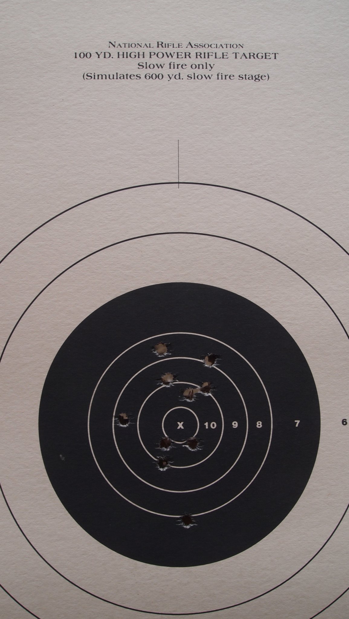

Nice shooting @pmclaine, I really love the `03 Springfield you have there, she is a fine example.
I finally carved out a little time last night to start loading for the 30-06; 175gr RDF over H4350. My rifle, a Rem 700 Long Range, has not been fired yet, but once it has started the break-in period, I will run a ladder test. Starting at 55gr and going up .5gr increments to 59gr max load.
Reactions: CuTm
Interested in your results.
My load was 46.6 Varget with 168 Nos CC and WLRP.
Im switching my bolt '06 over to I4350 and 175 SMK sometime soon.
Reactions: CuTm and DRAGON64

Sweet looking rifle, you made me think to. Would you or the OP want to consider a 30-06AI?
Who knows? It’ll take some time to wear this barrel out.
And I like the Salazar Serengeti chamber I have now.

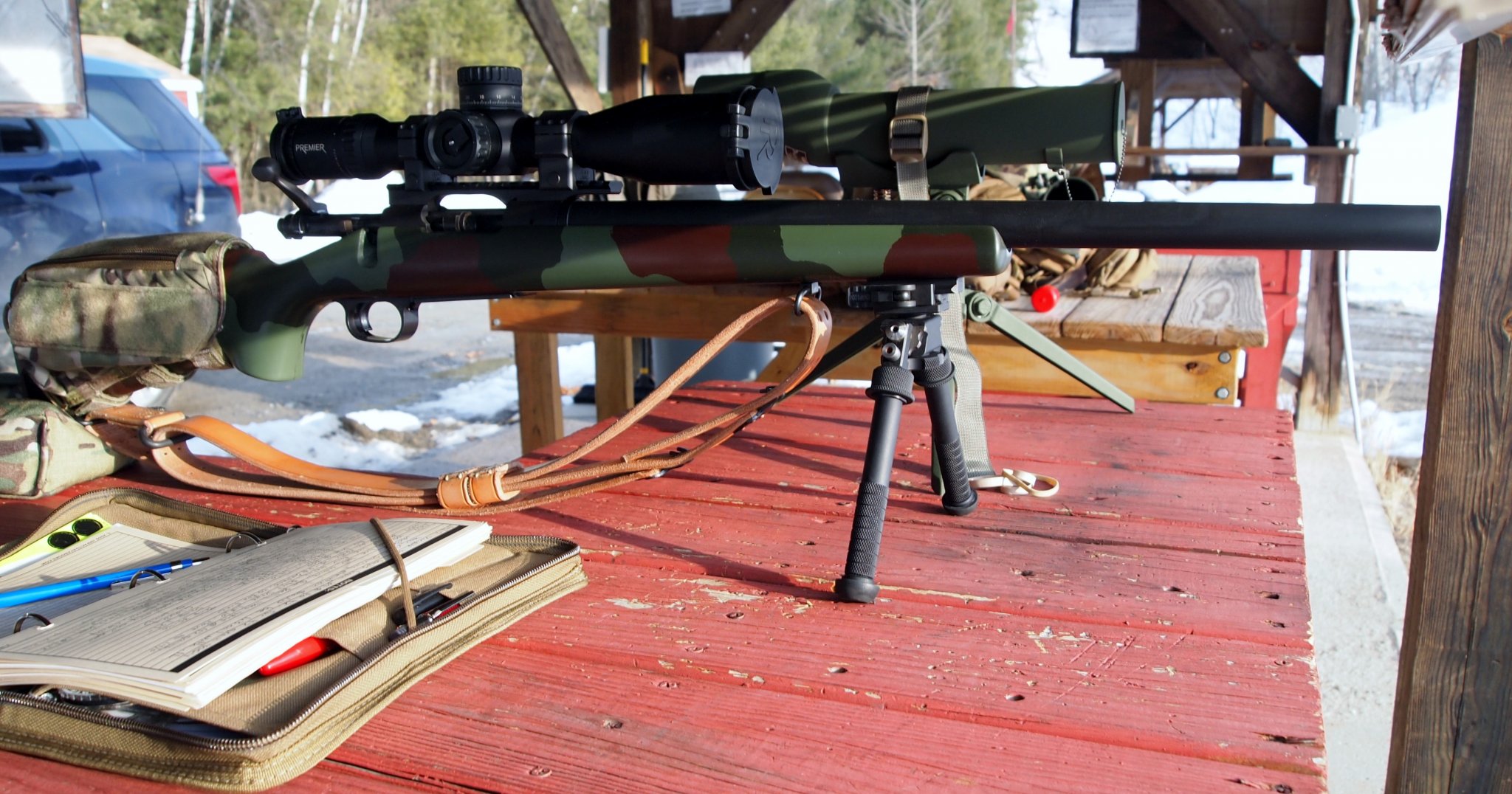

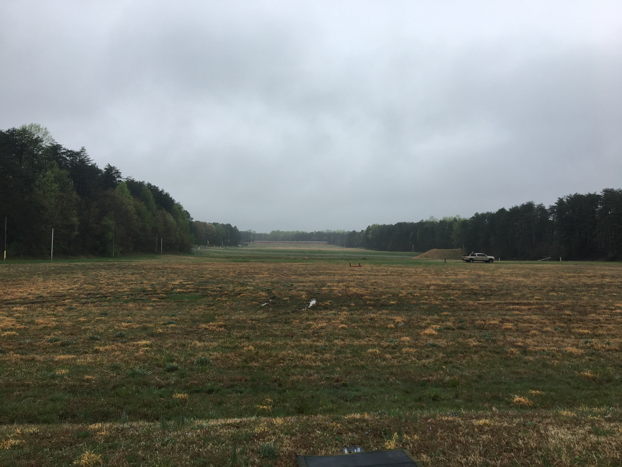

Two weekends ago I shot the 30-06 alongside a match at Quantico. My scores didn’t matter because this rile was illegal due to match rules.
In a pretty steady drizzle I shot a 200 14X at 800 yards and a 197 12X at 1000 yards. 208ELDMs were running 19.5MOA @800 and 27.25MOA @1000.
Like I said, my score didn’t count, but it was fun have a target pulled, marked and scored.

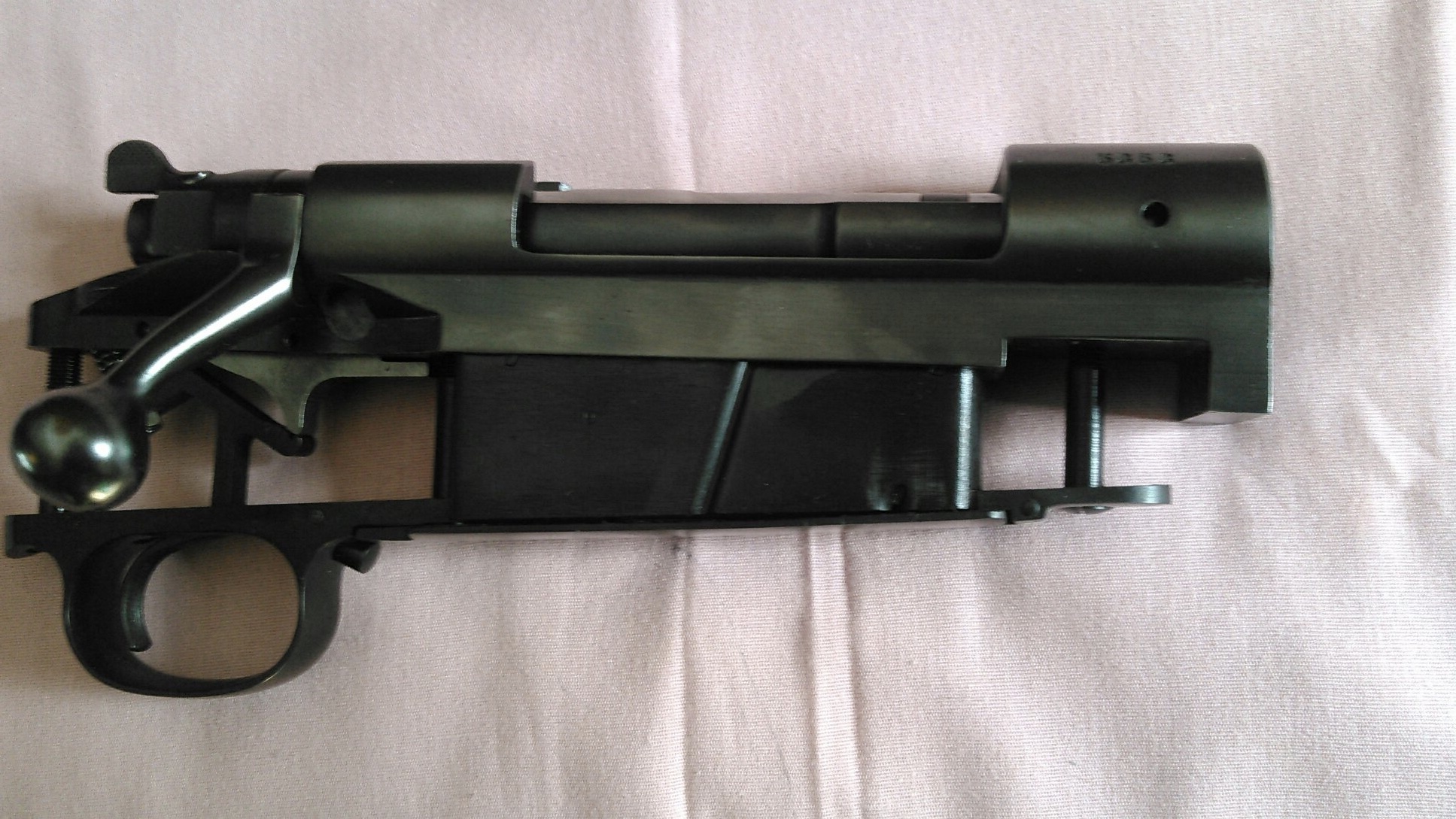

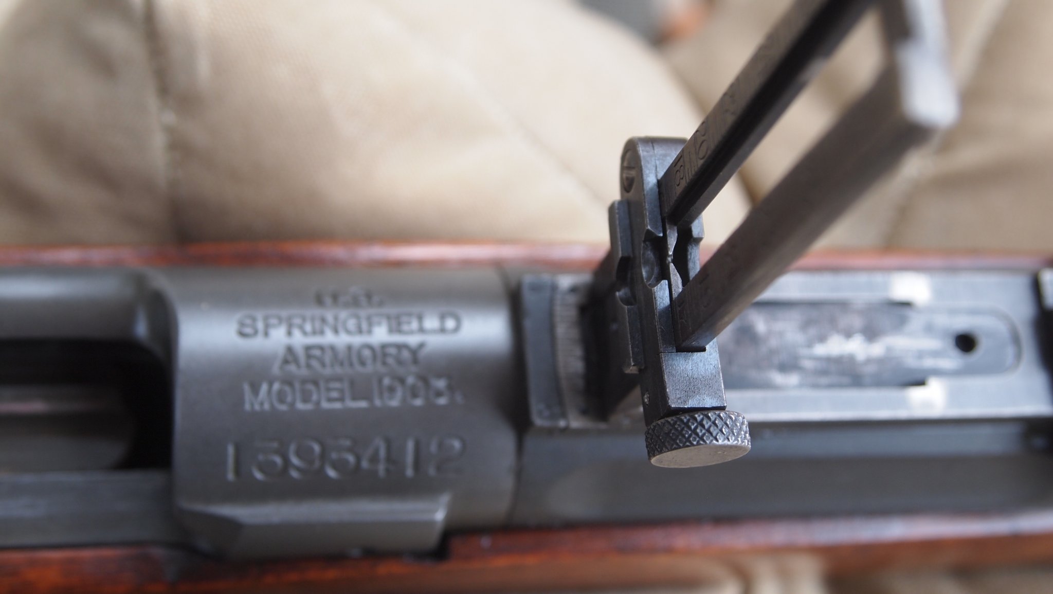

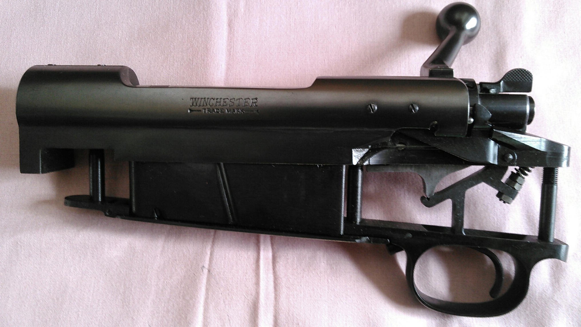

Just bought this yesterday......
Im planning something with a Douglas barrel chambered in 30-06, McMillan stock and S&B 5-25 PMII.
It will do as my 300 WM I wont buy because I dont want another caliber to load.
For those days when I have some doubt and dont feel .308 is what I need.
Nice score Phil!
M70 goodness!
You need a big old Unertl now.
That was USSRs thing, the old member I referred to earlier, M70s in 30-06.

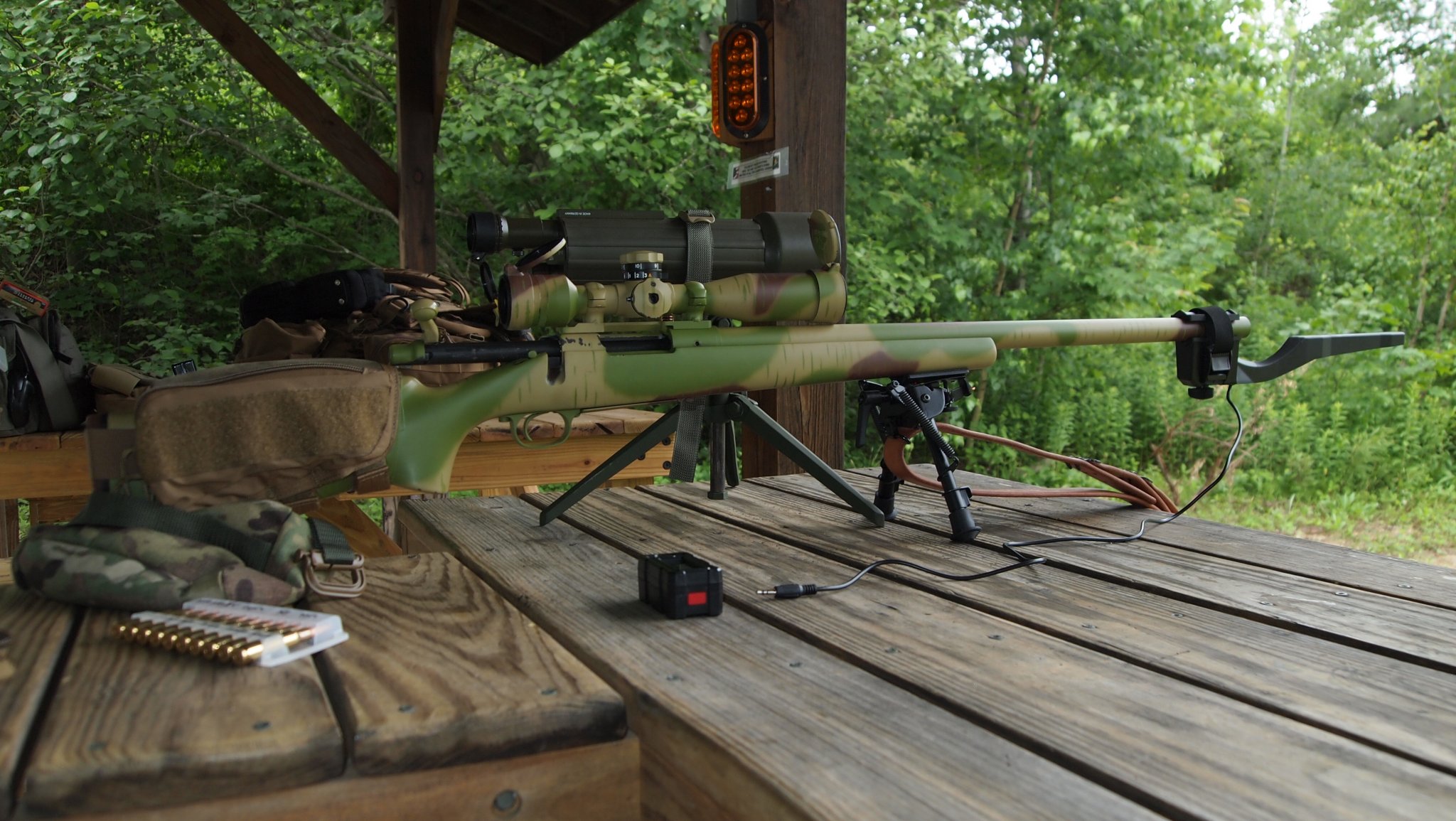

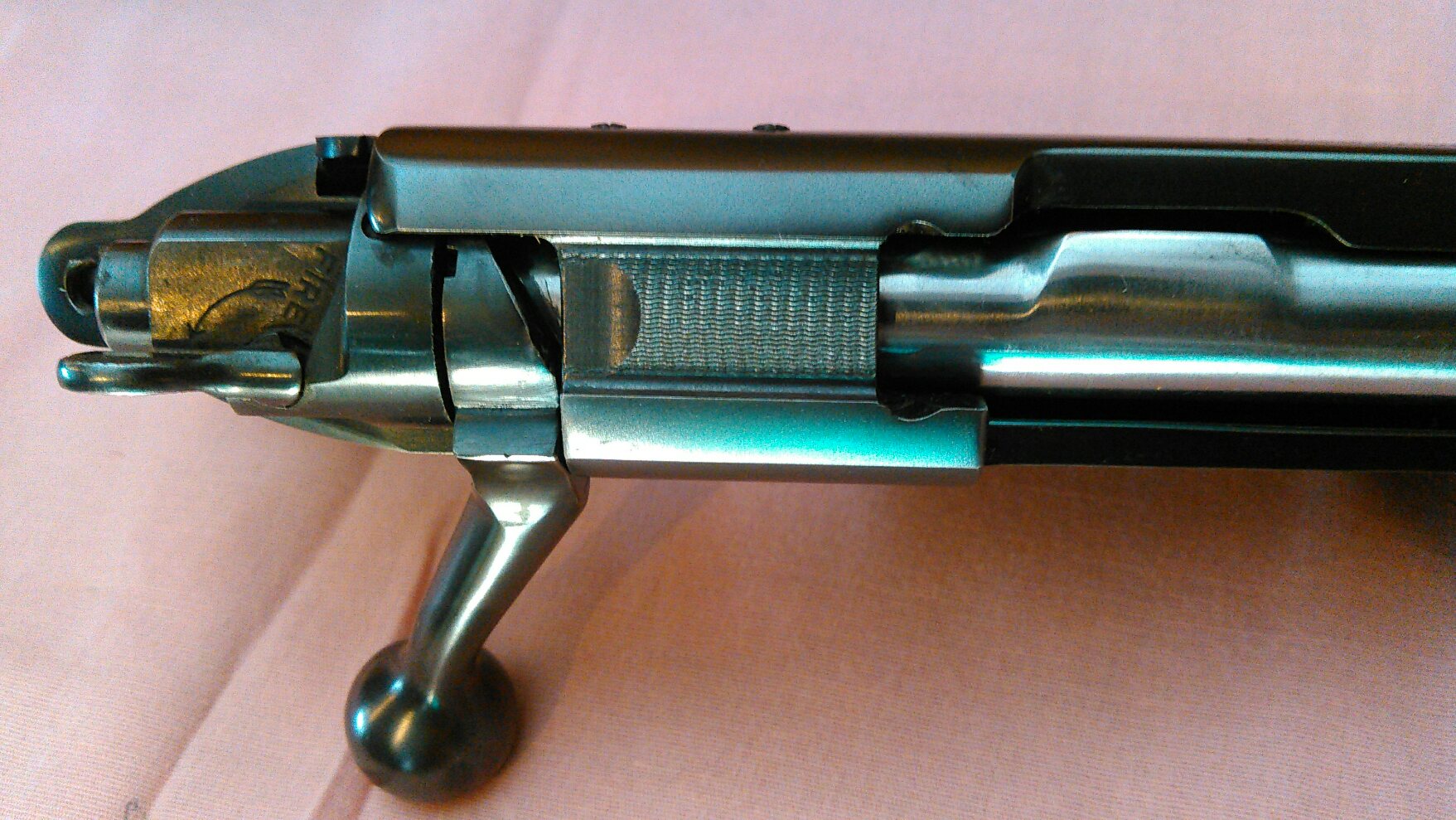

I have the M70 with Unertl set up already, a clone of a USMC VN sniper. Pictures somewhere in this thread I think.
This would actually be a much better receiver for that gun but things don't fall in our laps in a timely manner.
I want a "modern" 30-06 that retains some history. I love the serial number of this receiver.
This receiver, a Douglas SS match barrel at minimum MTU contour, 20 to 23 inches in length. Minimum 1/10 twist, considering faster. McMillan Htg to USMC M40A1ISH spec with an added bipod rail. Badger USMC M40A3 rings and my on hand S&B 5-25 with H2CMR.
Open to taking suggestions regards length/twist of barrel considering 175 SMK to be most common bullet through it and my only readily accessible range being 1000 yards infrequently.
Maybe LRI will be running Winchester services soon.
Biggest decision...........do I dare drill this for a pic rail/scope mount?
I wouldn’t worry about d&t’ing it. It’s not going to be original anyway. You might as well set it up however you want.
Nice find BTW!
Reactions: Eddystone
Real nice action! That looks like a .220 swift magazine box. I have a pre-war action that I plan on building into a precision rig. I am thinking either 30 GOV'T' 06 or a 6.5x55.
