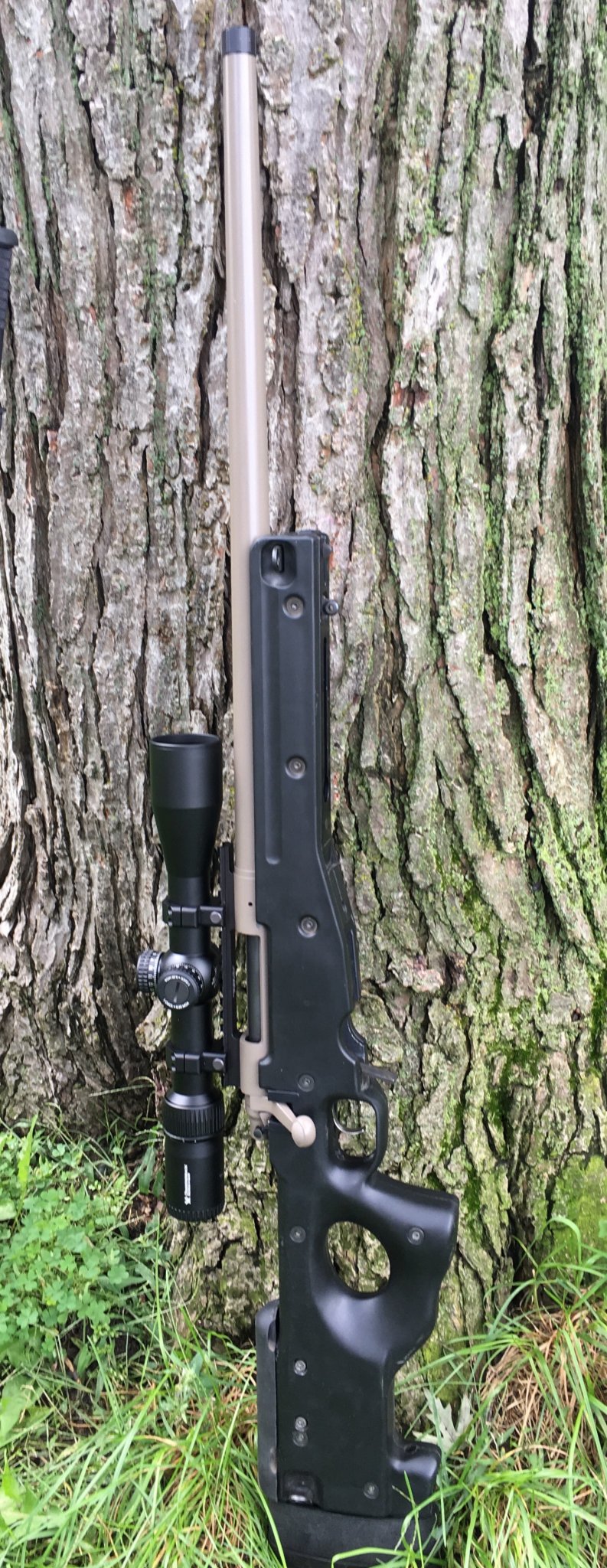

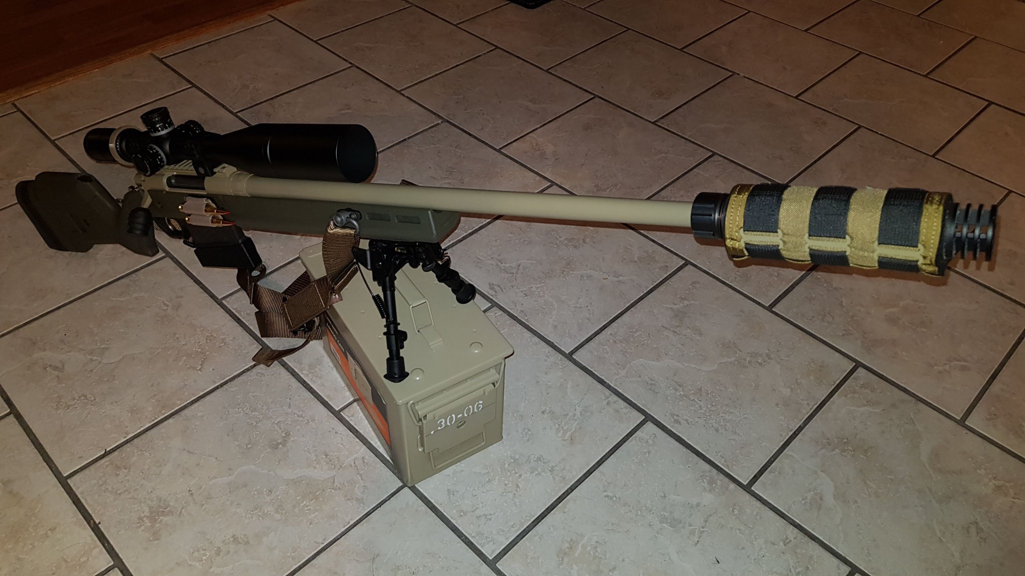

My ‘06 is still a project waiting in the wings. Right now it’s a basic R700 Long Range, 26” barrel with only new trigger and the bolt polished. It’s only had factory stuff through it so far, but I plan on 208s for it once I get the dies.

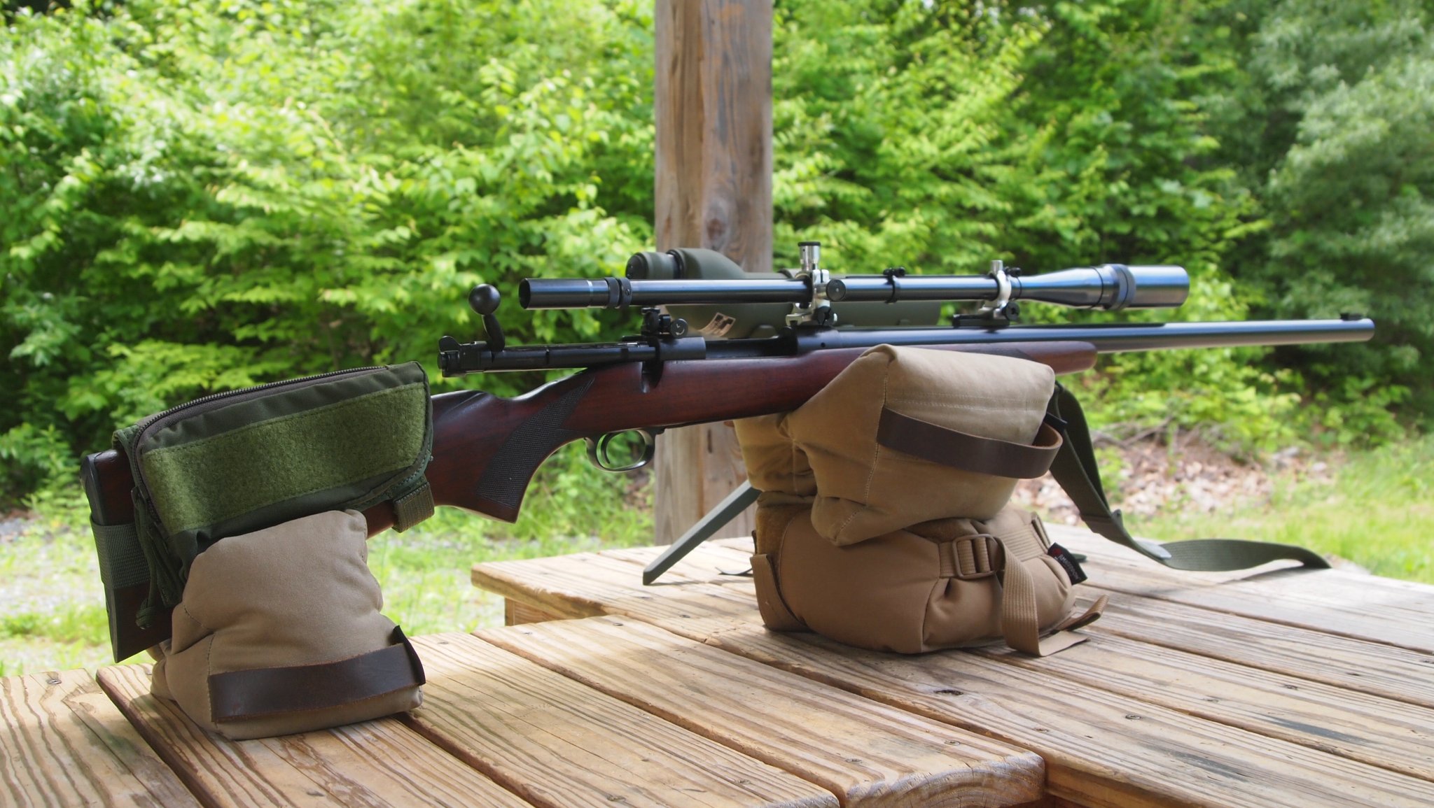

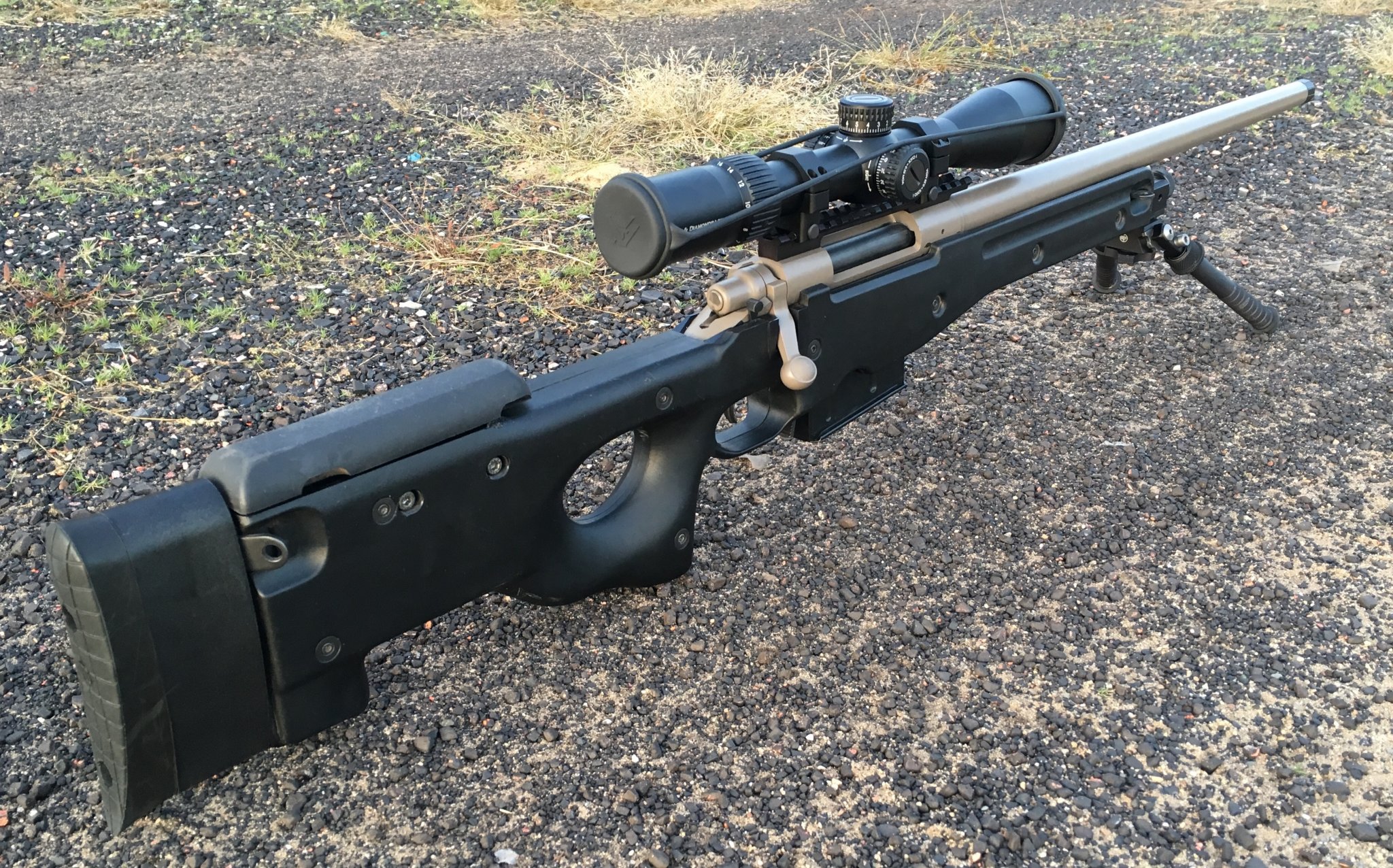

Here is a fairly recent pic of my 06’... 28” bartlein HV slings berger 200.20x’s at 2740-2750... 8mils exactly to 1,000 yards
was shooting them around 2800-2810 but decided to back it down some if i wanted to get more than 4-5 loadings from the primer pockets.

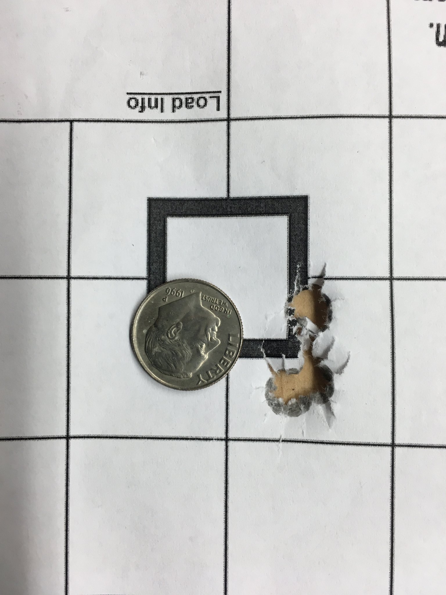

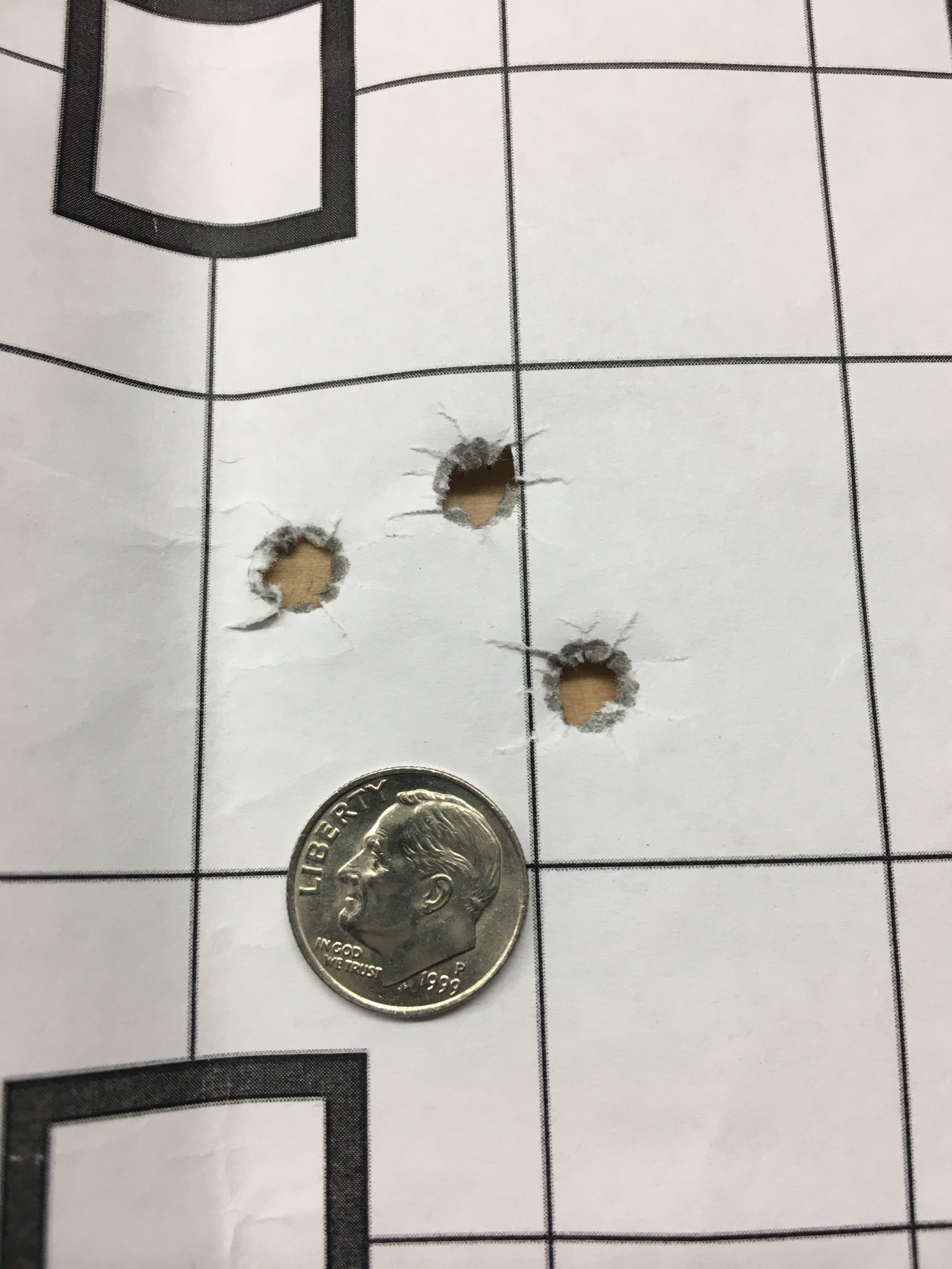

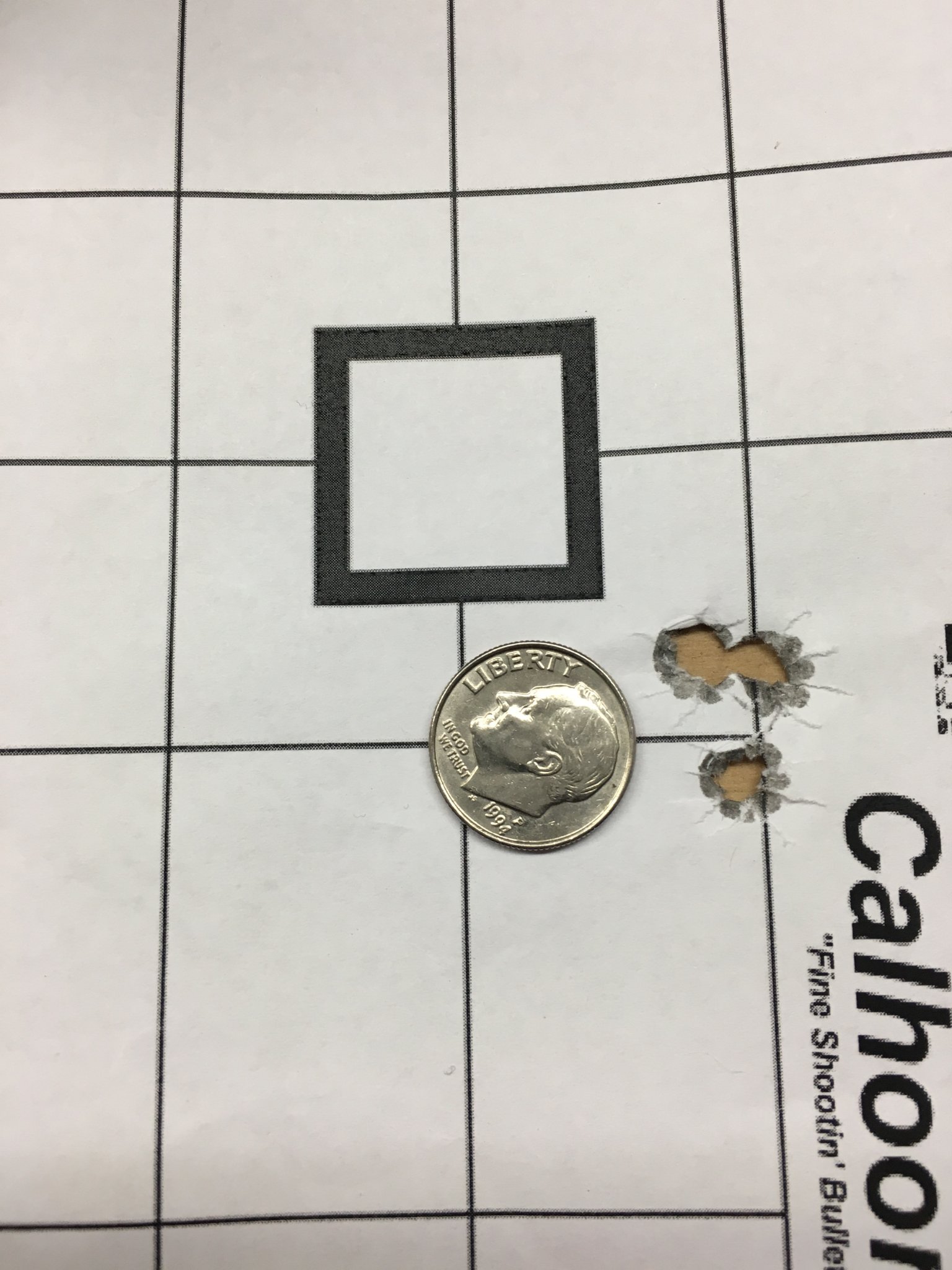

Went to the local 400 yard range last night to do a little load development.
IMR 4350 - 168 Hornady Amax
Reloader 15 - 208 Hornady ELD- M
Both loads looked great and the 208’s put a hurting on steel at 400 yards.
The first group pictured was shot with factory 180 Remington Core Lokt. The Core lokts held a 3.5” group out to 400 yards.

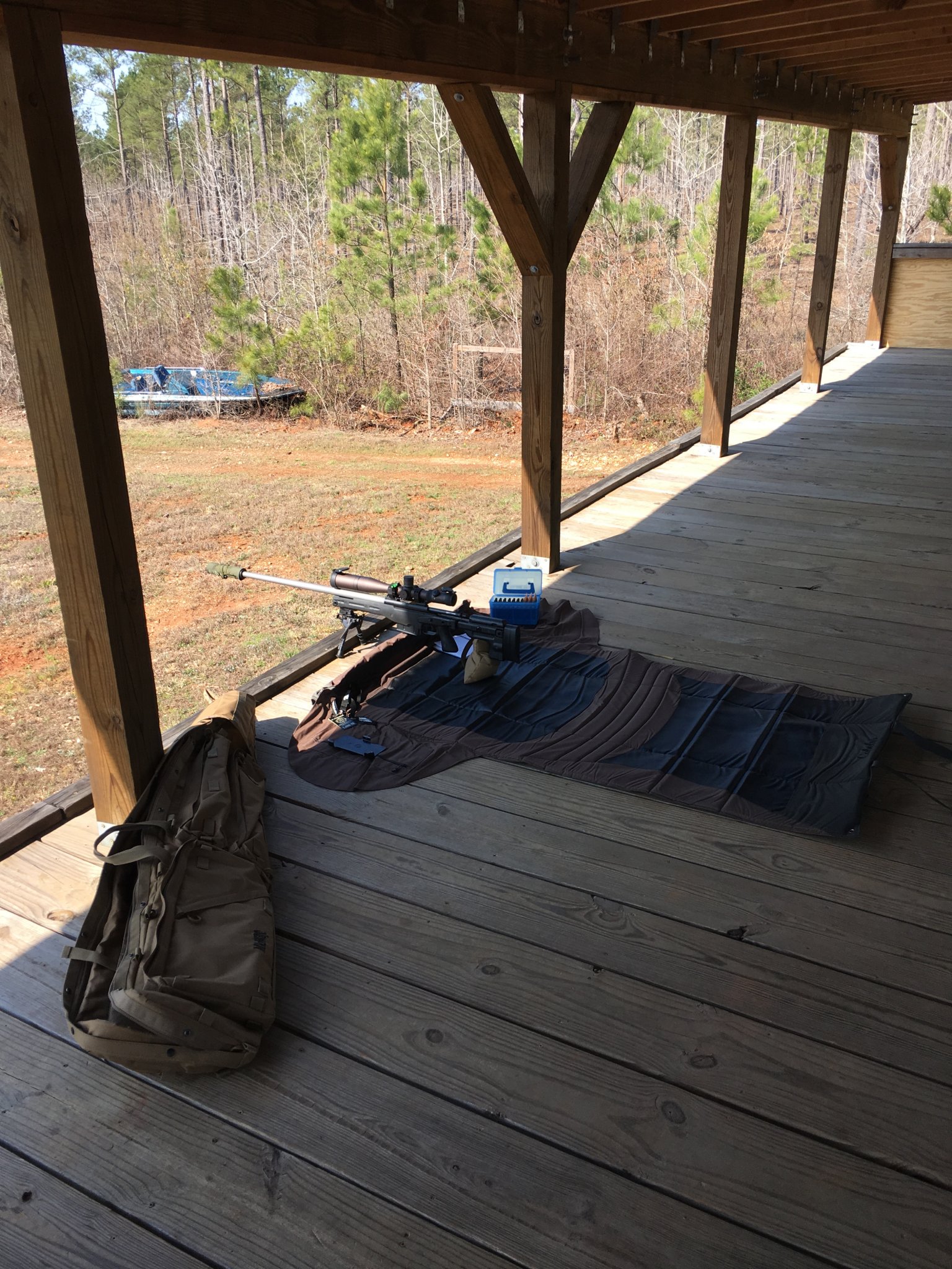

Playing around with Reloader 15 and the 208 Hornady ELD bullets. Shot four answered a text from the misses and forgot my fundamentals.
Don’t text and shoot my friends?
Can’t wait to chrono this guy and see how hard I am pushing them. Seems like a mild load and it still lays some serious energy on targets at range.
