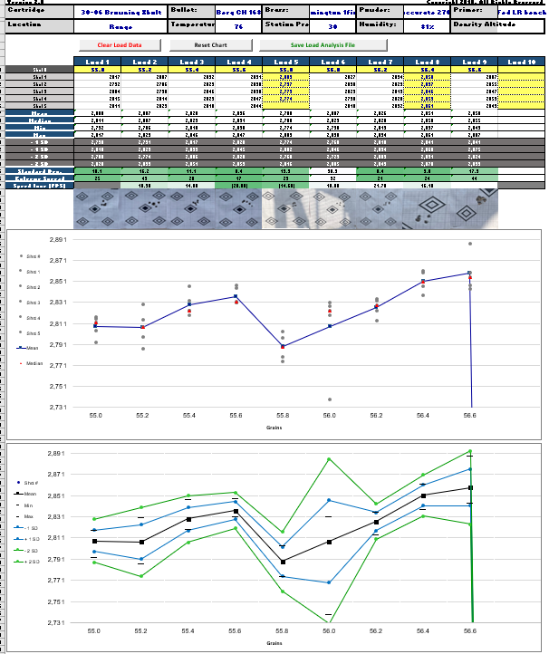

OK gentleman, I'm a very new reloader and am working up my first load to take elk hunting with me this fall.
30-06 browning xbolt, Accurate 2700, Berger Classic Hunter 168 grain. My results so far are as follows. Which one would you guys focus in on? From what I've read it should be load 5 or 6, but load 9 group came in well under an inch.
Also if you look at 56.0 column, I had a round that chrono'd at 2738 and I remember it specifically because there was a split second delay between primer strike and gunshot. Kinda weird
I would omit the outlier in 56.0. As you mentioned something strange happened. A weak primer, a light charge, etc. Those things happen.
Looking at the info provided... I think there is a low powder node around 55.5gr, then a higher one around 56.1.
For powder nodes I'm looking for a few consecutive charges that produce close to the same velocity. The highest velocity of 55.8 and the next two charges, along with the lowest of 56.4 all hover around the 2825 fps mark. The POI of groups 55.8 through 56.4 also look very similar (hard to tell with the small pictures) which would confirm the node.
Load to the middle of that (56.1) and test seating depths to fine tune the groups.

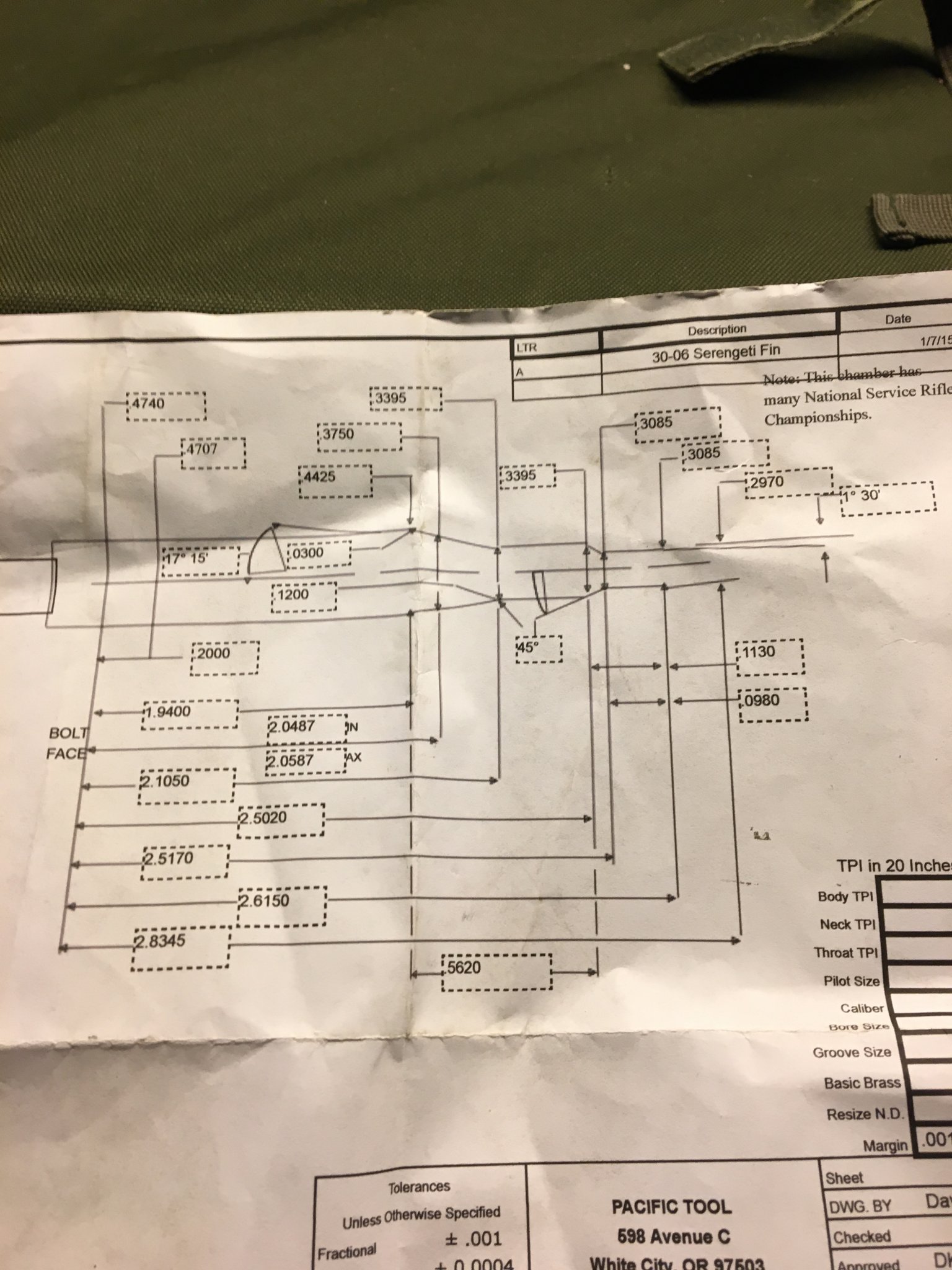

I have a question for the guys running the Serengeti reamer, I need to know what kind of COAL you guys are getting preferably with heavier bullets like the 208eld, but anything would be helpful.
I’m planning on picking up a SSG3000 and I’d like to have a 30-06 barrel made up with the Serengeti reamer, which I’ve already bought. The magazine can handle the 30-06 and loaded rounds up to 3.45” COAL. I’m curious how limiting the mag will be with heavies.
My coal for the above load is 3.282”. Iv got 3.6” to work with so I could have probably used a bit more throat. That was .010 off jam on a fresh chamber
