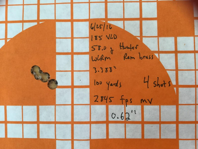

I use Hunter for 168-185 grain bullets.

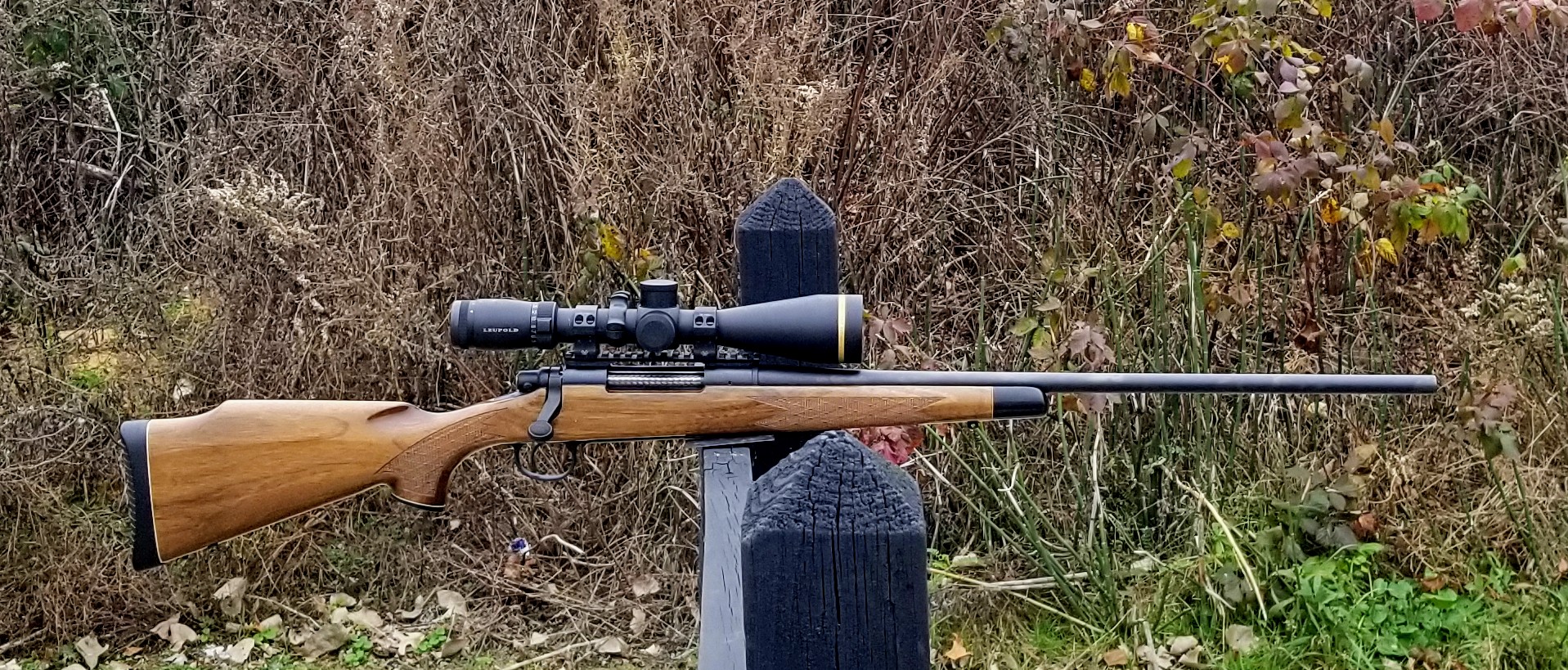

I got sentimental about hunting with my dad this summer and built a classic Rem 700. Found a beautiful 1981 walnut stock ( brass pin) and used a new SPS barreled action. Surprisingly it has a 5R barrel and a Timney trigger instead of that awful x mark pro. I either got lucky or the new 700s got a lot better, this action is timed smooth as butter and is one of the only 700 barrels I haven't needed to replace immediately.
I'm happy.

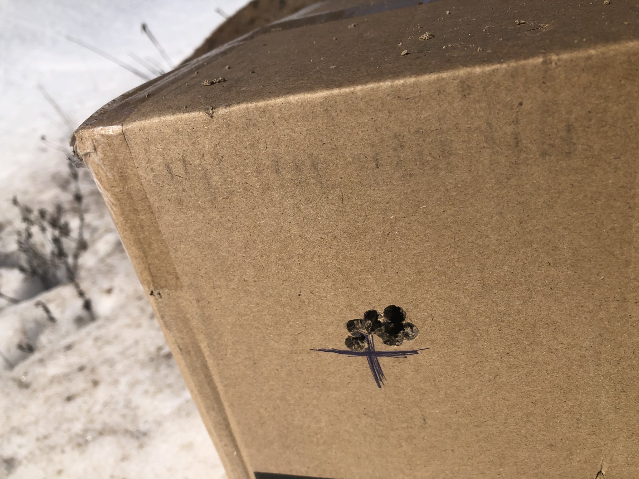

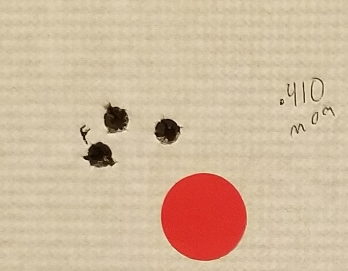

Shot at 200 yards from a hunting bag.
168 Berger classic Hunter .025" jump,
57.0 gr Reloder 16,
Gm210 primers,
Once fired Norma brass.
2930 fps. 24" barrel.
No where close to pressure signs, never got it in high gear yet. I stopped when it started shooting small.
225 yards 2" exit. No tracking.

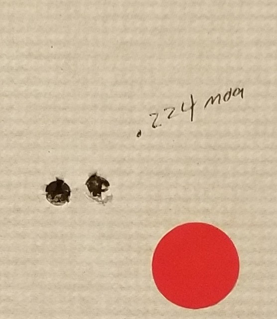

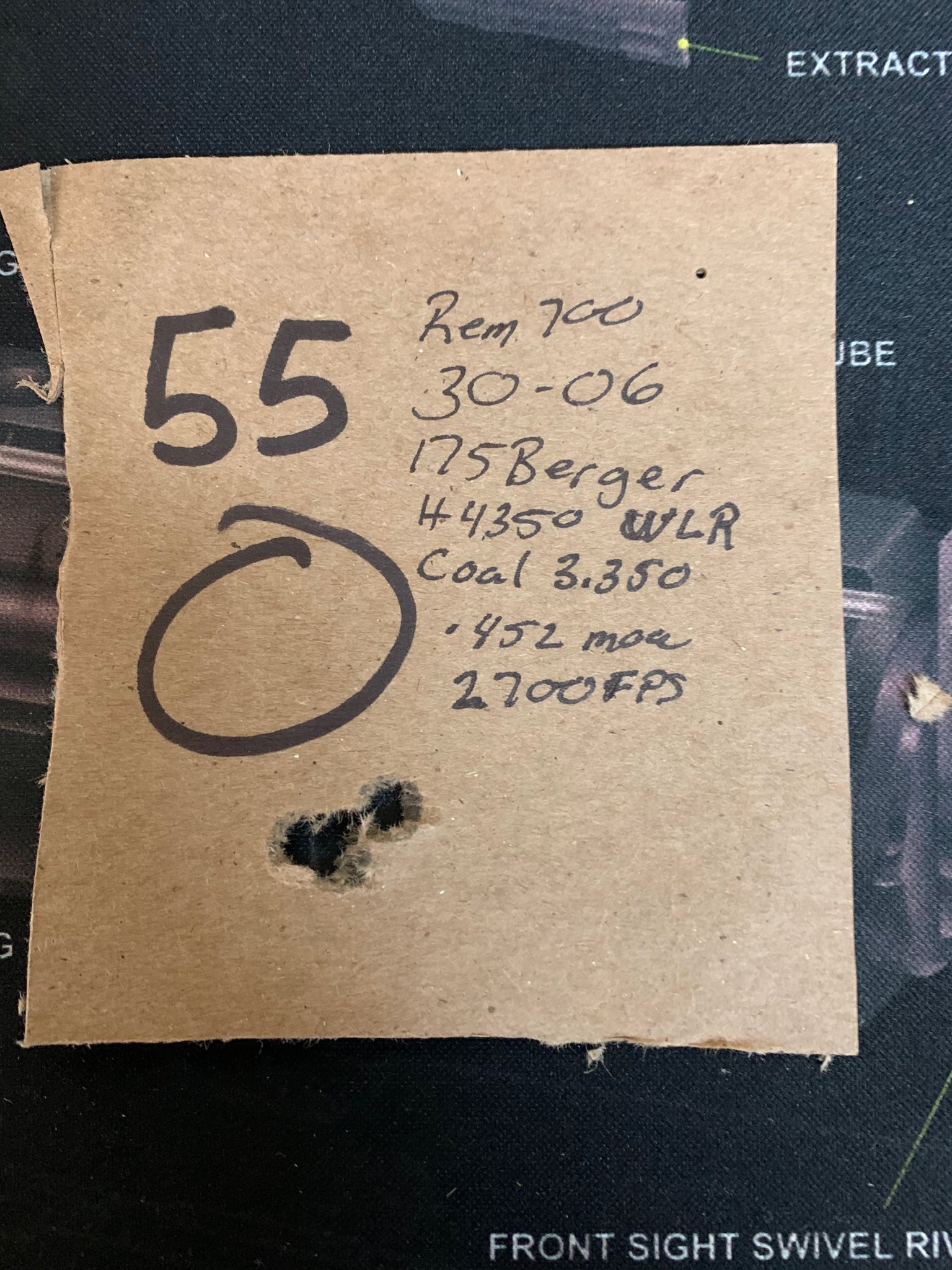

I loaded 178 eld x with 55 grains of h4350, Remington brass and wlrm primer. This is in my hunting rifle and shoots 3/4 moa with a velocity of 2810 out of a 24 inch barrel. Overall length I believe was 3.350.
I have a box of those bullets and my brass is REM with a WLR primer. Difference is the rifle. It's a HOWA 1500. I will work my way up and see what that load does.
The wlrm primers were a mistake by me that ended up working out very well. I have have 2 different bullets that I have tried 55 grain of h4350. Both have shot very well.
