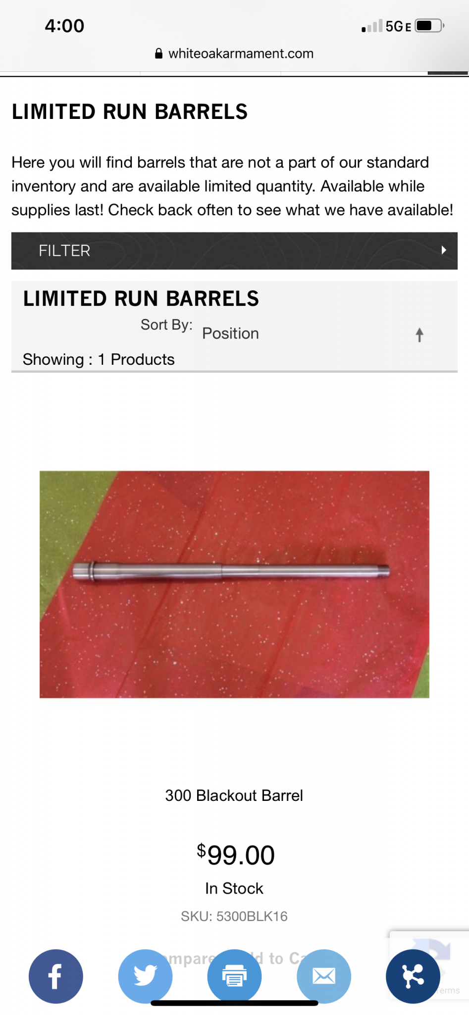

Prepper gun shop has a complete pistol built with a ballistic advantage barrel for $550. If your on a budget it might be something to consider.

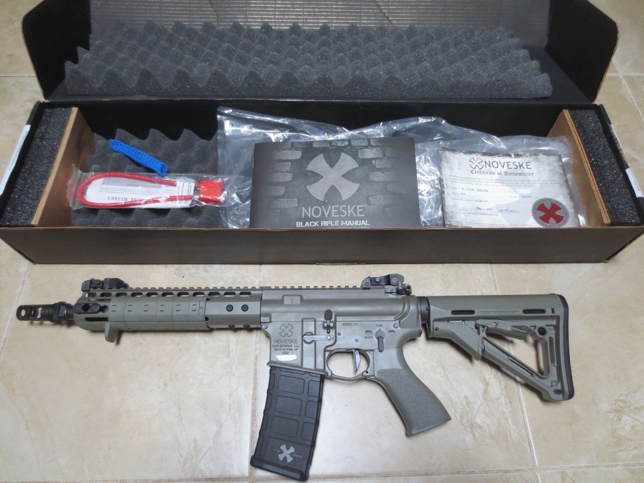

Mine has a noveske 8.2” barrel and runs a tbac ultra 7 on it. Plenty quiet for me. I run supers exclusively. I have played with subs but when I built the gun my intention was to primarily run supers out of it.

Also, while I like the quality of something like that WOA barrel above, I see zero reason for a heavy profile in a short 300 Blk barrel. A lighter profile 10.5" barrel is just as handy as a heavy 9" barrel, the the heavy profile is not needed for stiffness in this application. It's not needed for heat either; the 300 Blk doesn't get that hot if you're not going full auto.
