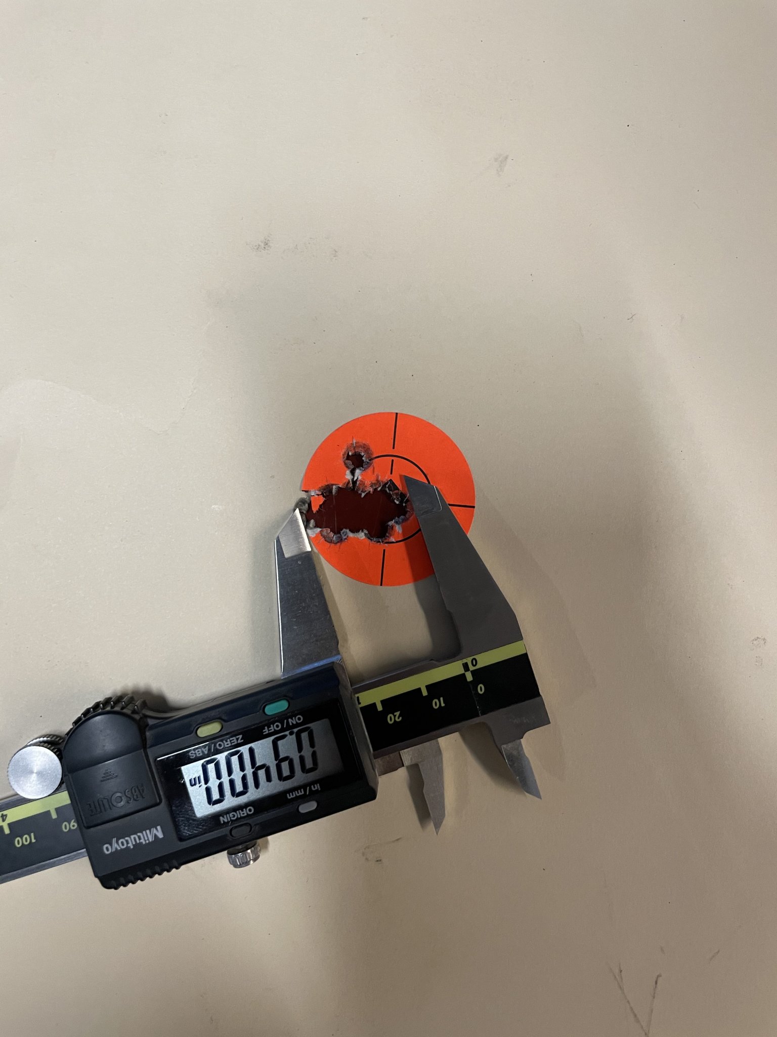

Alex wheeler did a 300nmi for me. I talked with both Ryan and Alex prior to the work. I would definitely get in contact with Alex.
Here is 10 shot pressure testing group with 230 Bergers and over a couple of grains of H1000. I was over 3000 FPS on the top end!

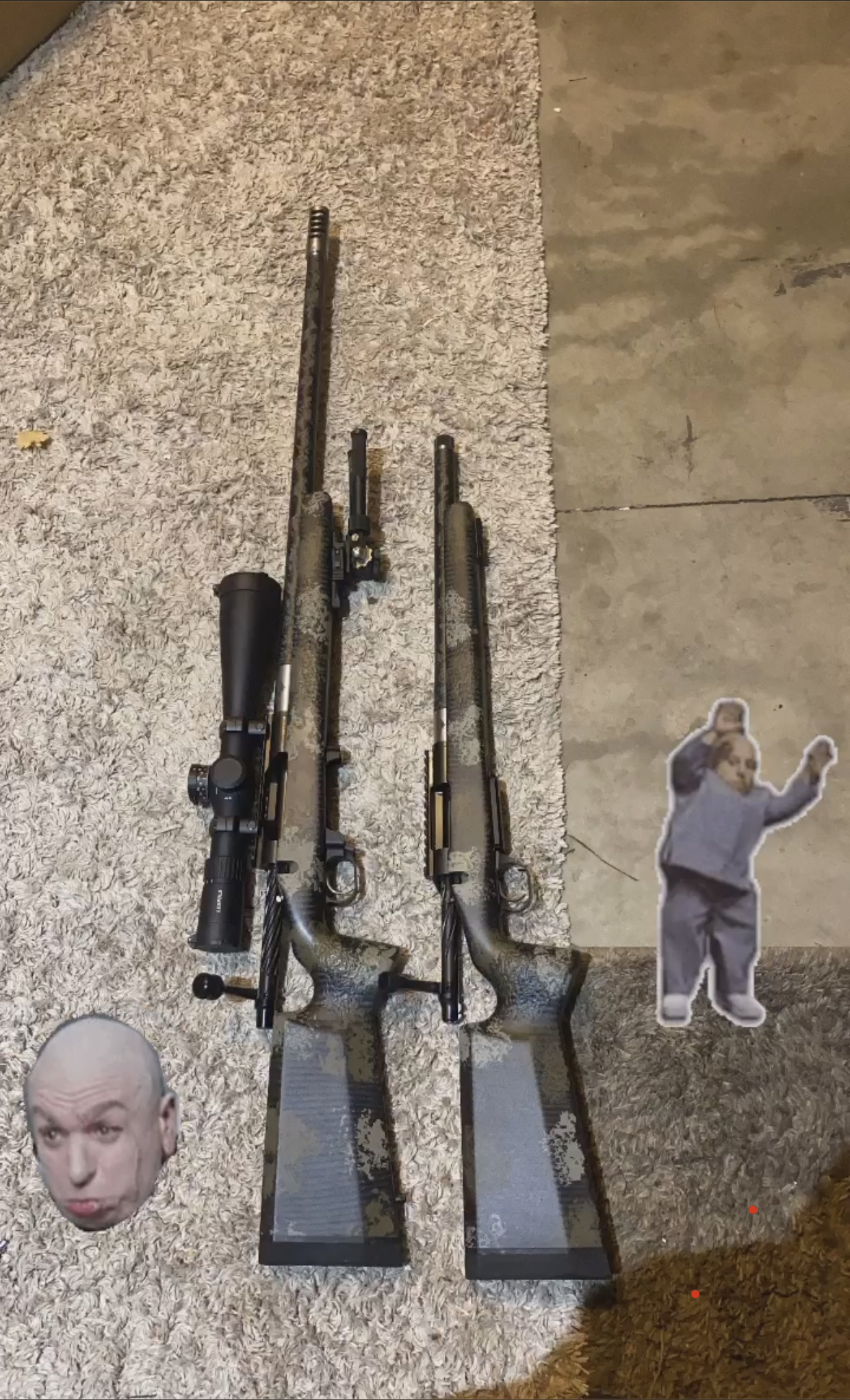

I have built two 300 Norma Mag rifles this past winter for my son and myself.
Both are currently on Mausingfields, but I plan to switch mine to an Impact action when it turns up.
Between these two I prefer the Impact based on my experience with other Impact long actions based on ejection. Personal preference.
Both are BDL but I am changing one to Hawkins' new hunter DBM.
I built these to run specific bullets. My son's is for the Barnes 200/208 LRX's. The hunter DBM will give enough overall length. That one is running a nine twist 26-inch fluted barrel from LRI.
I plan to run the 212 LRX bore rider in the other with an eight twist Proof Sendero barrel. The Wyatt extended BDL box is required to load that bullet long enough.
Both are in Manners EH-5A stocks.
I am well into load development and both rifles shoot under 0.5 moa.

How did this turn out?
I had deep south tactical chamber, thread, bed and assemble everything. i think it turned out really good still needs more load development but i settled on a 3/4 moa load shooting the 199 hammer hunter at 3250fps. it smoked a 380lb+ black bear and left a huge hole on a deer this year overall im really happy. just got my 16.5" 6.5 saum back from them too. i had them do the same exact thing as my 300 norma but obviously much shorter and different caliber. im really loving that rifle right now
Post a picture of finished gun! Love to see it. Did you build your saum on the kelbly too?
The specs on my 300 norma are very similar to my 6.5 saum but not the same. I wnated them to match and basically have a mini-me version of my 300. the norma is awesome for what it is but its really long and adding a suppressor would have just been ridiculous i feel like so i had the shawty built.
300 norma:
- kelbly atlas tactical
- proof carbon 26" tube
- manners eh1 in swamp camo
- hawkins dbm
- accurate mag
- piercision self timing brake
- leupold mk5hd 5-25 pr2 mil
- leupold mk4 rings
6.5 saum:
- defiance tenacity
- proof carbon 16.5" tube
- hawkins hunter dbm
- hawkins hunter flush mag
- rearden double port brake (havent gotten on yet)
- leupold vx5hd 3-15 htmr
- hawkins long range hybrid rings
