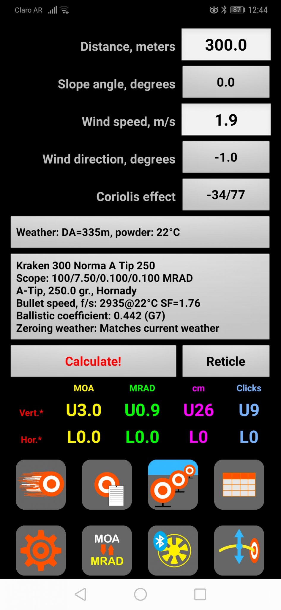

Join contestI can't run the load in either QuickLOAD or GRT as the Warner Flatlines are not included in their bullet databases.Can you run this load in your software rgtools seems not to be working , N565 , 198 Warner tool Flatlines, seems 84 to 86 grn could make it but any info will be appreciate it, thanks

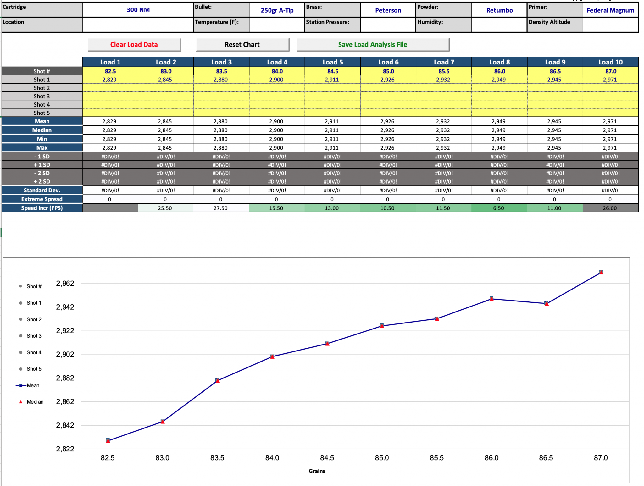

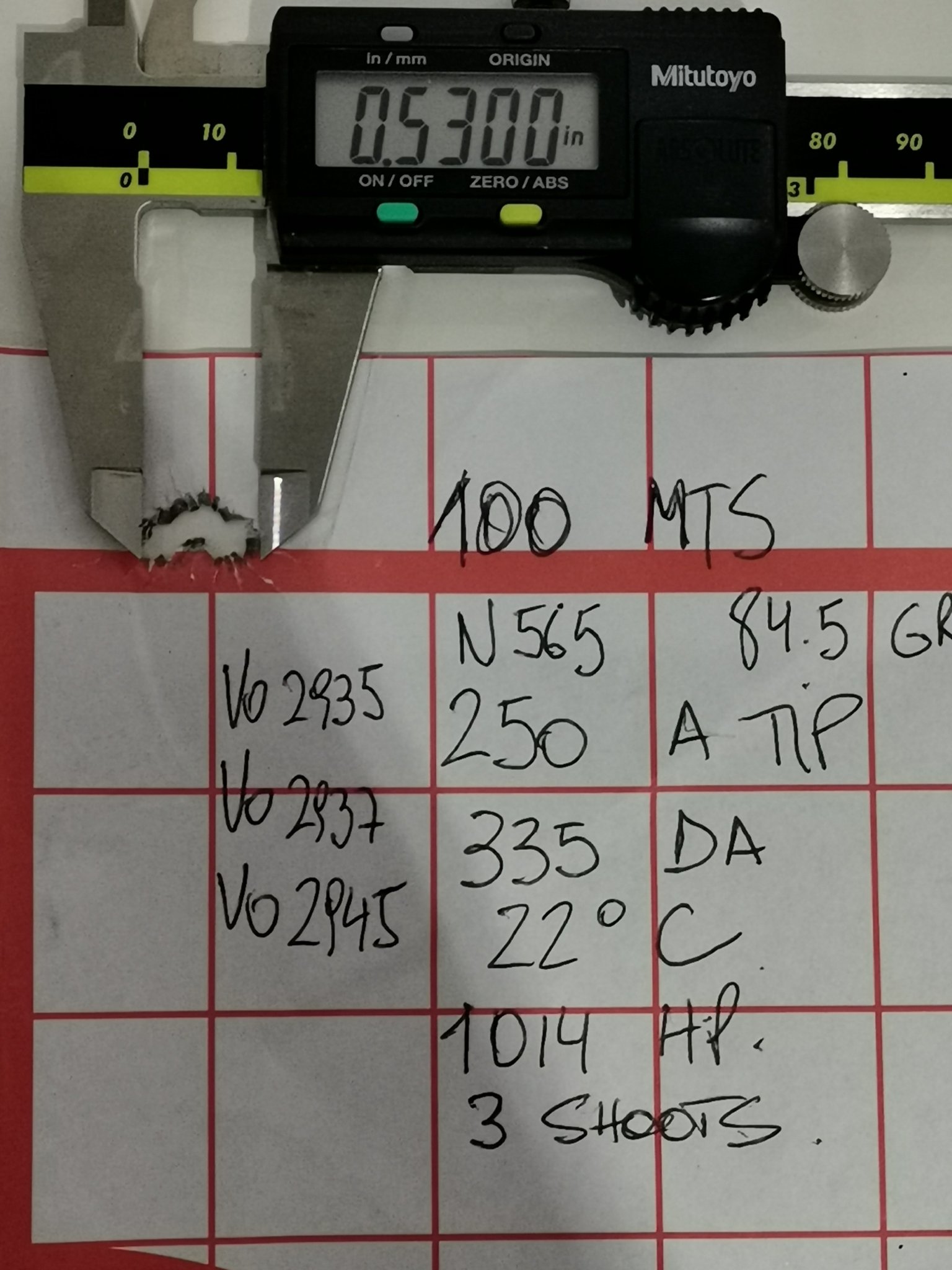

@Yerman I shoot today 250 s with N565 84.5 grn, those were lights out at 2935 average really impressive, but I think I m on maximun with N565, will slow down 1% to stay in more secure zone, but seems that contact surface is lower than 230 and they go out really fast, I was not convinced to drive them so fast. This is also a drop test, I know you guys talk in inches but I ve done in cm, test is at 100 and 300 in order to match tables from balistic app. Full list is Lapua brass CCI 250 primers, N565 84.5grn, 250 A TIPs DA and weather in pictures, SD was amazingShot some of the 250gr A-Tips out of my 300NM today.
Hornady 250gr A-Tip
Peterson Brass
Federal #215 Primers
Retumbo
No Pressure Signs
I'll further explore 86.0 - 86.5 grains

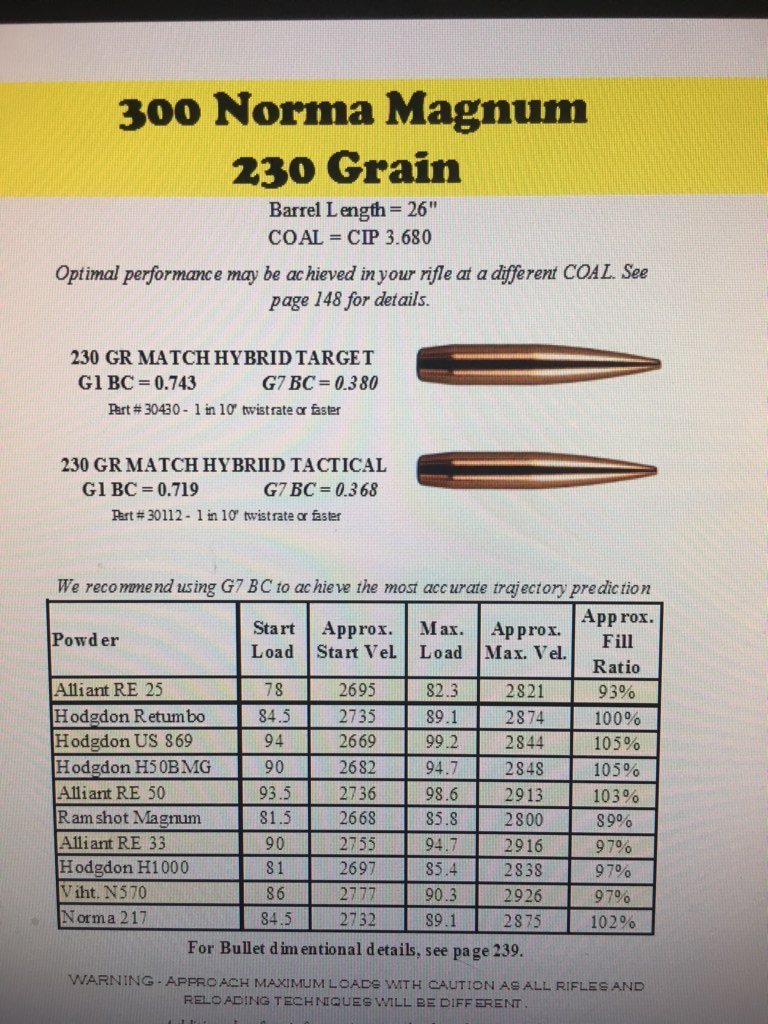

I would like to hear of any luck with the 230 ATips. Been playing with Retumbo and N570. Chasing loads from 84 gr to 86.3. Seeing some promise but no ah ha loads so far?Has anyone been shooting 230 a tips in there 300NM?
I have been doing the same thing I finally settled on 86.3 Retumbo and about .024 setback. Am shooting sub 2” groups at 500yds. Had good luck w N570 also but was dirty and couldn’t get more at the time so went with Retumbo. Getting almost 3050 out of a 30” barrel an no pressure signs so far. I started with new Lapua brass and had poor luck but really improved after brass fireformed!!I would like to hear of any luck with the 230 ATips. Been playing with Retumbo and N570. Chasing loads from 84 gr to 86.3. Seeing some promise but no ah ha loads so far?
