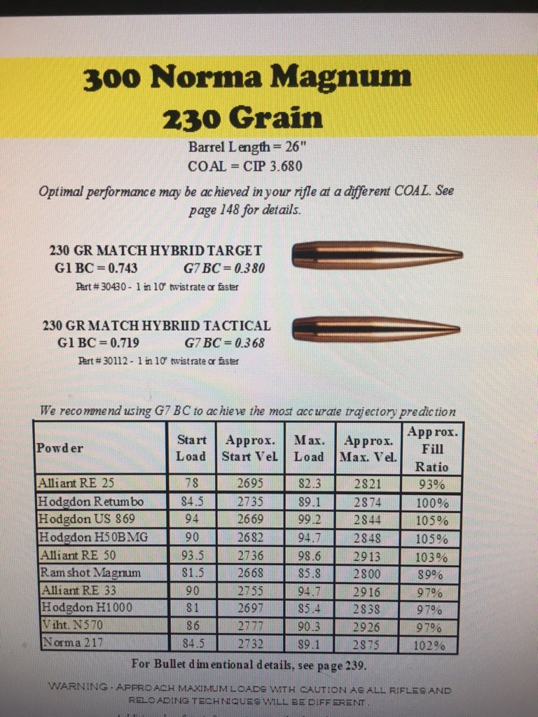

I may have missed something but, why is it that Berger is the only company with any sort of tested load data for the 300 NM? I know it’s sorta new but it’s not that new. Is there an actual reason as to why, that anyone knows?
I pulled & weighed a charge. It was either 84 or 84.5 grains. I can't remember cause it's been a while. I've been told it was h1000 but I personally believe it's retumbo.
The Berger page that @Yerman posted (above) shows 85.4gr max load for the 230 with H1000 in some 26" barrel and unknown brass. Elsewhere it was mentioned (possibly earlier in this thread) that the data on that page, or possibly just that max H1000 load, is considered hot. I understand individual rifles vary so work up, but are the N570 and Retumbo loads on that sheet also typically hot?
DO NOT use the Berger load data posted above (post #507). It's way too hot! I have no idea what they were smoking when they put this info out. I shoot a 300NM IMP built by Ryan Pearce. My load is 91gr N570 with a 215 which gives me 3160fps from a 26" Proof CF 9-twist barrel. ABM is using H1000 for their factory 300NM ammo.

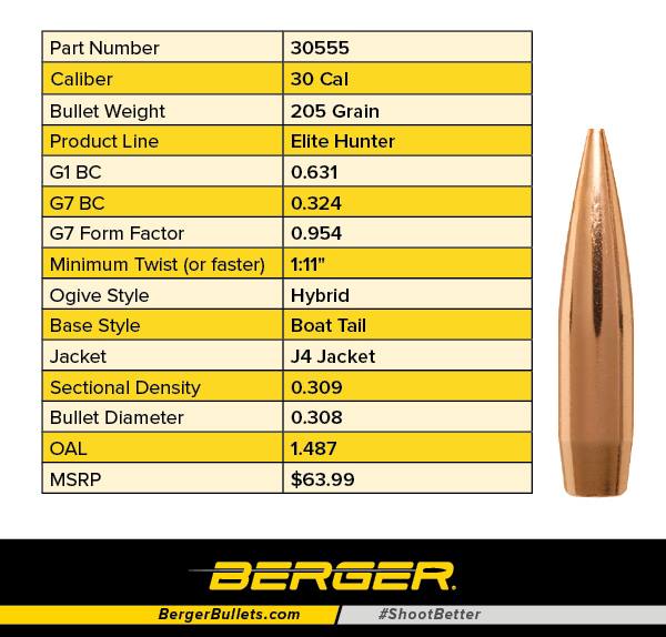

This is an interesting addition!
