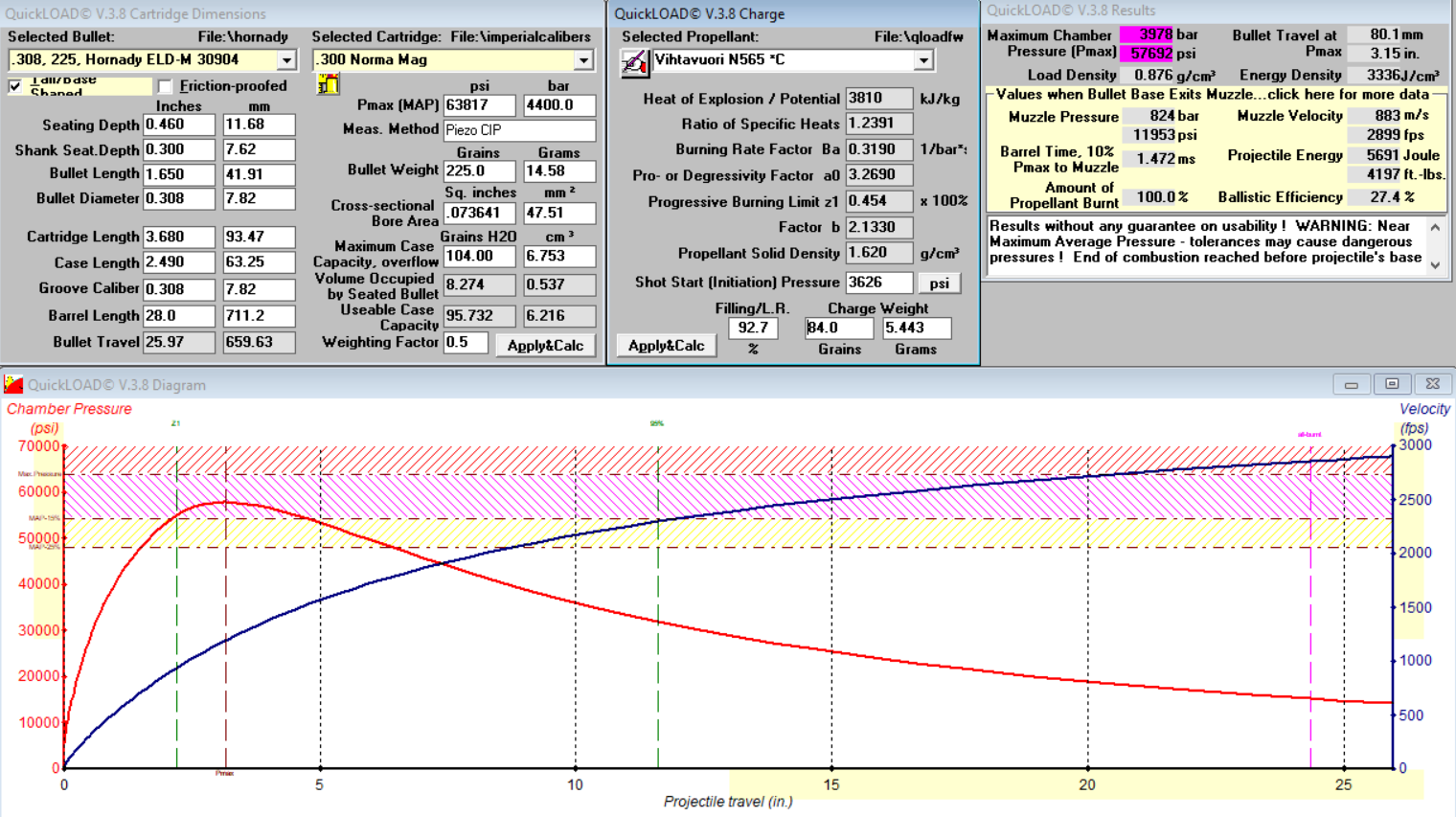

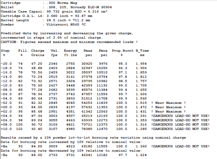

Would anyone have a recommendation for a min-max load for 300NM with VV N565, Lapua brass and Hornady ELD-M 225gr? Will be shooting these in an Accuracy International AXMC with 28" Bartlein barrel.
The VV loads (with the very strange small COL) confuse me and I did not see any postings yet on N565.
Was maybe thinking between 82-94gr N565 for standard COL of 3.680"?
84gr looks to be a bit on the hot side for a starting load.
You might want to start closer to 77gr.
NOTE: if you read further up you'll see a discussion about how VV's load data for .300NM seems to be off.

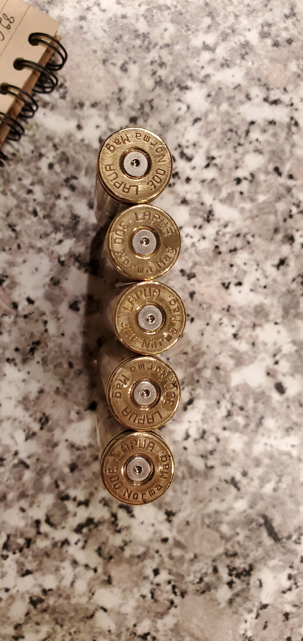

Took my 300 norma out today ... tried a group test... did not go so well, i started at 83 gr and worked up to 86.5 and the speeds were awesome but groups were pretty crappy... so I figure ill work a few more out and see if I can get it better......
