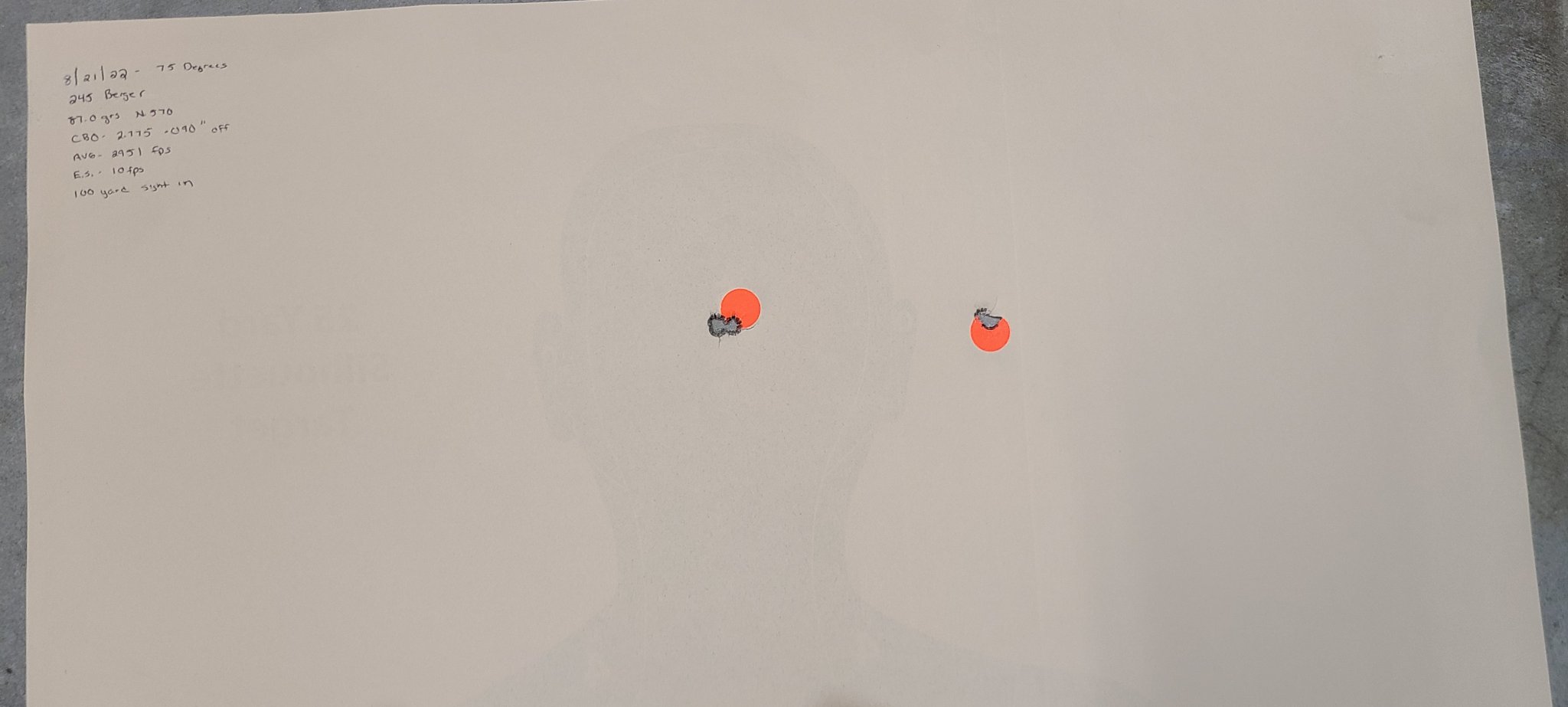

So here are my last two results with the 198 Flatlines and N570.
The target with 6 different groups (5 are from the .300 NM, the one on the very bottom left is from one of my 7 WSMs) is the most recent and was testing seating depths. All my previous shooting was done with the projectiles touching the lands. The rifle/projectiles seem to prefer .005 jump better for accuracy than touching and definitely didn't seem to like jumping .020 or .050 jump. This wasn't much of a surprise since they are so long. These groups were shot at 100 yards and the best was the CCB with .005 jump and measured 2/3 MOA.
No, they aren't 5-shot groups with the cost to shoot these things, plus barrel life; I'm not keen on wasting them.
The other target with one group was shot at 300 yards. It was 6x 3-shot groups with varying powder charges, and the projos were set to touching. It managed about 1.1 MOA.
I only have about 70 rounds through this barrel but 1 MOA seems to be about where I'm at with it or a little better. I'm also not pushing these projectiles as fast as I could but I'm not trying to kill the brass within 2 firings either.

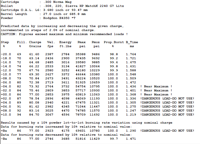

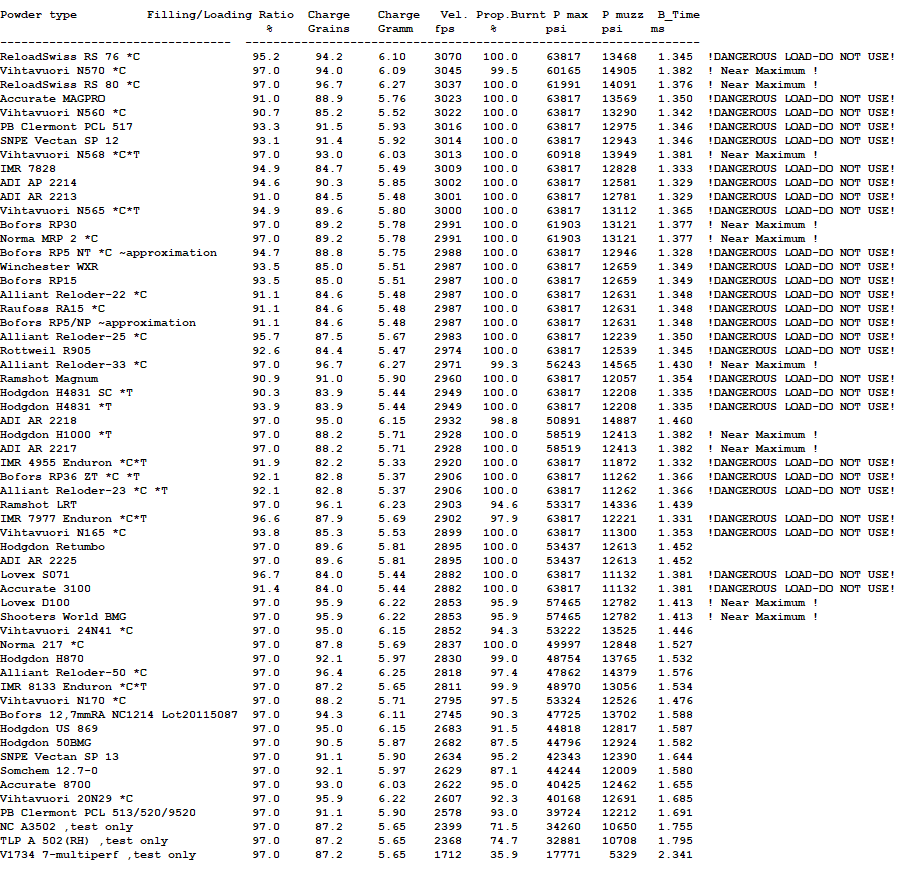

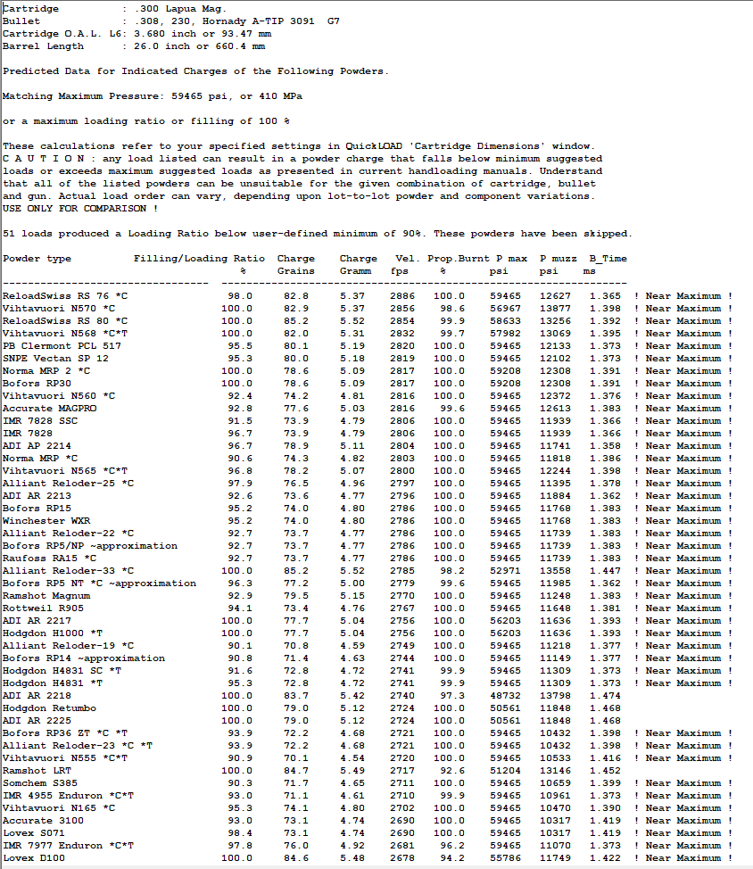

Does anyone have a suggestion for where to start from this number (77gr) for a 220gr SMK? I have quite a bit of H4350, but don‘t want to blow myself up! I will am shooting a 26” Proof Research carbon fiber barrel on an AXSR.
Reactions: Balor
Never heard of anyone using H4350 in a .300NM, but here's the data for the 220SMK
Reactions: BCX
You're just burning up the barrel with that powder. You should be running that 220 around 3100 fps at max pressure with the right powder. Why bother for 300 WSM ballistics?
Reactions: Balor and Dogtown

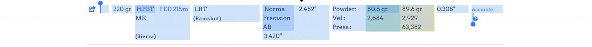

You have convinced me. Only considered it based on the numbers the user posted above. He quotes 300 ft/sec faster (10gr heavier) than the calculated data.
edit: Here is what scares the crap out on me. Above says 96.1gr Ramshot LRT (2903 ft/s), where another reference says max load is 89.6gr (2929ft/s).
Right. Look at the overall cartridge length.
