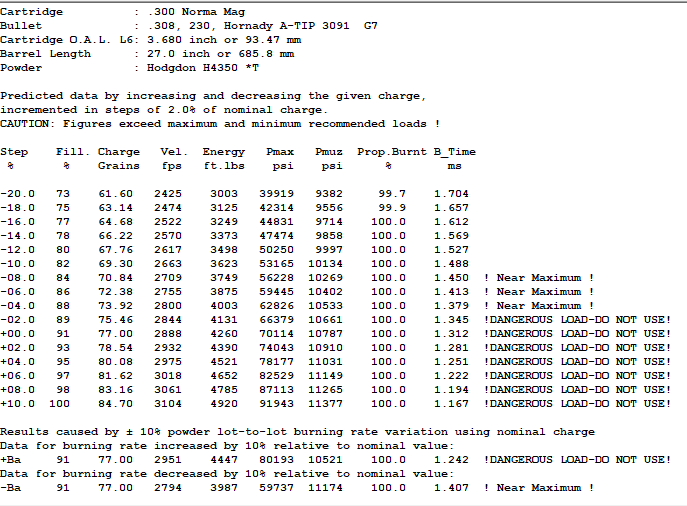

Late to the party, but why do you believe H4350 is going to burn out the barrel? Best I can tell, its heat potential is actually less than most popular powders for the 300NM and you use 10% less - so my understanding is the barrel would actually last longer (I'm very open to hearing why it would burn the barrel quicker because I agree, it seems counter-intuitive to what I would expect).
Hodgdon H1000 - 3630 kJ/kg
Vihtavuori N570 - 3950 kJ/kg
Hodgdon Retumbo - 3710 kJ/kg
RL33 - 3900kJ/kg
Hodgdon H4350 - 3760 kJ/kg (close to Retumbo)
220 SMKs tend to want to stay in the 3k range from what I've tested - and admittedly shoot slightly better with the H1000 running 84-85gr. I did push them up to 3131fps with the H1000, but my SDs and accuracy went down anything hotter than 3050 (26" 1:8 twist).
Reactions: Balor
Because if you look at the Quickload data Dogtown posted, near max load of 77 gr of H4350 is only giving you 2850 with a 220 gr projectile. Why waste precious barrel life on a 300 Norma for something like 300 WSM ballistics? That powder is too fast and limiting the cartridge potential and just shortening the barrel's life while your doing it.

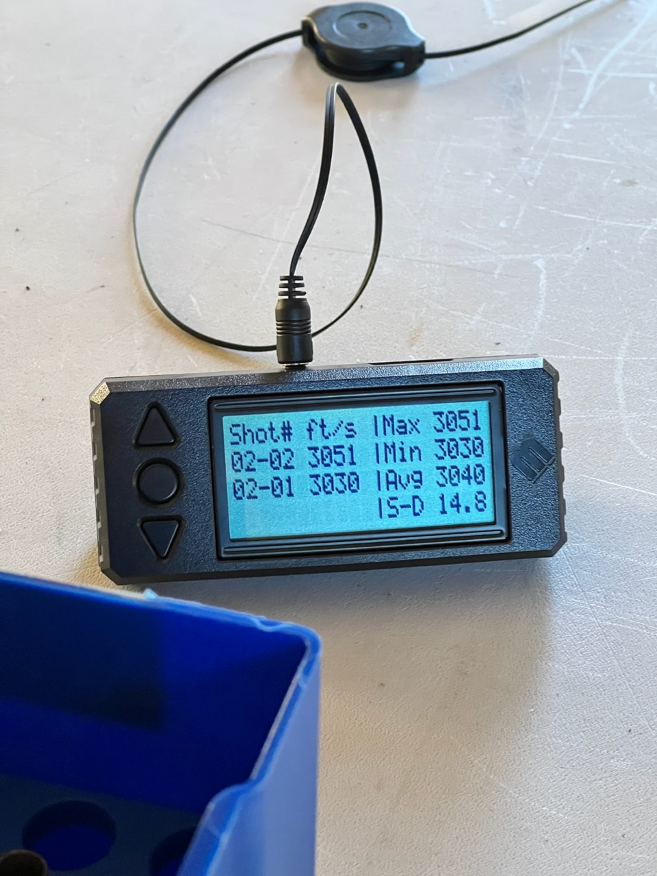

My magnetospeed seems to read as expected with other loads, so I believe it’s working properly (I did once let the voltage on the 9v dip and without giving me a voltage warning, it started reading all over the place). I since swapped over to the Cr123s or whatever it is they recommend and it’s been solid ever since.
Finally getting settled in after moving across the country, so picked up getting my loads dialed in on the 300nm. Also found a few boxes of the Berger 230s - so excited to test those out as well
77gr H4350 with 220 SMK - 3040fps
Also ran 78.5 with the 230 a-tips @ 3,004 with heavy bolt lift - so certainly over pressure. 4 shot SD was 10.14

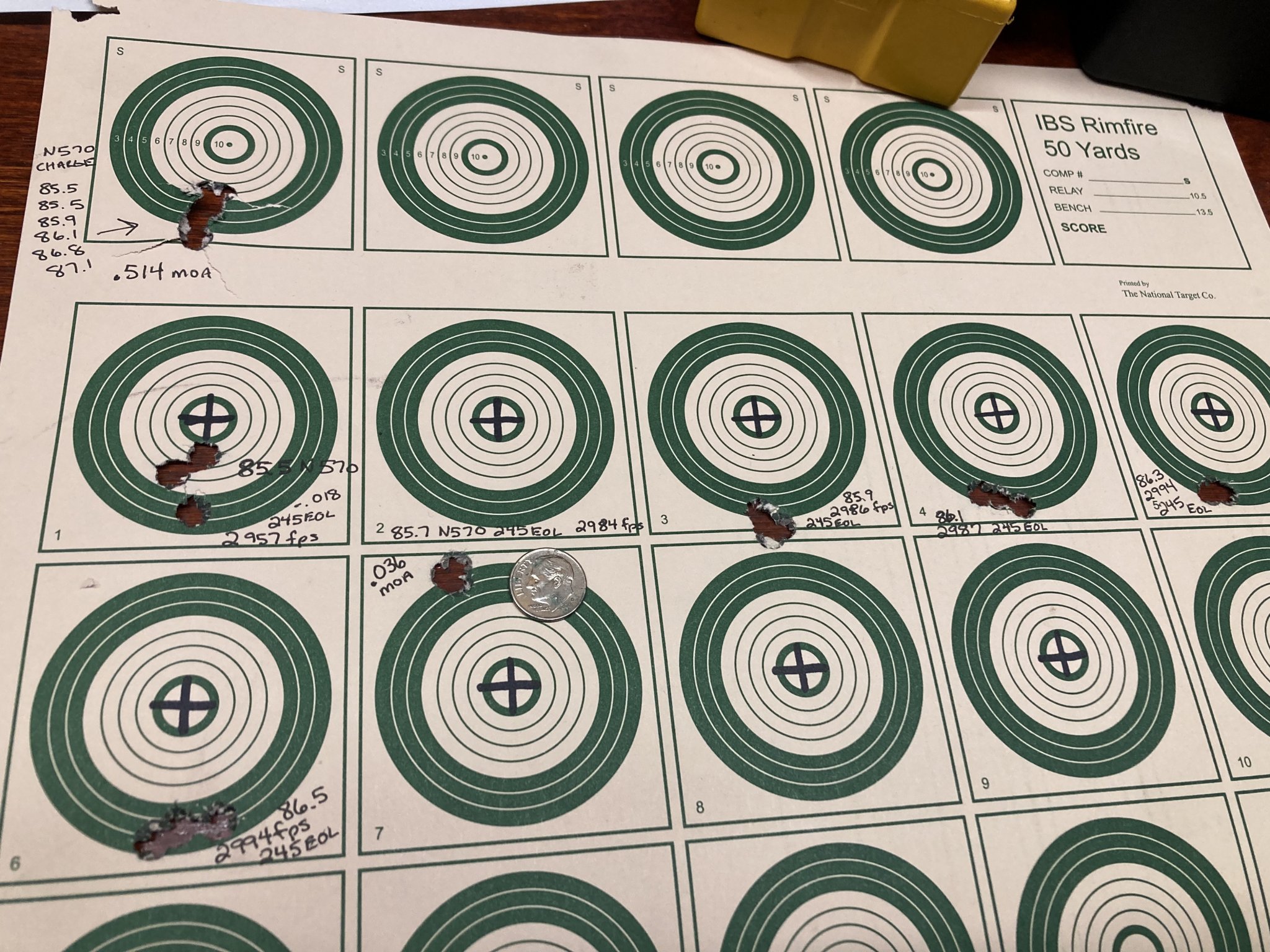

N570 245 EOL
85.5 2969 avg 4.5/11
86.5 3004 avg 5.2/11
3 shots
85.5 2957 3.6/7
85.7 2984 .5/1. Only 2 on chrono 3 shots one hole.
85.9 2986 6.7/10 2 registered
86.1 2987 3.1/6
86.3 2994 4.5/9
86.5 2994 3.7/7
You've pretty much duplicated my results. It's as if that bullet/powder combo were made for the 300 Norma.

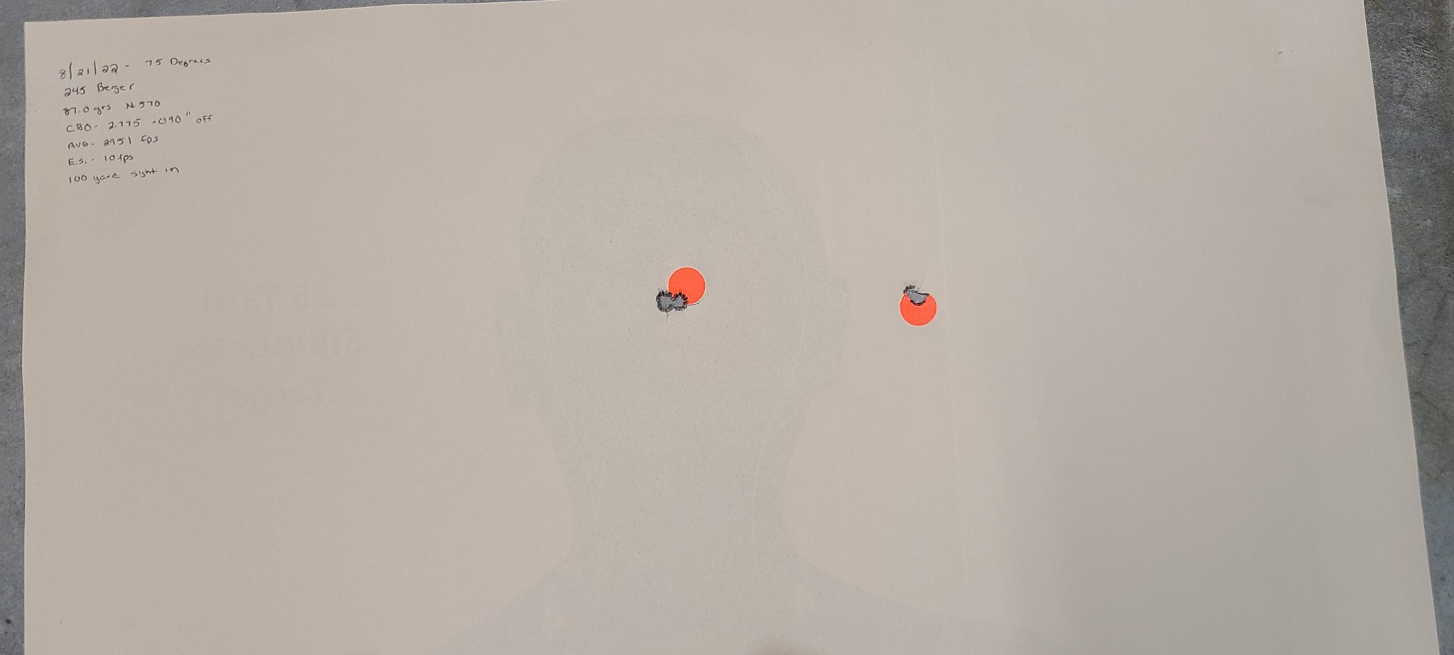

Been seeing a lot on long jumps with Bergers. Played with seating depths and settled on .090 off the lands and went out to re-zero at 100 today.
Berger 245 EOL
87.0 grs N570
CB0 2.775" @.090 off
Avg Velocity - 2951 FPS
ES - 10 FPS
3 shots on the left and adjusted scope and 2 shots on the right to confirm.
I'm jumping the 230 gr. Atips .075 and getting similar results but my coal is 3.751. This barrel has a super long throat and I can barely get to the lands with a 230 gr. at 3.831. I've got some 250 gr. Atips coming.

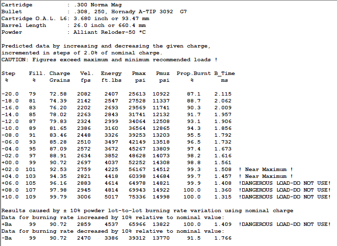

Im going to begin my load development with 250 A-Tips, Lapua Brass, CCI 250, and RE50 in my AXSR. I normally use Gordons Reloading Tool to get estimate velocities and min/max loads, which in the past have always been within approximately 10-15 fps, and accurate to seeing pressure signs as I near max pressure, but RE50 is not a listed powder, and other than one person here stating he wants to try a load in the 88-91 gr of RE50, I am not confident with where to start.
Not that's it readily available but N570 worked magic in my 300 Norma with 250 A tips. Right at 3000 fps with a 26". RL33 would also probably work well.
All those powders are unobtanium, N170, 24N41, looked promising on GRT, and have read quite a few people having good results is H50 and US869. And RE50 is supposedly a faster burning powder than those, but slightly slower than N570.
I tried a quickie work up with RL50 because I had some and N570 is unobtanium. 250gr A-Tips, Lapua Brass, Fed. 215m. 28" barrel. 1 shot with each charge weight:
81.0gr 2591 fps
82gr, 2576 fps
83gr, 2606
84, 2652
85, 2674
86, 2692
87, 2725
88, 2765
89, 2781
90, 2837
Not great but not terrible. I forget when loads started to get crunchy when seating. No idea how consistent a crunchy 90+gr of RL50 would be since I was only shooting 1 round to get a rough idea of potential velocities.
I haven't finished load dev with 250gr A-Tips and N570 but velocities were predictably better, 5-shot groups:
84.5gr, 2898 fps
85.0gr, 2906 fps, ES 7, SD 2.8. looks like an easy winner. enough velocity to do the job without pushing crazy PSI.
85.5gr, 2918 fps
86.0gr, 2913
86.5, 2932
87.0, 2942
No load I've ever shot has had pressure signs with Lapua brass and N570. I've always found velocities and stopped before pushing too hard. With 230gr Bergers 86.8gr of N570 got 3098 FPS, ES 13 SD 5.2.
