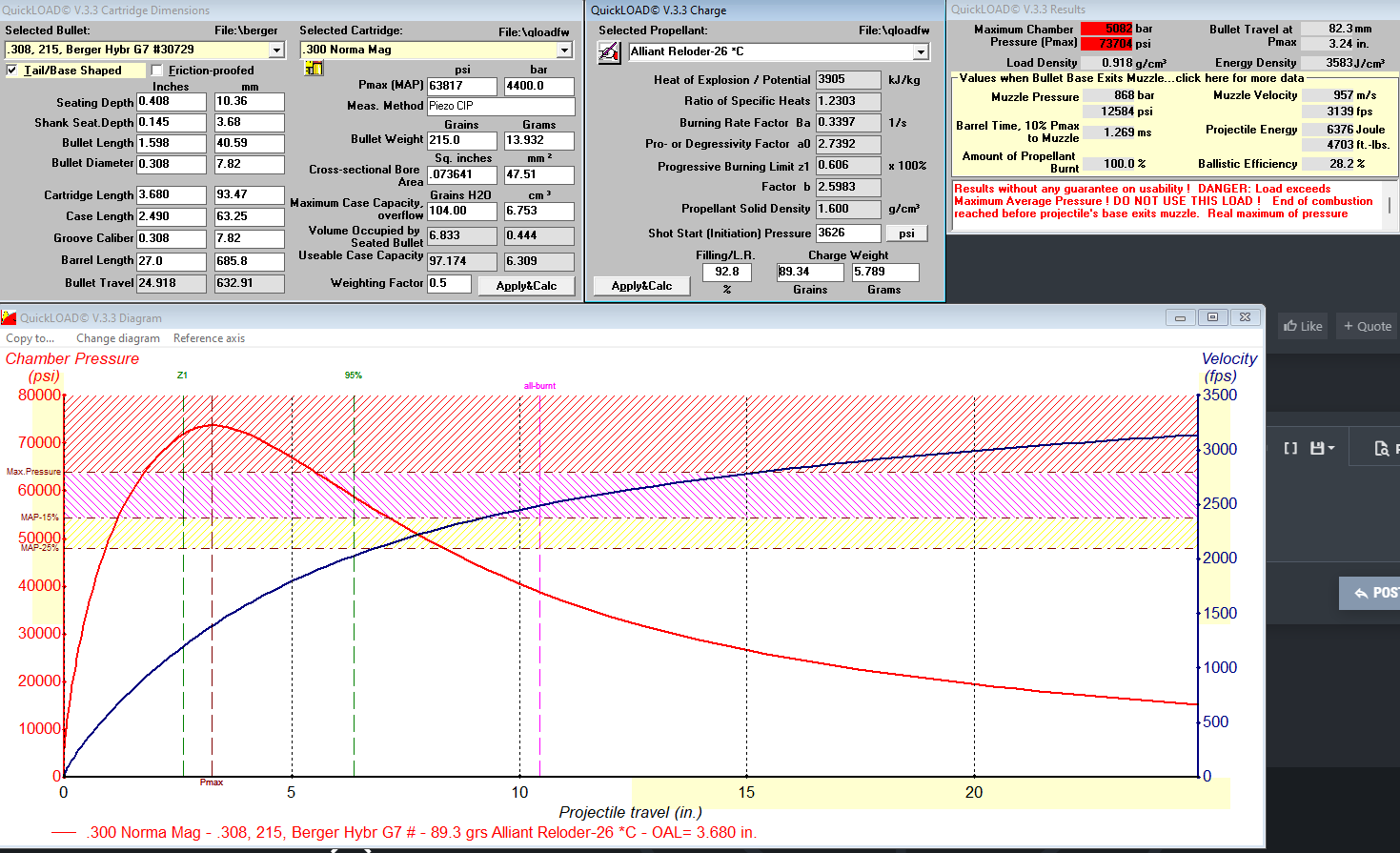

Is there any data on using RL-26 for 300NM? Or is it too fast?

Looks like it's probably too fast. Even with the 215s and a case fill % of less than 93%, it's still way up there in pressure.

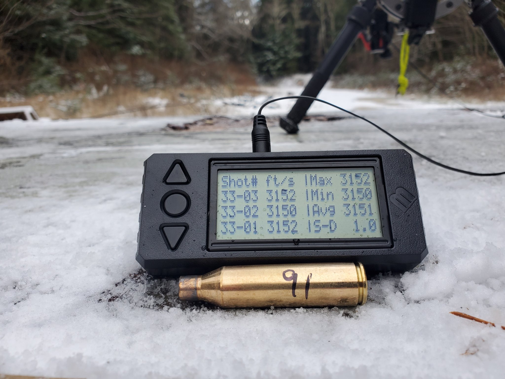

Not much info I could find. So ran some n570 and 208gr amax in Norma brass.
Loaded to .020" off the lands
Slight ejector marks, but also new brass that's .006" shorter then once fired. So I'm going to give it a .002" bump and see what happens when I do some seating depth tests.
Now I'll get my excuses out if the way. The table was covered in snow and was difficult to get a solid position. I had it slip bad at 90.5gr.
