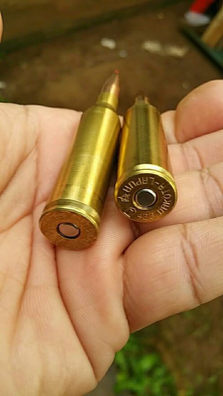

Ive been using standard 300nm brass..5-7x and i called it DEAD..ive been testing lapua 423 dakota necked down and turned neck to 300nm..15-17x loads and pockets still feels like a new NORMA brass..and i load them to i got ejector marks and flat fed215m primer lol photo86789.jpg

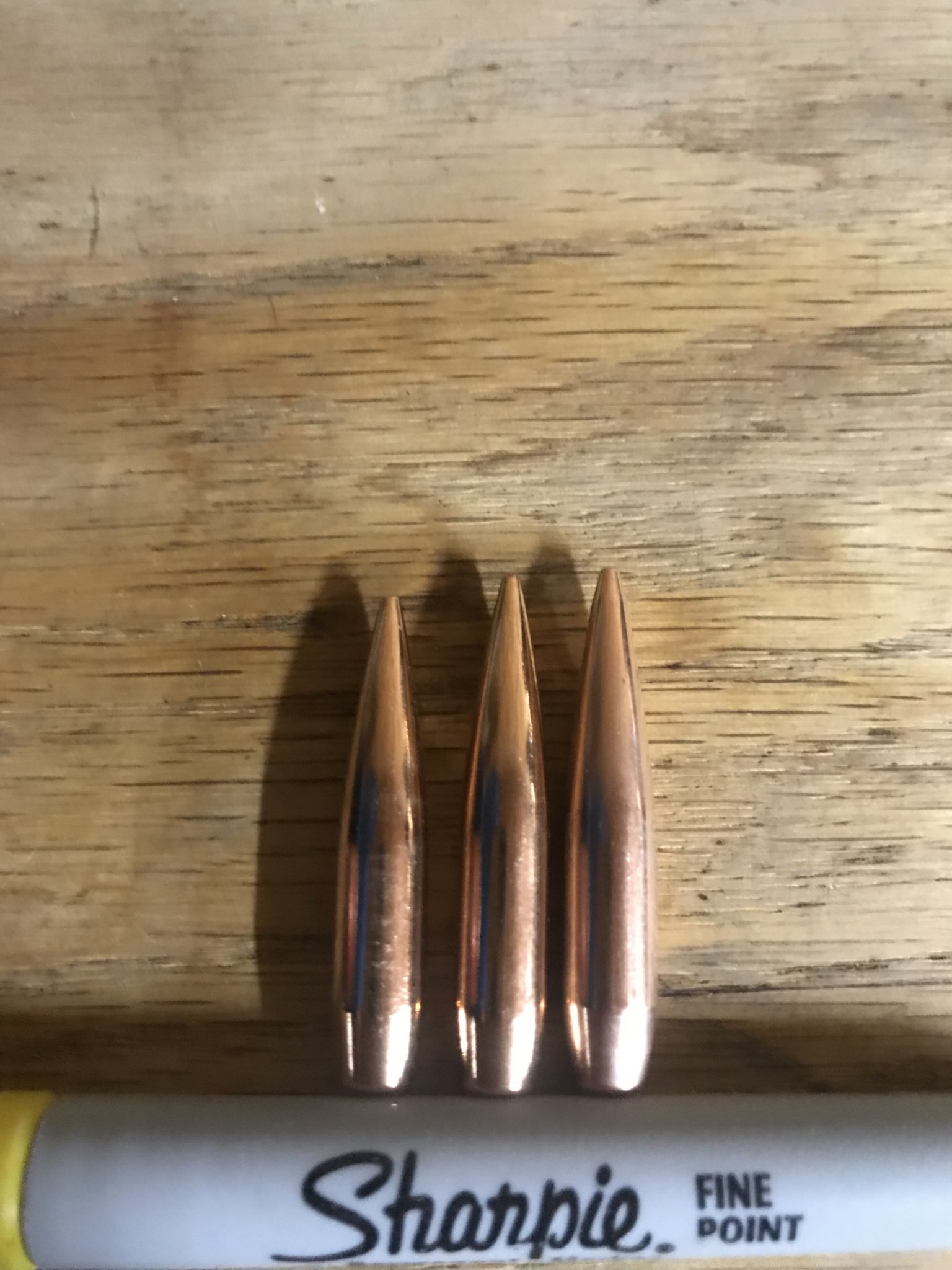

Got my 28” 9 twist 300 Norma out for first load development this week. 198 Flatline looks like it will be around 3090 with 84 RL26 using Warner’s 3.765 OAL jumping a long ways, more than I like, but groups were promising. More load development tomorrow.
Also my 230 Sierras showed up, will try to get a start on that this weekend too!
Left to right 215 berger-230 berger hybrid-230 Sierra

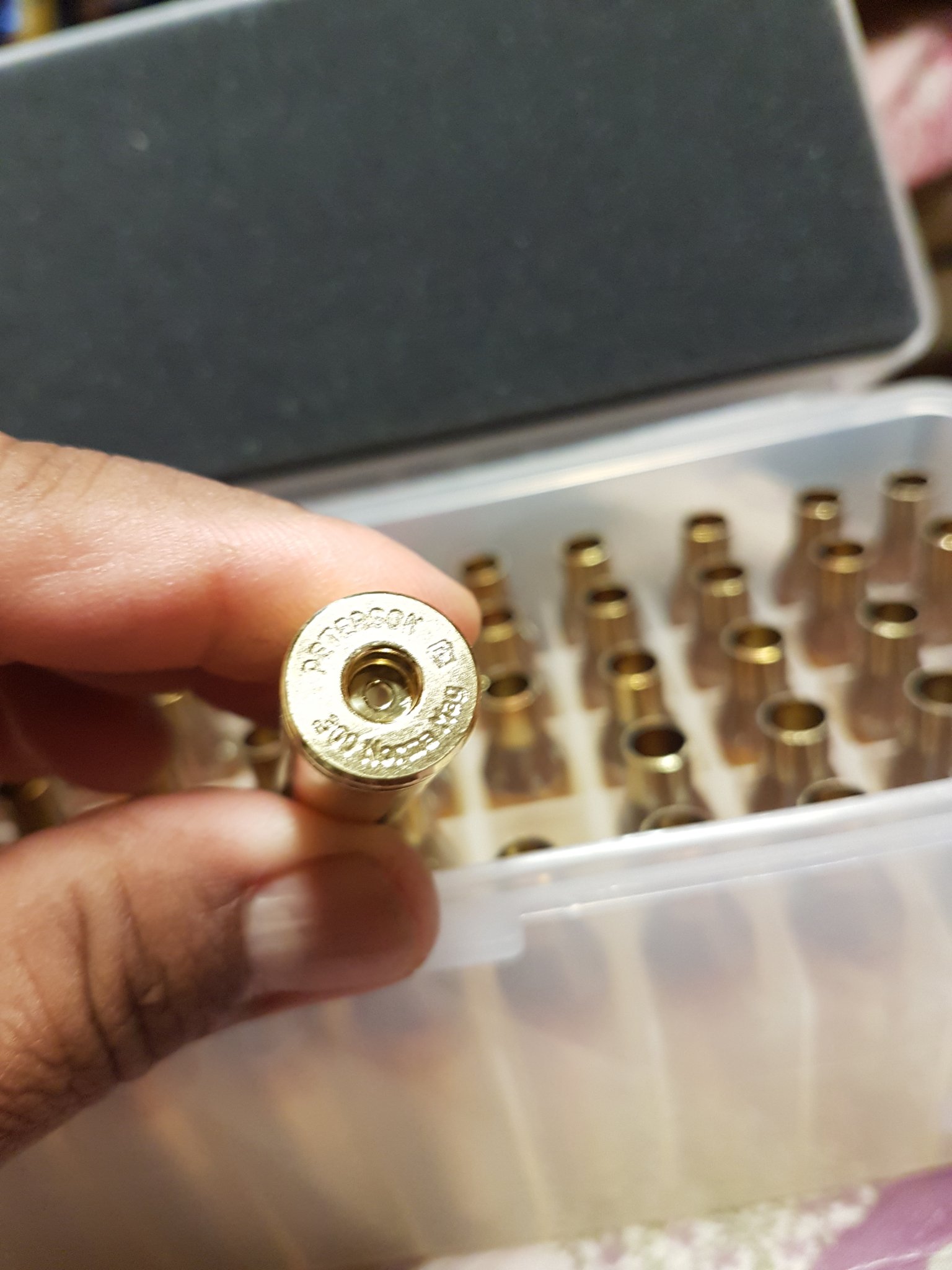

Looks like Graff & Sons are shipping Peterson brass. My back order just got filled.

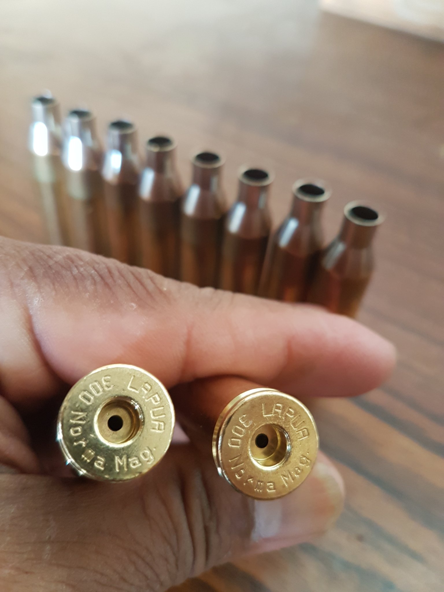

I have both petterson and lapua on hand..i can tell you that they both really concistent vs that crap norma brand..ive been using necked down 423 dakota lapua brass so its safe to assume the lapua will last lot of loading..its also thinners vs pettersons its about 015 and petterson around 1-1500 thicker..norma is about 3k thicker vs lapua .this will give you idea on what neck size for no neck turn chamber...id say no less than 341..

Peterson brass is for real folks! I fired the same piece 10x today, 87 grains of Retumbo and 215s . Primer pockets are still like new . For a legit torture test I FL sized it each time, figuring that would lead to a case head separation sooner rather than later , never happened.
Case head expanded .002" on the initial firing and .000" on subsequent firings. Had to trim 3x , got bored and started on the beer . I don't know how many firings it'll take to kill this piece, but I'm a believer!
