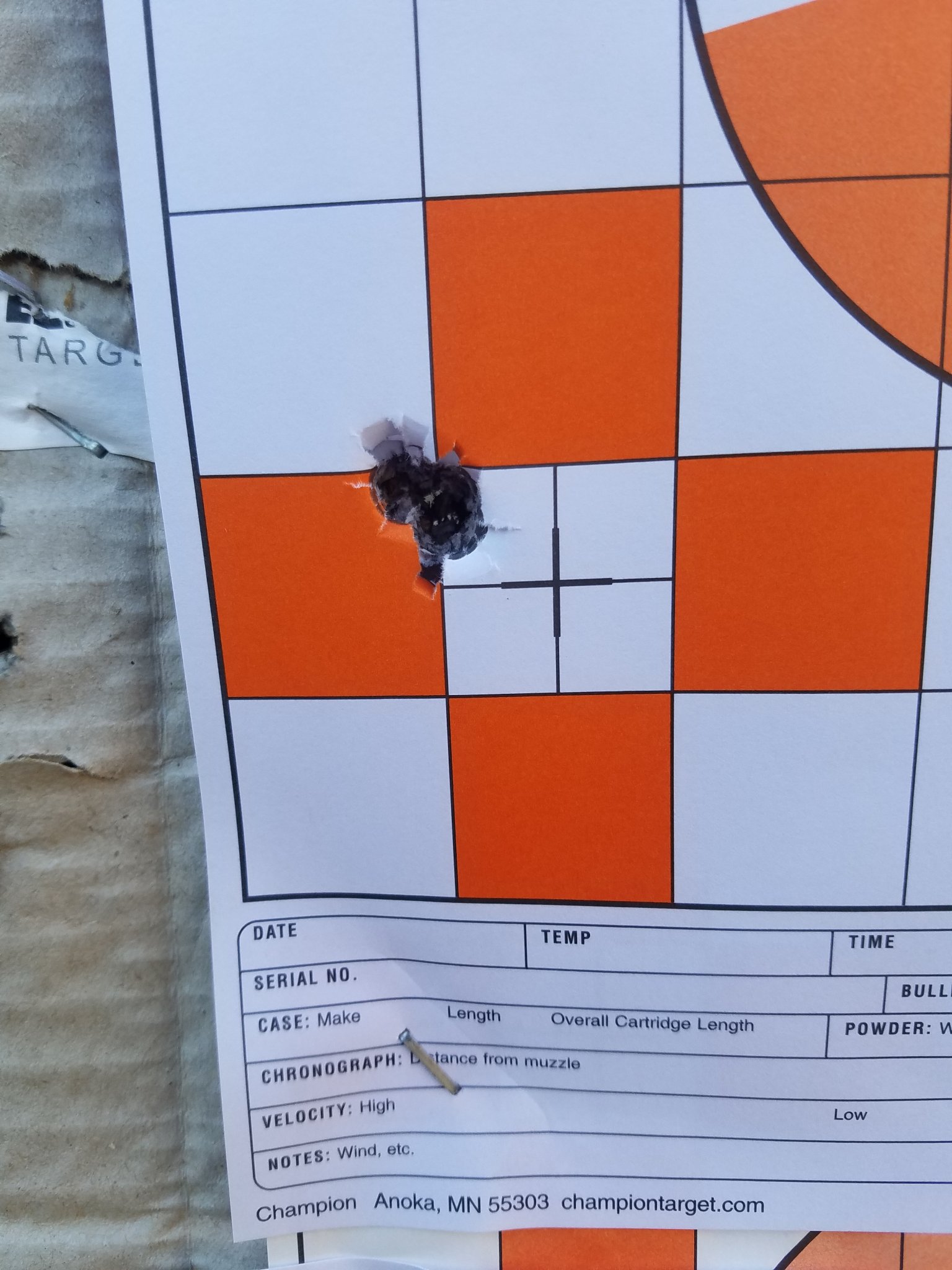

Having issues tuning my 300NM with 225 ELDMs , they want to be near the lands , but any closer than
0.010 sees the ES go silly . Any more jump than 0.025 and groups are poor . Best load was :
ES 4 SD 2.3
84.7 of H1000
0.015 jump
CCI 250
28 inch 8 tw Bartlein
Just under 0.5 MOA for 3 shots ( barrel life ! )
No 1 and 2 below are best load with 225 .
Below is pic of 230 Hybrid load .

View attachment 6924027 Below is pic of 230 Hybrid load .
Looks like you found a winner with that Berger. I am just about to start load development with the 225s in my AXMC. Hopefully I have better luck then what you are seeing as I just bought 300 of them to give a go.

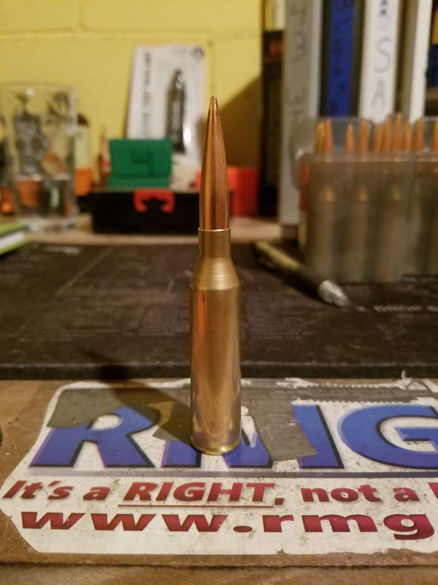

I've been working on developing a load for my .300NM, and this is what I've come up with:
- 230 Bergers 0.015" off the lands
- 84.4 grains of Retumbo
- Norma brass
- CCI 250 magnum primers
My barrel is a ~29" benchmark barrel, 1:8 twist. My final velocity is ~2923 fps, with an ES of 12. There were nodes higher, but I ran in to pressure pretty early.

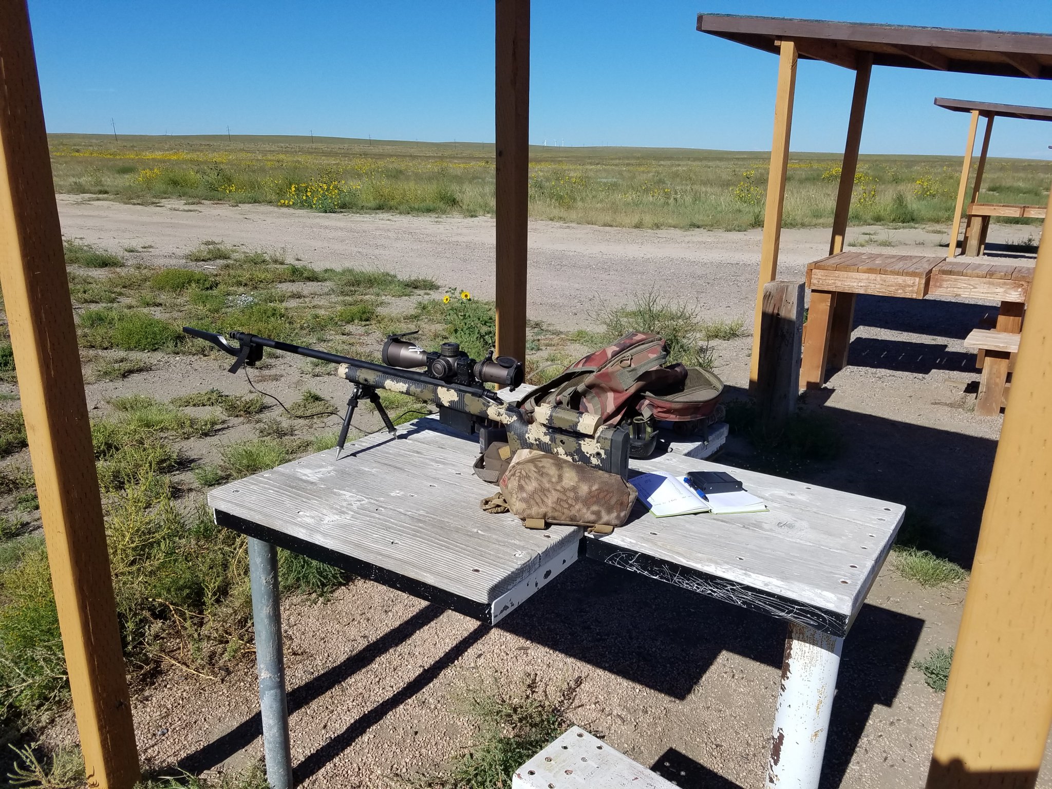

I'm at the range now letting my barrel cool. It's hot and humid again today and the RL33 is looking much better. I started at 90 grains and went up to 94 by 1gr. increments. Primers just started to flatten out at 93gr. Still no ejector marks. Great accuracy at 92 and 93. Haven't put the magnetospeed on yet. Just trying to check pressure and find a node.

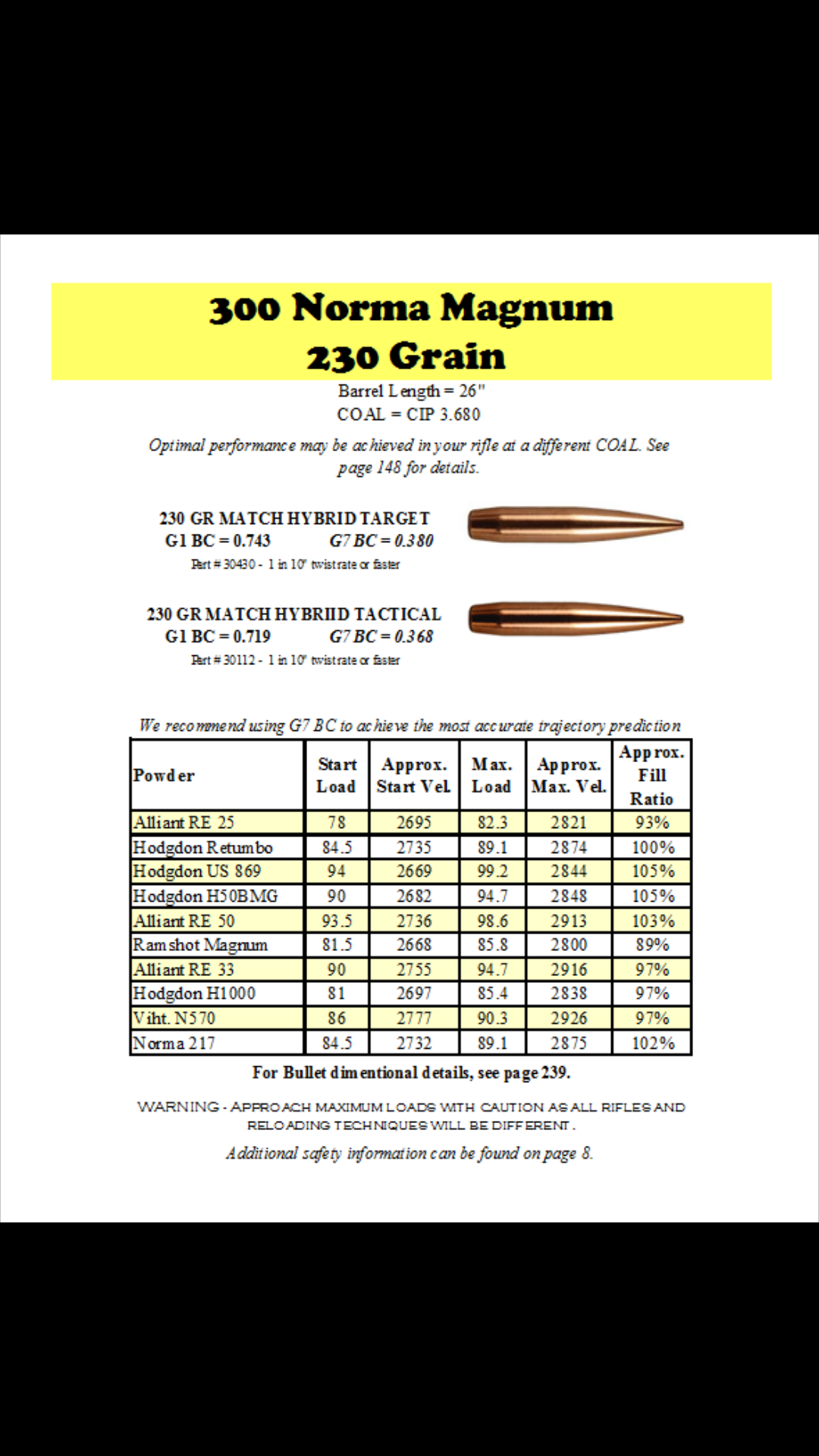

Its way off for me. I'm pushing 2940 with 83.6 GR of Retumbo and a 230 Berger Hybrid. I get stuck cases, hard bolt lift and a bunch of other pressure problems if I go north of 85 grains. Accuracy is good, so far around 1/2 moa out to 600 yards. This is with Norma brass which only seems to last me 3 loadings max before its smoked. I just got 100 cases of Peterson in the mail today which I'm going to do a whole new workup on with RE33.
Reactions: jonthomps
It's way too hot for me as well. I'd like to know what reamer the Berger guys were using to determine these numbers. I'm at 86gr of RE33 with a 215 moving at 3120fps from a 27" Bartlein barrel. 94 grains?!? I'd blow my gun up.
Is this a standard 300 norma. Not a improved
Yes, It's a standard Norma.
And I haven't seen that chart above on RE33 before. I could have sworn I saw a spreadsheet from Berger saying 93.2 was max recommended load using the 230gr Hybrid. Which seems more realistic. I think a person can push to 94grs with some rifles, I think mine could get there, but it would be smoking hot. 94.7grs is crazy. No idea how they are doing that.
And the velocity is off. I'm 130fps faster than their numbers using 1.1grs less powder. Same length 26" barrel. I can only speculate that their 10" twist rate allowed them to work up with a hair less pressure. Doesn't really explain the lower velocities though. My initial work up on the new rifle had a nice node at 2980fps (92.4grs RE33). After 150 rounds I worked up a new load that had a node that was only .2grs higher at 3050fps.
