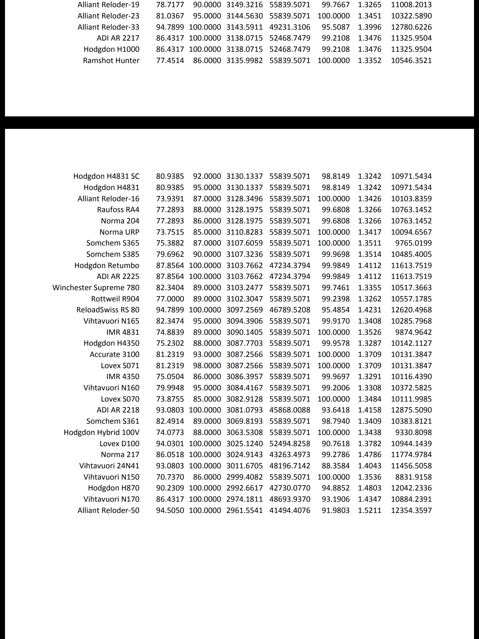

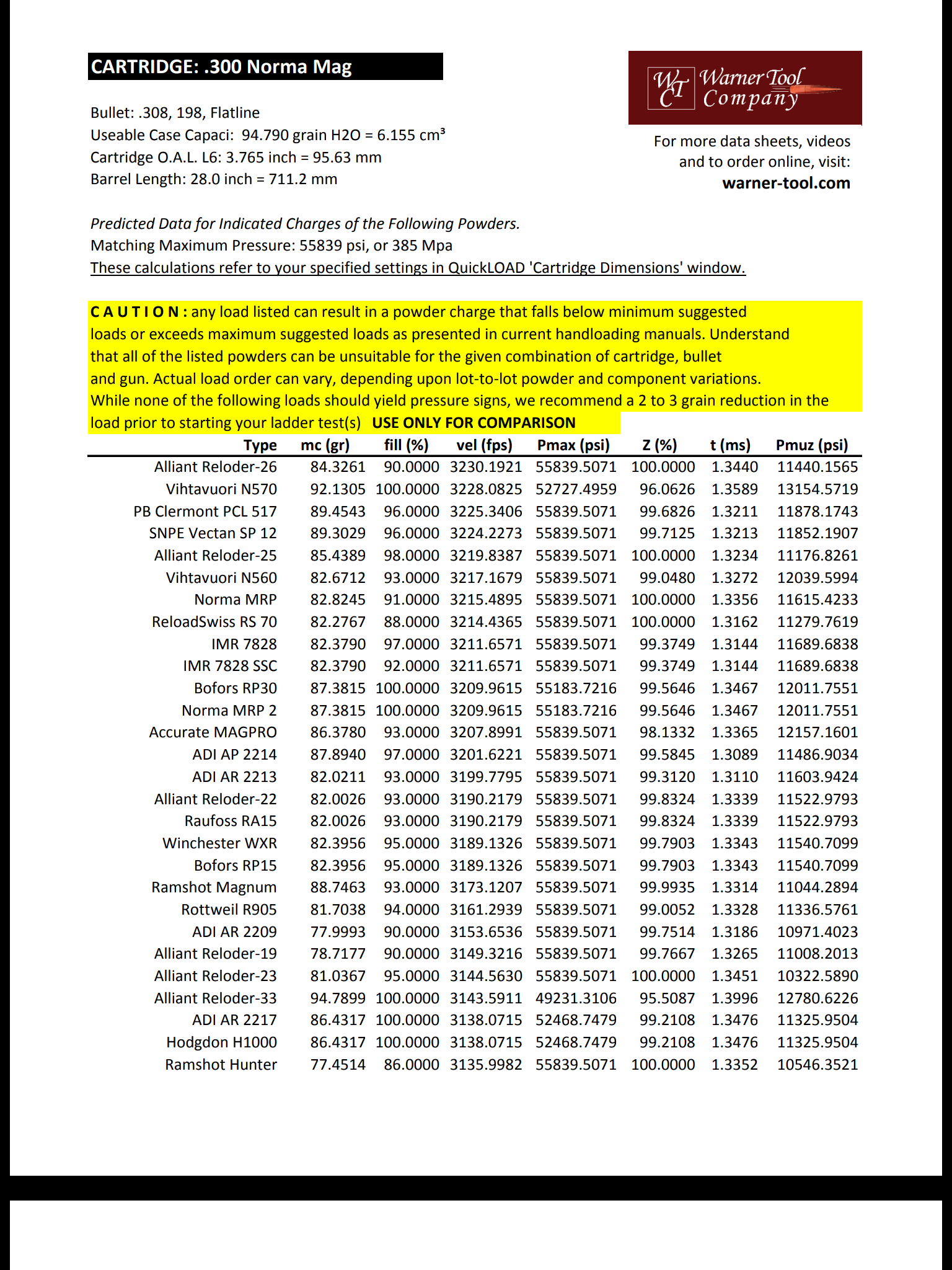

RL26 is your friend with flatlines and 300 Norma. 84 grains loaded to 3.765 OAL jumping a mile ~3150 from 28”. I made it up over 85 but it didn’t shoot as well. Love their ballistics but hate trying to spot them.
Retumbo is not even a decent choice with the Flatlines. N570 is really good according to Warner but about impossible to find. N570 has a 100% fill, only 2 FPS slower than RL26, and keeps max pressure low.
RL26 will get you a little more velocity but only a 90% fill so that may give you some problems.
RL25 might be the ideal choice as it is a 98% fill and only loses a couple FPS compared to RL26 and is a lot easier to find than N570.
Check out these charts from the Warner website for a 300 NM with 198gr Flatlines and a 28" barrel.

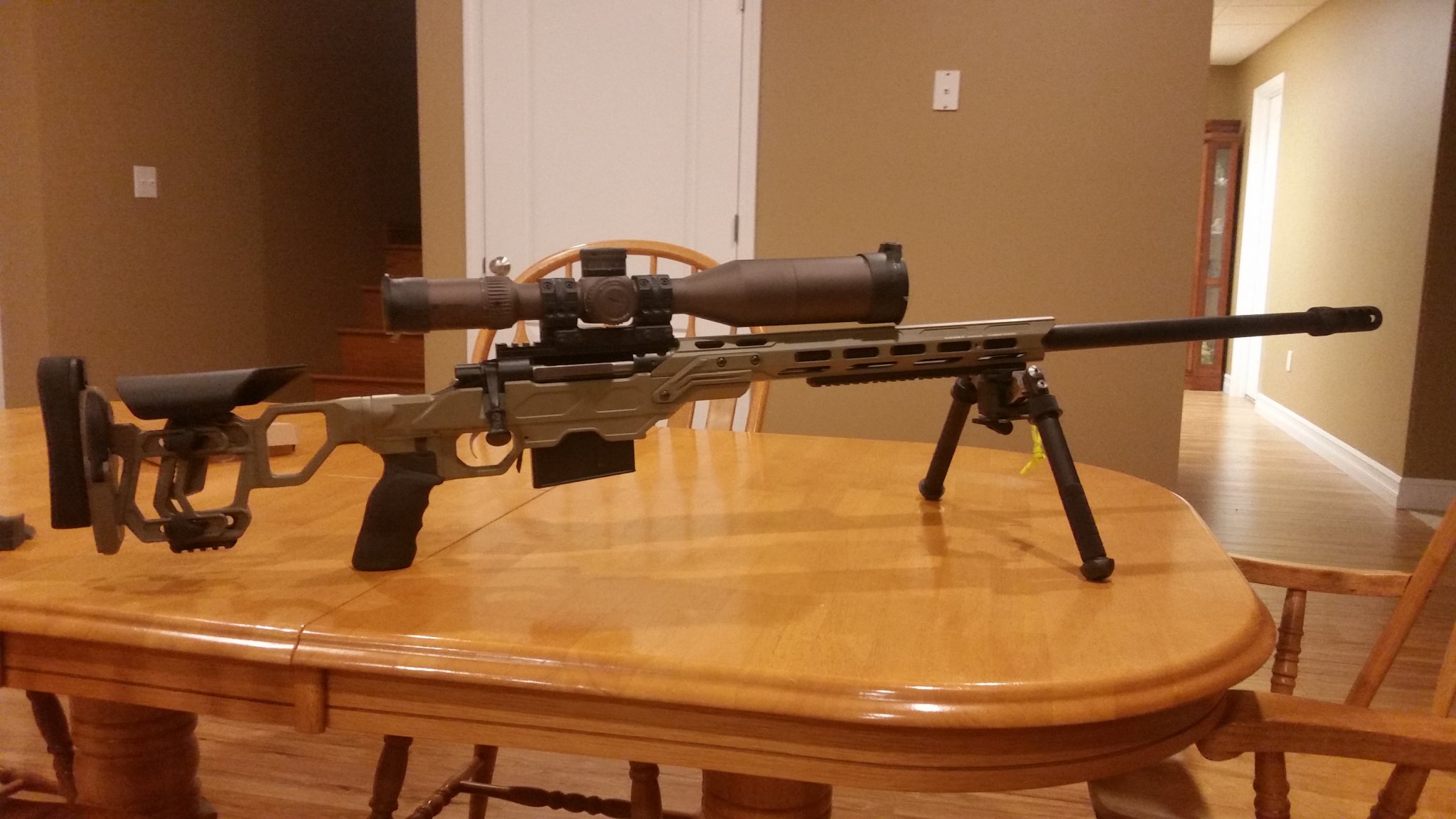

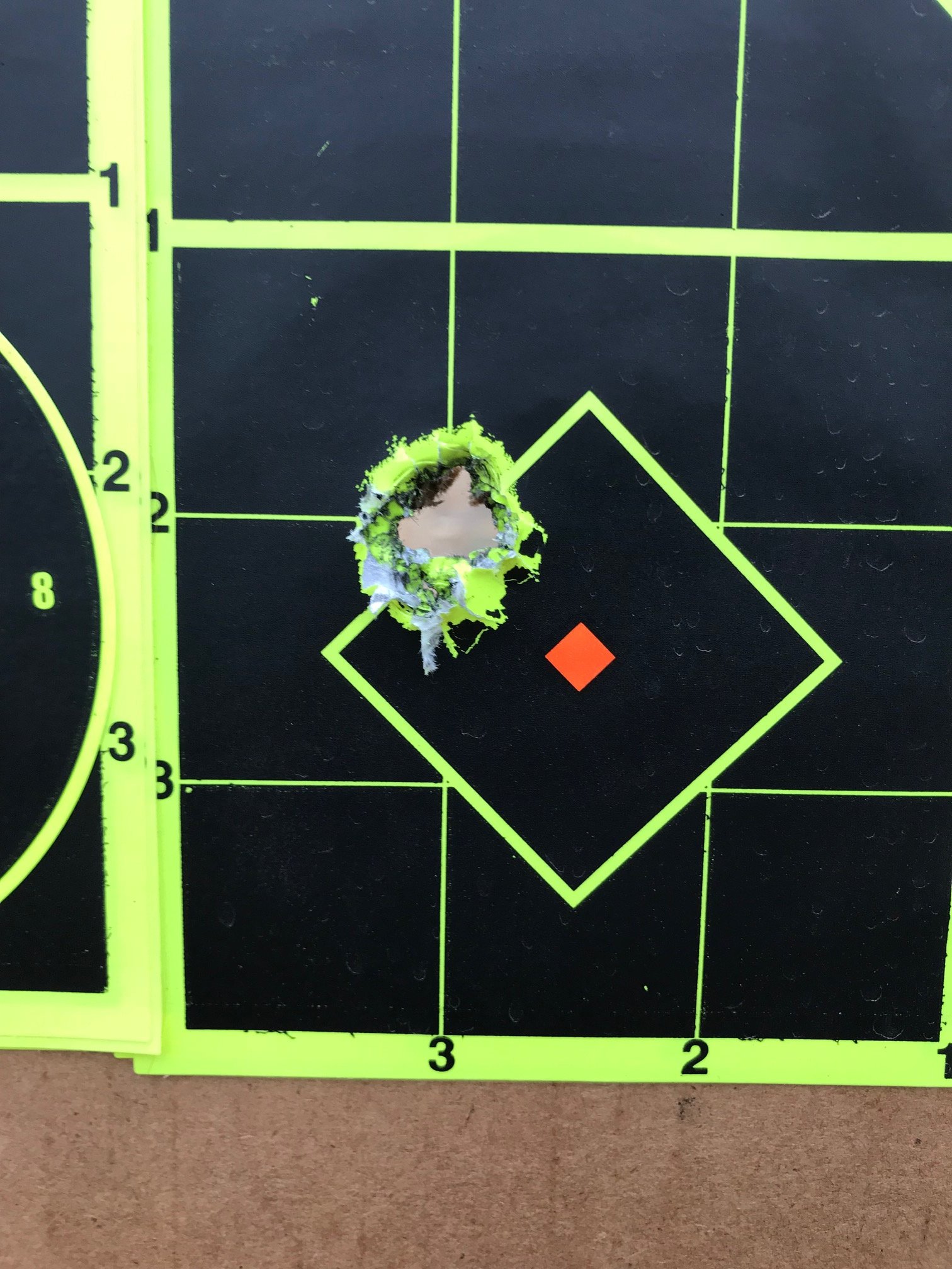

Doing load work up this evening with the new 300NM Moon built me. Bought 100 pcs of Peterson brass to test it out. All I can say is... DANG. This is the answer I've been waiting for! Consistent, high quality, and super tough. I wore my hand out priming them!
Here is a 5-shot group shot at 100y. 83gr of N570 pushing a 230 hybrid at a mild 2915fps. COAL: 3.600.
10.20.18 UPDATE: My barrel has sped up since this post and the same 83gr load is now producing 2970fps in virgin Peterson brass.

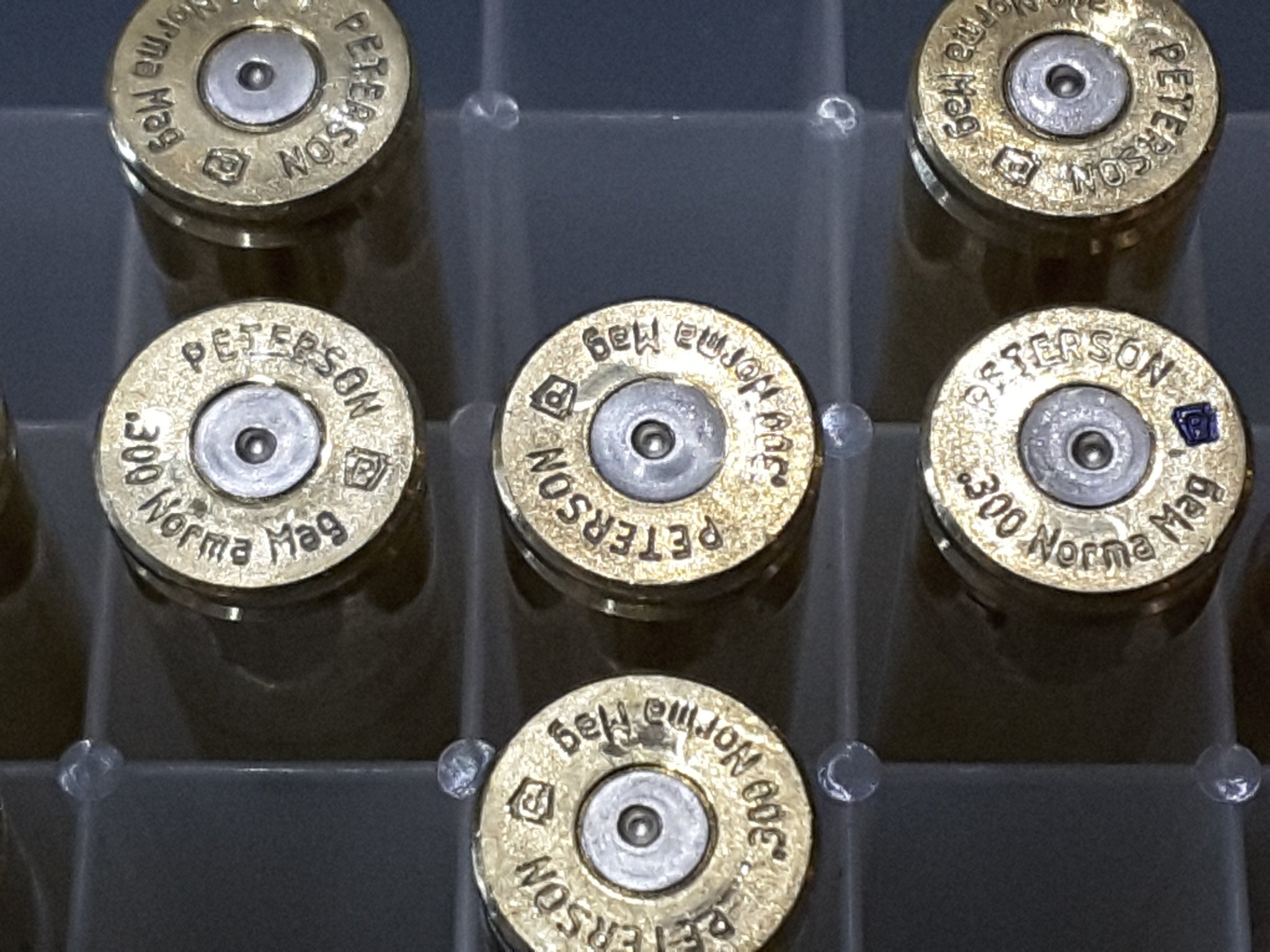

I picked up 100x Peterson brass as well and those primer pockets are super tight. Brings a new meaning to virgin brass...

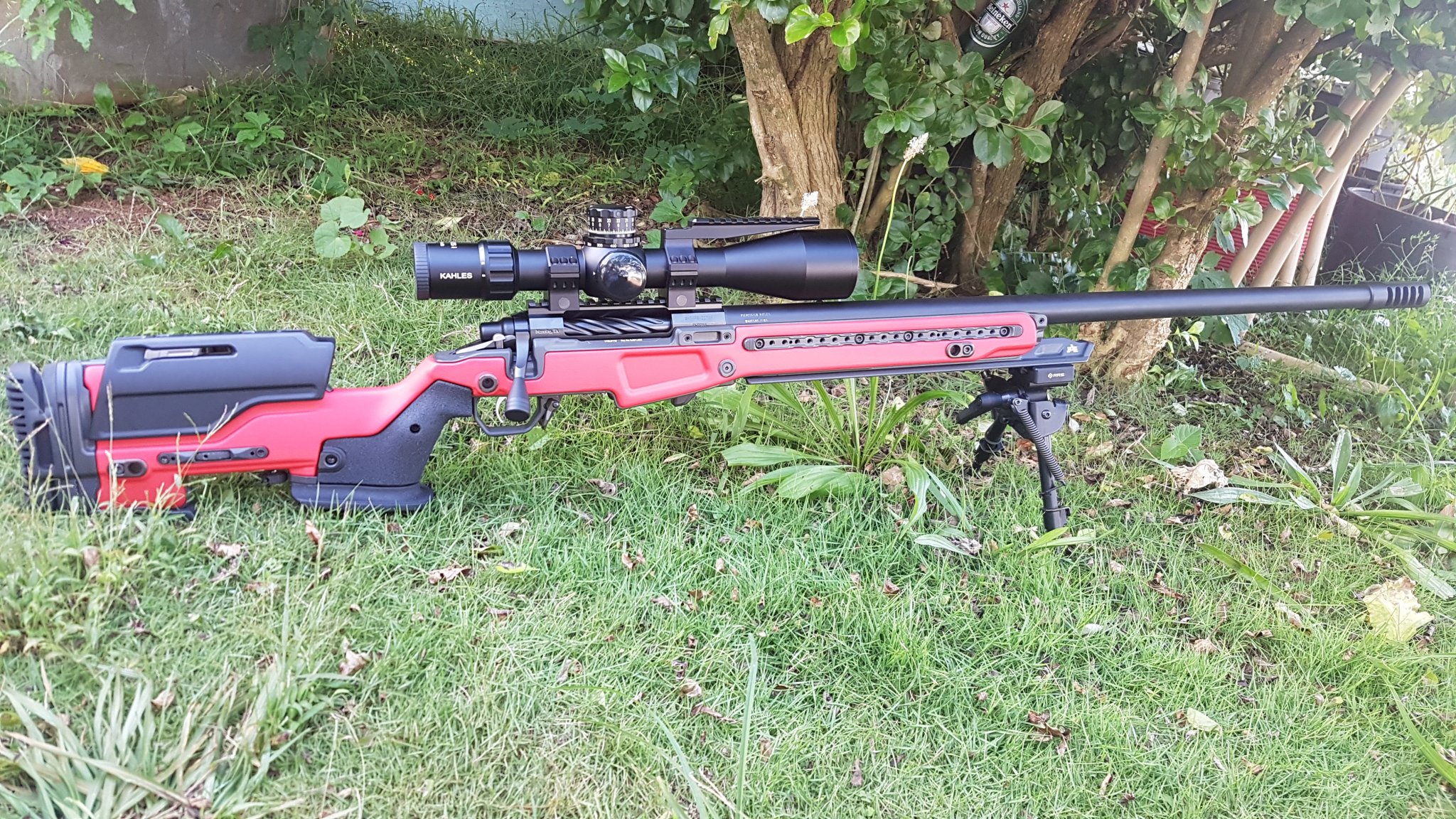

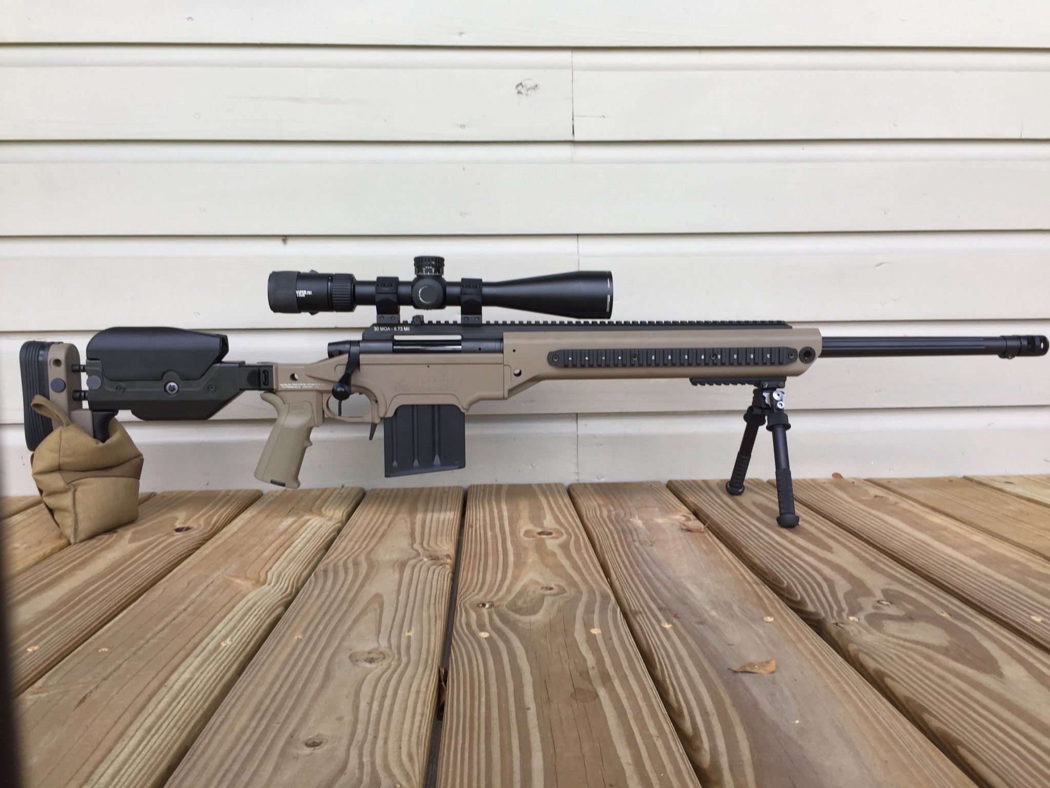

My 300 norma is on a mausingfield action, 30 inch bartlein heavy varmint barrel. Lri did the work and I sent the the cip length magazine and some peterson brass, and they had the 230 bergers on hand. They set the free bore to take advantage of the cip length. Any way this thing has 150 rounds through it now and I was running reloader 33. It shot every different load really well, this thing is literally a one hole gun. I found 93 grains of reloader 33 after about 100 rounds is giving me one hole 5 shot group, sd of 5 and 3112 average mv. The problem is with the re 33, after about 30 rounds it won't chamber the rounds. Clean it and it will, but damn that is some dirty powder. Ime going to turn the necks down, they are 16 thou on the peterson brass. So I put together some loads with retumbo, found a Excellent load at 86 grains, 15 though off lands, giving me 3042 mv, with sd of 4.5. All data collected with labradar. Shot 50 rounds through gun with retumbo, no problems with chambering rounds, cleaned it just to see and it is day and night from re 33. Ime sticking with retumbo. Its a shame re 33 is so dirty because it shoots so good. On a different note is anyone else turning the necks on peterson brass and if so what are you taking them down to? Thanks
Reactions: jonthomps
JMW - great looking rig! What are your rifle specs?
Thanks. LRI did a great job fitting the barrel, it shoots lights out, could not be happier. It's a mausingfield action, 30 inch bartlein heavy varmint 9 twist 5r. I don't know the exact neck or freebore, but I will find out soon and post it here. Bix'n andy tacsport pro 2 stage trigger, area 419 sidewinder muzzle brake, mpa ba chassis with some extra weight added, spuhr mount, vortex razor hd gen 2, 30 moa on the rail, and a atlas 5h bipod. Have only got to shoot it to 800 yards, waiting for the soy beans to get cut so I can stretch it out. 800 is a joke with this gun, hoping to get to a mile right after deer season. I highly recommend LRI, I have several guns built by them, and they all shoot well under 1/4 inch, provided I do my part. They have fast turn around time, which is important to me because Ime not the most patient person.

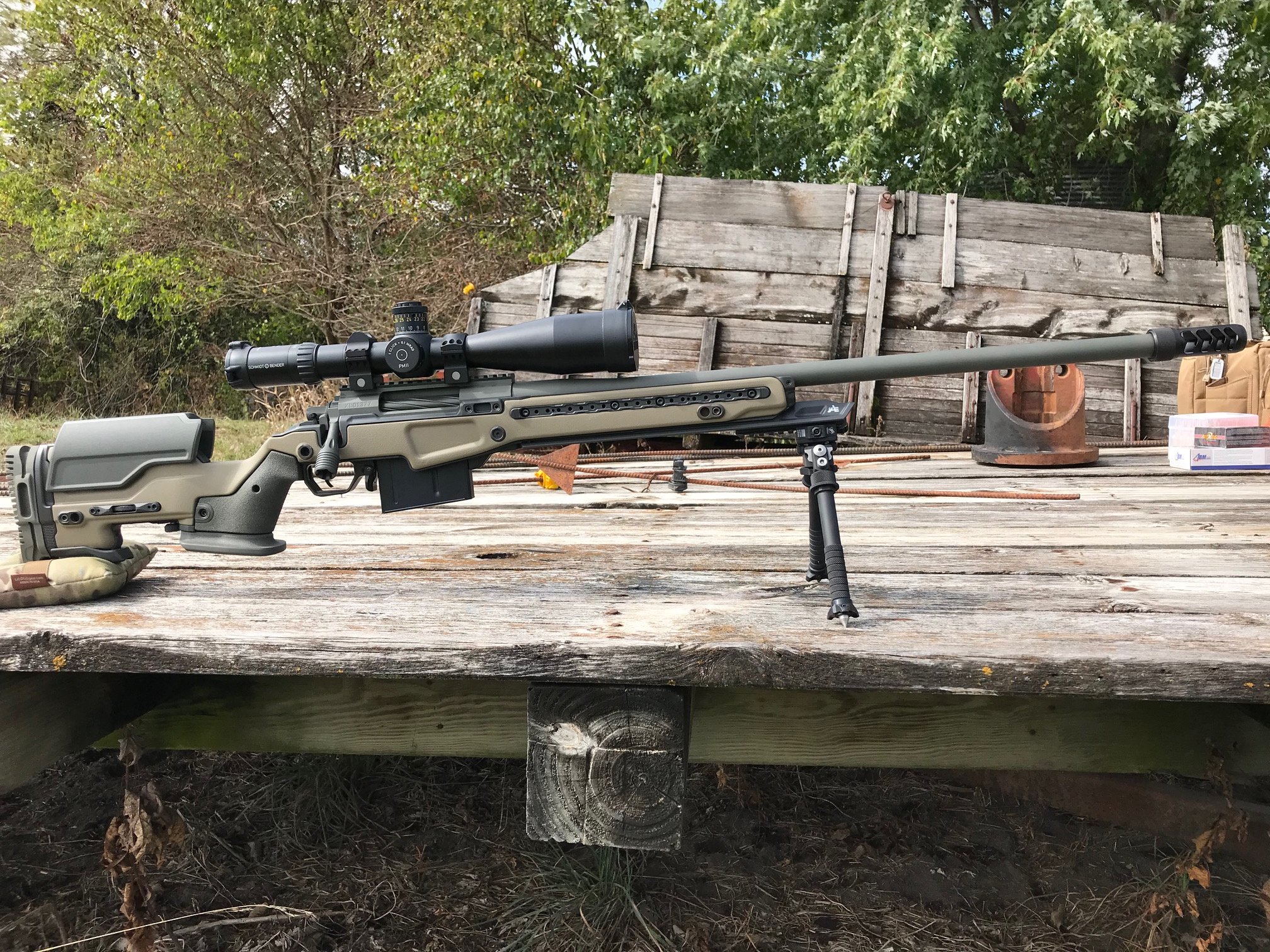

finally got mine shooting but seems slow for 210gr
27" hawk Hill 9t 210 JLK lbt peterson brass. Showing no pressure still. bolt lift is same as unfired, standard primers not flattened
95gr of rl33 3023
82gr of h1000 2915
85gr retumbo 2995
built this for a long range hunting gun primarily is the reason i was hoping for more speed. But proving dope yesterday i shot a 5 shot 6" group at 1090. good for the first 70rds down the pipe. Ill try to get a pic uploaded

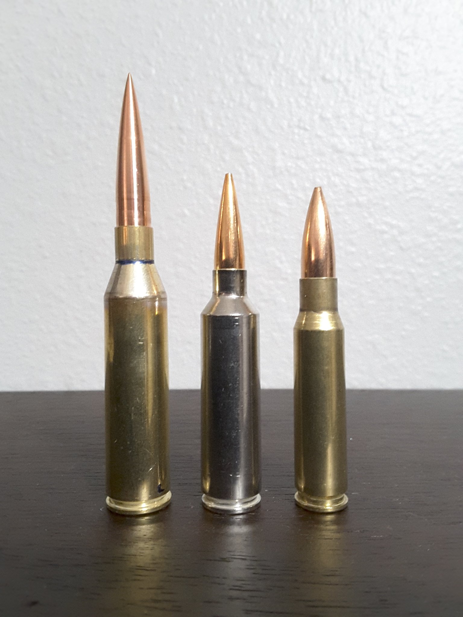

Finally got to take the .300 NM out to the range for the first load development session.
Barrel is a 28" Bartlein 5R with 1:8" twist, chambered by Short Action Customs. I didn't shoot groups on paper as my powder charges were varied and I only had 2 shots for most charges. Plus I was using a friend's LabRadar and couldn't get a decent position to shoot from while also getting the LabRadar to read, and the LR missed several shots over the day.
Load specs:
198 gr Warner Flatlines
Peterson Brass
Federal 215 Match primers
COAL touching lands 3.818"
Ogive length touching lands 2.802"
VV N570 88.2 gr to 92.2 gr (max is 92.1 gr according to the QuickLoad data on Warner's site at 100% fill, but doesn't quite max pressure out)
Velocities:
88.2 gr
XXXX FPS (did not read)
3106 FPS
3100 FPS
3099 FPS
Average 3102 FPS
88.8 gr
3141 FPS
3139 FPS
Average 3140 FPS (+38 FPS)
89.4 gr
3179 FPS
3148 FPS
Average 3164 FPS (+24 FPS)
90.0 gr
3200 FPS
3187 FPS
Average 3194 FPS (+30 FPS)
90.4 gr
3221 FPS
3222 FPS
Average 3222 FPS (+28 FPS)
90.8 gr
3211 FPS
3234 FPS
Average 3222 (+0 FPS)
One flattened primer
91.2 gr
3261 FPS
Average 3261 FPS (+39 FPS)
Bolt lift was still light at this point but I didn't want to shoot the other charges I had due to the primers giving out. There was no cratering but 2 primers really flattened out (see center and 3 o'clock primers in the photo) and I didn't want one to pierce. Does anyone know if Federal 215 Ms are soft? Any suggestions for tougher primers?
One of the ejectors (DTA bolt has two) has a sharp spot on it and kept scraping the brass so I will polish it and keep an eye out for any other issues. Due to this, all the brass to include the lowest charges all look like they have ejector swipe, but there is no mark where the ejector was during firing, so no brass is flowing into the ejector hole(s) in the boltface.
The next step will be to refine and reassess powder charges between about 89.4 and 90.6 grs. The barrel should speed up a little as it breaks in and I will post when I have more results.
From left to right the picture of bullets is a .300 NM with 198 gr Flatline, a 7 WSM with 180 gr Berger VLD, and .308 Win with 175 gr SMK.
