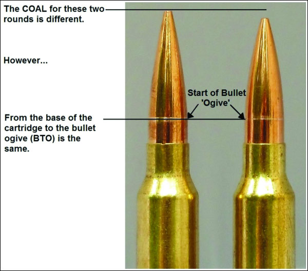

The better dimensions you should be measuring is where the bullet contacts the leade angle of the throat - which is the cartridge base to ogive dimension (CBTO). Reason why is bullet profiles differ and a secant ogive bullet has a much more slender and longer nose length which when measured out will give you a very long COL (cartridge base to bullet tip) and the illusion that it your barrel may have too long of a throat but your dimensions may very well be within specifications. The reason why is the bearing surface and contact point sits much farther back on a secant ogive bullet than tangent ogive bullet.
If within specs, your concerns about throat erosion should be alleviated.

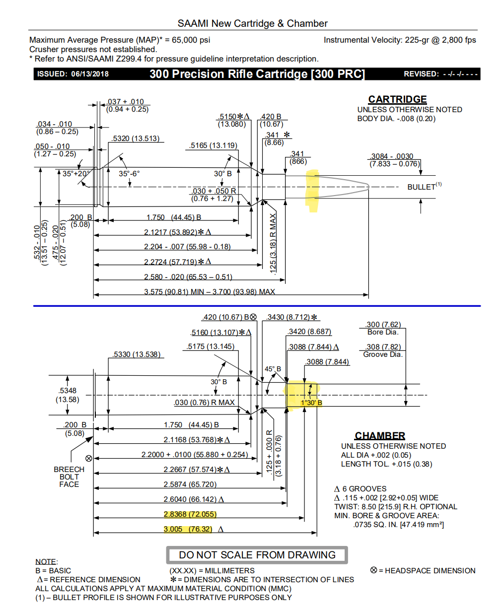

I have heard pretty bad things about PTG reamer. I am having a new 300PRC barrel spun up right now and he mentioned he would use whatever reamer I wanted except PTG.
Just make sure it has a .535 base. If you go with a minimum saami of .533 you might have some extraction/clicker issues. Some reamer makers like Manson are already doing something like .5345 which works as well. If not, then you can as for the AW2 version (Alex Wheeler as he's the one who figured the issue out early on).
We've had some come into the shop with issues and all it takes is spinning the wider base reamer by hand in the chamber to open it up, and solves the issue.
