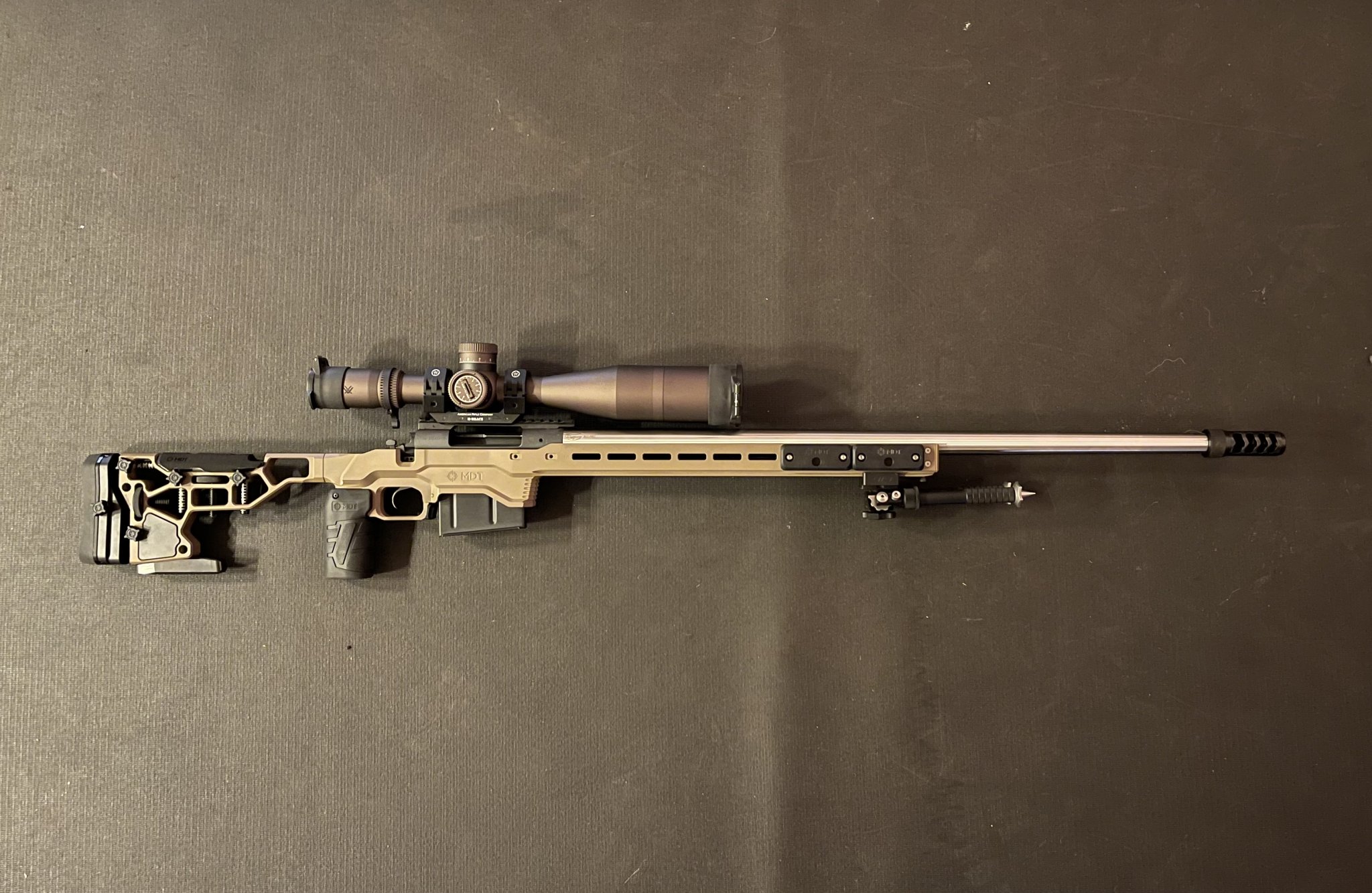

I’m about to pull the trigger on a new MPA Matrix Pro build, primarily for ELR, but it will see the occasional “sniper style” match. With this in mind, I keep flip flopping on barrel length, twist, and contour. Currently looking at 27-30” and a 1:9 or 1:8 (leaning toward 28”/1:9), with the MPA Match or MTU contour.
I have a bunch of factory Hornady 212eldx and 225eldm ammo I picked up a while back but have also been acquiring 230 and 250 A tips as I find them locally and will likely look for some 220/245 LRHT for future load development. RL26 is my powder choice as I can find it in Alaska with N565/568/H1000 and factory loads as a backup.
Having said all that, anyone care to help steer me toward a barrel length and twist that would best fit my needs/situation?

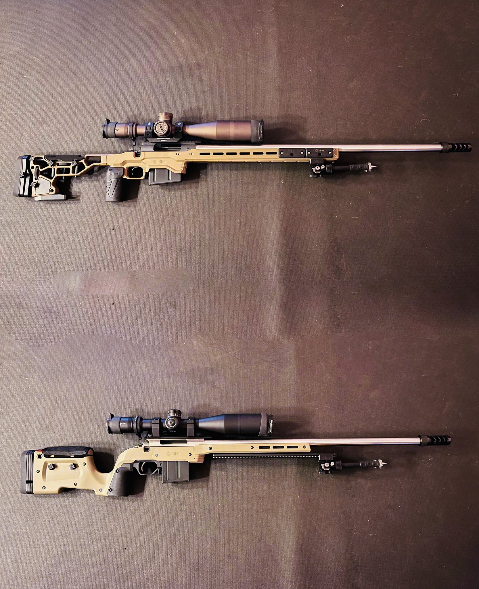

Here is the new girl too!
The top one in the first pic. The lower is my 6.5 cm.

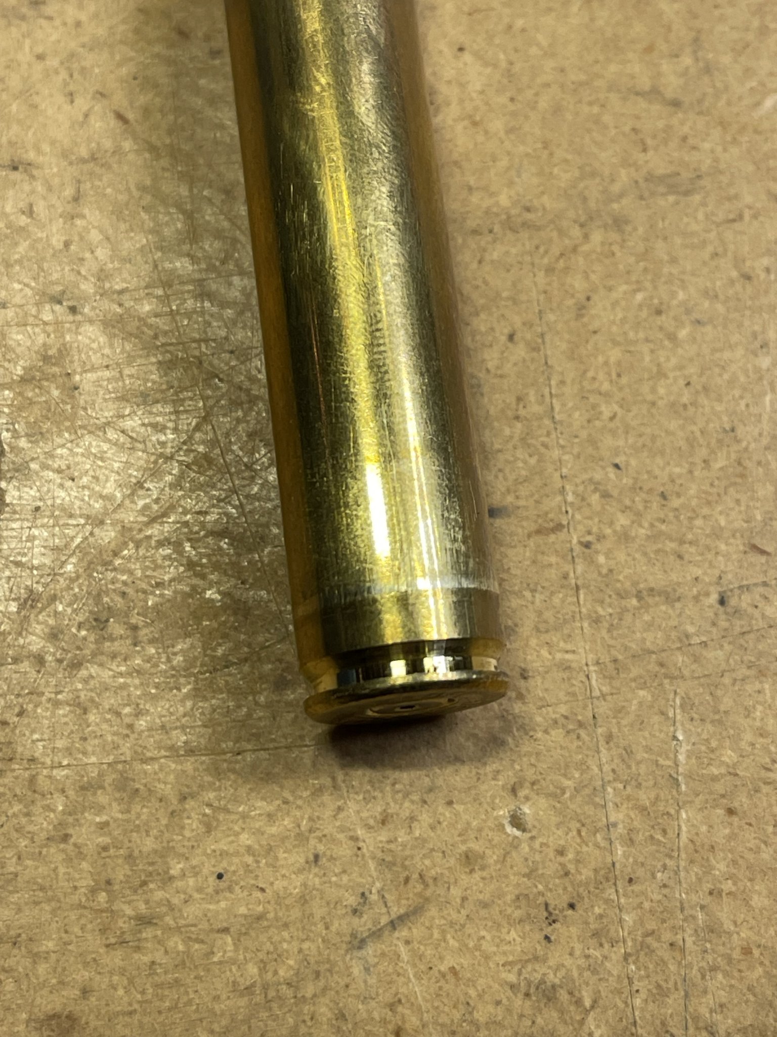

I am doing my load dev with the h1000 today and got a hard lift bolt and pressure signs for my first round, ie lowest charge. It was a slow velocity that I’d expect from the lower charge and nothing else showed signs of high pressures even other rounds at the same charge weight or rounds at nearly 3 grains higher.
All the brass was treated the same as well, same annealing, same resizing etc. So what about that SINGLE round or piece of brass would have caused that?
Charge weight? Virgin brass? Barrel length? Velocity? Do you have a saami chamber or the AW2? If it is previously fired brass what die?
30” Barrel, custom throat from PVA, that I’ve seated for and shot a least few hundred rounds through at this point, with the same 220 Berger LRHT bullet and same Lapua brass but with different powder. Charge weight was 75.6.
Bras had 5 previous firings and annealed and full length resized… I’m kind of at a loss for the cause. Like I said the other rounds at the same charge had no signs. The rounds up to and including 78.2 had no signs either….

Question...since this was your very first round....did you leave just a little bit of cleaning fluid or oil in the barrel? If you have any moisture in your barrel...ie some liquid cleaner....left kroil in there...whatever...this is an uncompressible liquid that will cause a spike in pressure on even a modest load....especially on a July day.
#2 is possible but I highly doubt since you aren't running an excessively light load...but for the sake of discussion....if you put too little powder in your magnums....and it's a fast powder.....when the round is laying on its side in the chamber...the powder doesn't cover the entire flash hole. This allows the flame from the primer to flash across the entire column of powder and cause an increase in pressure that is WAY too high. Too little powder in a load can cause a catastrophic failure of your firearm and most people don't know this.
I would bet you had some oil or something in your chamber and caused that very first round to be high pressured. You can kiss that primer pocket goodbye....into the ole recycle bucket.

Thanks for the info! Honestly I think I know why it happened but I can’t be sure since it’s after the fact but long story short it was possibly a stupid reloading error on my part.
That said that last part you pose is really interesting! Is it has there been any ballistics papers written about the phenomenon?

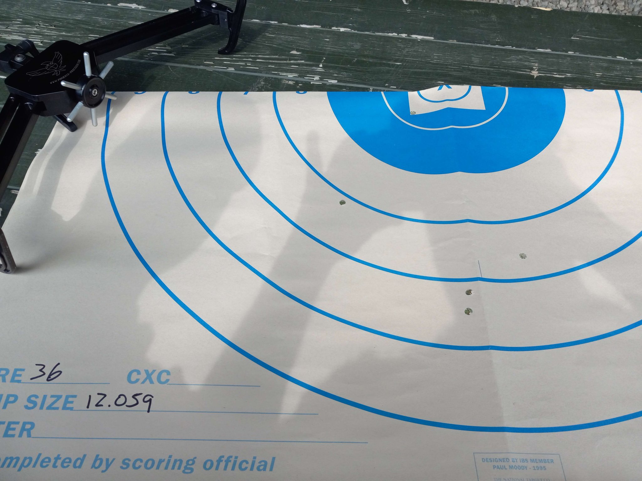

So, below is a picture of a group I shot this past weekend at TVP in a 1 mile benchrest match. The other 2 targets I shot that day did not have 5 on for a scoreable target because I didn't guess the wind correctly on a few shots and had some sail off the target due to a wind gust that I didn't see. This current barrel now has right at 1600 rounds on it. The highest on on the target could have been the 5th shot with increased speed due to heat on the barrel; but upon reflection I believe it was caused by not shooting in the same lighting condition...ie....the sun was popping in and out of the cloud cover. For those that don't know...optically the target can move from where you see it...and can cause up to 1 MOA of shift from behind a dark cloud to sunny. Anyway, enough excuses:
Yes....'not in the bullseye'....but at 1 mile...being a tad off on your sighters and you get no feedback to where you are hitting the target. I was very proud of my wind calls on this target. Wind was very strange. Flag behind the 1 mile berm was dead. I had 3.2 mils of left on the scope. The previous target I had 0.8mils of right on the scope.
