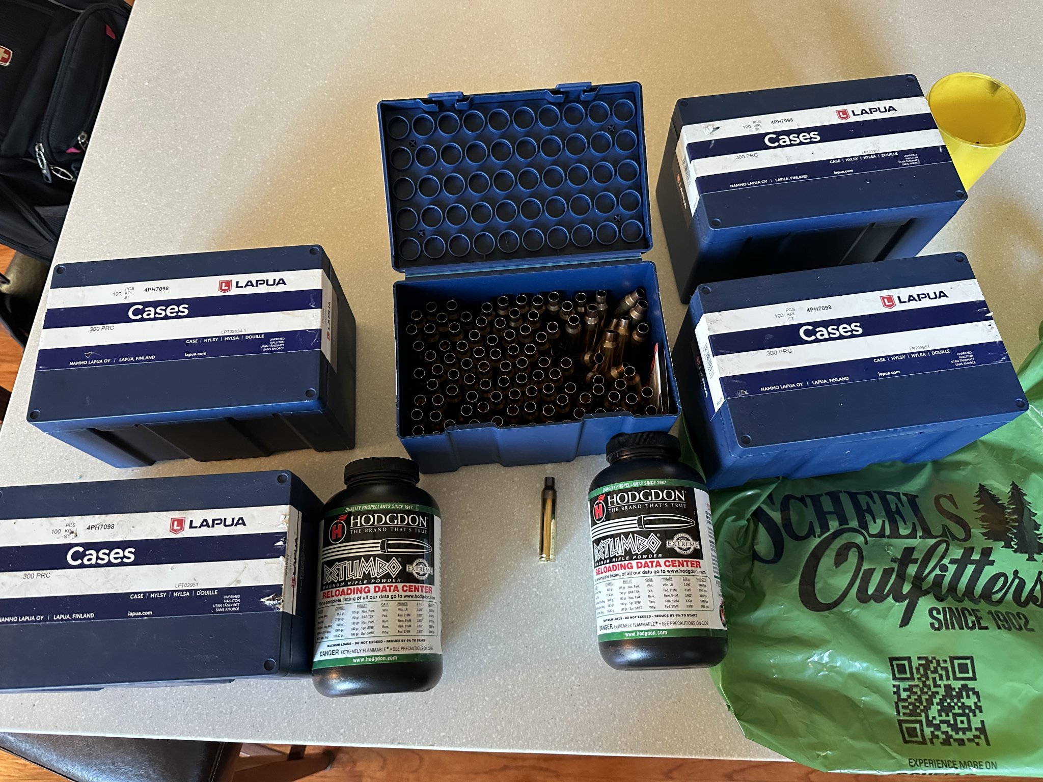

Hi all… I am ready to step onto the world of high powered magnum rifles….
Lightweight hunting rifle is ideal for me right now. Not sure if I want a custom action or pick up a proof 300prc prebuilt or seekins?
only drawback I see is the limited types of powder for the heavy 200+ grain bullets
During the absolute primer heist, everybody locally was out cutting online with inflated prices. Not sure how competition guys got their primers , but Scheels had them in stock when no one else did.
So that’s why I give Scheels outfitters props.
This quantity of brass should be enough for 3 barrels lol
How many times can you typically reload the 300prc Lappula brass?
Obviously not all things equal but with relative conservative pressures. ( i’d like to have a mid range node as far as powder loads, but beggars can’t be choosers.
