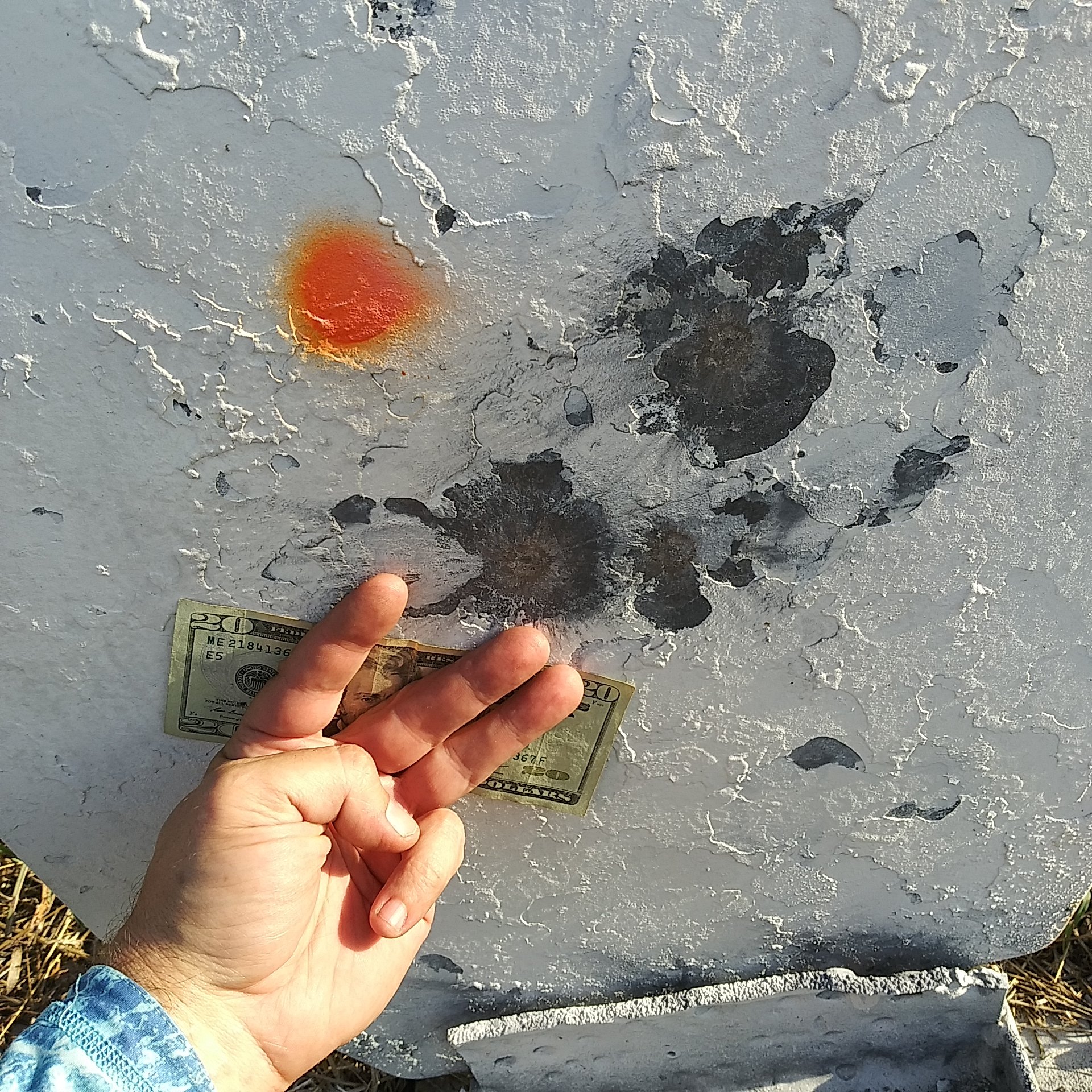

I am not sure if this is something for a new thread or just keep it here...
As a refresher, i am shooting a 300PRC, 30" barrel, 1:9twist, Berger 230gr HOTM and my average MV is 2972. I previously used a LabRadar to get my MV and have since moved over to the Garmin Xero. My scope is a Vortex Razor Gen III 6-36x56.
I setup my scope with a mount that allows me to set a 800yd zero with enough elevation to reach out to 2200yards.
I was at the one-mile on Sunday and the gun performed well. However, the predicted elevation was 46MOA but the actual elevation as dialed in on the scope was about 43.5 MOA. I received my calculation for windage using a Kestrel, Vortex Fury HD AB, and an app on my phone and all provided similar predictions of 46MOA. When i calculated what the correction would be to true the MV, the difference was appx 70fps (initial MV was 2972 and calculated correction was 3042MV). I previously noticed a similar correction needed back in March on the same Rifle/Scope during my first ELR experience.
My question is whether or not this is normal. I am guessing that the need for a correction could be caused by a number of different factors including differences in how the scope measures and other factors.
In the end, what I am trying to understand is what could be the cause of the difference and whether or not to manually update my MV in my calculation.
Have you tried truing the BC to match the actual MV and elevation you were using?

The following was using 230gr Berger HOTM, 77.8gr N565, CCI #250 Magnum Large Rifle Primers
300PRC one-mile at Clinton House SC
#Speed (FPS)Δ AVG (FPS)Time
12996.823.911:06:16 AM
22963.7-9.211:08:12 AM
32961.6-11.411:10:46 AM
42978.65.711:12:22 AM
52974.21.311:13:57 AM
62954.0-19.011:15:49 AM
72961.6-11.411:24:44 AM
82972.90.011:27:12 AM
92979.97.011:28:59 AM
102961.2-11.811:30:59 AM
112991.518.611:33:08 AM
122967.6-5.411:36:53 AM
132984.611.711:40:33 AM
AVERAGE SPEED2972.9
STD DEV12.4
SPREAD42.8
SESSION NOTE0.0
DATEJune 23, 2024 at 11:02 AM
Before adjusting BC make sure your look angle and sight height is set correctly. Maybe do a tall target test to validate your scope!!
Got it... good points, thanks
As for look angle, I am assuming that is the same as LOS. At the mile, that was kinda hard to confirm but it was pretty much right on, less than 10 degrees for sure.
I have never tried that. I will look into it.
Is that the preferred approach over changing the MV?
My preferred method is to put a cheap chrono behind the steel plate your shooting and at the distance you are shooting. I did this for my 6.5 CM and trued the BC to actual speeds. Now that I have the 300PRC new loads tested I might try the same thing at 1000yds next time I'm shooting.

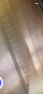

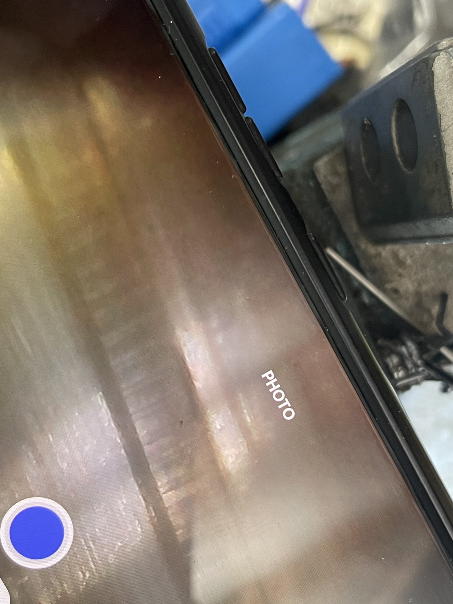

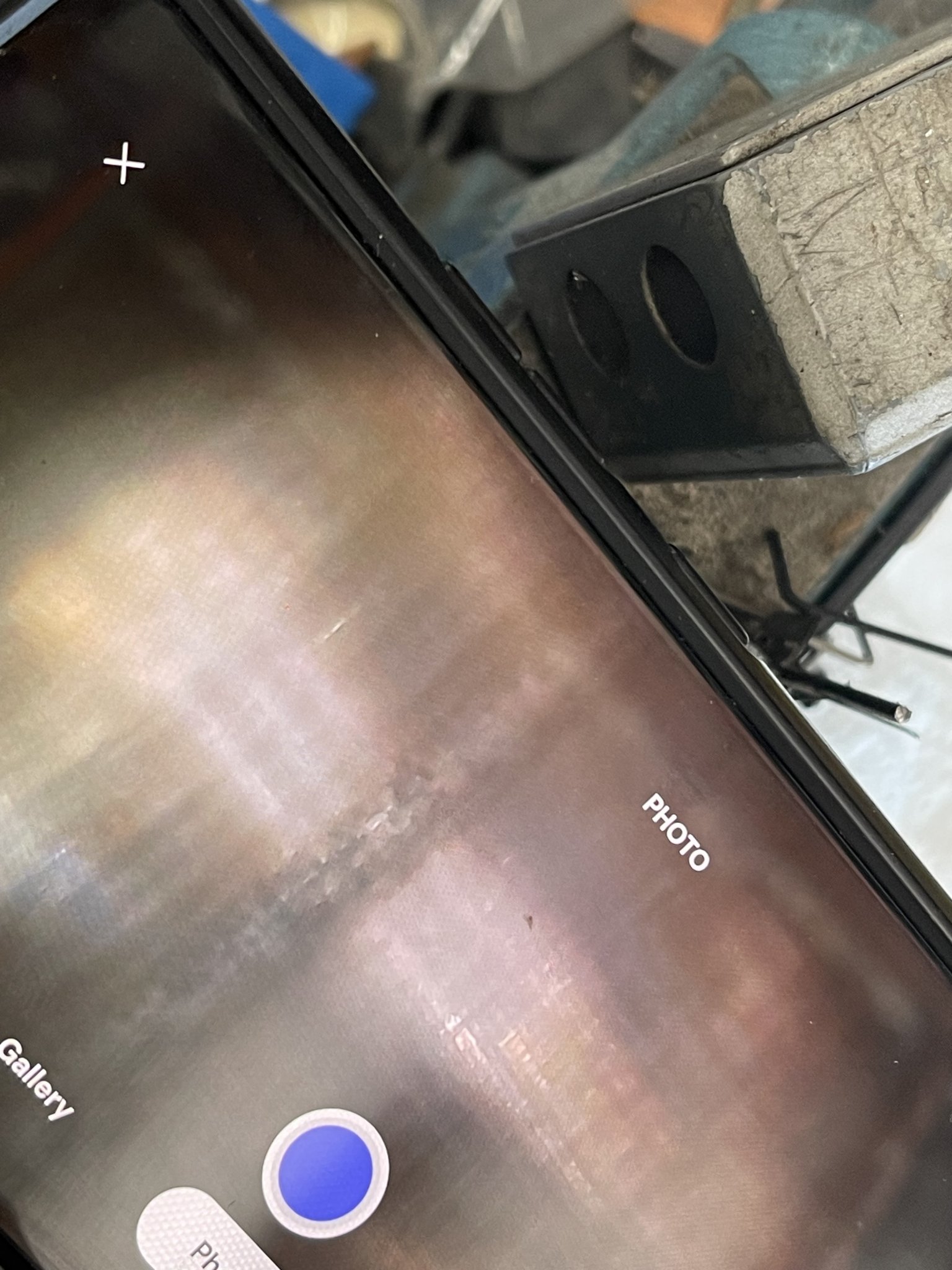

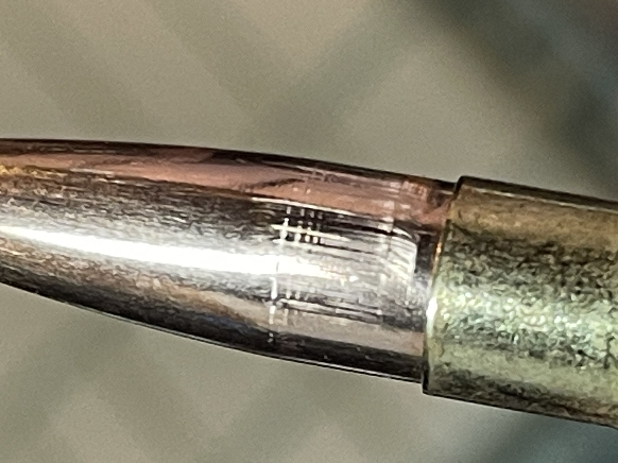

What’s your first thought on this factory ammo chambered and then ejected in a brand new barrel?
It looks like this all the way around and I can feel them with my fingernail.
Looks like they are jamming the lands. Lucky to get it out without powder spill into trigger area. What round and barrel/rifle?
Sorry for the bad pics. I took a pic of another phones screen, so it’s not nearly as clear and detailed as it actually was. Chambering doesn’t look too bad. But the rifling…..😳
The chatter runs the entire length of the barrel in all 6 rifle grooves.
What makes it worse (and scary) is that the minor measurement that should be .300 dead nuts, we couldn’t fit a .295 in the barrel. It was too big!
I shot 5 rounds down this brand new barrel, and the fire cracking in the throat looks like 1000 rounds

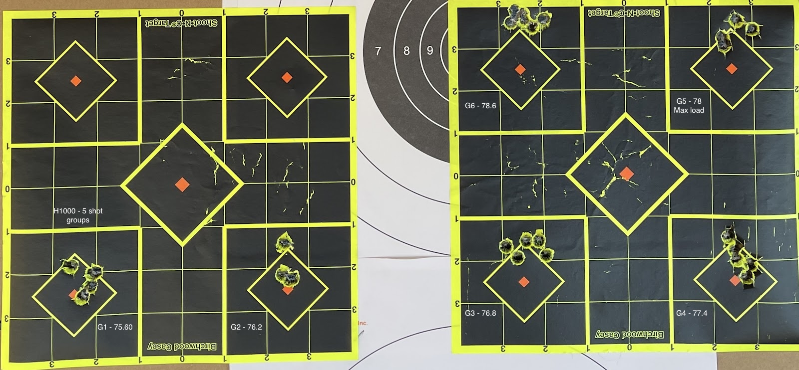

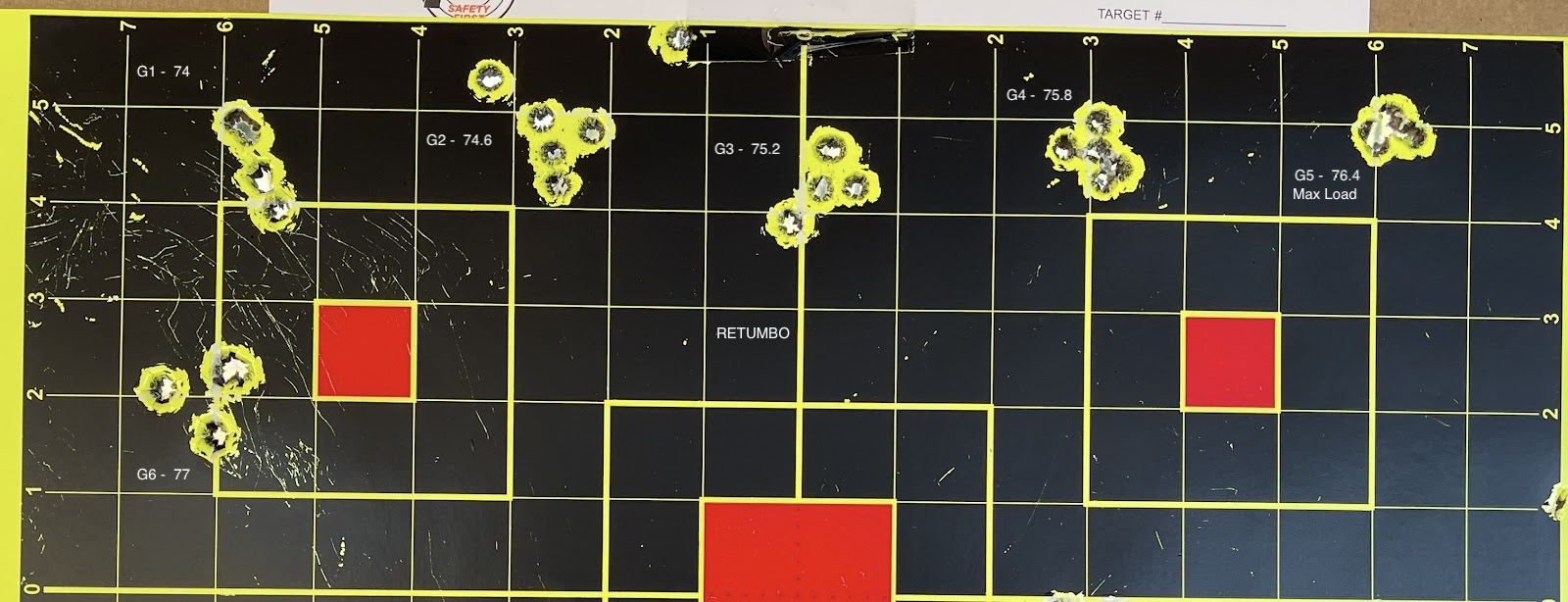

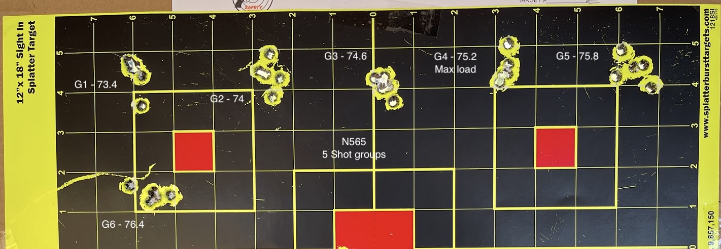

I had a lot of time and components to waste so I did the OCW test with 3 different powders.
Which one would you pick? (220 Berger LRHT + Lapua Brass, 100 yards)
I like 74.6 of N565
Max load 76.4 looks great, but depending on fps wants, I’d take accurate easy load that’s not pushing the limits of my gear.
What kind of speed you getting with this?
I like 74.6 of N565
2,761 fps average.
I'm not really aiming for a high velocity, as long as it's not too slow and as long as I can hit the target at a mile.
this group POI is a bit lower than the one to its left and its right. wouldn't that be a problem?
I didn't hit any pressure signs for any of those loads. the "max load" refers to what the manufacture websites recommend.

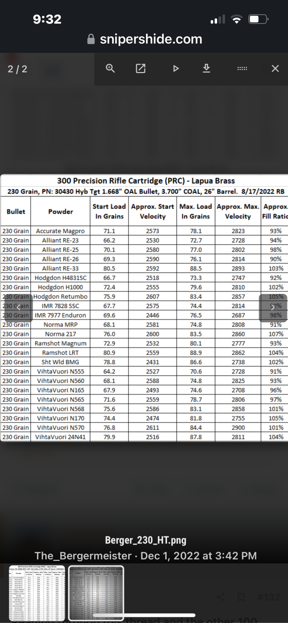

Yeah, but my point is that I don’t think that’s right. I have data sent straight from Berger for 230gr LRHT. With Retumbo their STARTING load isn’t much less than what you’re showing as “max”. For the 230, they start at 75.9 and go to a Max of 83.4. Obviously, your lighter 220gr bullet should allow the charges to be even higher. I started to bump into pressure at 80.0 with the 230, but you shouldn’t even be really in the ballpark at 76.4, especially with a 220.
Yeah, but my point is that I don’t think that’s right. I have data sent straight from Berger for 230gr LRHT. With Retumbo their STARTING load isn’t much less than what you’re showing as “max”. For the 230, they start at 75.9 and go to a Max of 83.4. Obviously, your lighter 220gr bullet should allow the charges to be even higher. I started to bump into pressure at 80.0 with the 230, but you shouldn’t even be really in the ballpark at 76.4, especially with a 220.View attachment 8469117
I used the data from Hodgon. Yes I have seen that table from Berger. Not sure who is correct so I used the lower ones.
I like 74.6 of N565
I think I will pick that for my seating depth test. One question, is it necessary a bad thing to see the vertical strings in this group and the two next to it?
For me, and I’m only slightly better than a novice, unless I have the rifle strapped to a sled, vertical stringing could be heartbeat, but that’s just my personal feeling on that. How much is the bullet and how much is my heartbeat?
If you can put it in a sled where you don’t factor into movement guaranteed, that’s when you’ll know for sure.
Just my 2c which is usually worth less than a dime 😁

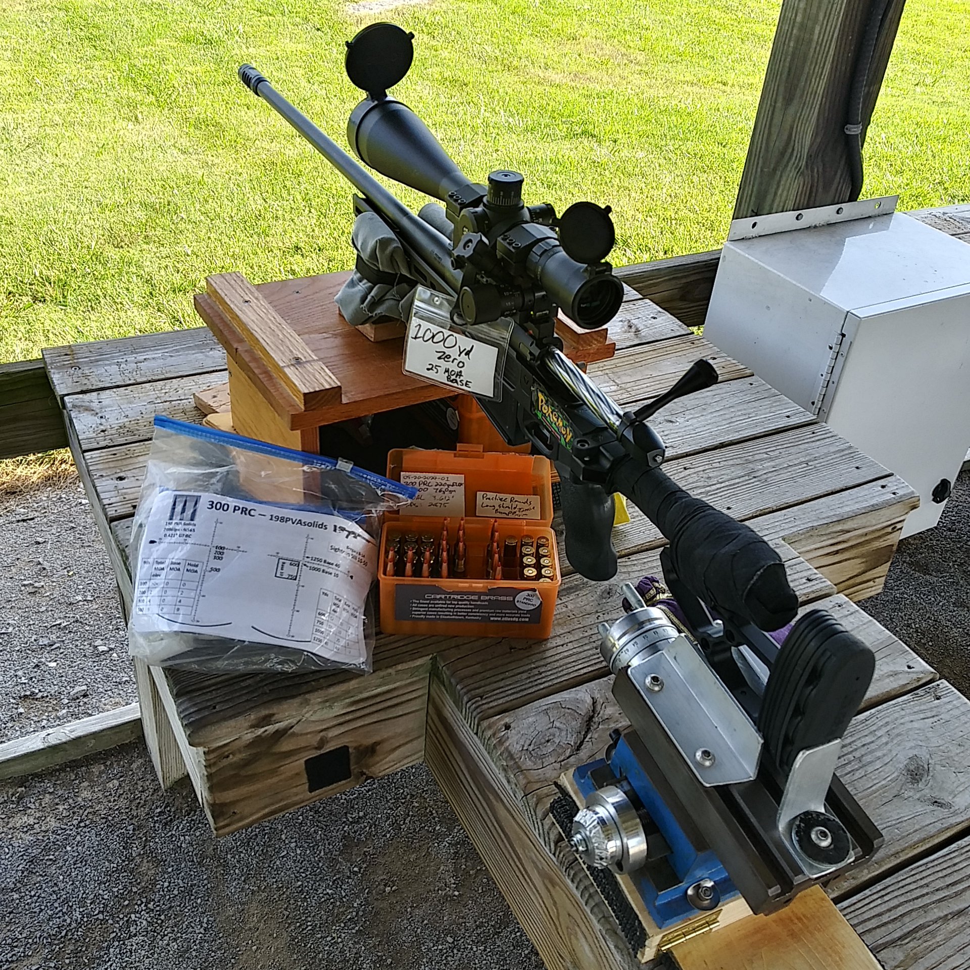

My setup
