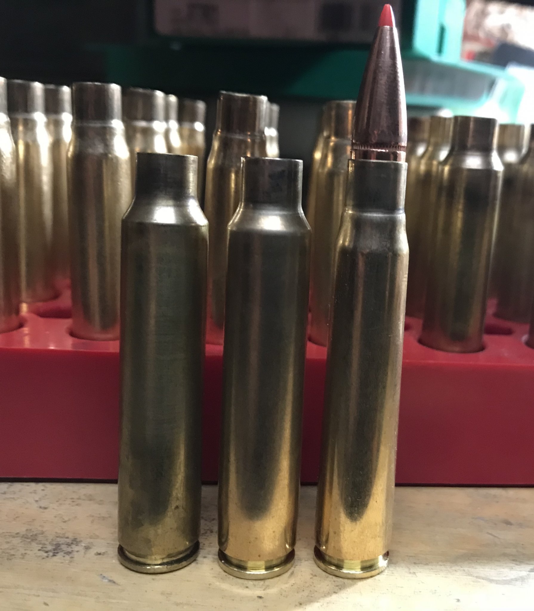

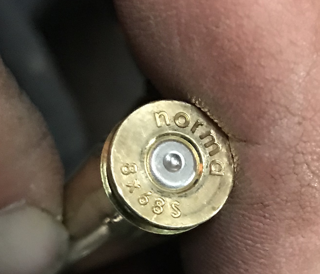

im shooting a 338/375 ruger xl. Love it. I ran my reamer .025” deeper so I can use Norma or RWS 8x68 s brass and fire form with out trimming. Gained about 4% capacity. Shooting a 250 gr Berger at 3025 fps from a 30”
what is the angle of the shoulder after firing the RWS brass?
Reactions: jasent
Left to right
375 ruger hornady brass, fire formed 1x 8x68 s Norma, ready to fire form 8x68s brass. I don’t have any pics of the RWS
The head is .020” smaller on the 8x68 brass but I’ve had zero extraction issues
Shoulder is still 30° But my case walls are .025” longer. And case length is 2.605” after fire forming. Reamer design was just a straight neck down of 375 ruger to 338 but I didn’t want to have to trim brass to fire form and liked the extra capacity. So I ran the reamer in an extra .025”. I simply neck up the 8x68 to 375 with a fl 375 ruger die. Then neck down to 338 using 338 rcm die adjusted Appropriately to form a false shoulder that’s slightly crush fit in the chamber to hold the brass still to fire form. 100% success with zero kulls.
My Hornady brass it 103.4. Norma is 98.8gr H2o

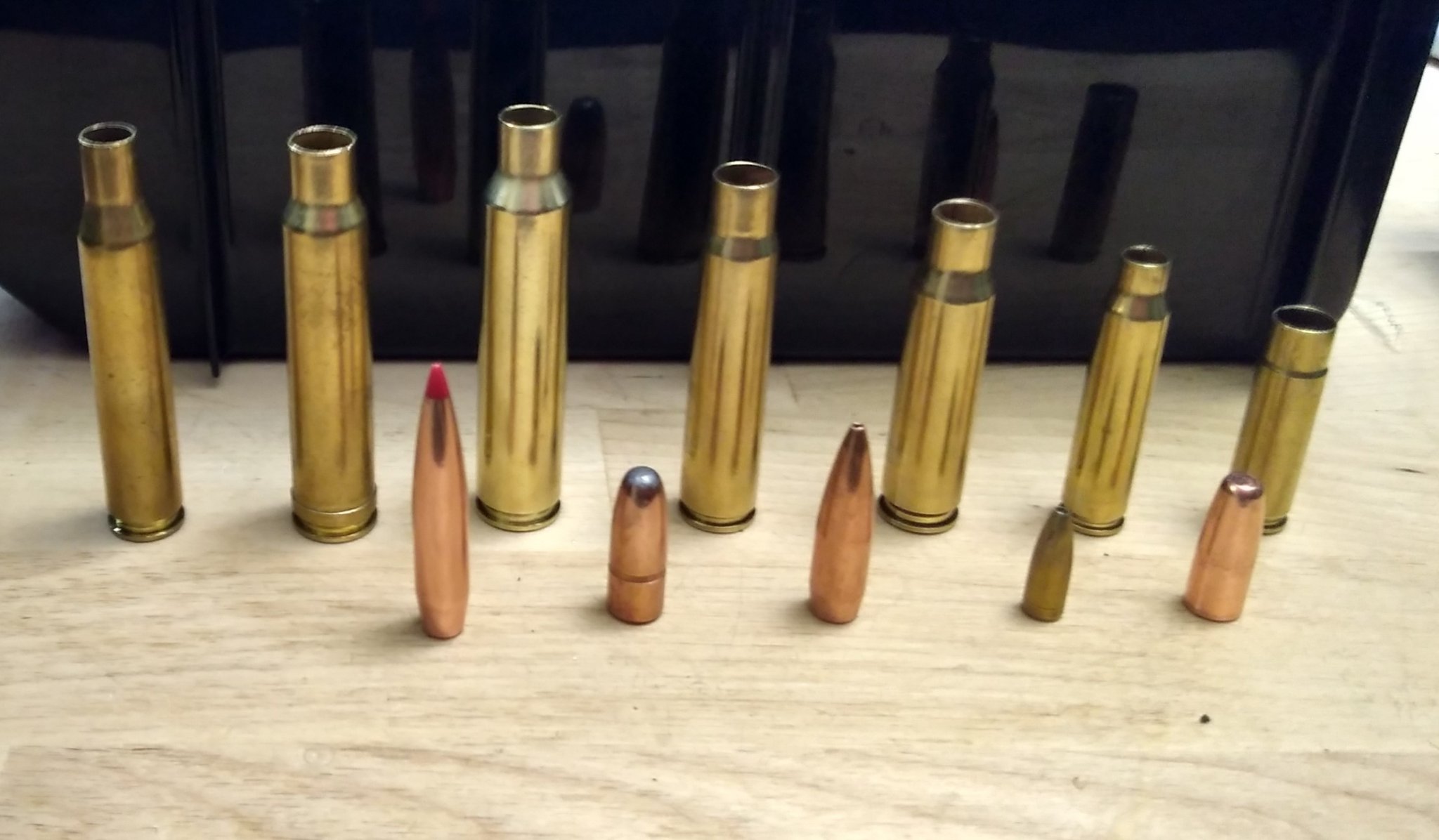

Just for reference: Left to right: 270WIN, 338 WIN MAG, 300 PRC with 225gr ELD-M, 8mm Mauser with 170gr Interlocks, 308 WIN with 168gr Everglades Match, 5.56 with 60gr 22lr to .224 corbin die swaged, and the 300blk with 150gr plated.

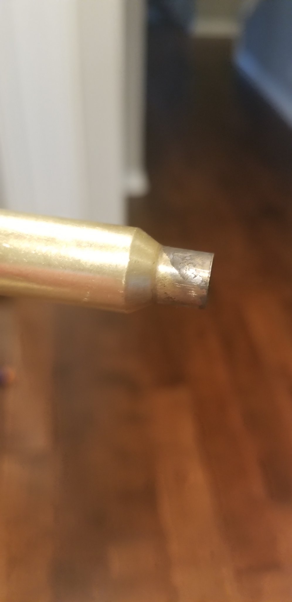

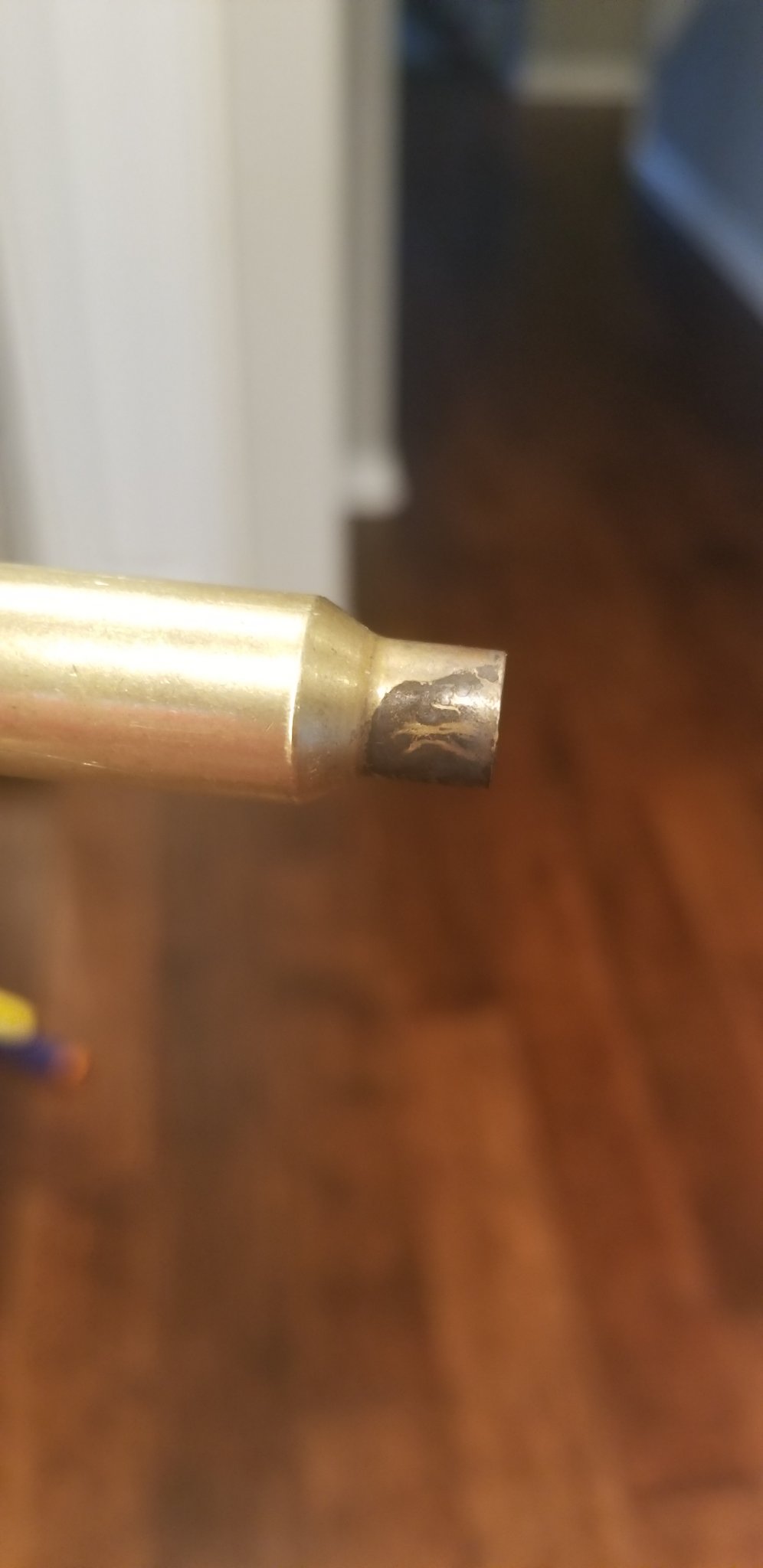

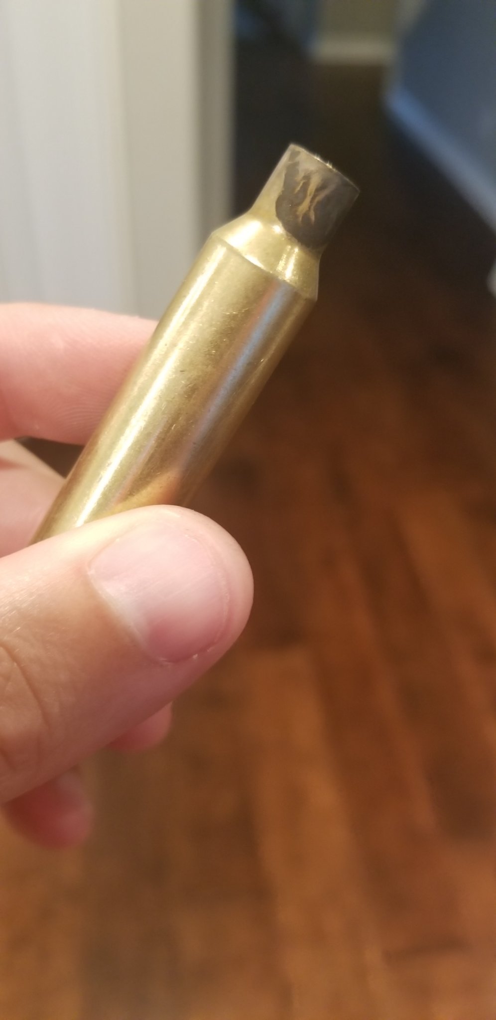

Ok gang I just got back from my 9 day vacation to Kauai! It was great. 9 days without the kids. It was hard to return until I saw the kids.
Anyhow I was trying to do some load development and ran into ejection issues. No matter the charge I had to pound the bolt back to extract.
Chambering was not difficult. A little tight but nothing that spooked me.
I was using the 1x fired brass from Mr Tubbs that I purchased.
Anyhow @Rocketmandb was kind enough to send me 10 brand new pieces of brass.
I just tried Chambering and ejecting the new brass. I had ZERO issues Chambering or extracting.
However when I try the samething with the now 2x fired brass.... It's hard to close the bolt and hard as hell to extract.
I checked the brass and all looks well except for this carbon ring.
People have said it is the used brass. But I am FL resizing. So maybe it is the brass or is it the die? Chamber bad? I need help.
Accuracy was great. I have not had a chance to fire the new brass yet.

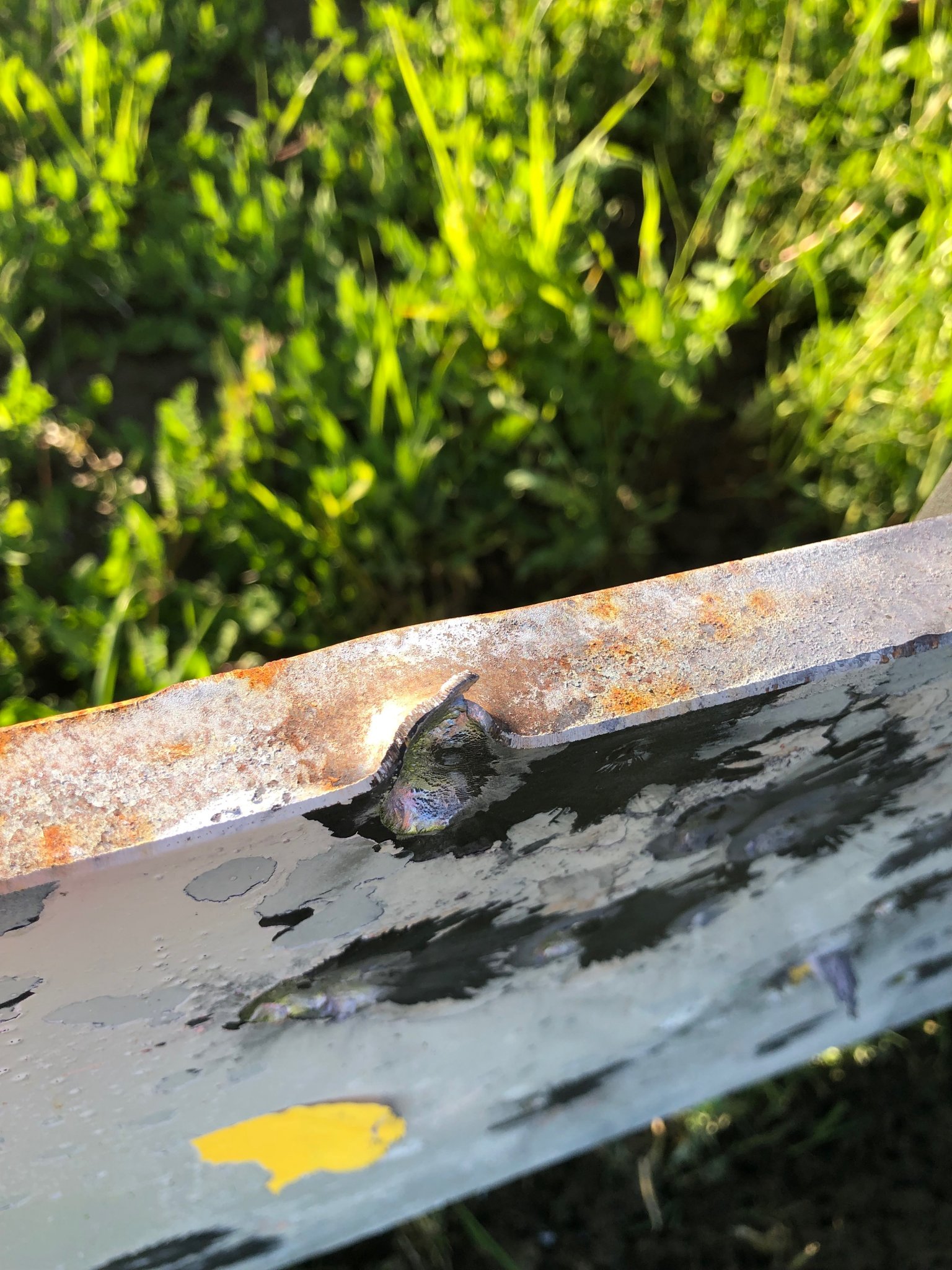

PRC Update from the Range:
I went up to the 750 yard range today and a great time - again, 70 and bright blue skies. There was about a 10 mph coming in at about 30 degrees front right. My purpose(s) of the trip:
1) Load test Retumbo
2) Test my rifle's new trigger
3) Put my new attempt at a portable steel target holder to the test - one that can take being on a hill and absorb a 225 gr bullet hitting it at 2000 fps.
Load Test Retumbo
I started the ladder at 77.5 gr, which I thought would get me close to the equivalent of 76 or so of H1000. I was wrong. The muzzle velocity of the first load averaged 2891 fps, with an ES of 14 and a SD of 5.9 - nice! The group? Not so nice. It was all over the place. Okay, so not a good (or even decent) group, move up to the next load. It was worse than the first. The best group I got was 1.7" at 200 yards = ouch. It was so bad that I thought my scope might be loose, or that mucking with the trigger screwed up the joining of the action to the stock. I stopped my development and switched ammo over to my 76.2 gr H1000 load. I averaged 2853 fps and shot a .73" (.365 MOA) 5-shot group. I'm not ready to give up on Retumbo, but clearly the upper end of the spectrum isn't working for me.
New Trigger
Works great - very happy.
Portable Steel Target Holder
Another not so great result. It sets up easy, - put it up at 750 yards - but cant' take the beating from the PRC shooting 225s. I got four rounds into it before it fell most of the way over. Then it took about another 6-8 before it went all the way down. Back to the drawing board here. Below is a video of the first shot - it's not the greatest quality because I had my phone set up incorrectly, but it's cool because you can see the bullet flying in.
I ended up switching over to the range's steel (also at 750). Look at what the 225s do to steel that's not AR500 - and not just the edge shot. It put gouges in the middle :)
7052661
My target stand didn't hold up, but at least my steel did :)

Never seen a carbon mark like that
It does look kind of odd. If doctor hadn't said it was a carbon mark, I would have said that something is wrong with the brass. If you look closely at the edges of carbon marks, they tend to be diffuse, as they are made by gas. These marks have very defined edges - I don't see how the finger-like markings in the first image could have been made by gas. I would suggest sending a picture to Hornady and asking them how these marks could have been made.
The gas marks are consistent on every fired brass that I have out of my gun. Something is wrong.
For a gas to make hard edges like that, the unmarked portion has to be completely sealed. Conceivably, the brass could be expanding and sealing against the chamber before the round exits, but I wouldn't think you'd get those sort of irregularly shaped lines. Do any two pieces of brass have the same or similar patterns?
All the brass has those findings. I should and will check concentricity. I'm guessing something is off with the chamber
I would index 4 rounds with a witness mark, single round feed with said mark into the position of 12, 3, 6 & 9 O'clock.
When fired does the carbon mark always end up in the same spot relative to the chamber? Or does it follow the
concentricity of the brass?
On my larger caliber rifles I anneal after each firing. It will not hurt your brass if done properly and it keeps
the neck/shoulder area flexible allowing the case to expand during the firing cycle which helps with several
issues.....neck tension, sealing the chamber etc. Although this is not a cure if the neck of the loaded round is way too
small vs. chamber neck size.
I hope this makes sense? It did when my little brain typed it out :(
Respectfully submitted,
Chet
So what's my options? Just deal with it and move on?
I recommend to my customers to always start with new brass. The reason is 99.9% of the time, if there is a problem it's traced to the brass that's been fired in a different chamber. Not all reamers are the same size, close but there are -0.000" + tolerances. Then the chamber. Not everyone cuts the same size chamber even using the same reamer.
