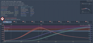

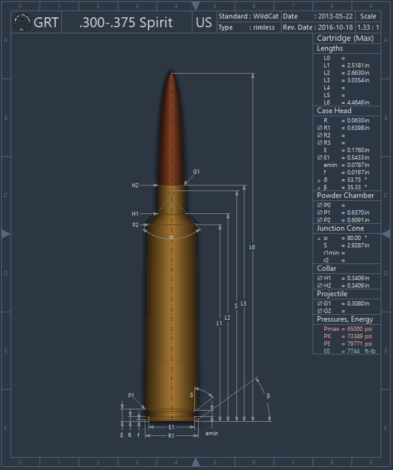

I did some prelim work on your wildcat (I hope you appreciate the name). GRT says it can push the 250s at 3120 fps with 124 grains of N570 :)
What software is this a screen shot from?

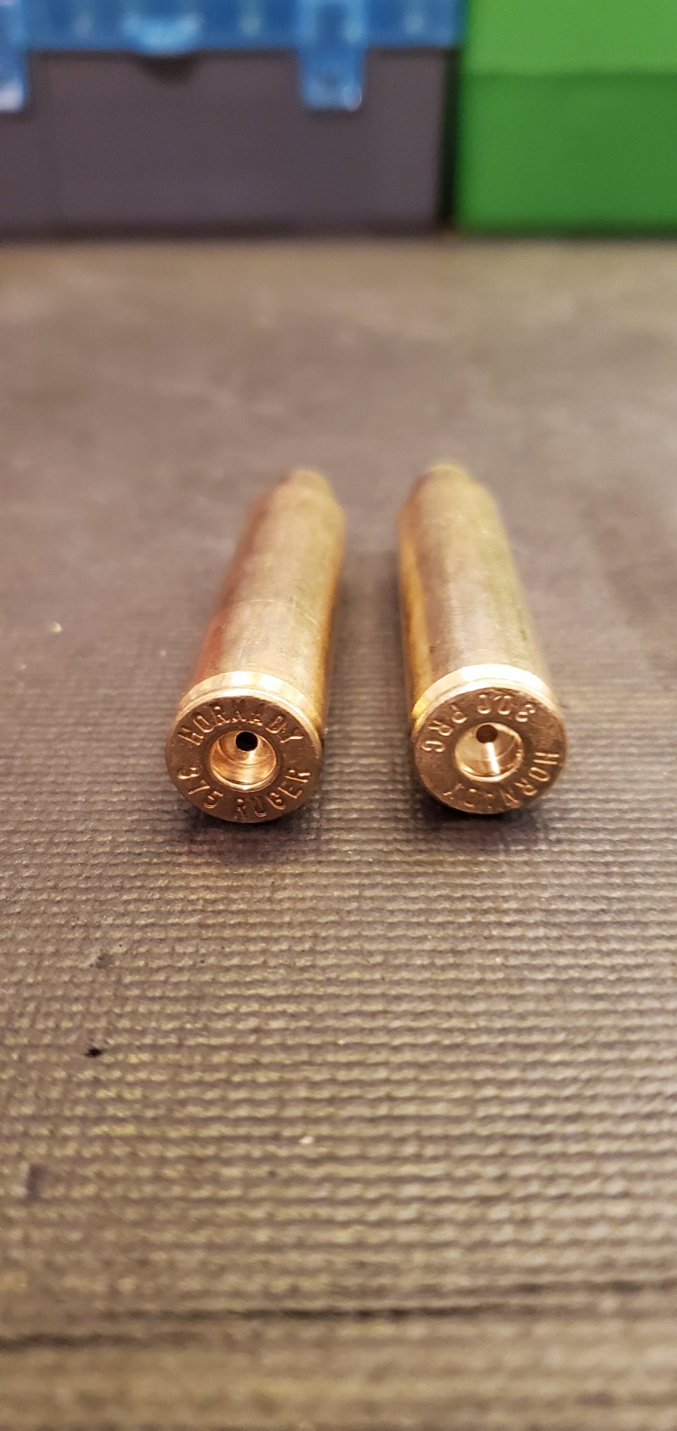

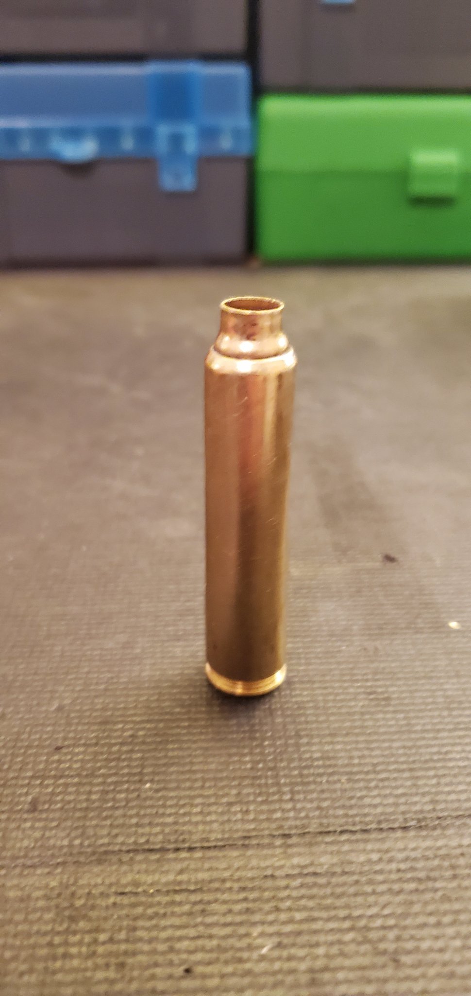

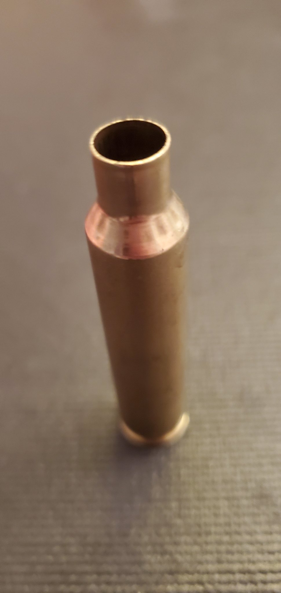

So, we all know that ammo for the 300PRC is scare in the market place. We also know that finding reloading components have been frustratingly scarce as well. Powders hit websites and are sold out in mere seconds. Same with primers, bullets and brass. With ADG not planning to come to market with more 300PRC brass until months from now, and the Lapua release that may get back up into summer, what exactly are we to do? Buy Hornady brass? Have you tried finding that lately? It has been gobbled up off the market as well. With competition season approaching, many people are getting nervous about not having anything. I myself have lowered my powder loads on my 230gr A-Tips and my new 245gr EOL's just to baby my brass so it will last longer.
Well, let me give you an alternative. Just incase the brass of ADG and Lapua get pushed back to a point that makes it to where you can't shoot, let's walk through one of the simplest brass resizing/substitution jobs you will ever encounter. I'll walk through how to turn 375 Ruger brass into 300 PRC. Yes, going from the parent to the child case. After this you will see how simple it is, and you will see that it wasn't much innovation to take the 375 Ruger to the 300 PRC. Wildcatters did it first and Hornady just SAAMI spec'd it and called it Easy Money. The cartridge is my current favorite for 1000 to 2000 yards...and slightly beyond. Now...let's take a look.
So, I'm using my normal full length sizing die with the expander ball removed...I never run an expander ball. I'm using a 334 bushing. I would not use a non-bushing die because it squeezes down too small. I did not find it necessary to go bigger and do two or more sizing operations making the neck smaller each time. I did however only partially size in a few steps pushing the neck in and the shoulder back. Let's take a look:
The 375 Ruger next to the 300PRC. You will notice that the cases are really close in OAL. You will notice that the 375 neck is much higher up and the shoulder angle is different. Everything else is very close, like body taper. So, I sprayed everything with Hornady One Shot and let dry. Next I attacked only half of the neck.
You will notice I only did a partial neck sizing. Look how the brass being squeezed in for the new neck diameter and flowing down. I only did a partial size here, lifted the handle...and then gently went for the remainder of just the neck.
Neck is done, but we haven't attacked that shoulder yet. What I do here is to slowly push that shoulder back...If for any reason I feel a little extra resistance, I'll pull back and do the shoulder in two steps just like I did with the neck. After the first one I measured and lowered my die just a few thou and finally got it to where the 375 Ruger was sized down and coming out within 0.0005....aka half a thou of my ADG brass measured from base to shoulder using a Short Action Customs 30 degree shoulder angle Comparator Gauge. They came out pretty nice.
375 Ruger on the left and 300 PRC on the right. The surprising part is: After all this, I measured the OAL and came to 3.871 on all of them. I trim at 3.870 and my trimmer barely made a sound as I took these to 3.870. I ran them through a neck expander mandrel that slightly moved them out to what I prefer my neck tension to be. I will load these up and probably shoot them this weekend. I'll anneal them after and run them through the reloading process just like the ADG brass and see if some of that brass flows forward and grows. I will see just how much brass I have to trim. I'm expecting a little flow forward. We will see. If I do see a donut forming I will neck ream and report my findings.
These should shoot just wonderful. The only problem they should have is the inherent primer pocket failures that are known in Hornady brass. I hope this tutorial will help at least one person who may be stuck in a situation where they want to shoot their 300PRC but either have no brass, or they are afraid of damaging/losing the precious little they have.
Just in case someone gets froggy and tries to do this in one step....in one pull of the press handle...here is what happens when you try to go too fast:
You get some nice dents that should go away when fire formed....however, you never know if they will create a crease and crack the brass. So, just go slow and take your time.

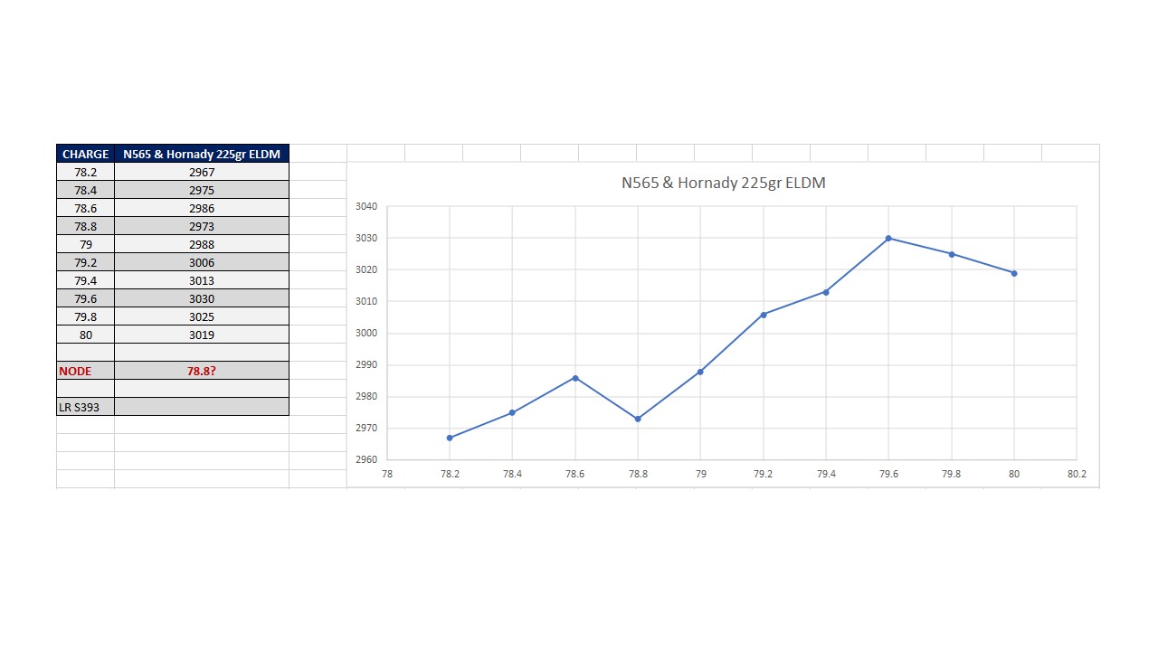

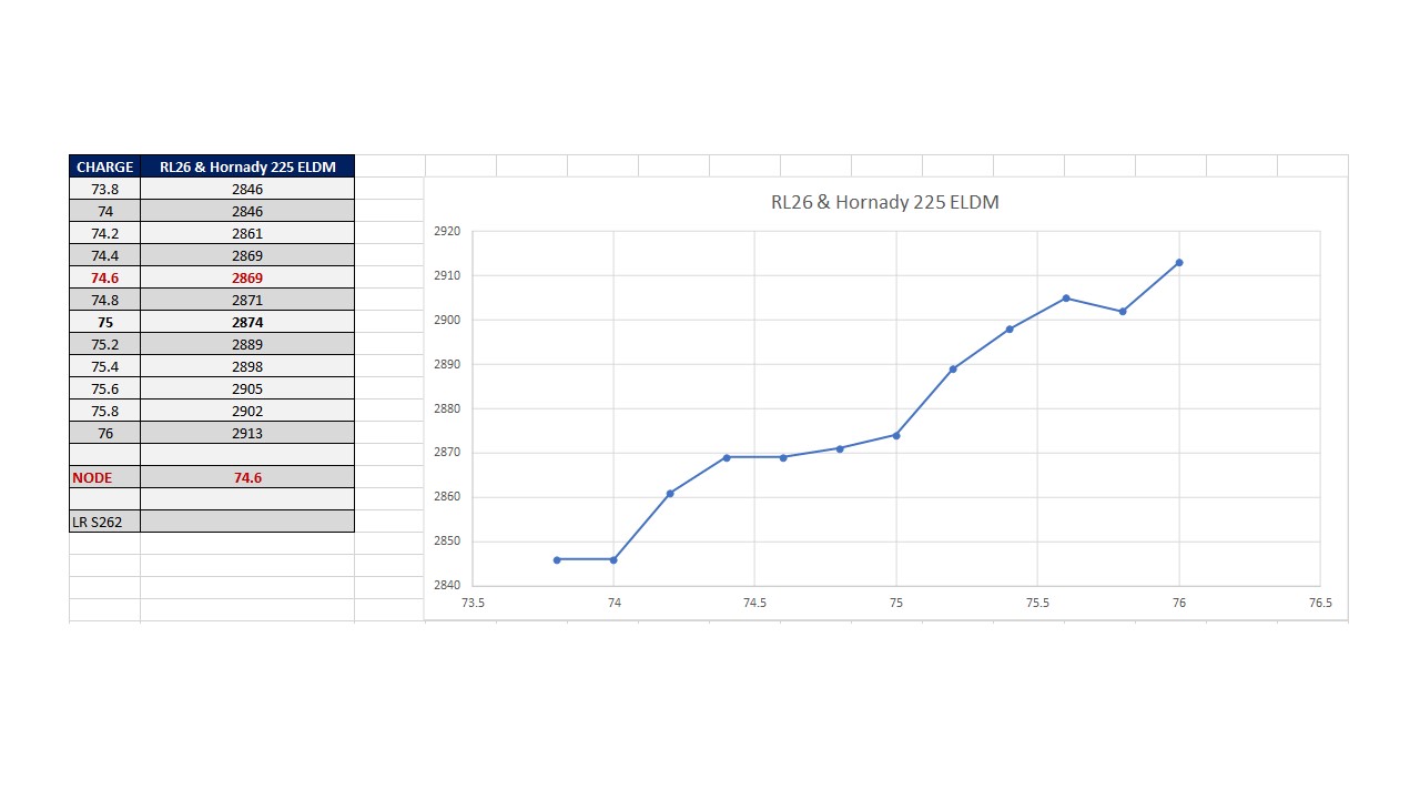

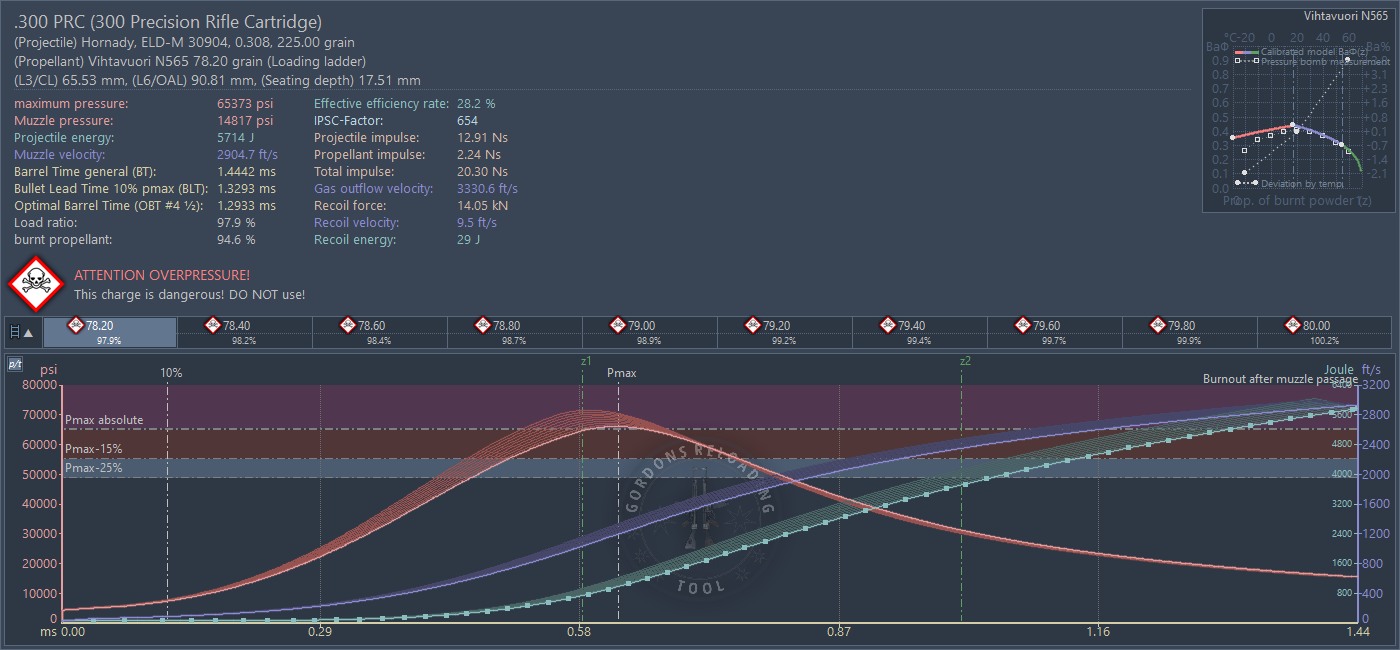

Some recent load testing in the AXMC with 27" barrel. N565 and RL26 with the Hornady 225 ELDM. Virgin Hornady brass and F210M. 40 degrees and a DA of 200.
The N565 load was much hotter than I expected. Heavy bolt lift at 79.6 and up. I'll probably re-run the test in the 76gr area.
HI,
I was trying similar loads with 230 A-Tip and no bold stickiness at all but I BACKED OFF after checking pressures with GRT, this load is flaged as dangerous overpressure. I will wait until Nammo publishes N565 load data. There is some people using N565 around the forum but we all are in danger of serious over-pressure until official data is published. Here you have the output of GRT about your load.

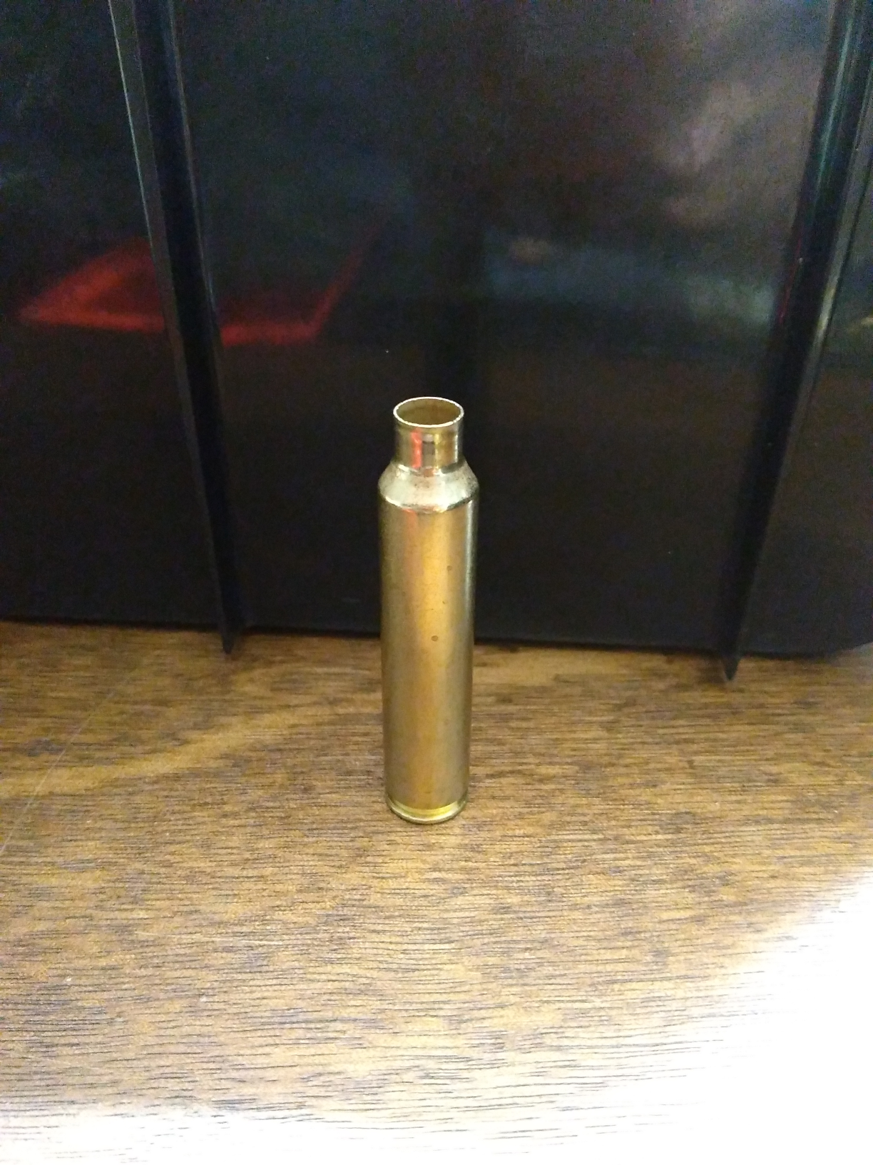

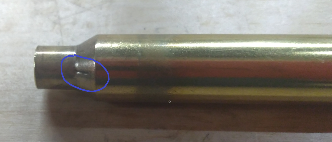

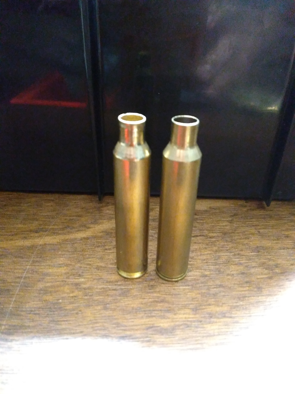

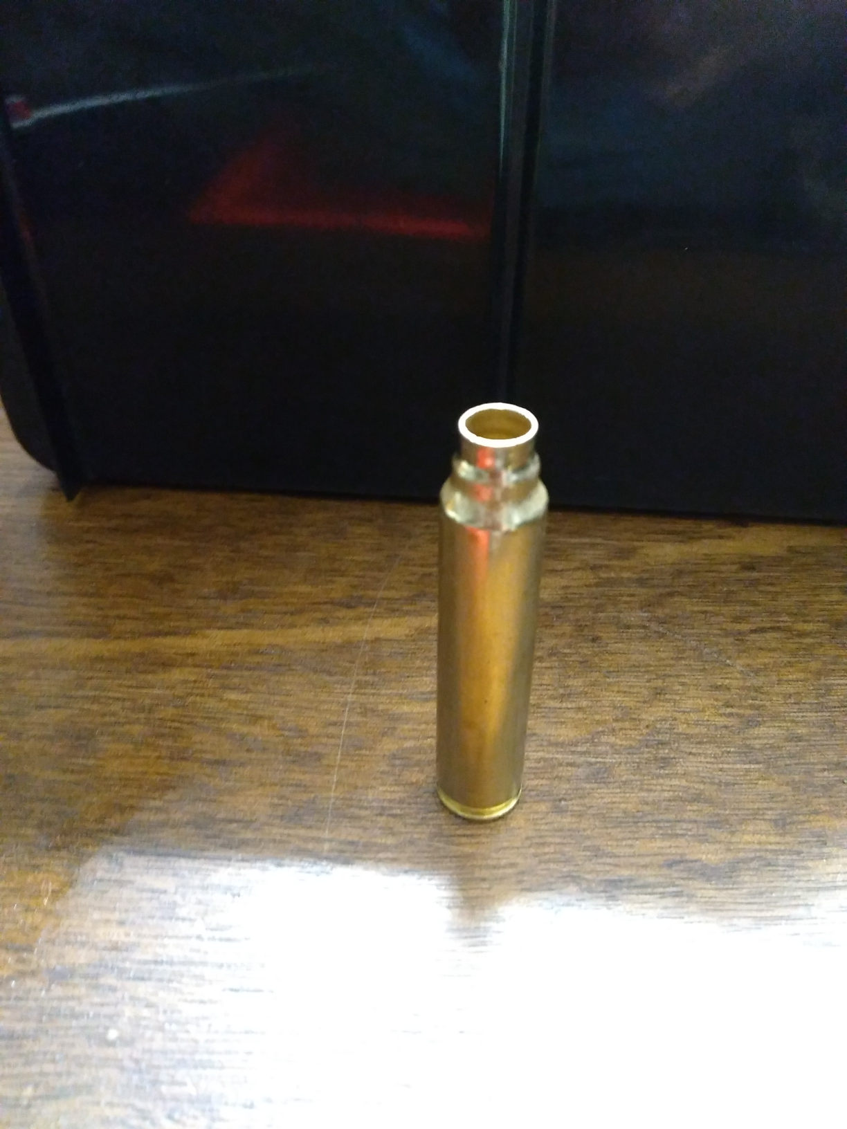

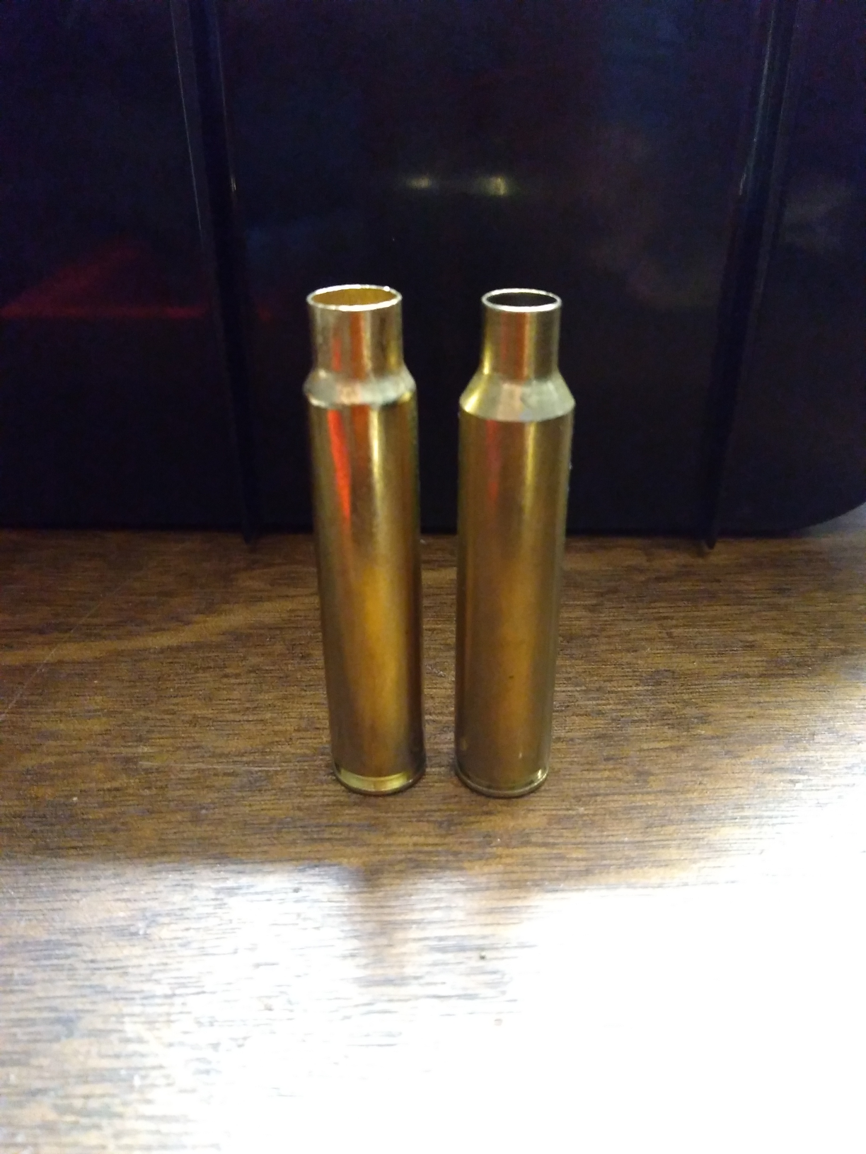

I picked up some 375 Ruger brass and sized it down. My first attempt failed and I wound up removing the bushing from my die to do the initial sizing. I reinstalled the bushing and ran them through again to finish sizing the neck and to bump the shoulder back to match my Hornady 300PRC brass. I also ran them through my mandrel die to expand the necks.
300PRC brass (left) 375 Ruger brass sized down (right)
I had a few at first where I had to much lube on the shoulder. They have dents from the Hydraulic pressure. Overall im happy with the results. The case overall length is right in line with b2lee's result of 2.871" When I get my barrel chambered I will give them a shot.
Side by side with little difference in appearance.

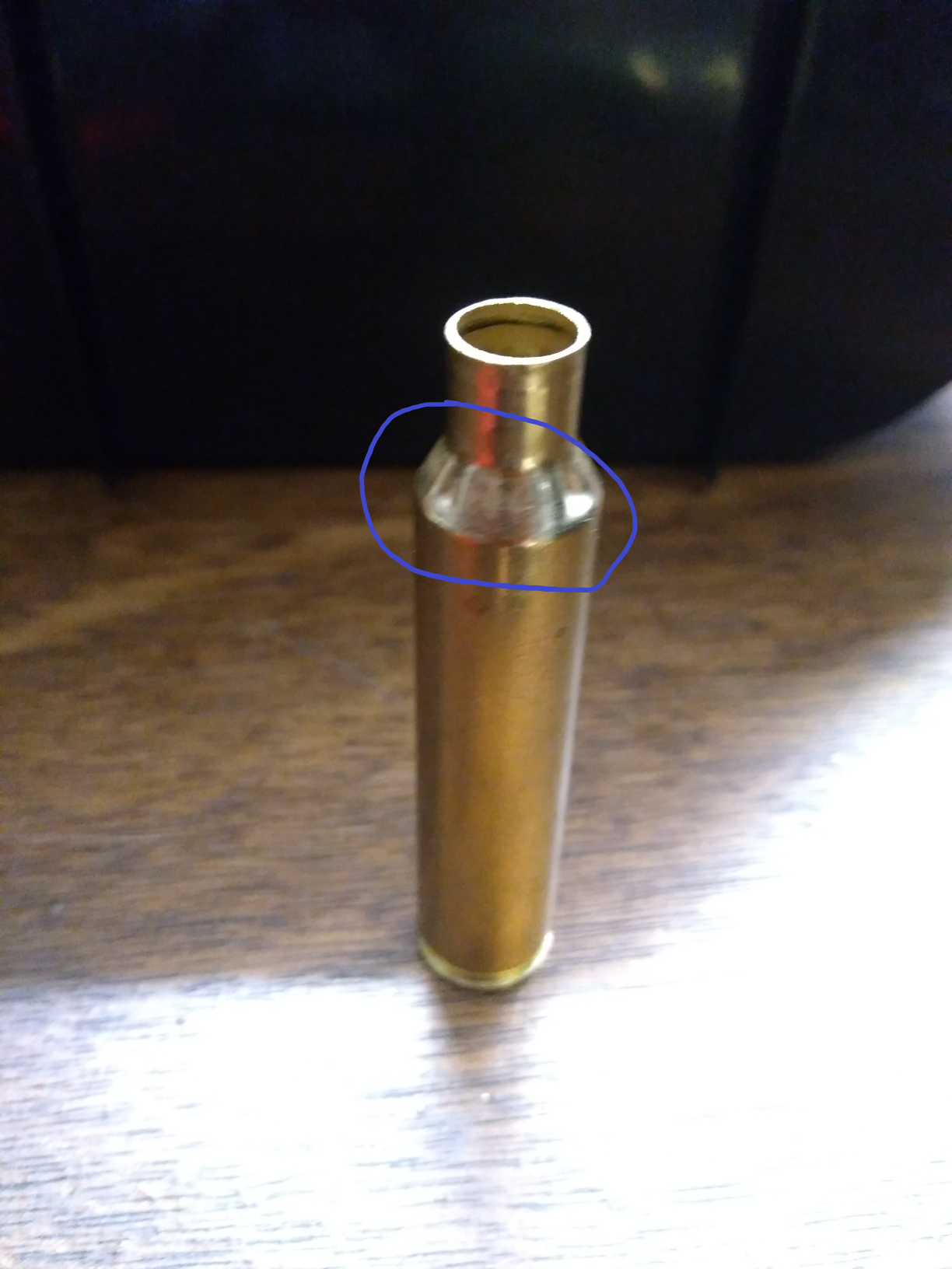

Here is one that I over lubricated.
Oops..

Here is the update to Tuesdays post on converting 375 Ruger brass to our beloved 300PRC. Let me throw some caveats out first. Today was a sunny day but cold to me. High while I was at the range was 30F. Very light wind. Elevation 931ft ASL. Humidity 54%....blah blah...like that matters. It was a sunny and cold day. Range shot is 100 yards.
Now...to something that does matter. Brass is virgin brass that was necked down to 300 PRC using my normal full length sizing die with a 334 bushing. No expander button. The brass was NOT annealed before or after doing any of these steps. Primer is a Fed #215M. Powder/charge is 75.0 grains of RL-26 measured to the kernel with an Autotrickler V3. Bullet used is the 245gr Berger EOL. Seating depth is an arbitrary seating depth. It fits in the CIP mags. No work up of any kind for seating depth...and all rounds were shot prepared exactly the same.

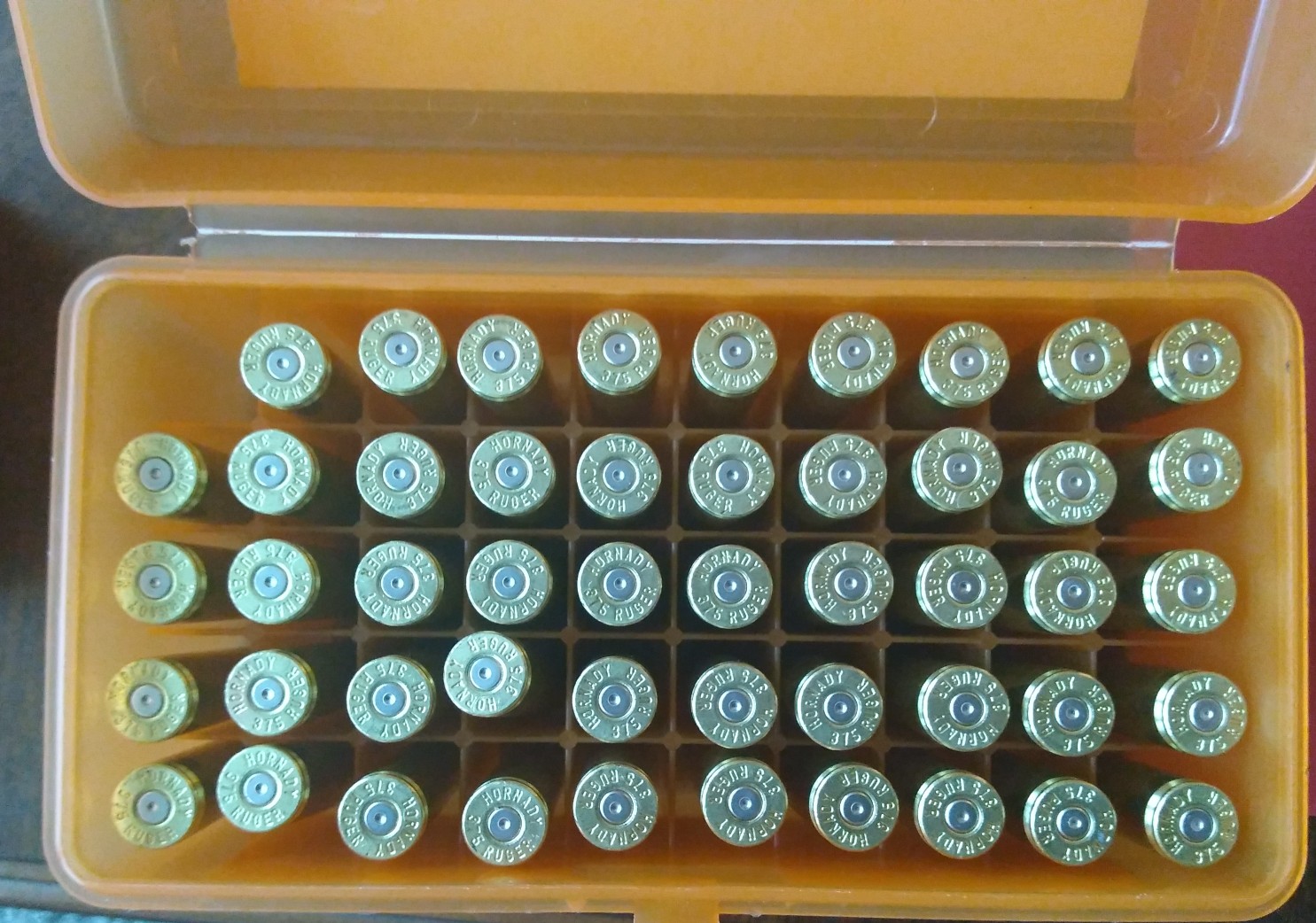

Here is a look at the fired primers:
Things look great. Going to clean some things up and I'll be in the shop running this brass through my normal reloading process including annealing. I will take some measurements and see just how much the brass moved, grew in length....check for donuts...and what the seating neck tension is on the next go around.
You are using large rifle instead of magnum primers and it is working out for you? Very nice, do you still start the load 10% under when you are switching primers? I am still kind of new to reloading....

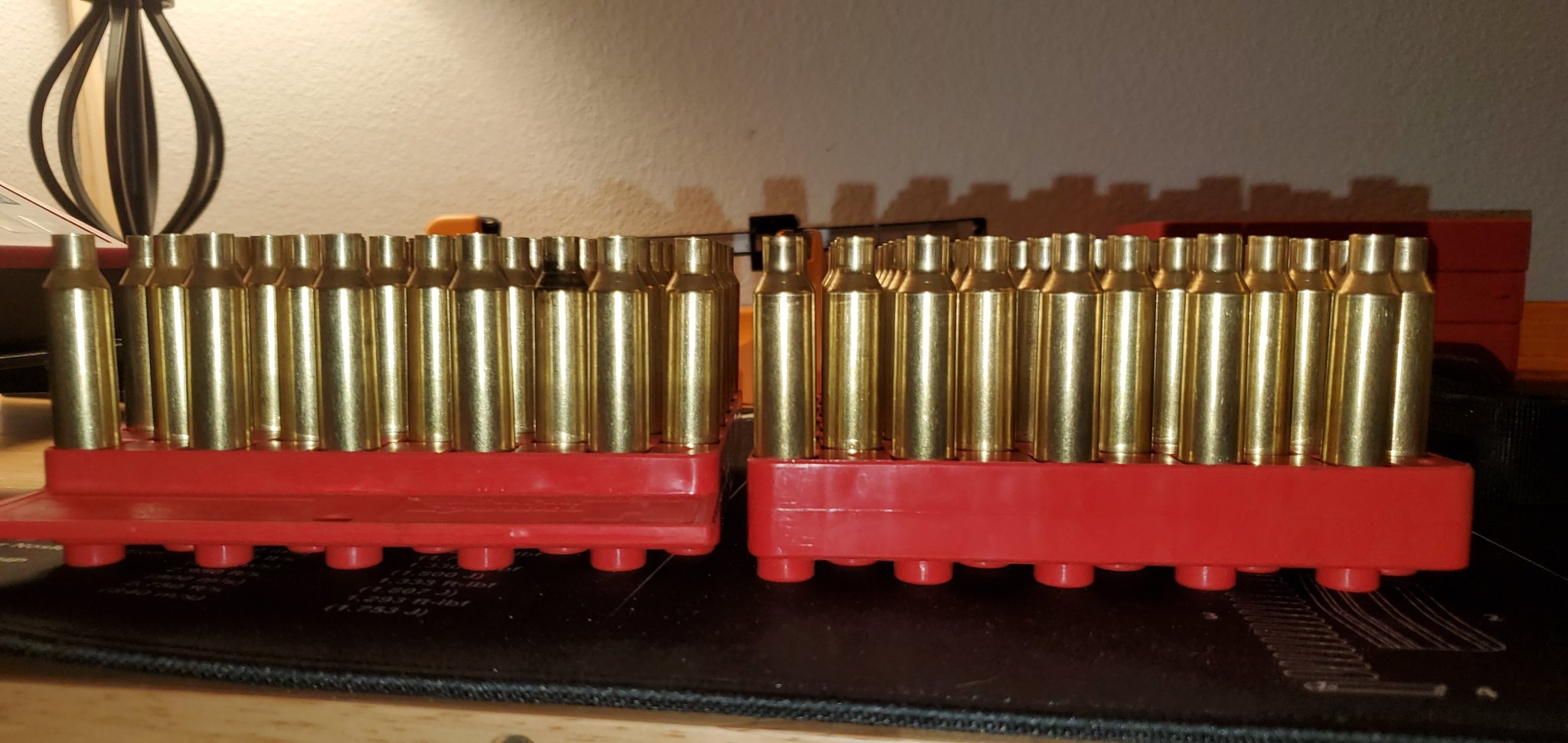

So, since the last post about the 375 Ruger to 300 PRC conversion on some Hornady brass, I've deprimed, wet tumbled, dried, annealed, full length sized with 334 neck bushing while only bumping back the shoulder 2 thou, neck mandreled, trimmed, chamfered and deburred everything. I also gauged the primer pockets and everything is good there.
I measured the base of the web and the thickness was 0.5325 and after sizing 0.5320...so a half thou base sized back to SAAMI spec. Neck thickness is 15thou. Upon trimming....probably 80% didn't even kiss the cutter....while a few cut a half thou off...and only 3 cut about a full thou off. So growth was none to minimal.
The big thing was....this time around....everything felt the same. Using a Rock Chucker IV with a ball handle instead of the roller handle...I get a good feel for any changes....unlike some of my other set ups where things are set up for my comfort and speed. Full length sizing was much easier than expected. Probably had to do with a good anneal and only bumping back 2 thou. Neck Mandrel opened up the mouths very easily with very little resistance and minimal spring back.
All in all...everything felt very consistent and I felt I was doing the minimal to the brass to achieve my goal. I'll load some up soon and give feedback on how easy the bullets seated. Maybe next week...if the weather would break...I'll go back to the range and shoot some across the chronograph. I expect to see those Extreme Spreads drop down to something I'd be happy with...along with a nice tight SD. Not really expecting much out of the groups, since I'll once again use the old barrel to do the testing work.
There is one negative. The picture I showed of a few divots in the neck...after fire forming and the rest of the process....it appears in the future it will split the neck. Next time...if there is a next time...I will anneal before the entire process. DO NOT ANNEAL FIRST {It will crush the necks too easily instead of forming them} I didn't anneal this time because I feel annealing is something a lot of new reloaders can't/won't do. The tutorial was to show how anyone can do it. But annealing before starting...is the way to go. Pictured below is a future split neck.
