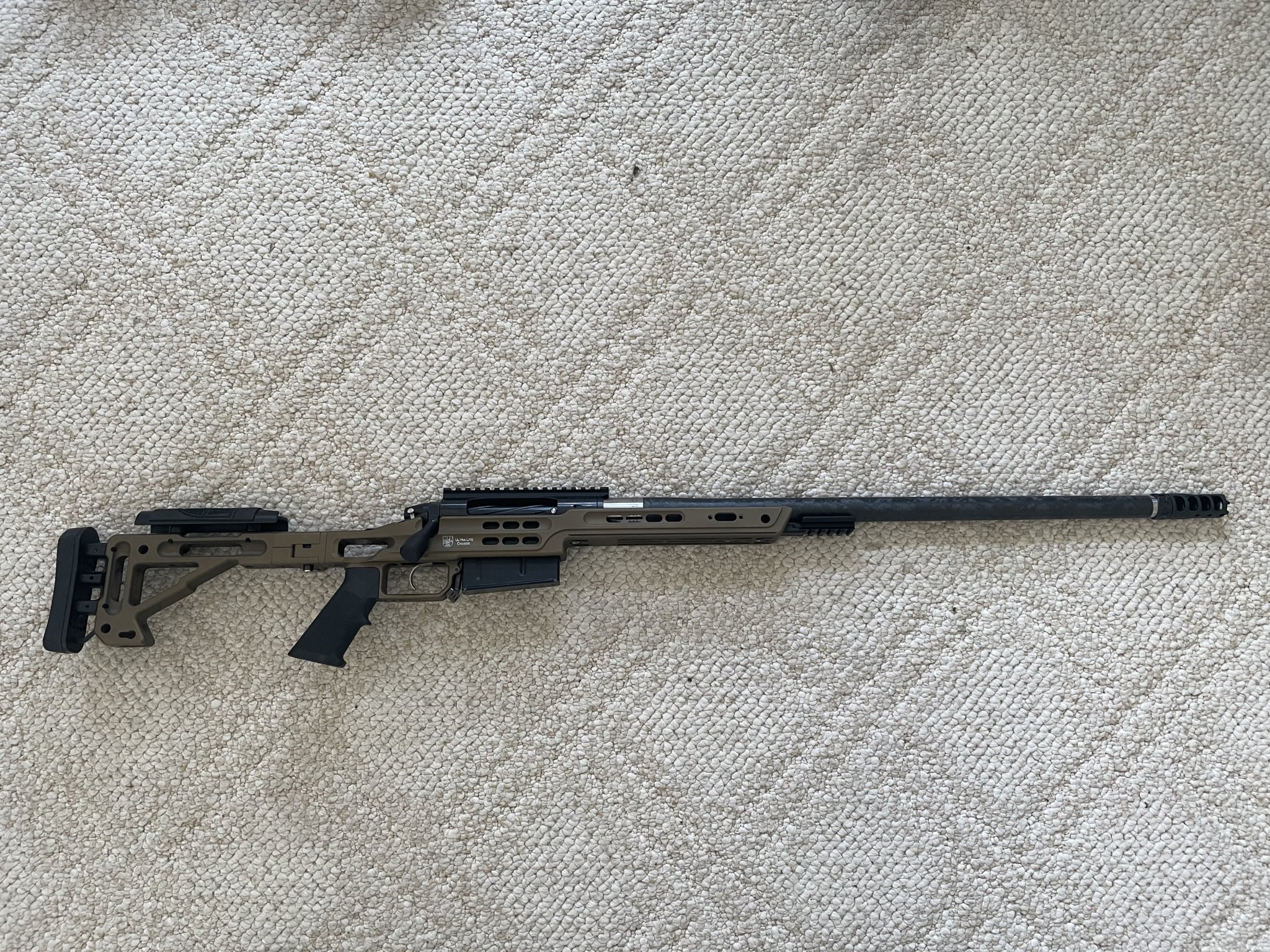

Finally got my 300 PRC put together. Here she is.
MPA BA Ultralite
24” Proof Carbon prefit
Bighorn Origin LA
TT special
PA hyper tap brake
Still waiting on the Vortex AMG, will use my USO MR-10 in the mean time.
