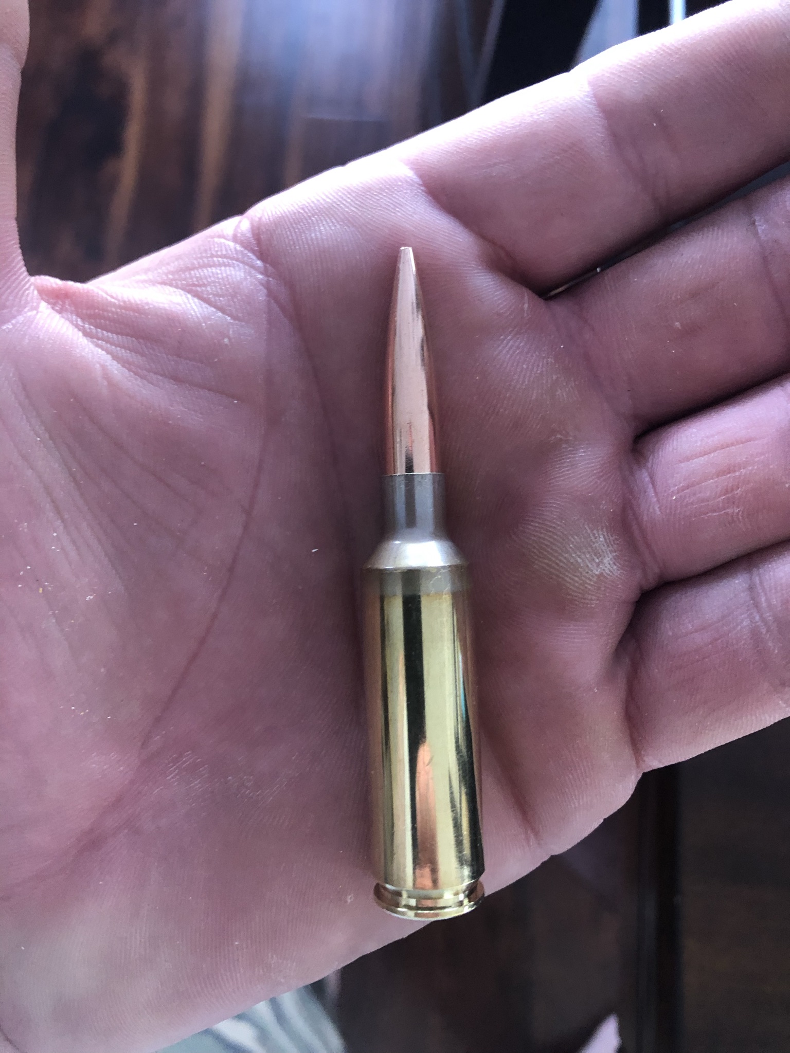

I hear that. In the middle of a 7 Sherman Max build right now. Looking forward to getting this one together. 195’s @ 3k or 180’s @ 3100+. Gonna be a fun rifle
Decided on a 7 Sherman Short
My daughters elk rifle and the 7 Max for mine.
those velocities are with n570 and not great barrel Life. I’ll be happy with 180’s at 3k and decent barrel Life (1500-ish)

I tried that 7 max and didn't see the numbers but didn't use n-570. I honestly matched the 7 saum barrel I had. The 7 saum had 26 inch barrel the 7 max 28 inch. Both were 2880 with no pressure 183 smk. I couldn't get any more from max with out heavy bolt lift. Imr 7977. I hope you have better luck keep posted

Yeah that’s pretty slow.
I'm not gonna mess with the n570, which is what’s getting those velocities. Pretty harsh on barrels. Gonna give H1000 a shot. Maybe 8133. Be happy if I could get “close” to 3k with 180’s in a 26” proof. We’ll see how it turns out tho.

I had imr 7977 and imr 8133. I love imr 8133 in my 7mm-300 win mag great results. I could of just been very unlucky haha I had 28 inch brux barrel. It hammered just slow I went 5 for 10 at 1 mile on man size gong with it testing loads.

My first two 7mm barrels were brux, I was very happy with them.
I got what seems to be normal 7 saum velocities out of both.
If you read around lots of people aren’t getting the commonly suggested speeds with the Sherman cartridge.
That what steered me to standard Saum.
The 7 max with it’s extra powder capacity should work better with H1000, retumbo, 7977, 8133 and N170.

I ran imr 8133 and imr 7977 183 smk and 197 smk. I was pretty slow but yeah a lot of people don't get what there suppose to and some do. Not sure why that happens it's a great looking case too.
