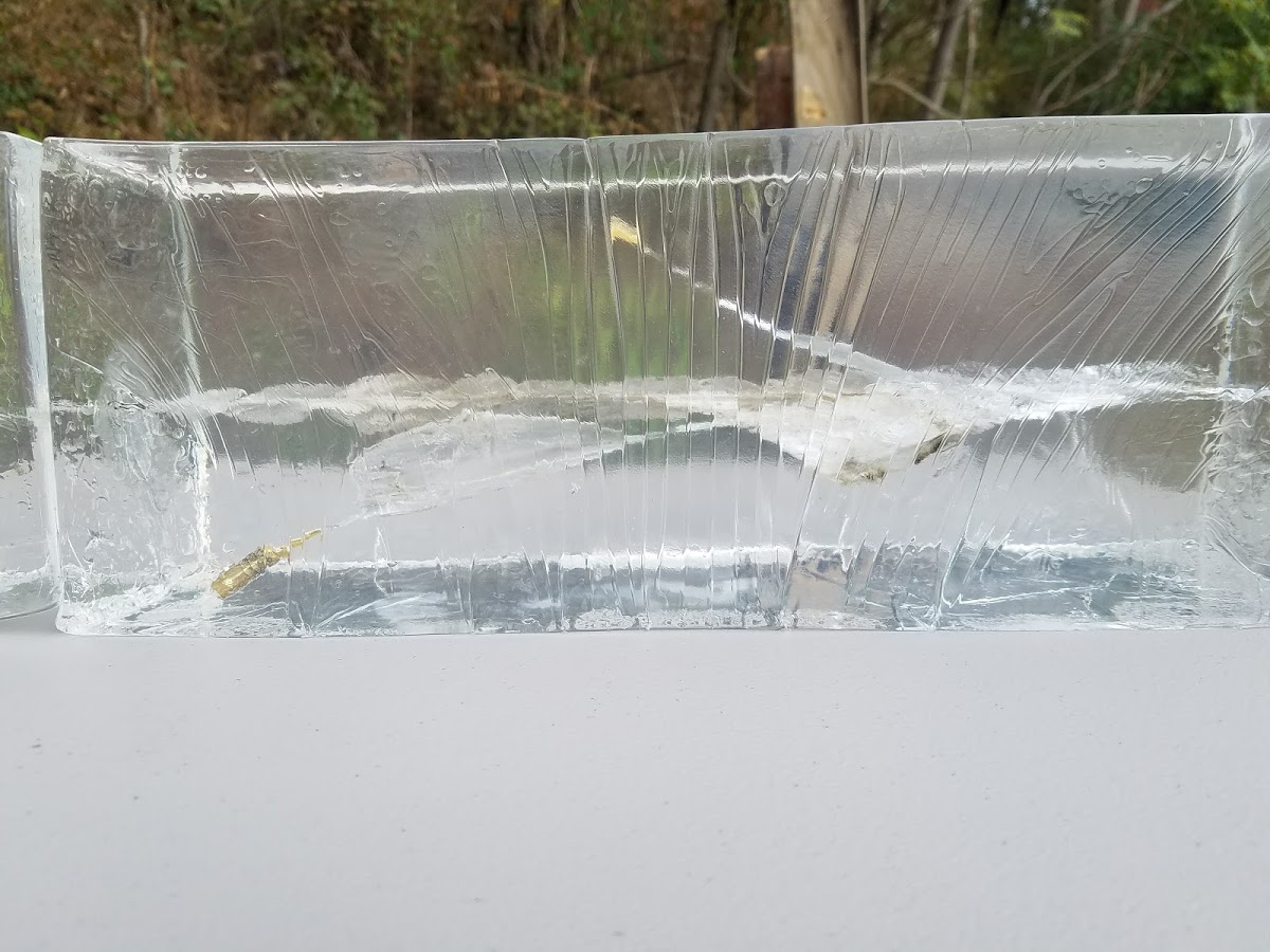

@danatkins Your best bet is to consult someone with real world experience hunting with subs. I've never used the Lehigh ME, but did some testing
with the CF.
Expand and fractured at 750 fps (channel in the background was a Win. Super-X 308 subsonic, horrible failure on their part)
