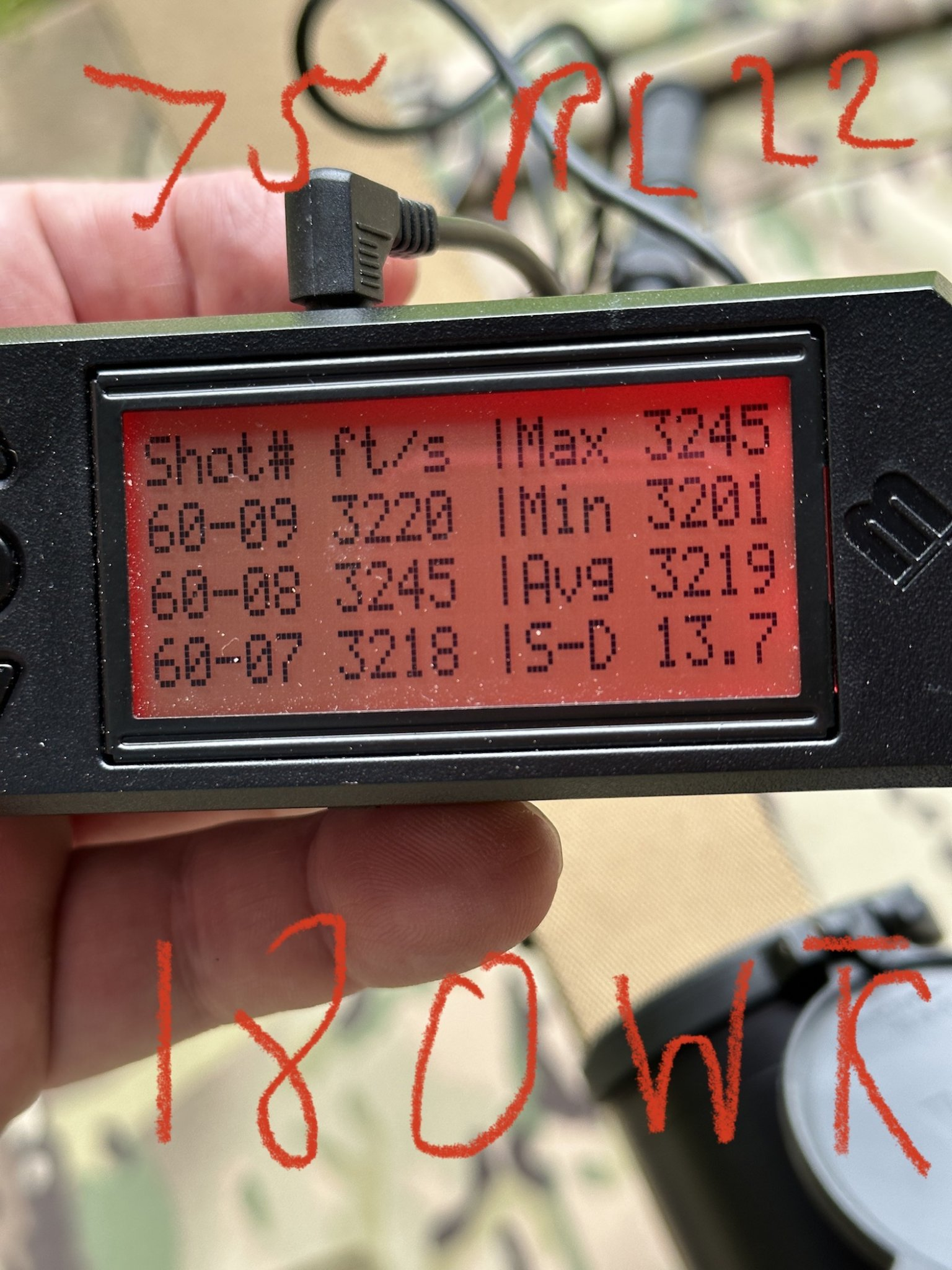

Tried two loads for comparison. Used a 208 Hornady ELD-M with 69.4g of RE22 and 71g of H1000. Both actually shot about the same. Didn't take my chrono so not sure of the speed. The accuracy was good so it gives me something to work with.

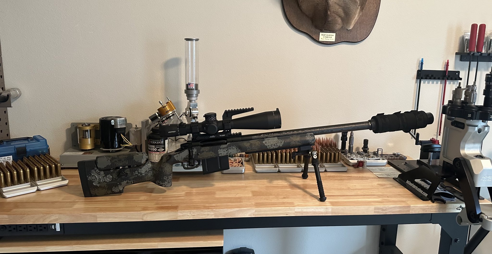

New rifle
Rem 700 custom shop pre-bankruptcy action
23 inch X-Caliber pipe, 1:10 twist, 5R rifling
OSS HXQD 762 Suppressor
Norma Brass
Federal Premium magnum primers
H4350
168 Hornady ELD Match
Broke the barrel in over the weekend. Made some test loads Sunday and shot tonight. Pretty impressed with these first test rounds trying to find pressure (didn't find it and now have no intention of loading hotter).

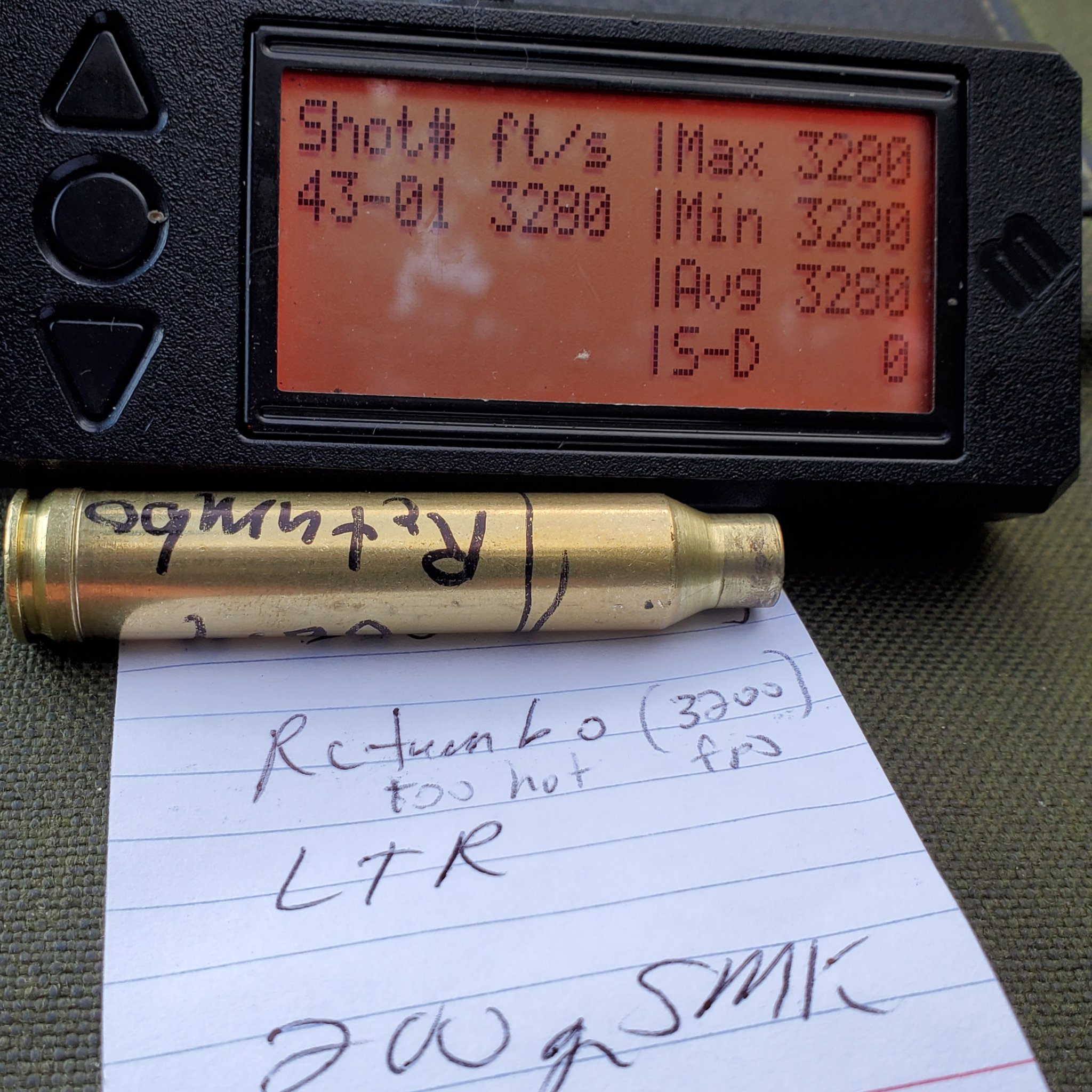

26" 300WM 200 gr SMK 3280 fps, in a chassis with 3.715" MDT mags, so extra long cartridges can be utilized. ..this was definitely a max load it loosen the primer pocket...but 3200 fps was doable.
230 grs SMK at 2964 fps with the long cartridge overall length.

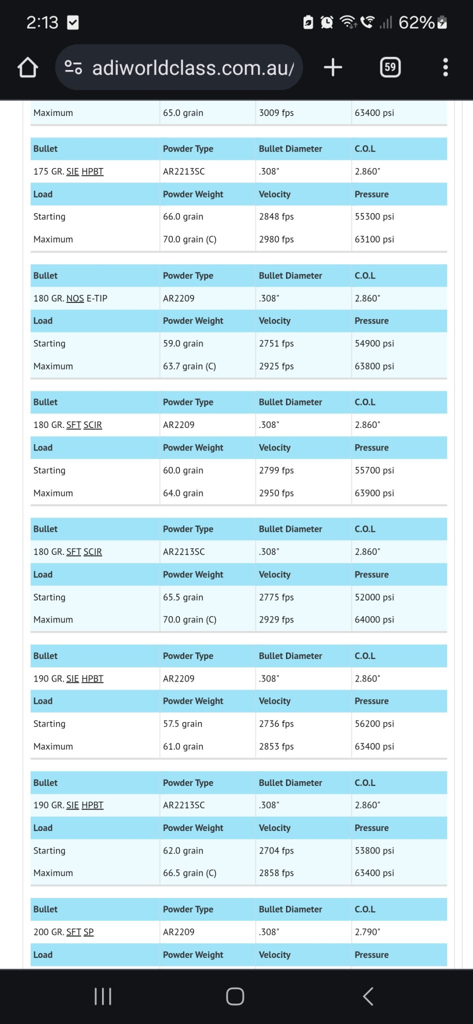

Glad I found this thread. I have a 300 WSM with a 22" Proof CF en route. I have H4350 and RL16 available. Will be picking up Hornady brass unless Lapua becomes available soon.
I'd like to run 190gr Accubond LRs, but I cannot find a starting point for any of these combos. Am I looking at the wrong powders?
ADI lists a 190gr load with 2209/H4350. That probably means reloader 16 will go a touch faster for equal pressure?
Just in case you have trust issues with burn rates. H4350 is the ADI powder repackaged in the US.
https://www.adiworldclass.com.au/powder-equivalents/
