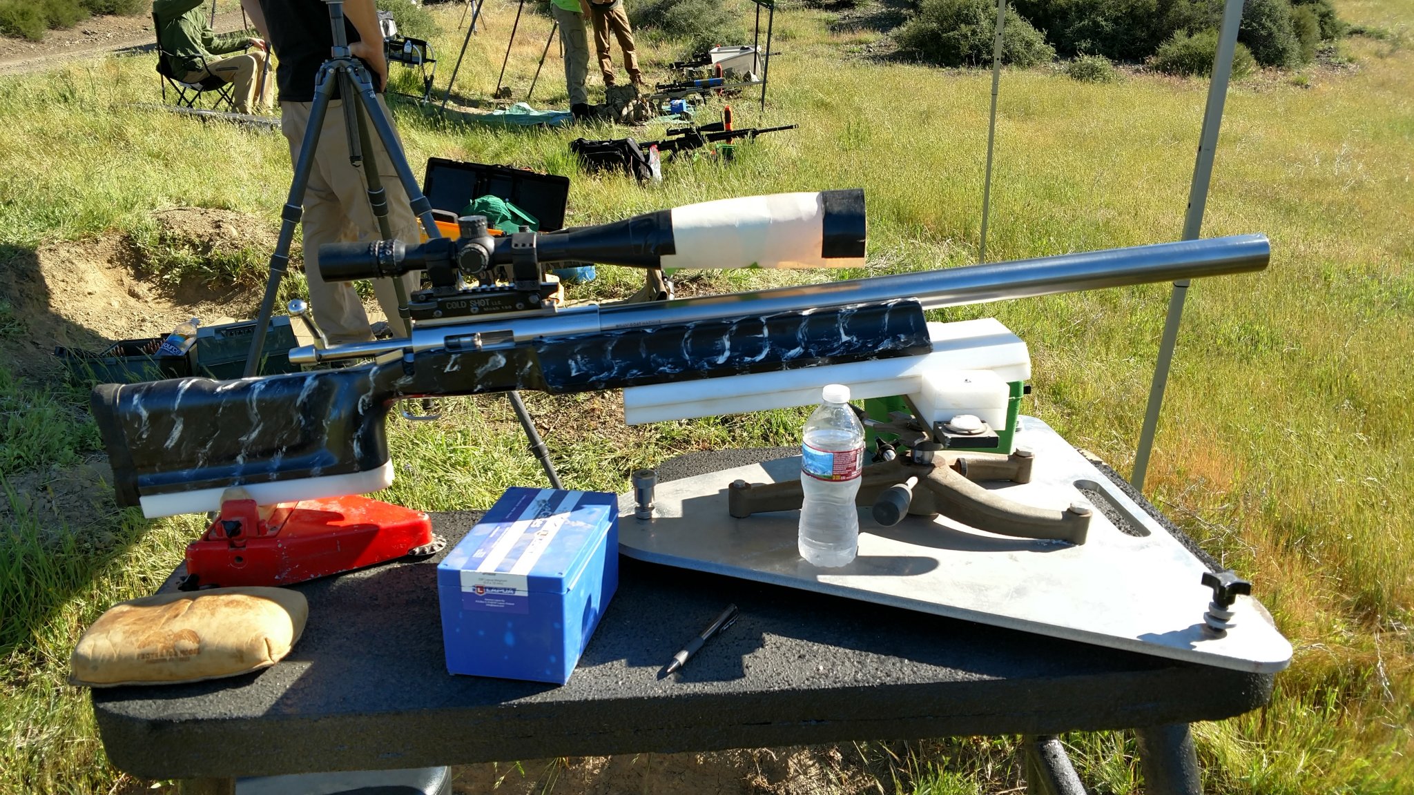

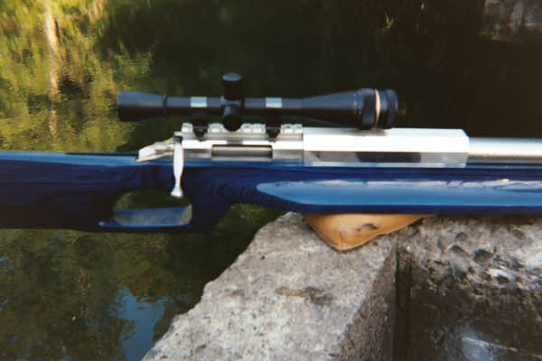

I am a former 600/1000 yard Benchrest shooter who now runs 2000 yard URSA matches in NorCal.
When the guy told you that very few 338 rounds are used in 1000 yard Benchrest he was spot on.
Most of the 30 caliber rifles are 300 Ackley's which is a 300 Weatherby magnum that has been Ackley Improved without the double radiused shoulder and the 300 WSM.
You won't find many 300 Win Mags on the line and one of the better bullets is the BIB 187 flat based bullet. With that bullet most are shooting 13-14.25 twist rates. Groups are simply outstanding but a gun set-up for the 187 BIB bullet usually has too much freebore for most of the better boattail bullets
The biggest issue I see with the 338 Lapua is the freebore is 0.175 - 0.190 to short for the 300 grain MatchKing bullet requiring it to be seated way too deeply which hurts velocity as well as accuracy.
For ELR work the 338 is still very accurate and most importantly you can see the missed shots much easier.
The 338 Lapua,338 Lapua Ackley Improved 338 Norma Ackley Improved and 338 SnipeTac all work very well at 2000 yards.
Black gun is a 338 Lapua Ackley Improved.
Blue gun is a 300 Ackley.
