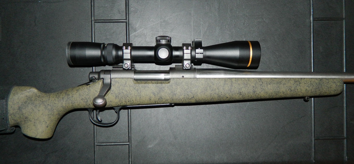

Its not a M70 action, but I was wanting the same thing you are, mine is a 700 action but with a #5 pac nor 1 in 9 3 groove. I had the H.S. precision PSS stock on it at first and I bought the sporter instead. After a good amount of sanding I got the barrel floated and the way I want it.
23.5 in, and not sure on the weight. If I had to guess probably 6# but im not for sure on that.
